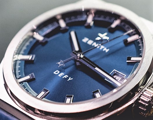

Very very very fond of that Zenith Defy. Jesus!
That was my initial impression...at last someone has done a Genta inspired design with integrated bracelet, under US$10K + with an in-house movement...and it looks gorgeous!

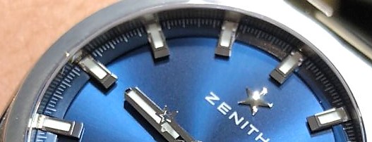

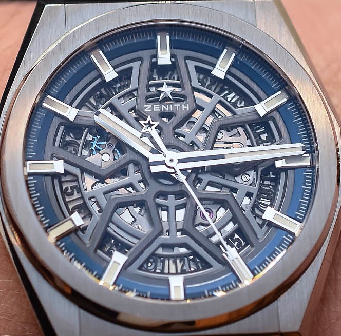

BUT...upon further examination of some online photos of the Defy Classic I have noticed that the indices/hour markers are cantilever fixed to the chapter ring and float above the dial. I think this was executed as part of the design elements of the skeleton dial structure and then to cut costs they kept the same approach for the blue sunburst dial.
I think it looks awful and cheap.

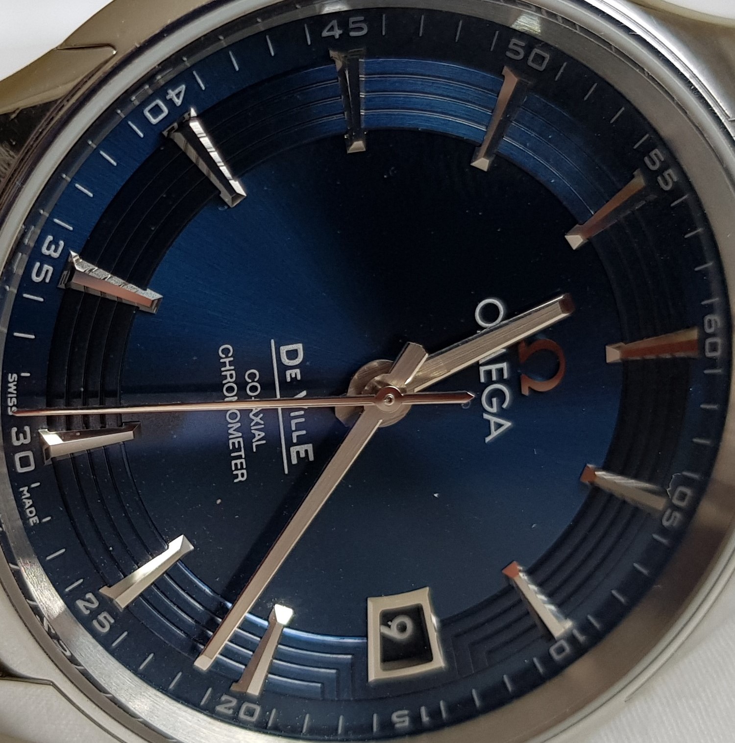

Don't think my Orbis HV is going anywhere (just need to dust it off a bit😀)...the Omega dial with the applied white gold indices/hours markers and sapphire case is on another level.
I would not choose the Zenith Defy Classic over a Globemaster either

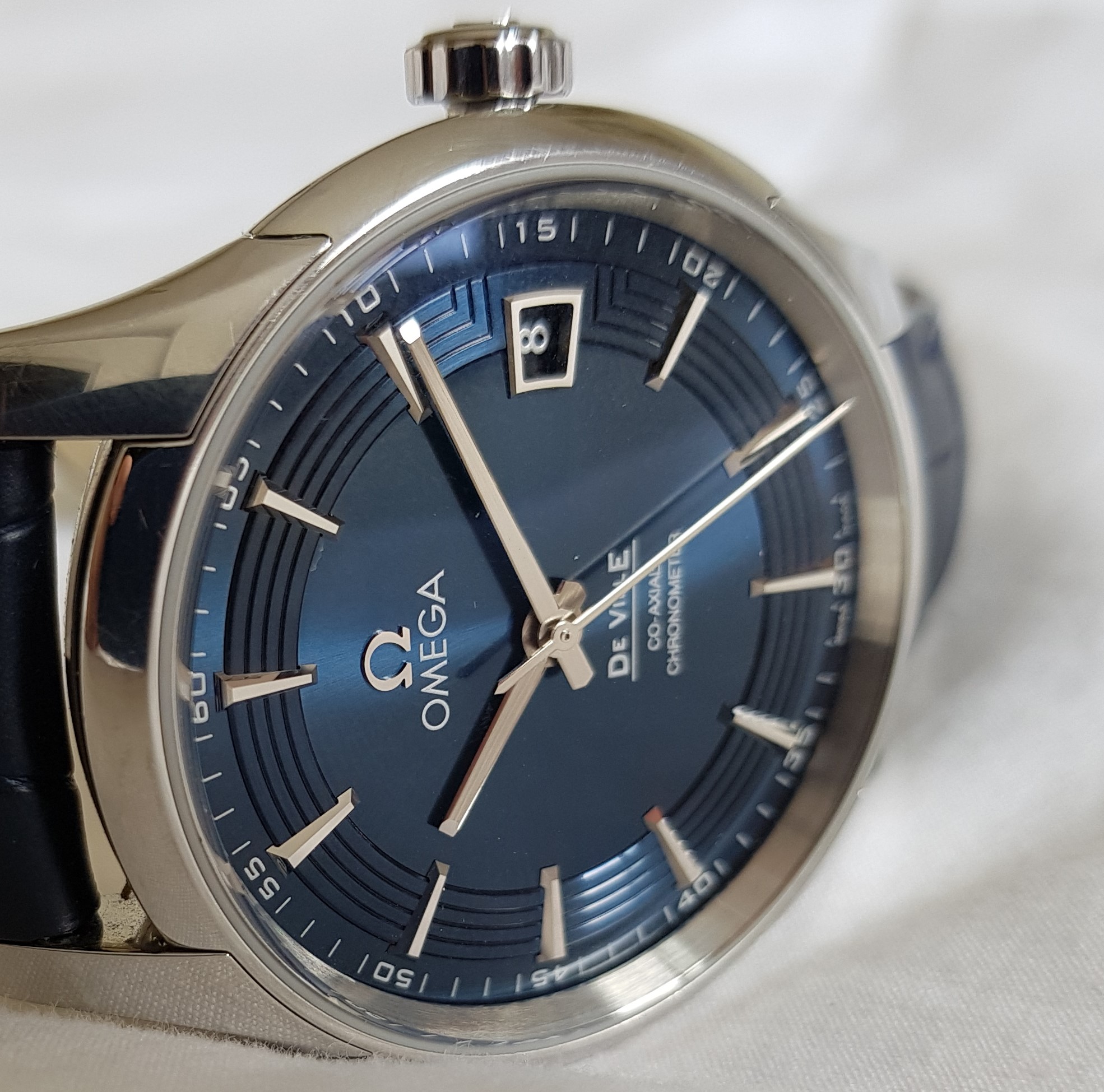

RP - my third Omega is the DeVille HV. Your photos do it great justice!
