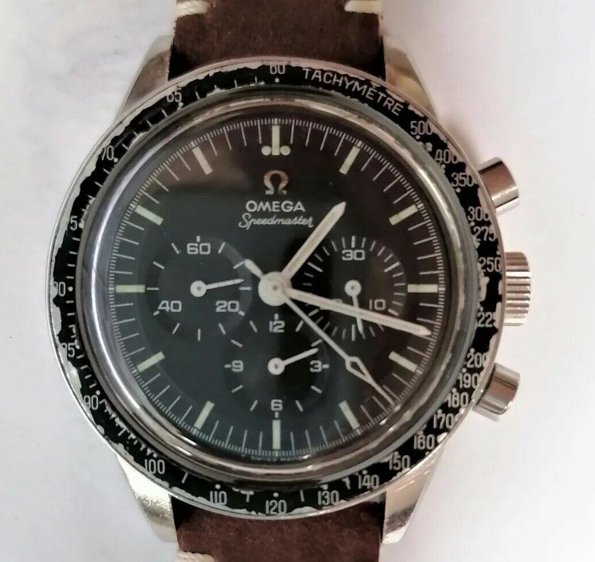

I hope I am not raining on anyone's Parade but I think its already passed the Value as Parts price, and it is from Peru, and it is from a low feedback seller (Only one of those 17 feed-backs is as a seller)....and its more fun to watch it end, so here is a 105.003-65...sort of
The sharp eyed amongst you will see the short indices dial with whitish plots. So that's wrong. But I do see a step...And an applied logo. It could be those plots are so white as any lume has been removed, but the photo is too bad to tell.
This is incorrect specification for a factory released watch so the two possibilities are a re dial, or a service dial. If it is a service dial its very rare.

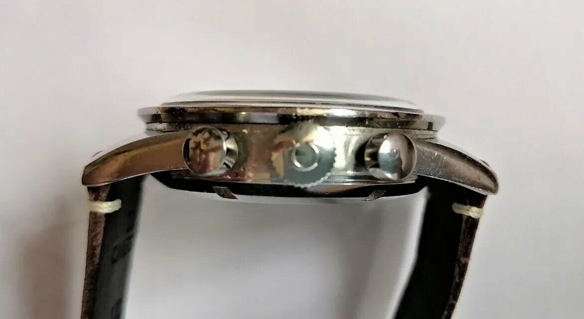

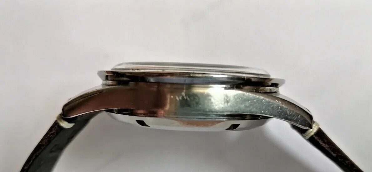

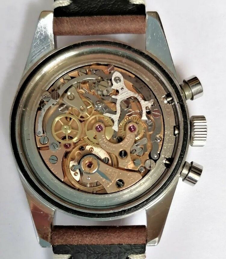

What made this a side step into interesting territory was the pushers, seen here:
Could those be 105.012 pushers?
If so, have they been damaged by forcing them into a threaded 105003 case or is it a push-fit case (rare).
Or are they just best fit pushers?

So possible rare dial, possible rare and valuable pushers, in a polished case with uncertain movement. And yes it has a DO90 but its a Meteor DO90 and those dont seem to sell like they used to

Rest of the listing photos for prosperity:

@Spacefruit William, what are your thoughts on 32 tooth crowns like the one fitted there? Are they always fitted at service or can they possibly be original? Obviously in this case the swapped pushed suggest the former but I am mean in general terms on Sixties models.

32 vs 24 tooth crowns on 105003's are something that sits in the back of my mind. I am not a hands on researcher like MWO crew , all I have to go on is observation and weight of evidence. I also keep in mind that just because something makes sense, doesn't make it accurate.
But the overriding feeling I have, is that it doesn't matter, in terms of value. A 24 tooth original crown can be found for between $250 - 450 and would be indistinguishable from one that had been there since new. I would never dismiss a watch on the crown alone, so again, it doesn't really matter a whole lot. It does of course matter that we note its presence and take it into account when valuing.
A watch where the ONLY question mark is the crown is very rare, so the question of the crown comes way down the list of value influences.
I am open to the idea that 32 tooth crowns were installed at the factory on new watches. (On 105.003's) but I have yet to observe any pattern that might explain, for example, those of a certain serial range or time.
I do prefer to see the 24 tooth crown, and yes, I have a little bag of them like all good hoarders should, and yes, I often (but not always) change them.

Thanks for the education Spacefruit, and I can definitely say without any hesitation, it's not exceptional.
The dial is puzzling. I refer to MWO page 97. "B.4 Short Markers (1960s and 70s). A seldom seen dial, probably very limited distribution or a vintage service dial. "
Main Features:
Professional inscription ( not present in dial in question )
Applied Logo yes
Short tritium markers not through the minutes scale yes
Step dial yes
Spaced Ts yes
Medium width E in Omega yes
G with medium length horizontal stroke yes
S with curving top loop yes
S and p not joined no
Curious about dial... redial?
