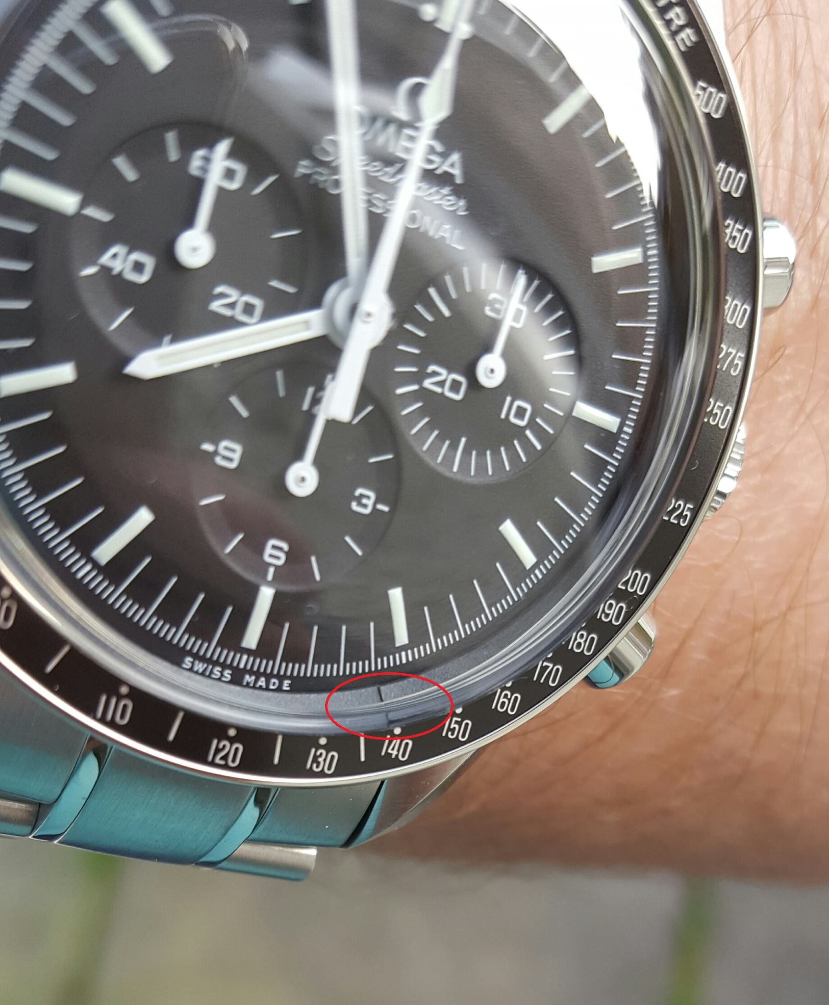

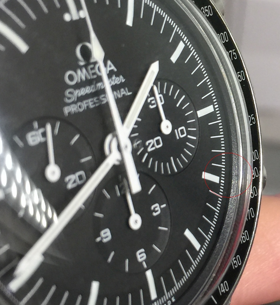

    Should there be a break in the chapter ring of the Speedmaster Professional Moonwatch? I was wondering if the ring is cracked or if there is a break that should be there? The watch is brand new. Please see pics attached. Thanks in advance for any replies. andspeed5pt.jpg andspeed6pt.jpg
  2. Archer Omega Qualified Watchmaker Sep 1, 2016
    26,464
    65,604
    The tension ring does have a split in it - that one seems a little more misaligned than normal though. If you look at the case from the sides all around the crystal, does it look fully seated?
    Cheers, Al
    Mad Dog, miurasv and Billyp7718 like this.

    i don't think i've seen anything like that before. If it's new I'd bring it in under warranty
    miurasv likes this.

    Thank you very much for your reply. I think the pics make it worse than it is but it's obviously not sitting right in the area to the right of the split. I will return it to the Omega agent as it shouldn't be like that. Please could you answer me another question: Is it safe to wash the Speedmaster Pro Moon watch in water?
    Billyp7718 likes this.
