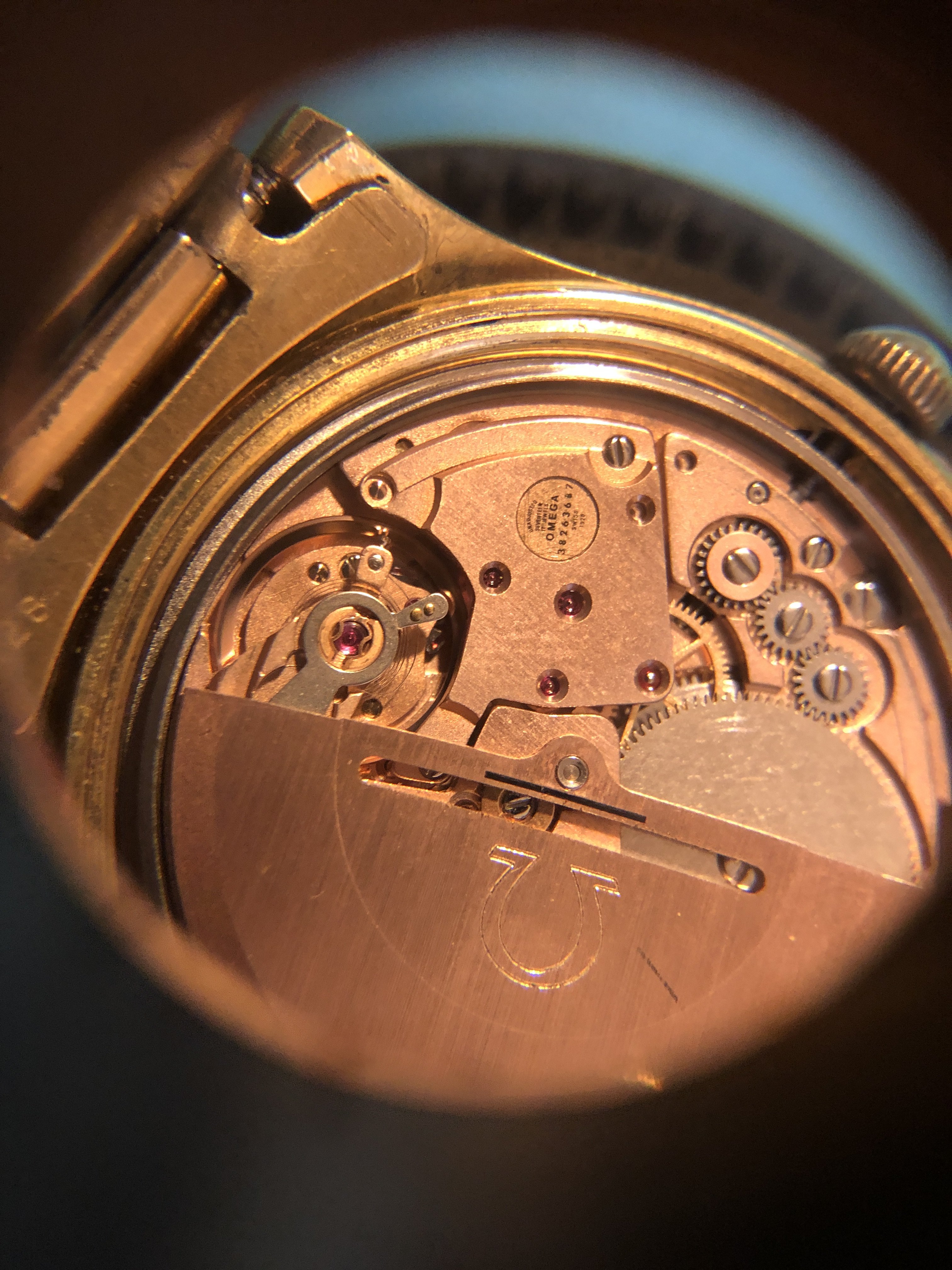

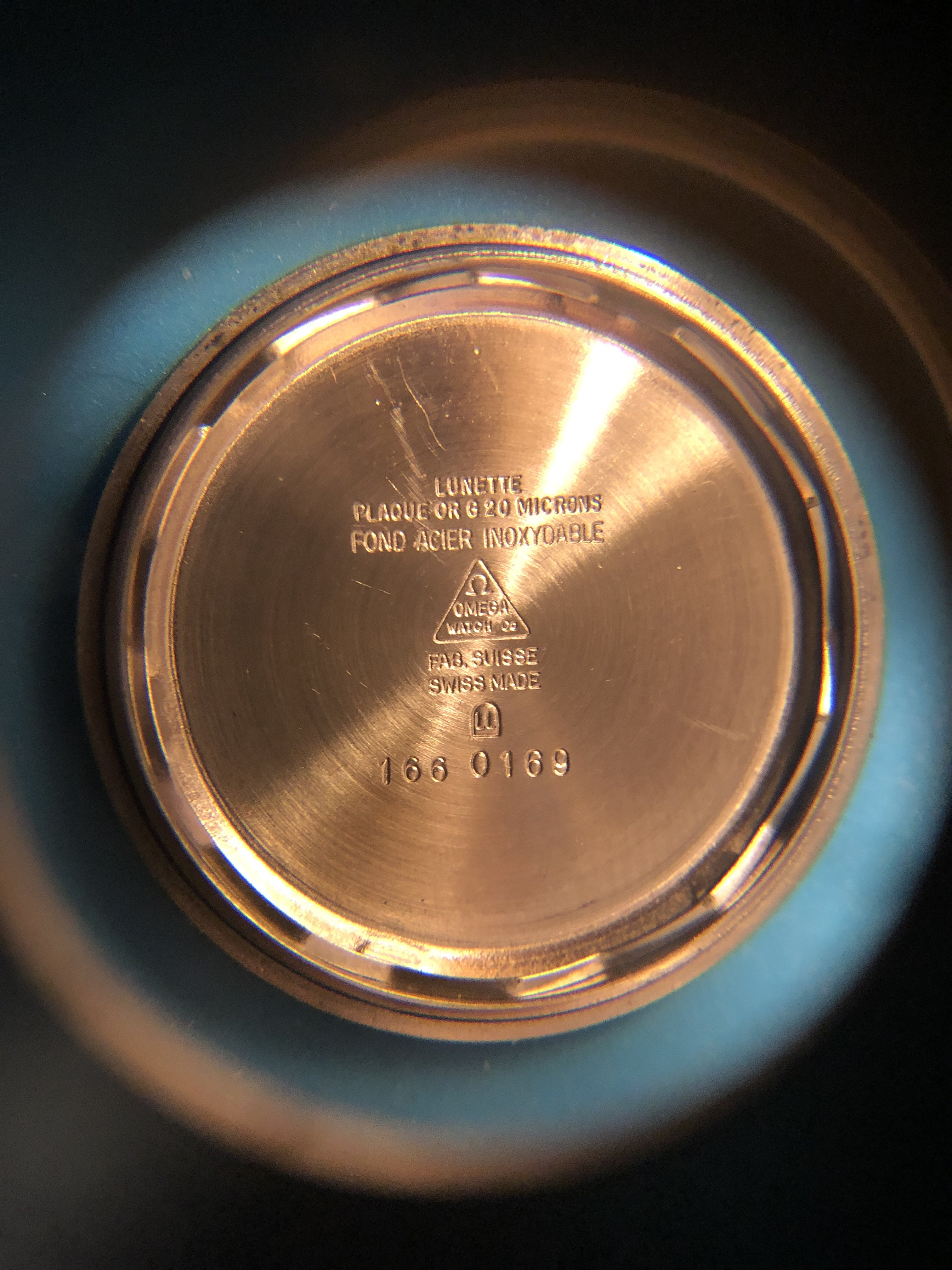

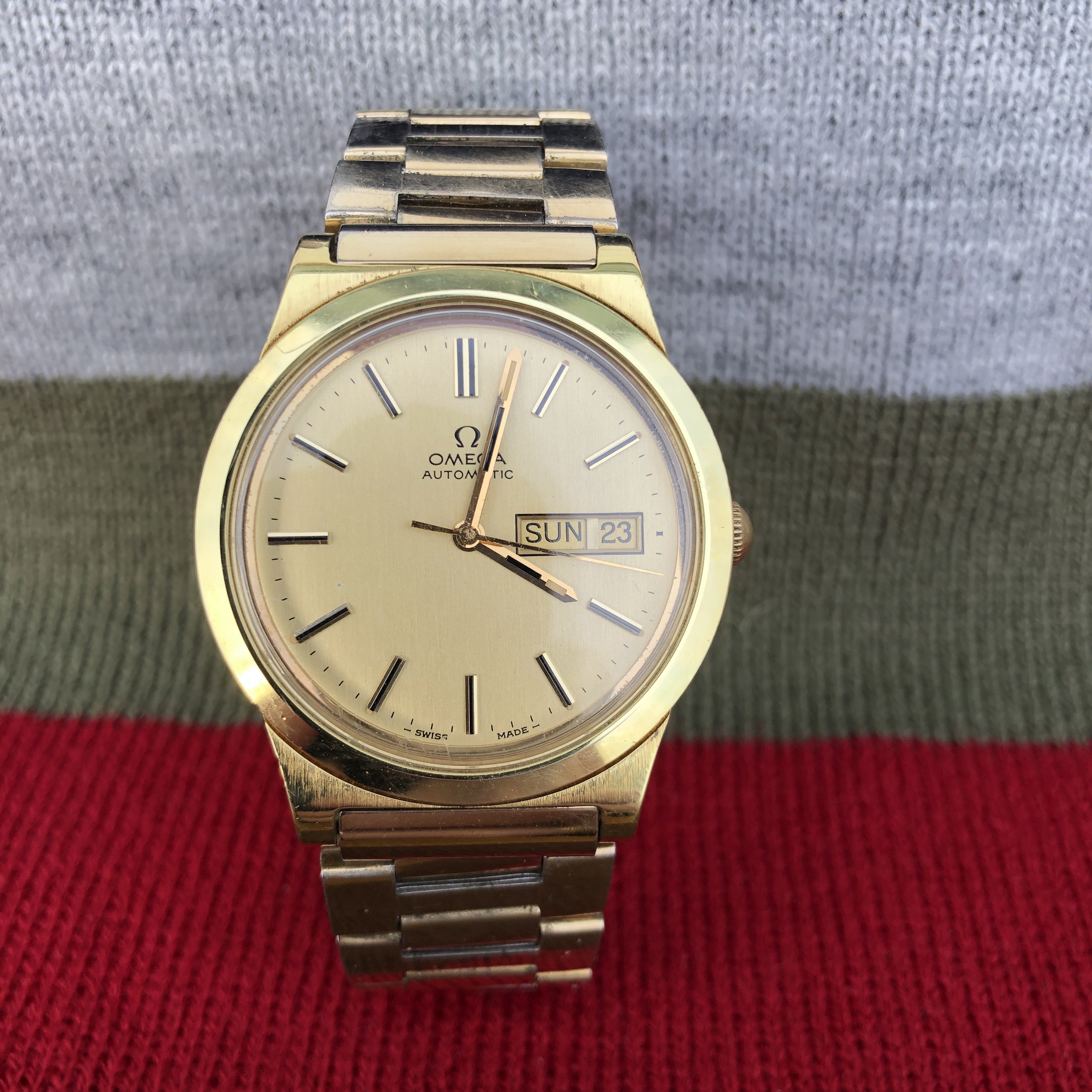

Hi all. I'm hoping someone can help! I have a 1974 Omega Auto Day Date. It has the 1020 movement. I purchased this watch some time back and when it came in, I immediately sent it to a watchmaker to have it cleaned, oiled, and regulated, and to have a new crown installed. Crown looked very worn when I received it. Anyway, I received the watch back and just happened to notice that it doesn't wind..., I mean, I know it's an automatic, and most can be manually wound to get it going, then the rotor does what it does. I honestly don't remember trying to wind it before I sent for service. Anyway, with this virus thing going around, I can't reach anyone at the jewelry store where I had it serviced. When I advance the crown should it wind? ... or is this movement like some of the old Seikos where only the rotor action will wind? Thanks for any help you can provide. Attaching some pics. --Andy

Maybe the reversing wheel is worn out and needs to be replaced. Most auto Omega's from this era I have ever handled don't wind manually because of this.

That watch can be wound manually. Give the crown 50 turns or so (you cannot overwind it), then wear it at least twelve hours per day, and keep a record of how long it is before it runs down and stops. Get back to us with the result. Perhaps then we may be better able to advise you.

I curious how the OP is determining that the movement isn't winding manually. Is it based on the feeling when he turns the crown, or based on the fact that when the mainspring is completely run down, he can't start the watch again by manual winding? Or something else?
Yes. You should hear it winding when you turn the crown clockwise in the position closest to the case. If you don't hear it winding, then it's likely that whoever serviced this didn't do the job properly.

When I wind it manually, there is no resistance and no winding sound. After the watch has been sitting, and the reserve is exhausted, I can pick up the watch and wind it 50 turns, and it doesn't run. Then, I'll give it a shake, and it will start running for a minute or two and stop. When I wear it continuously...it works great. And re: jewelry store, they do not have a watchmaker on staff. They send it out. I had actually approached this watchmaker to see if he could service some watches for me, and he was so busy, he could not take on any new clients. He sent me to the jeweler he works for. Anyway, sounds like this Omega should wind if turned, so maybe I will approach the watchmaker directly to see if he can fix it. Thanks for your help! - Andy
