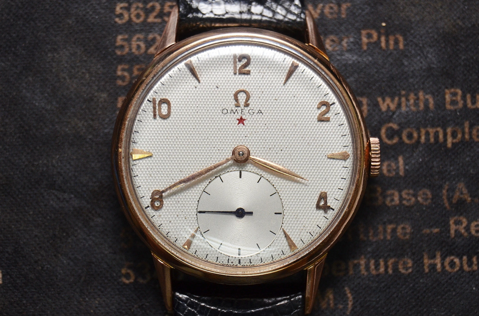

Ive recently bought this watch for $2000.
It is an Omega 18k rose gold, metal indices, honeycomb dial with 30T2 movement from 1944 (it also got the red star)
I know the combination of the above (especially the small seconds in a circle, the 12,2,4,8,10 instead of the regular 12,3,9 and the honeycomb together) is rare. I have found almost none of them out there, and seen identical one before for more than double of that.

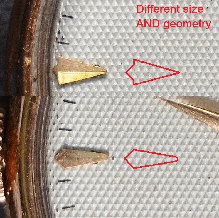

The point is that it was listed as factory original dial, which it is not.
The only eye poking "defects" are the indices of 3 and especially 9. The rest is minor but you can clearly see the dial hd been refinished in some sort.

Keep in mind i can get the indices replaced to ones original to the design one day.

Whole watch:
Replaced indices:

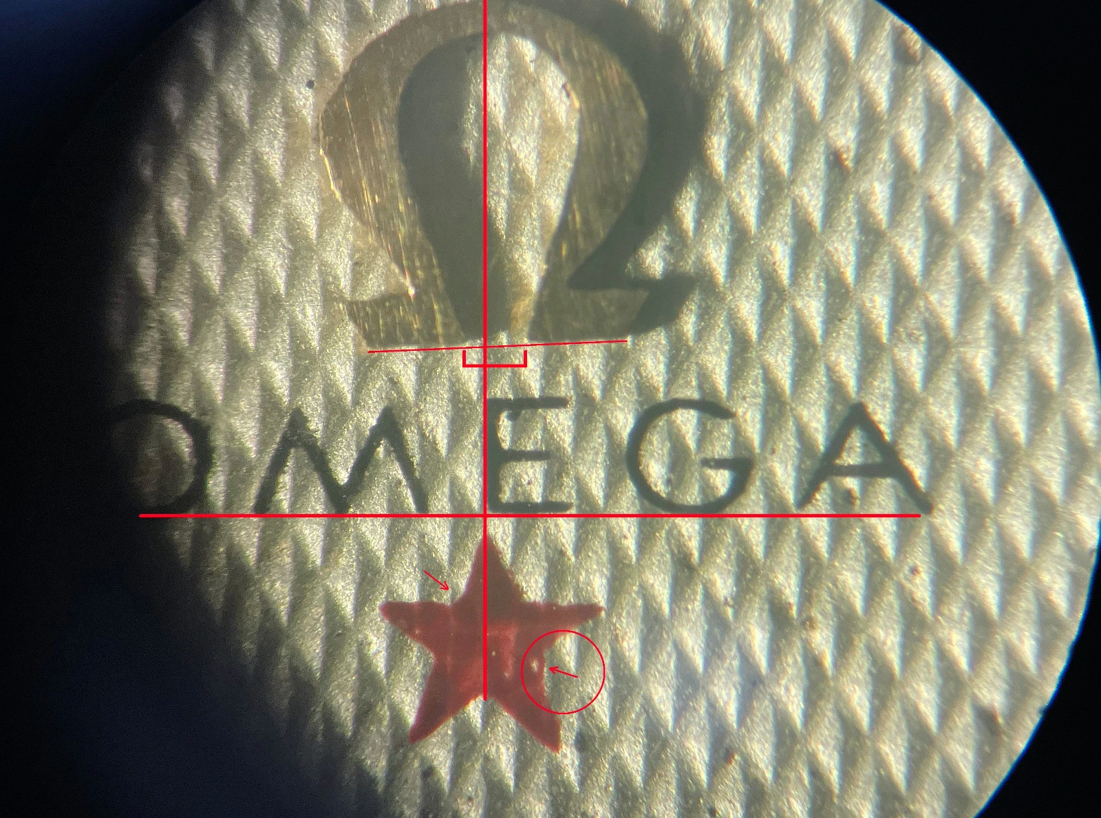

I guess the dial had been restored...

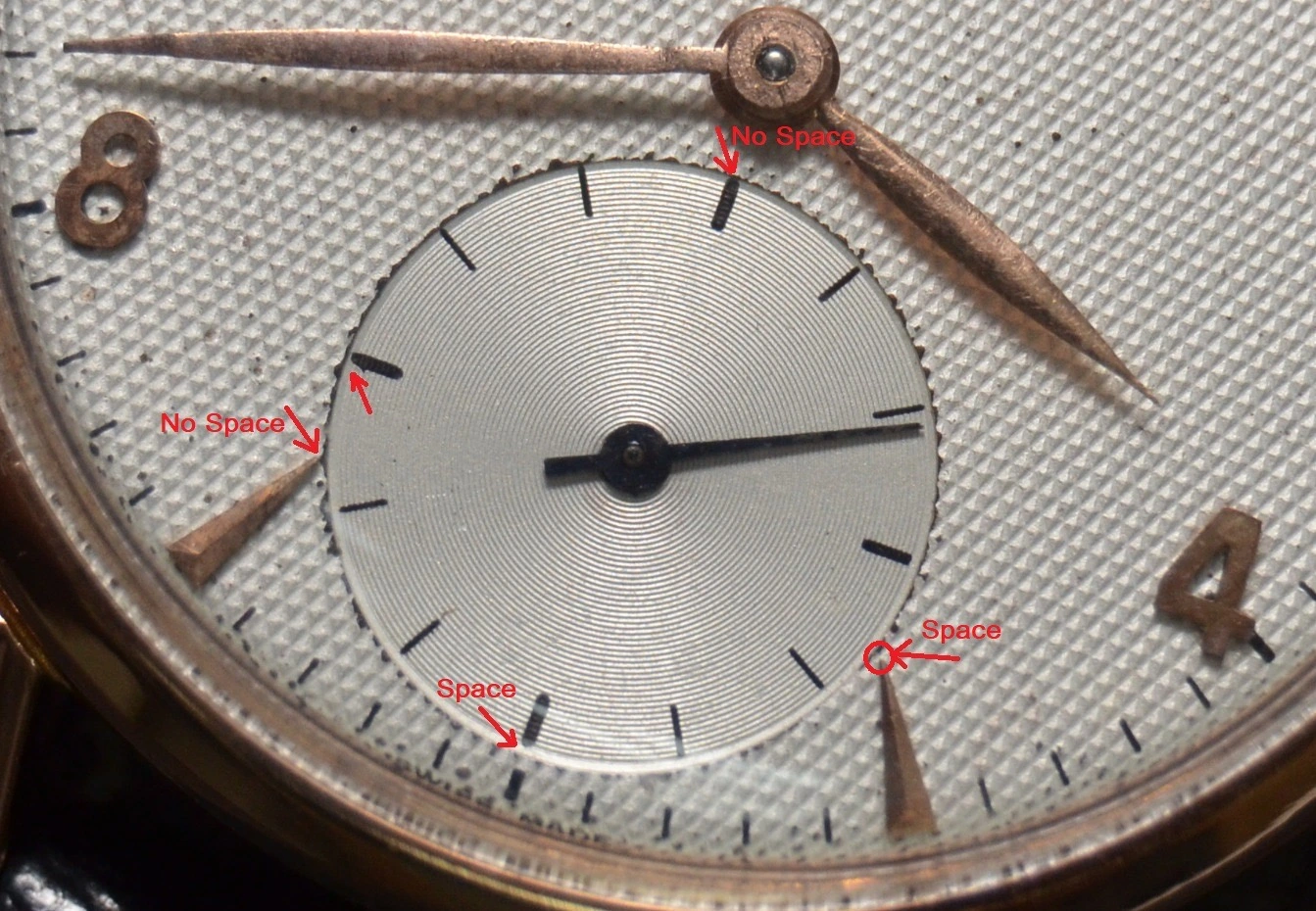

Not sure if paranoid, but this popped up as well:

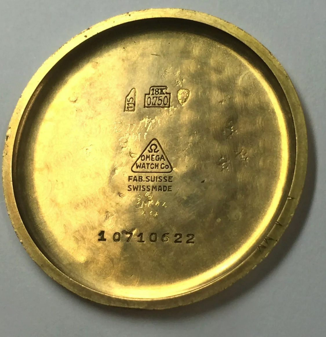

PS if anybody knows the reference - that would be cool. I couldn't find any, but I've understood it is common for the era.

To be totally candid, I'm immediately seeing a poorly repainted dial and I wouldn't look twice at it.

Hi @davidavid6 and welcome to the forum. This vintage Omega forum is comprised of vintage watch collectors who prize originality above all else. As you yourself observed, the dial has been restored. That means the watch is no longer original, and is not desirable at any price.

You’re likely close to the scrap gold value with the partial refund. Weigh the watch, subtract 18g and multiple by the scrap gold value, which is about $90USD/g. Add $100-200 for the movement. That’s the approximate value of the watch.

Return ASAP it's neither attractive, good value for money nor a worthy restoration candidate.
