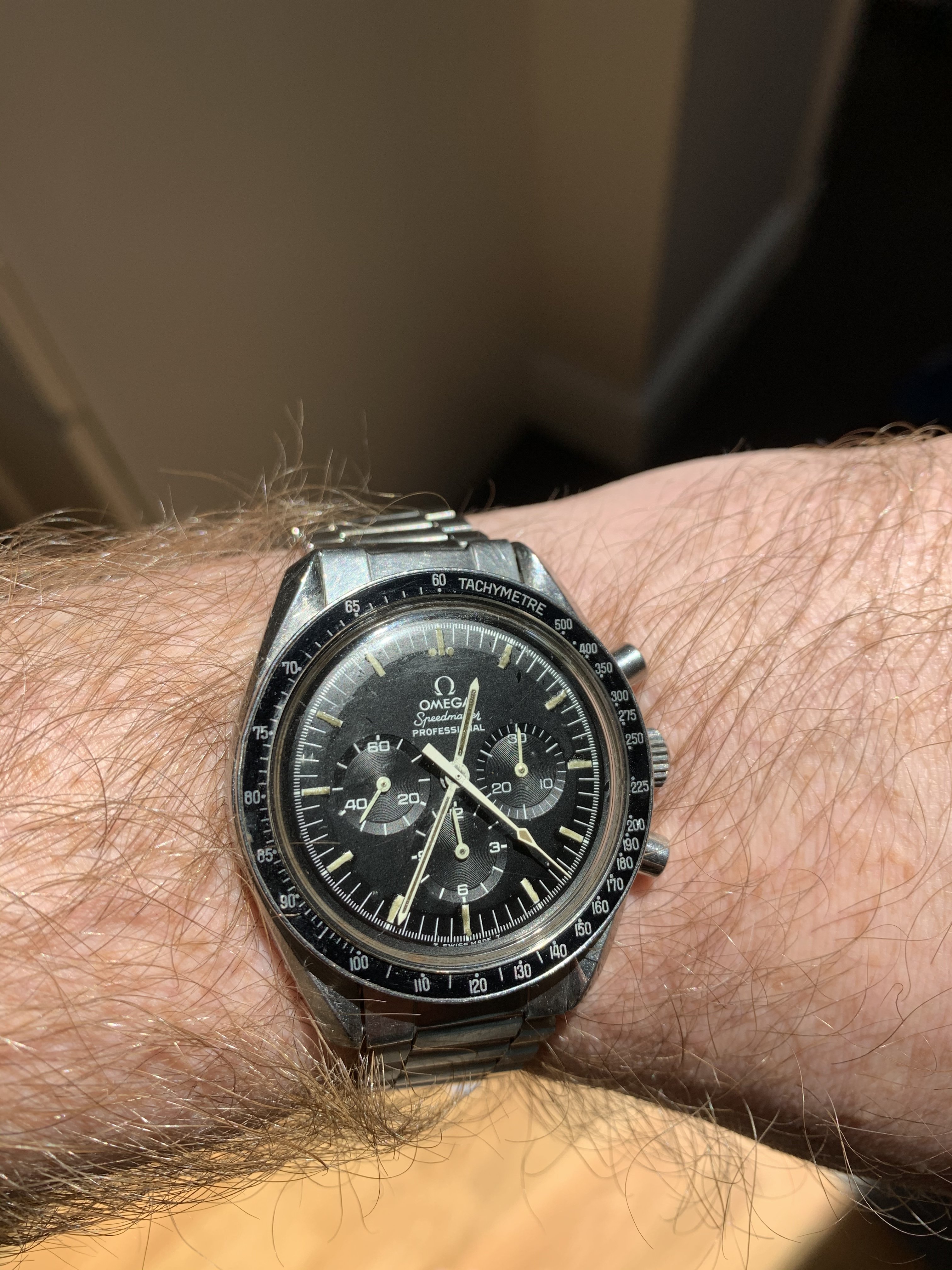

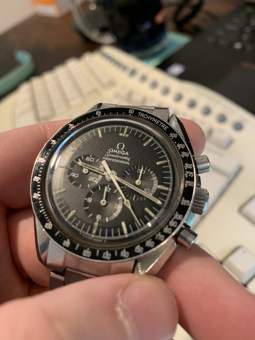

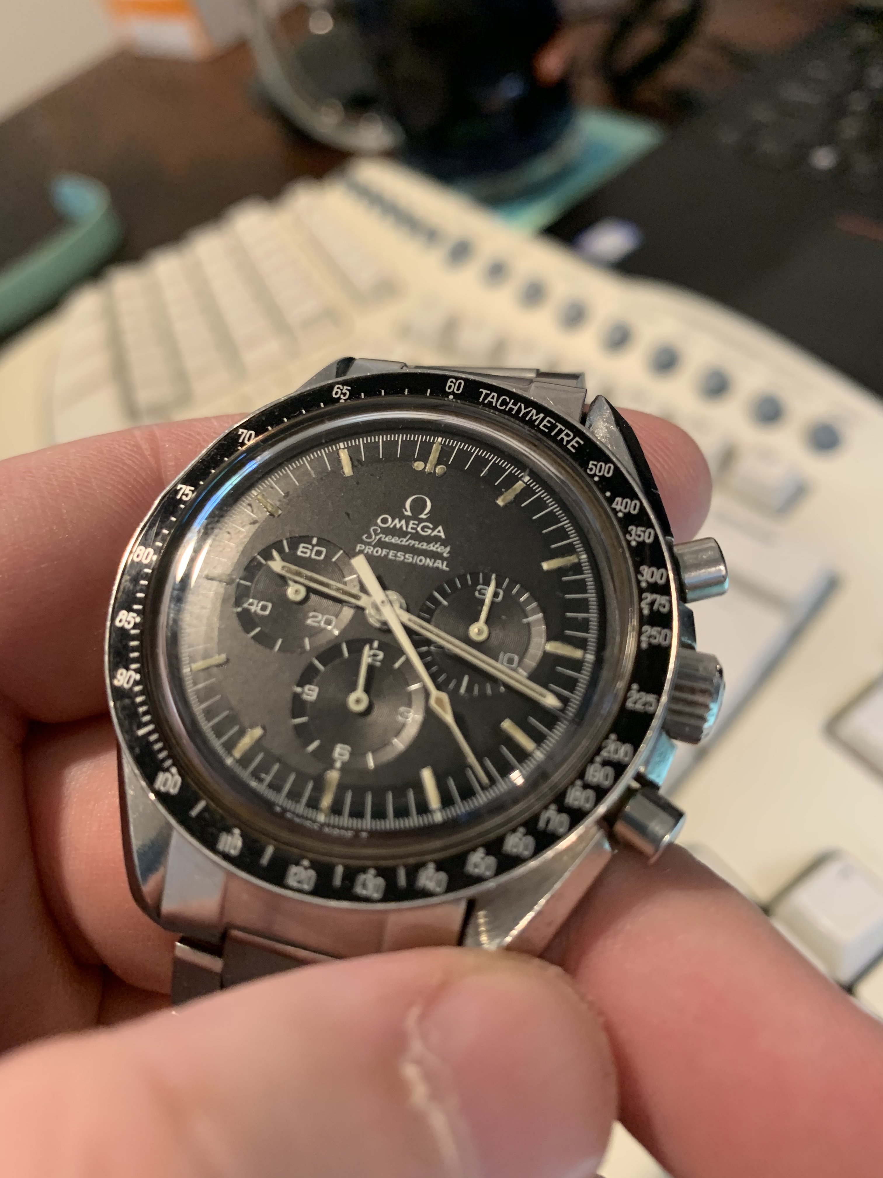

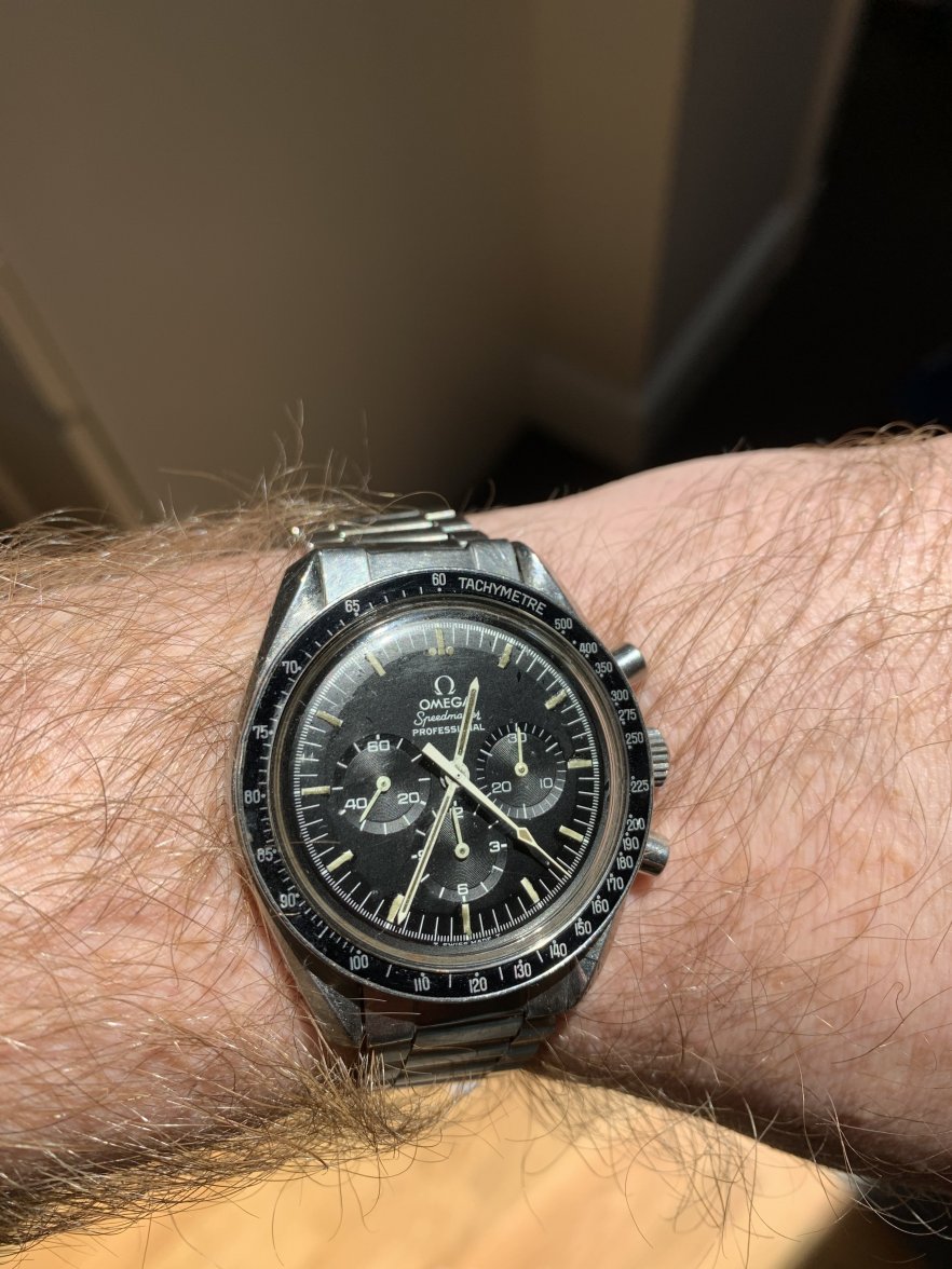

I’ve been looking at todays daily wearer and it seems to my eyes to be much shinier than others I’ve seen.
I’m curious if this is a known effect seen in some dials?

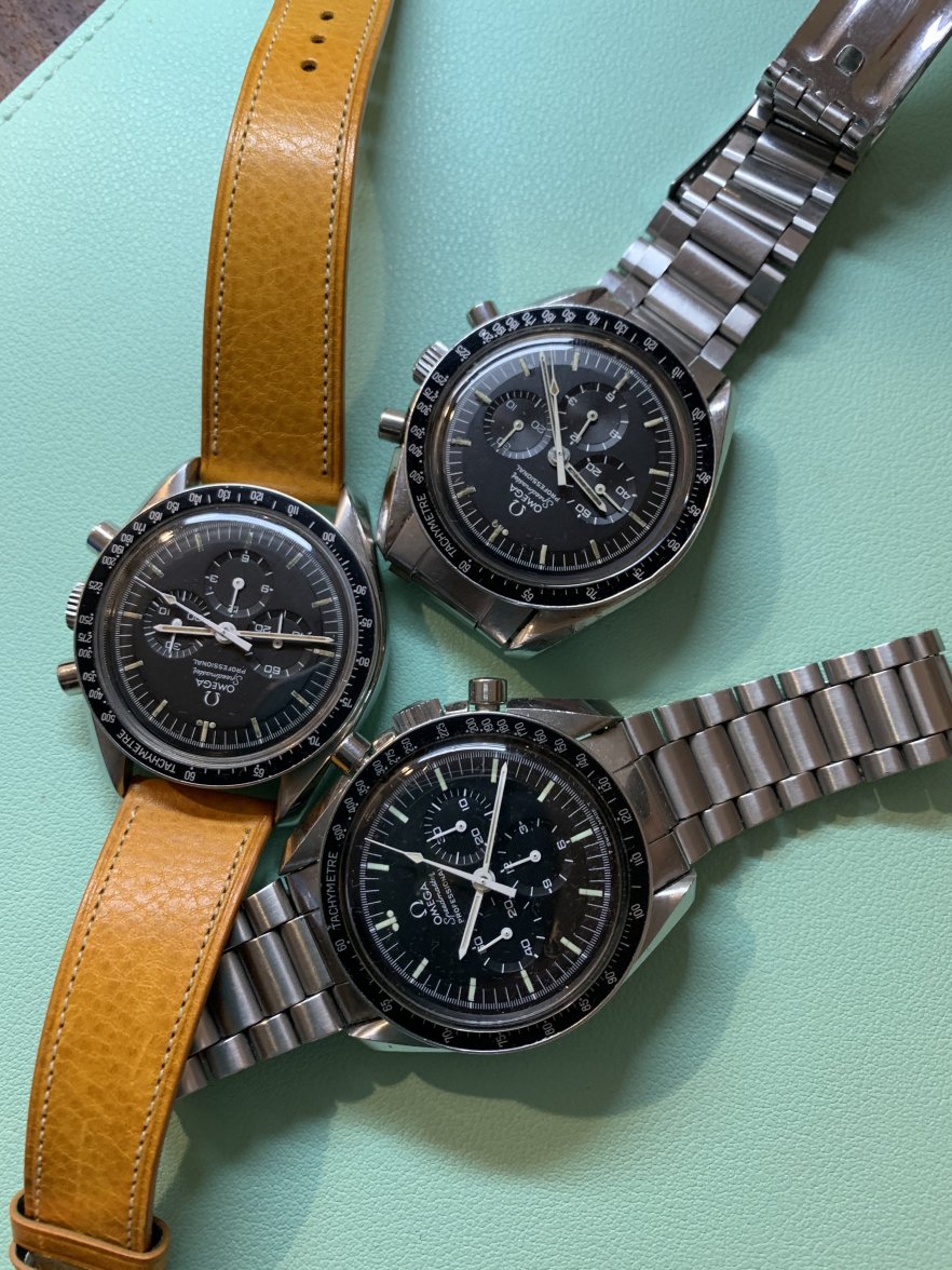

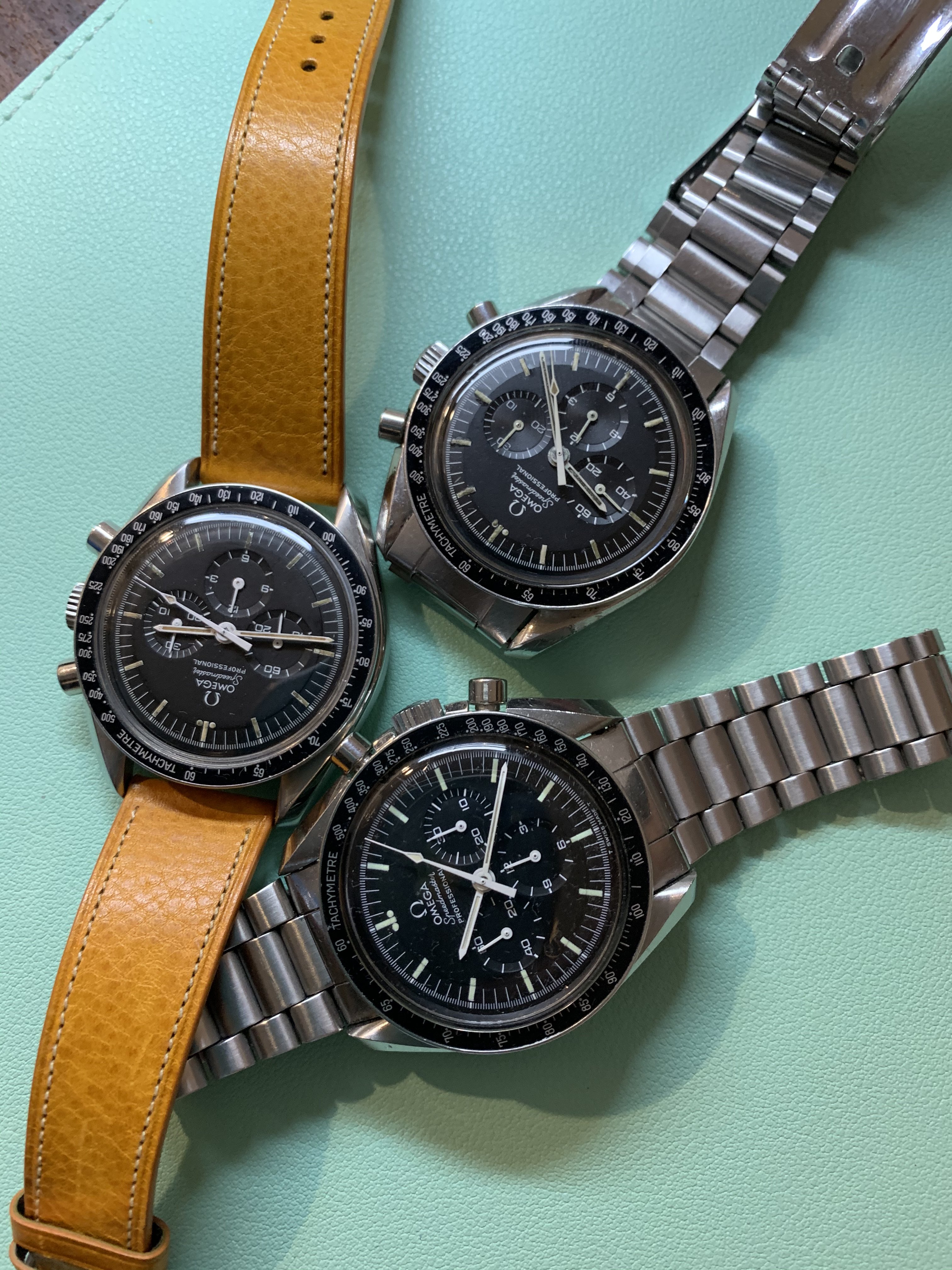

Compared with a 71 and 74 (with step) it’s very different indeed.
The lume on the hands and plots seems off, perhaps stabilized in the past. Is it conceivable that someone decided to apply something to the dial to make it shine more? Any observed this before?

Sorry I don't know much about things like lume stabilisation, and am waiting for the experts to chime in. But from the second photo it almost looks like it could be a famed soleil dial in the making? Any idea if the dial was replaced a long time ago?

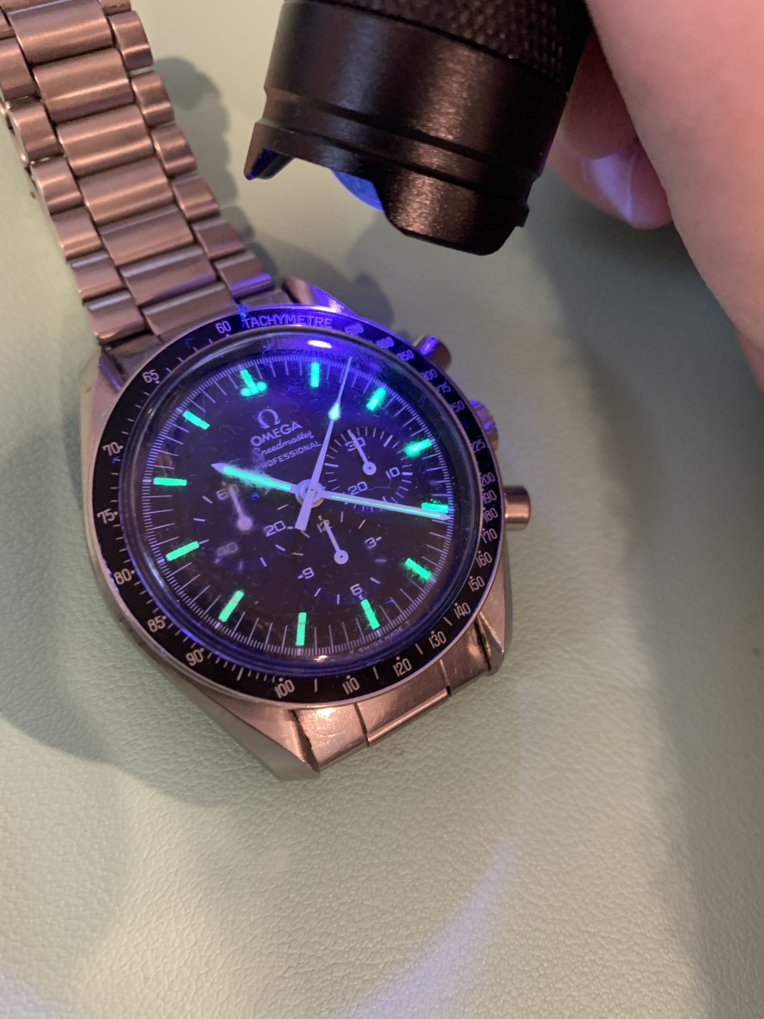

No idea on the dial being replaced. When I found it the Chrono hand was incorrect so I had a watchmaker replace that for me.

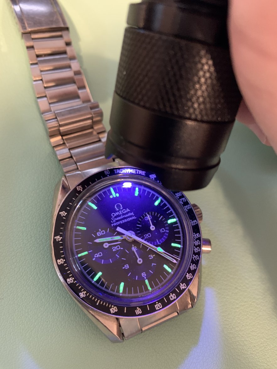

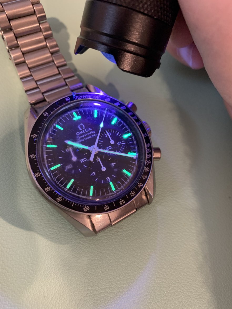

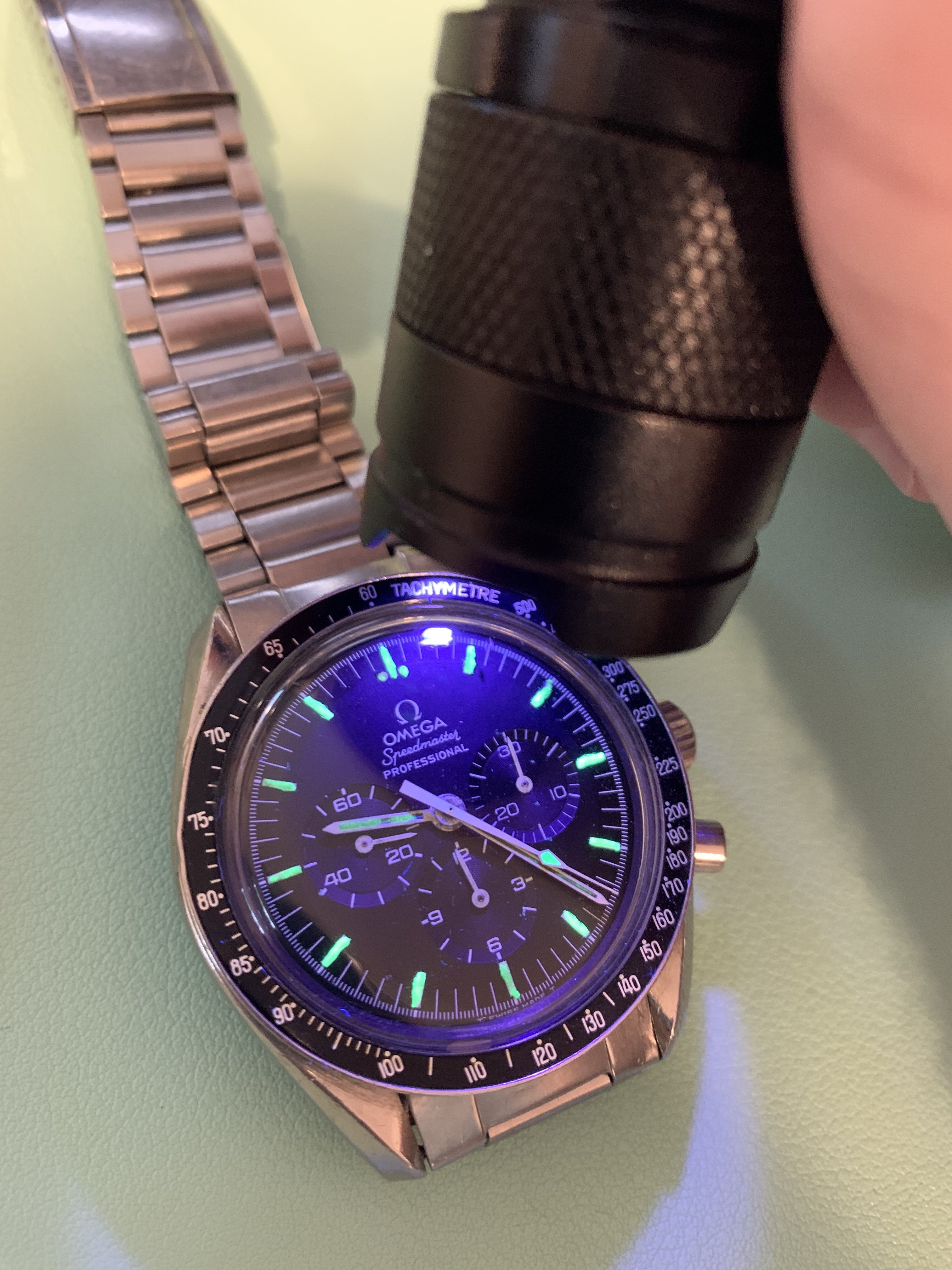

Adding some B/L shots of that helps with identification in any way. Watch showing 920 is the dial in question. The other is a diff 74 for comparison.

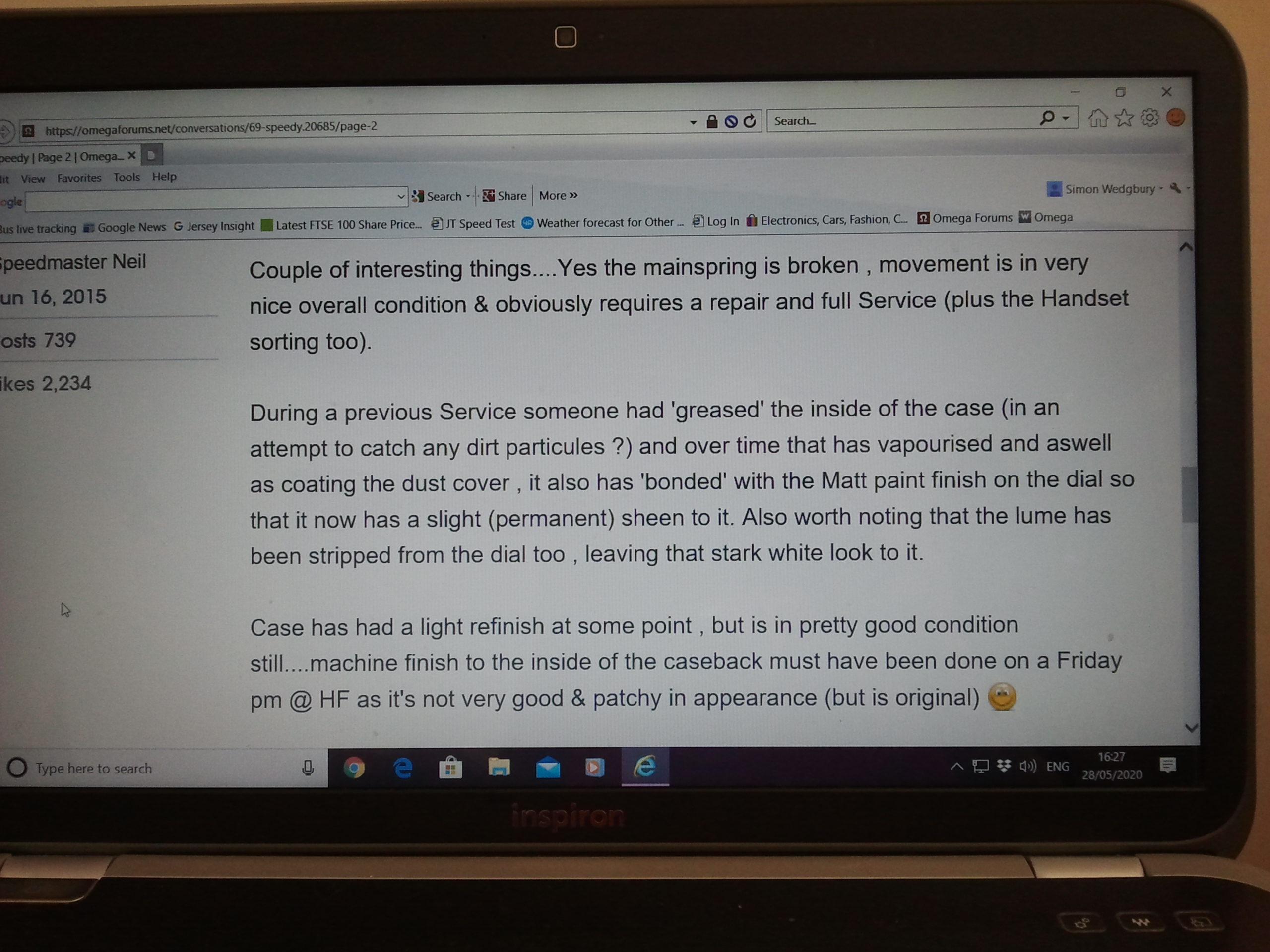

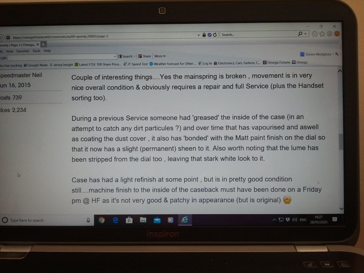

I had a 69 with the exact same sheen to the dial.
It was suggested by a watchmaker that it was a reaction to a certain oil used during a service.

Vapourized grease that "bonded" to the dial. First I've ever heard of that...will have to dig into this.

I don't know if it's relevant, but the watchmaker is the go to choice for vintage Speedmaster servicing in the UK for serious collectors.
