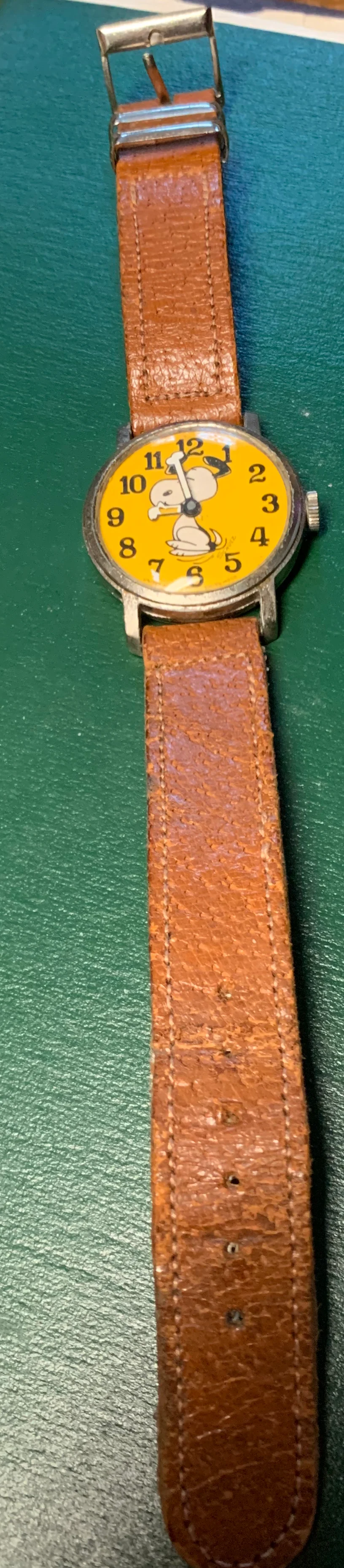

I finally got the yellow snoopy strap sewn back together. Probably would have made more sense to cut a new strap, but I really like the old leather. Glued in some reinforcement with barge cement. I did one of the sides months ago. Took a while to get around to the buckle side.
I also still need to clean the movement. Somewhere I have one of these snoopy watches with a black dial and a new home made strap. I seem to have misplaced it as I had it somewhere where I was going to show it off at the maker faire back in October. Amazing how quick the time files, we are already mostly through the Dickens fair.

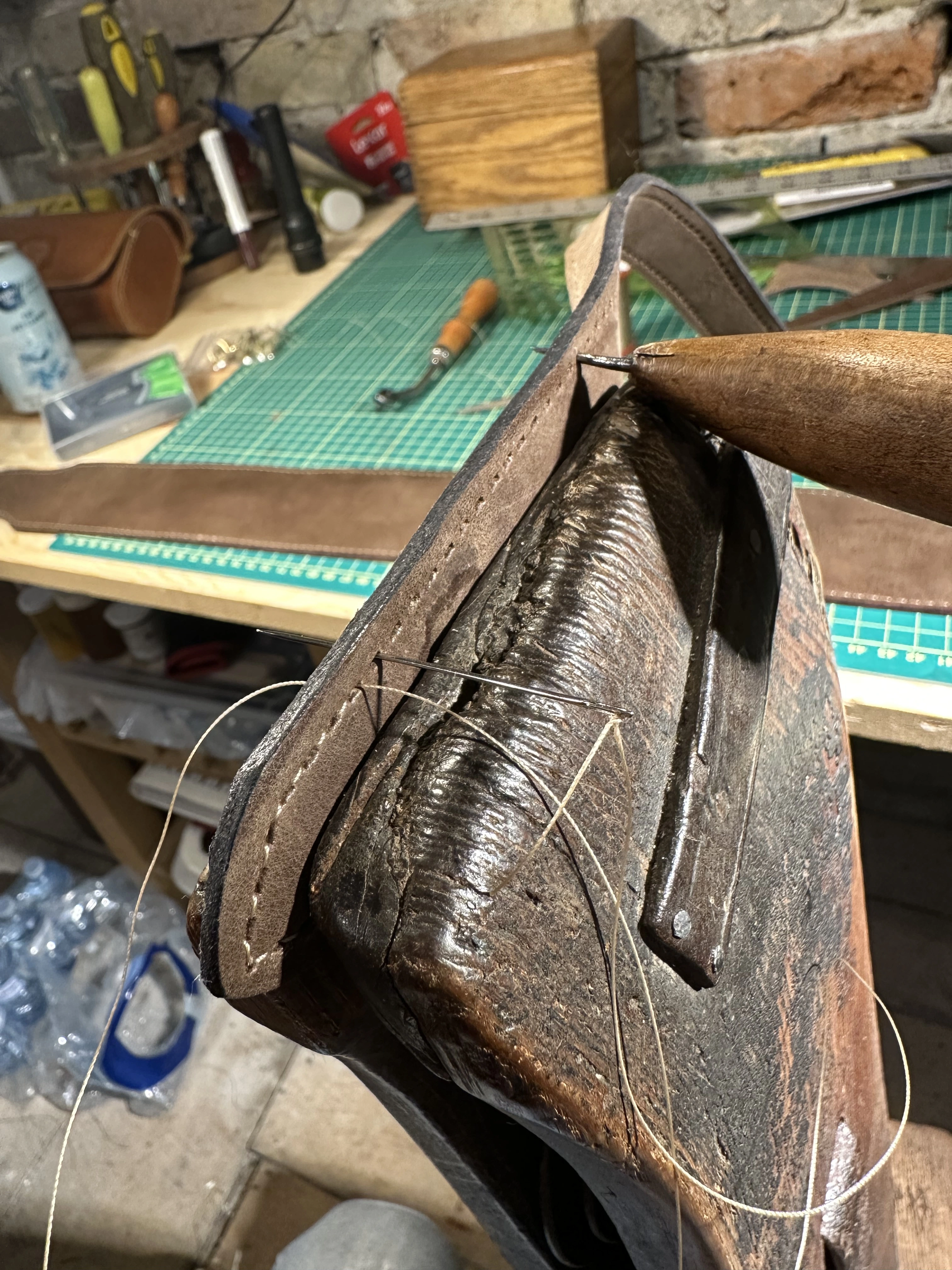

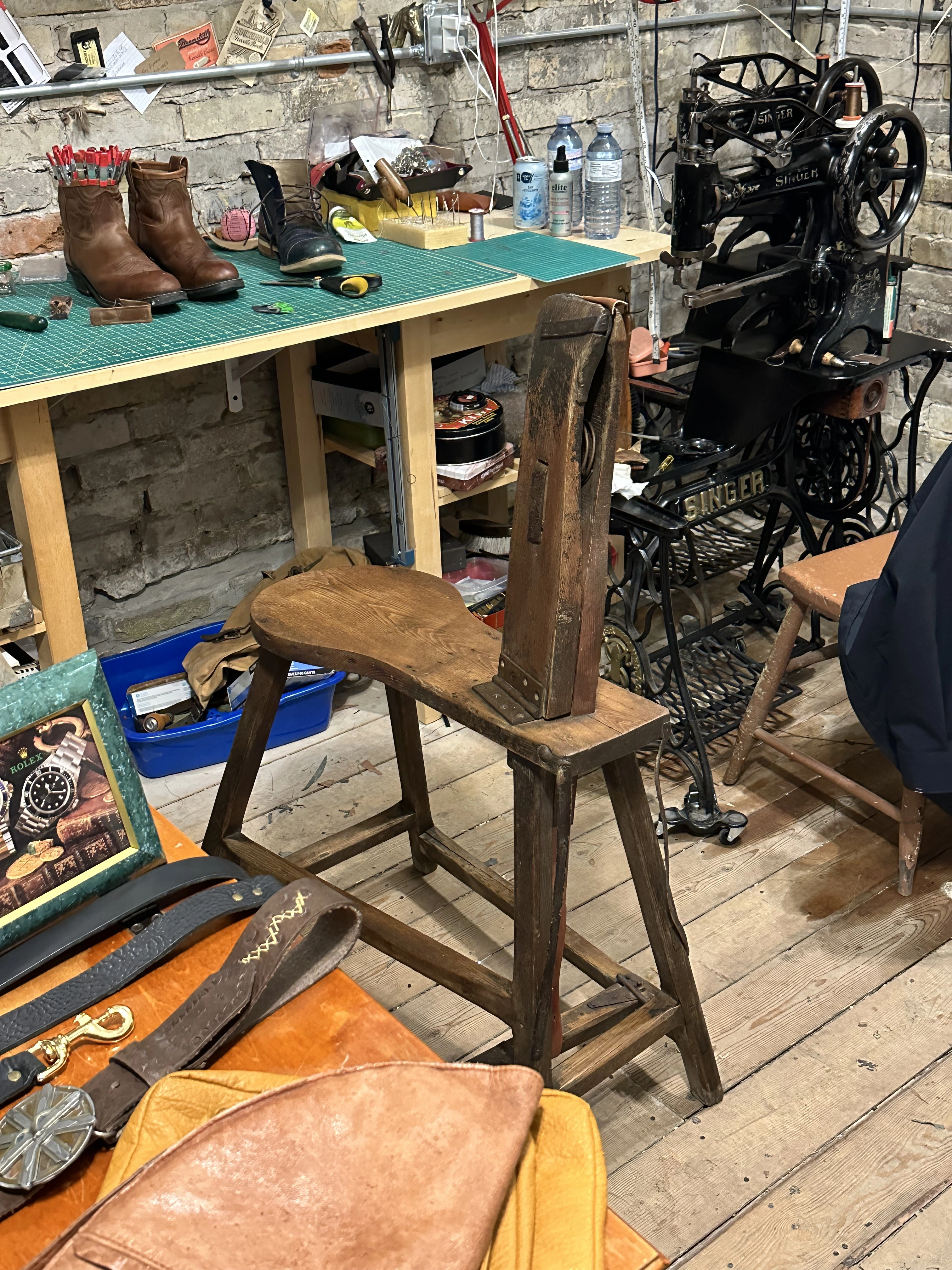

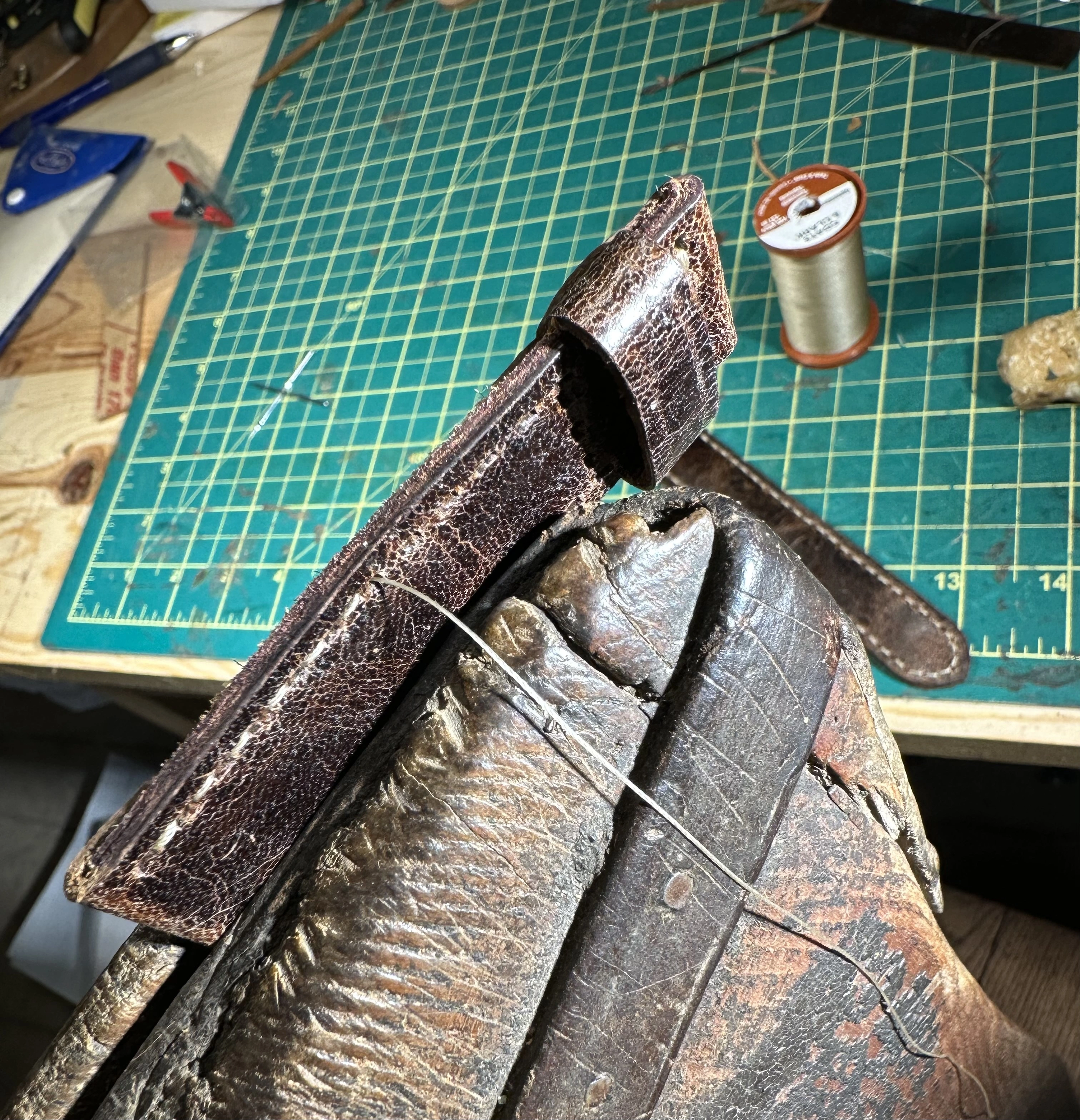

A few months ago I picked up a 19th century stitching horse.
Needed a bit of work but now it works as intended, and looks just right next to some Singer machines from the same time period.
A few pics of some of the jobs done on the old horse.

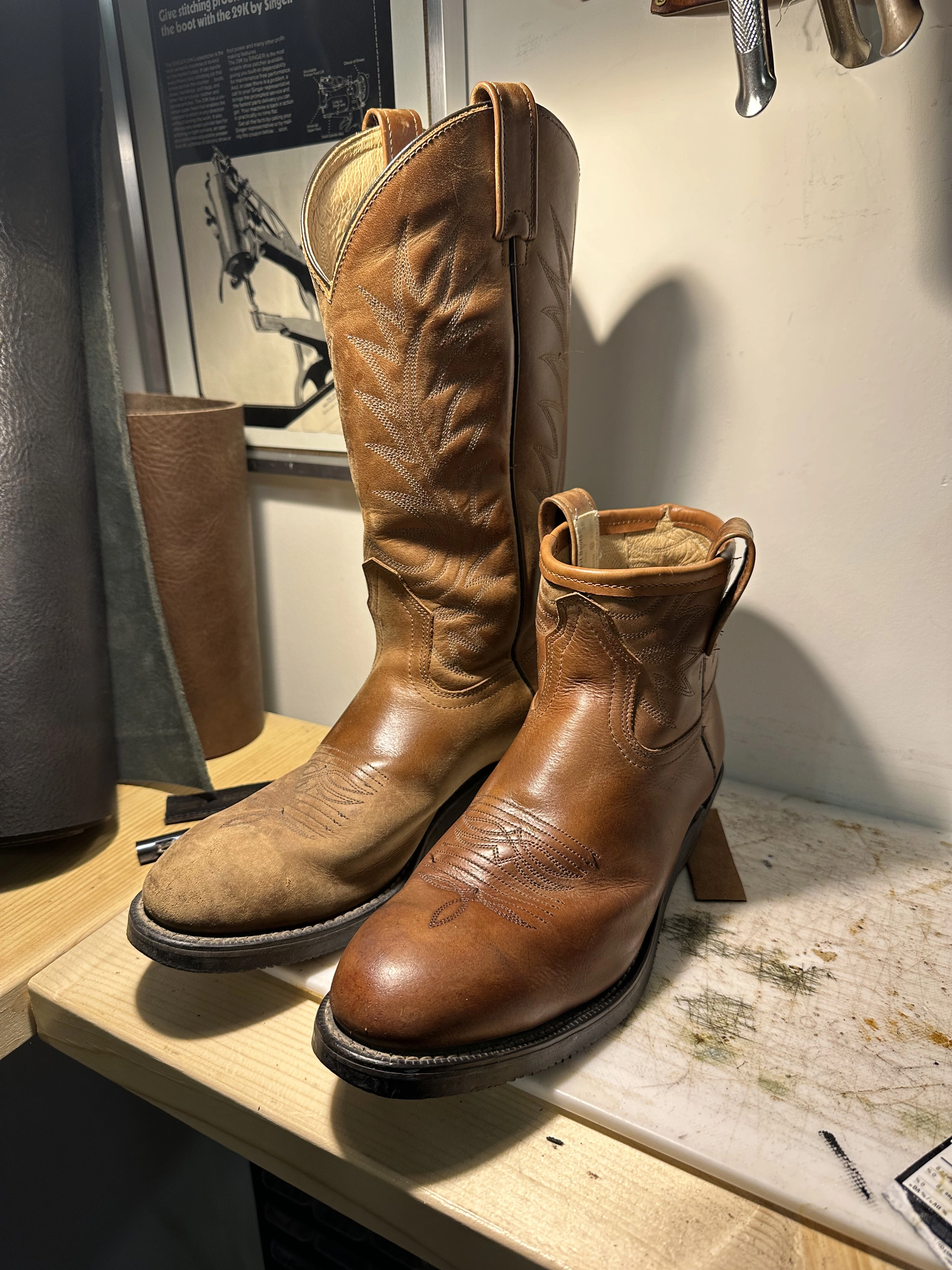

Steve, I thought the boot on the farthest left was being used by you as a pen holder until I took a closer look.
3,300
33,977

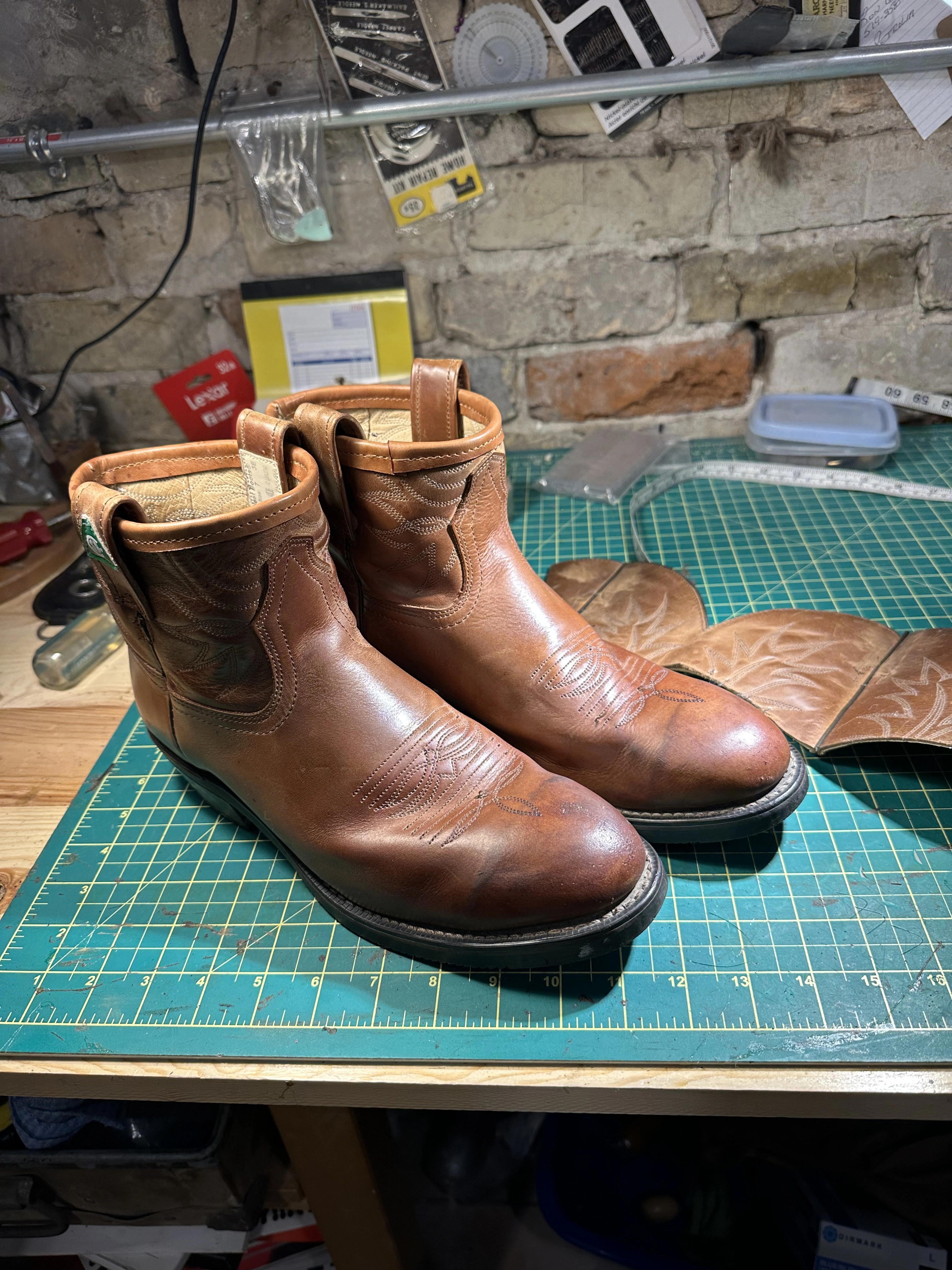

Jim. Cowboy boots (not the nice ones from Alberta or from @TexOmega ) that the owner wanted shortened. In his 80s and this is what he wanted. What you see are clamps that were holding a glued piece of leather. The boots were done on one of the old Singer 29s pictured.
443
2,081
I never thought shortening cowboy boots was even possible Steve, great job! And the boot leather looks so revitalized.

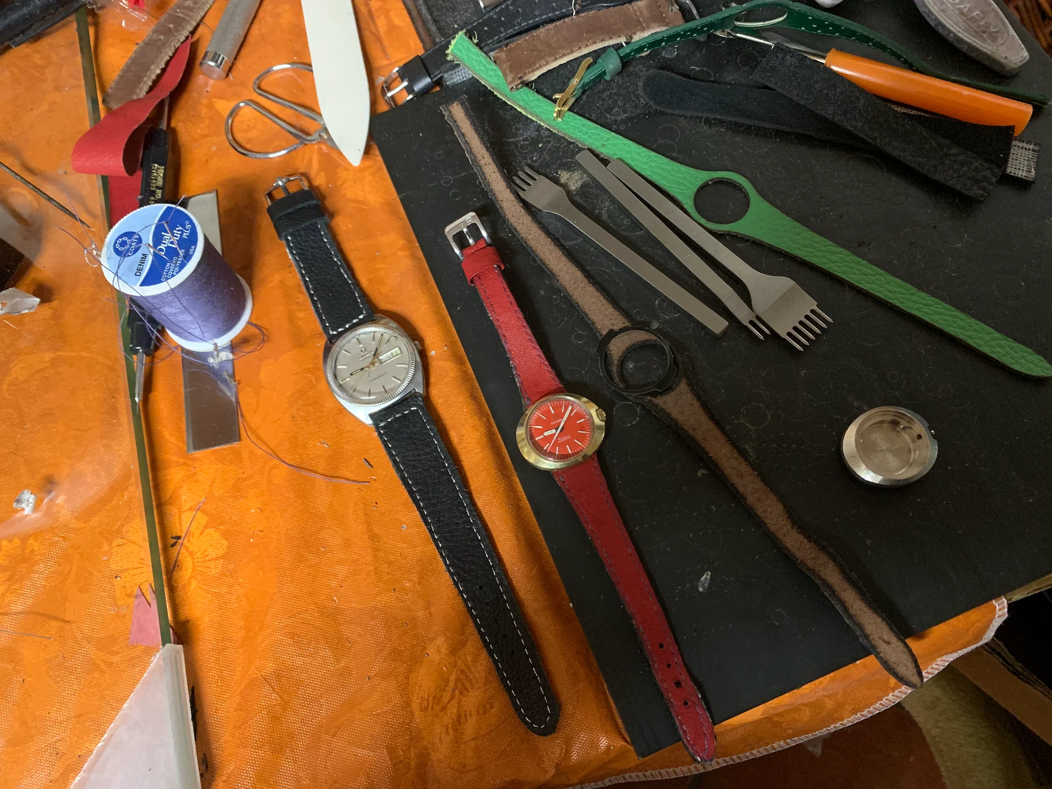

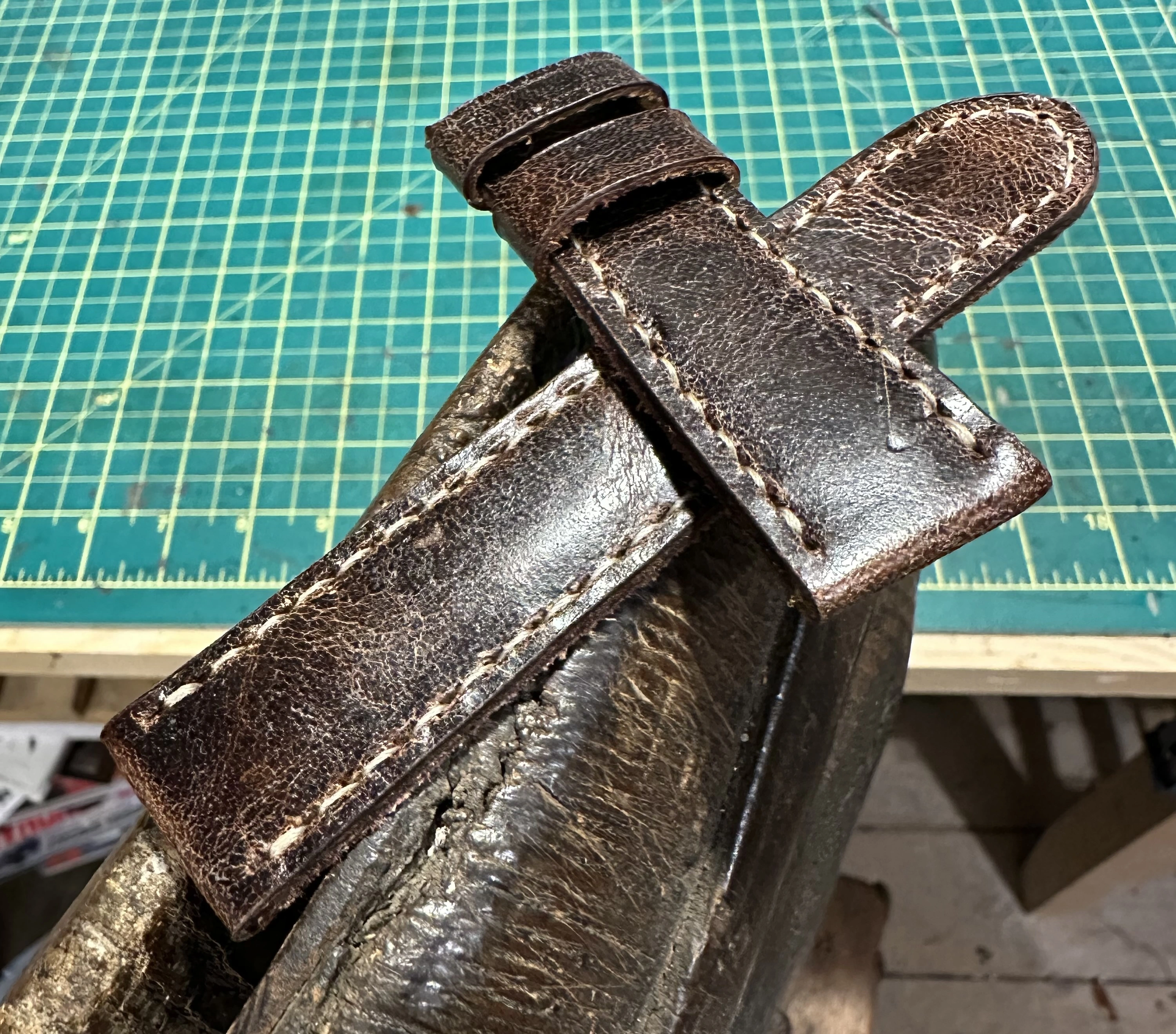

Finally after months of sitting on the table I got the first set of laser cut watch straps sewn.
The Quartz Connie looks like it will be a lot of fun. This is a 1354 made from 'parts.' I even found an acceptable Omega buckle. Decided to use some metallic silver embroidery thread for the stitching. Sort of makes it look lik a British 'pearley' outline, although without the buttons.
The ladies Geneve dynamic is also made from 'parts.' I wanted and original green strap for a different watch. This was the first strap I cut from some scraps of pipe organ leather. As these things are wont to do I wound up getting a bunch of scrap leather from a big box hobby store. This strap is a bit on the shorter side although I am finding it quite comfortable. I also got it a bit thin.
Now I am going to need to make a watch roll, as tossing these in the box seems not the best way to store them.

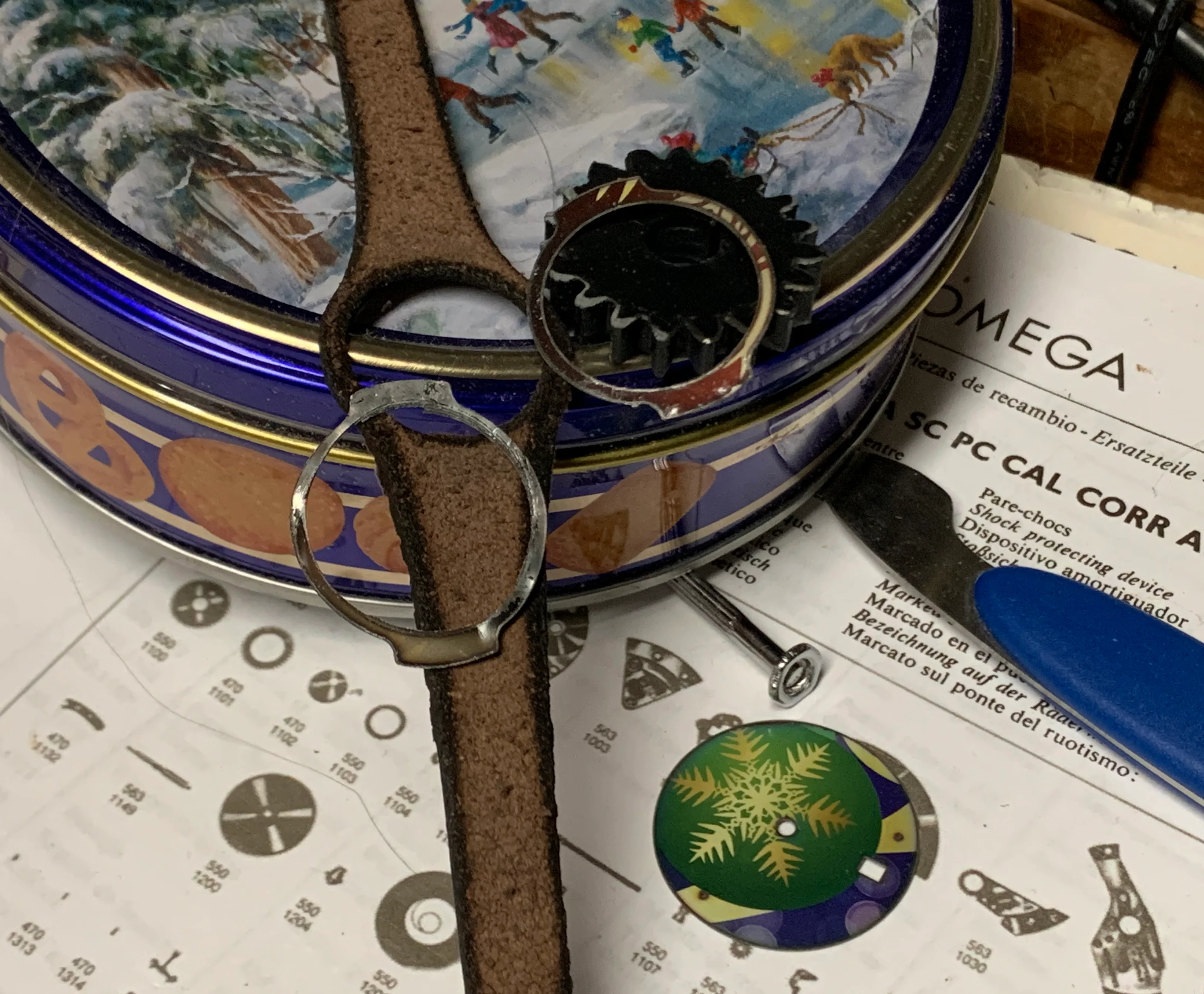

Procrastinating posting this. Made some strap reinforcement pieces out of an old Christmas biscuit tin. The other one had snowflake ornaments on the top. So I cut out a dyle blank since I had the template already in the program. Was getting little sheet metal circles scraps, which looked a bit like dials.
Probably should try cutting some watch hands.
I really do not recommend attempting to work on half a dozen watches at the same time. They are a bit like spoiled children, and one does not know which one to give focus and attention to. So none of them get the attention they deserve.

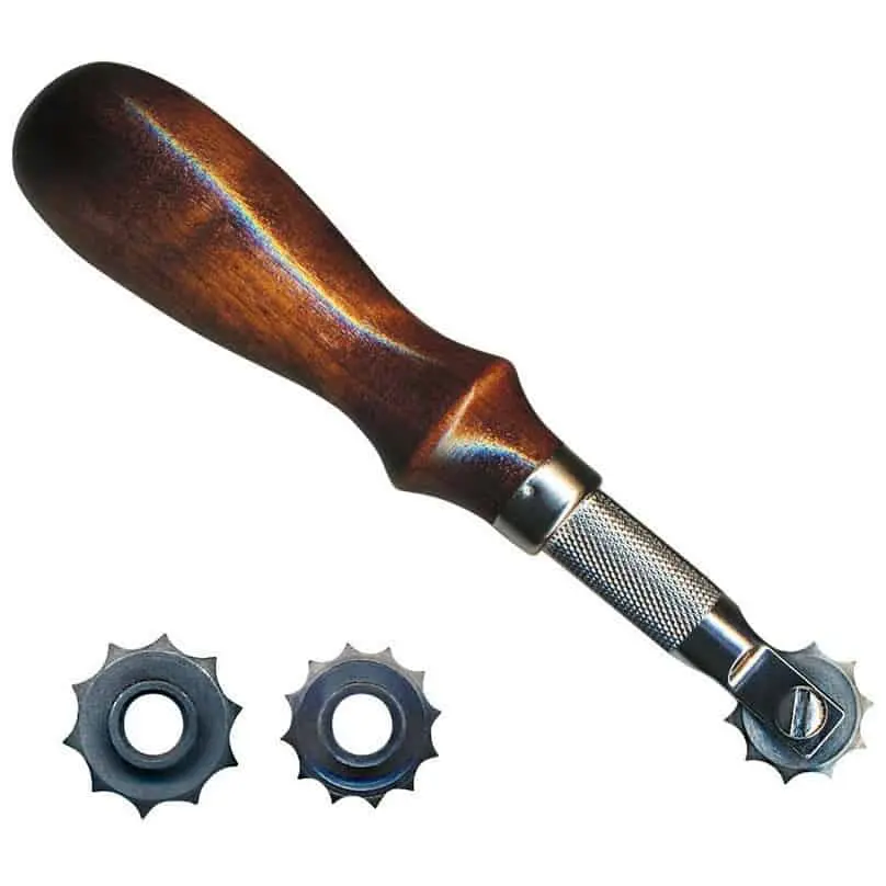

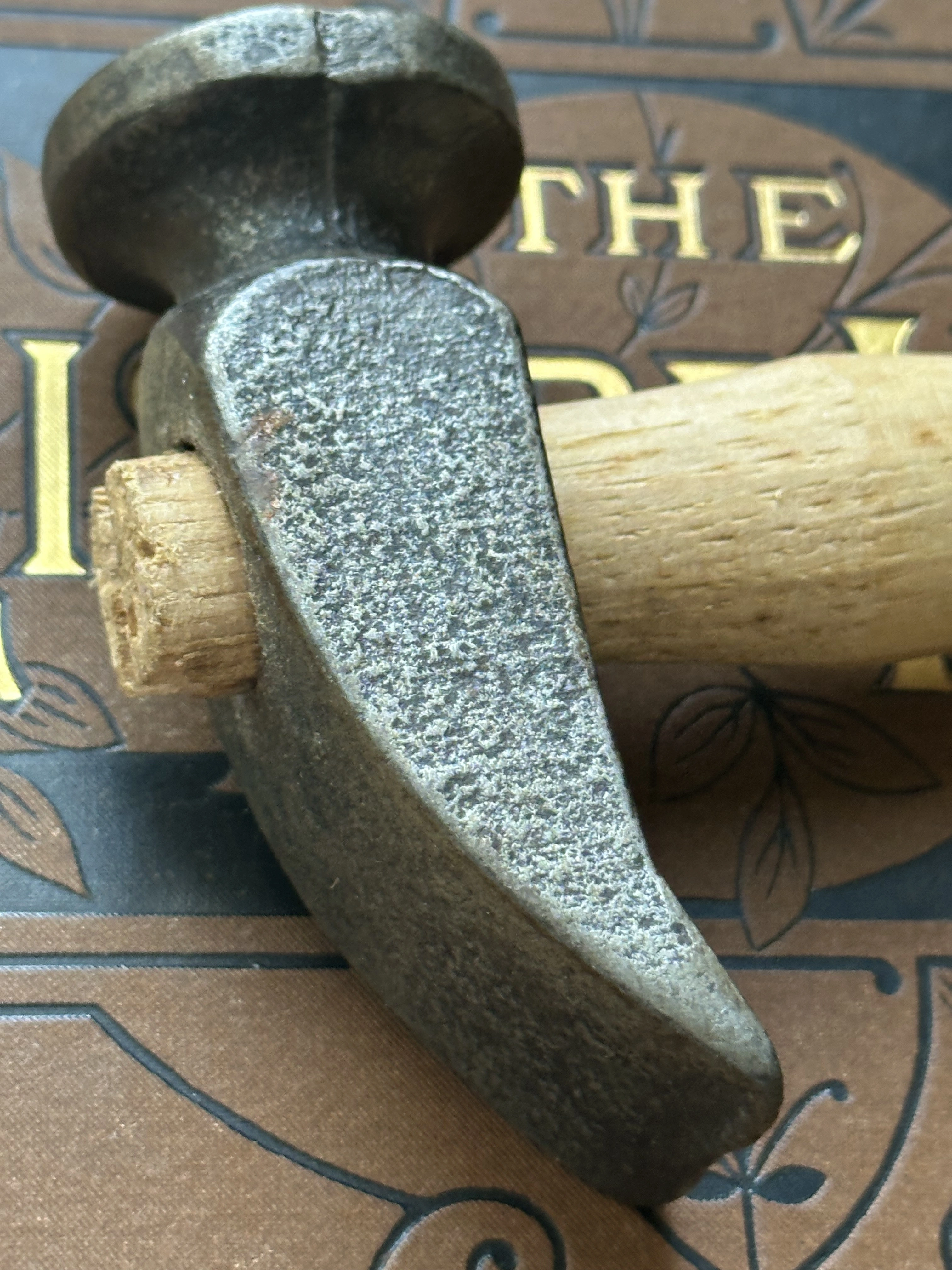

Do you guys use an "overstich weel" on the seams after sewing? It really helps me get the seams look better.
3,300
33,977
No. I press down on my work with the flat part of my hammer’s peen.
I do the same as Duracuir1, my hammer is a small one I have that I used to use for light nailing in walls. I had to sand the head though because it was leaving marks on my leather. Not as ideal as a flat head hammer like Steve but the darn things are so expensive from what I've seen at least.
Can you show me a picture of your overstitch wheel? I thought they are for making holes in leather, not flattening stitching.
3,204
9,616
I use it to mark the stiching holes befor I use an awl, then after stiching I run it over again. That seats the stitch in the groove and straightens the seam.
443
2,081
Thanks, it's what I thought it would be, but aren't you worried about the sharp edges poking through the thread and possibly cutting it?
3,204
9,616
They aren`t that sharp I never had a problem with that. They dont poke holes in the leather either, just makes a nice stitch groove.
