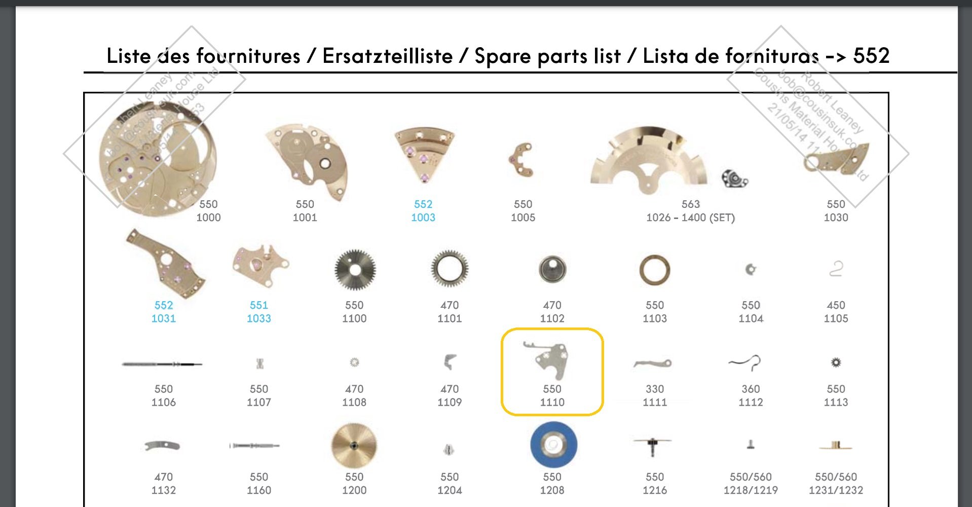

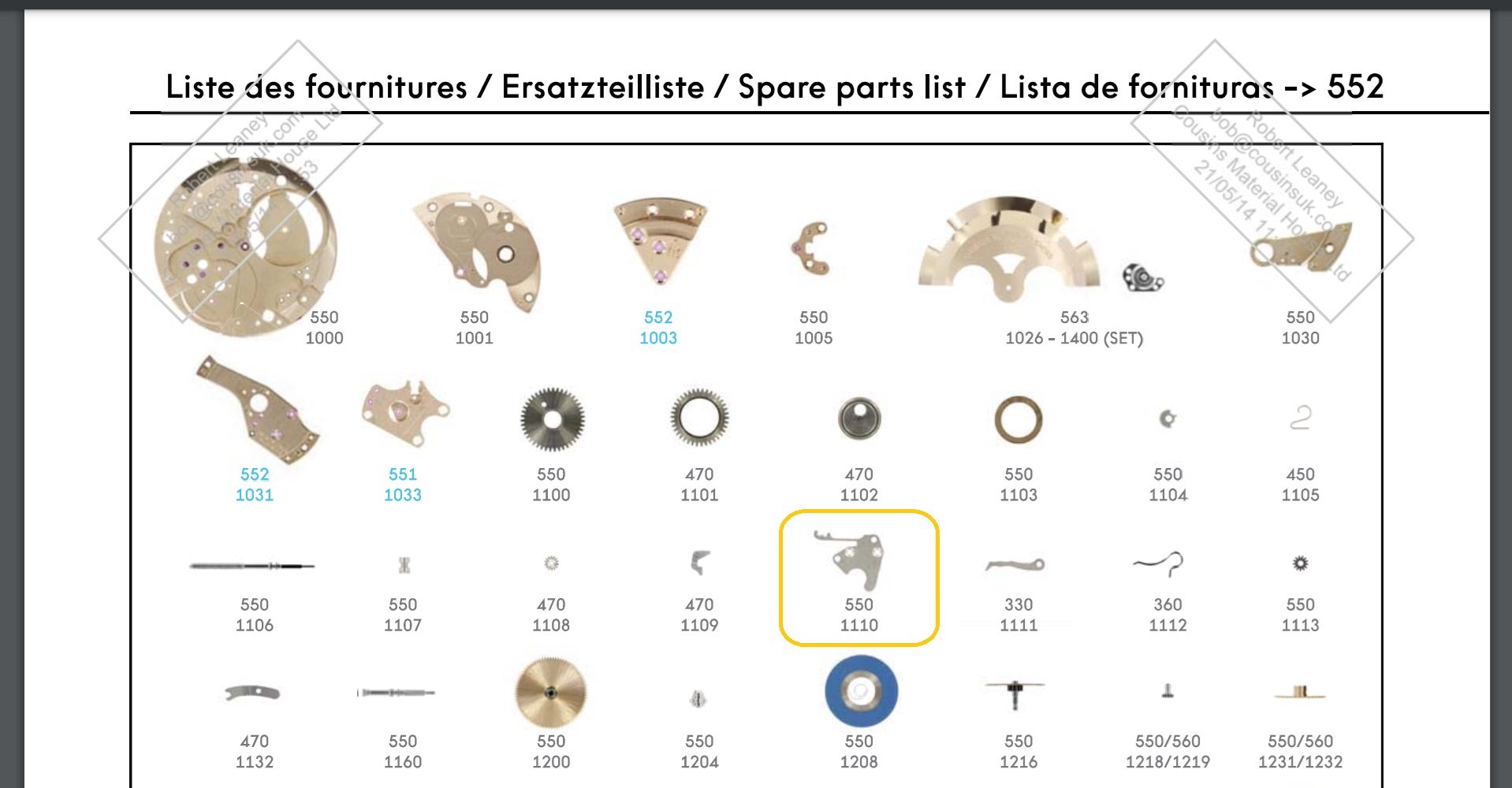

Cousins.co.uk offers a nice spec sheet look-up service;
https://www.cousinsuk.com/document/category/omega-movement-parts
"omega 552" search returns;
https://www.cousinsuk.com/PDF/categories/365_Omega 552 NewLR.pdf
And this shows the 2-notch part you need for the 552;
