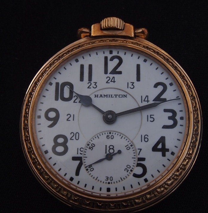

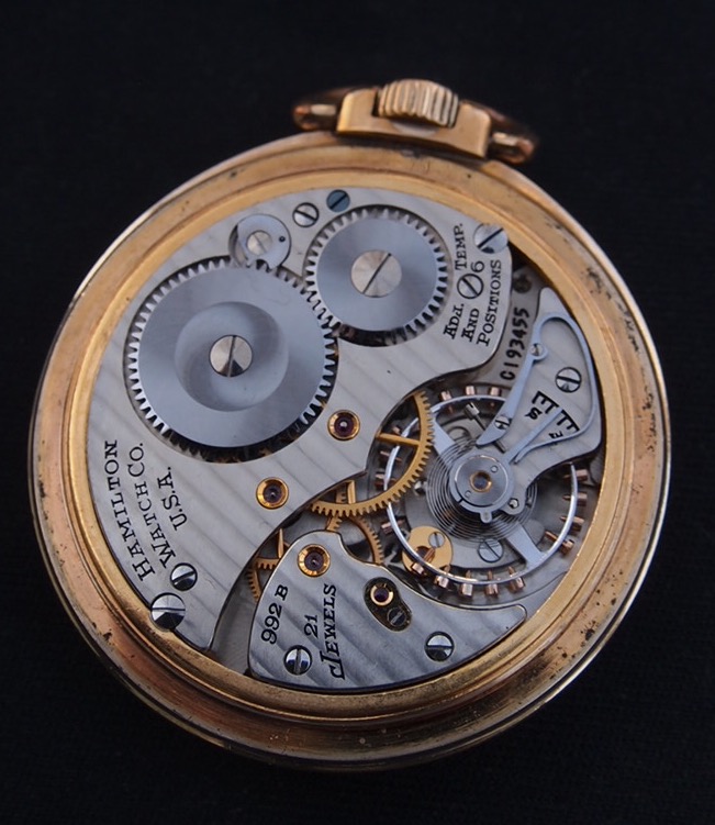

The last 992B I bought was in a model 2 gold filled case in nice condition, and had a mint 24-hour, double-sunk vitreous enamel dial. The movement had been well maintained, and all I did was to clean it, and replace the plastic crystal with a glass one. I paid $275.00 (Cdn.) for it! That's $204.05 US. Nice thing about it was that it found me. If you can find one for a price like that, I'd consider the subject watch to be for parts, only.

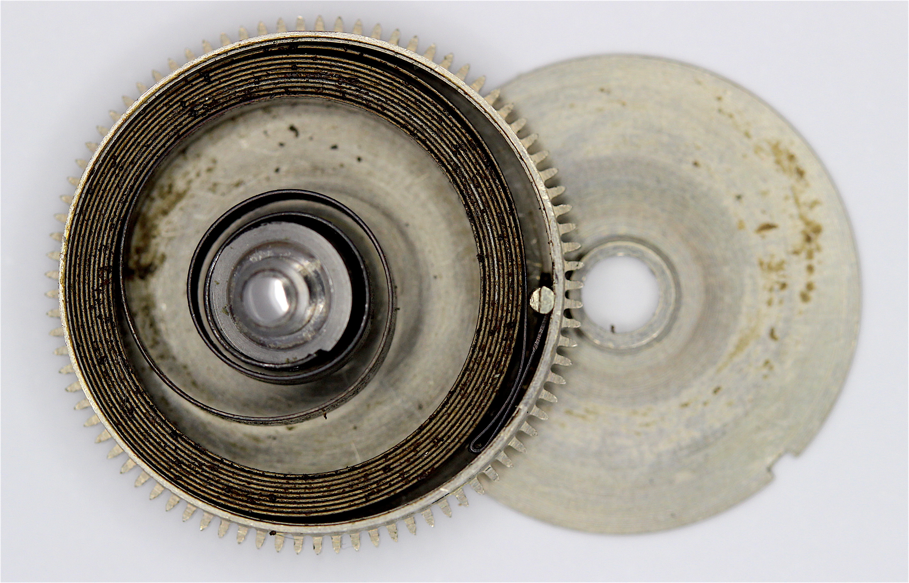

So after locking the Hamilton away in a drawer for a few days, I pulled it out again to commence restoration.
Not in the mood to do a great deal, I thought I'd just focus on the barrel and mainspring.
A sharpened brass wire was used to remove traces of superglue from the mainspring tail slot and other areas inside the barrel. After a good clean in WD40 using a small stiff brush, I put the barrel on a post and onto the lathe to polish thewall and the top (inside) of the barrel to remove gouges etc that could cause the mainspring to catch or drag. Then the same was done to the barrel cover.
The arbor was held in a No30 collet and I used a shaped pegwood stick with a smear of Brasso to polish all of the bearing surfaces.
Then it was into the cleaning machine to remove all of the cleaning residue.
Now I have a nice clean barrel assembly and arbor ready for a brand new Hamilton mainspring.

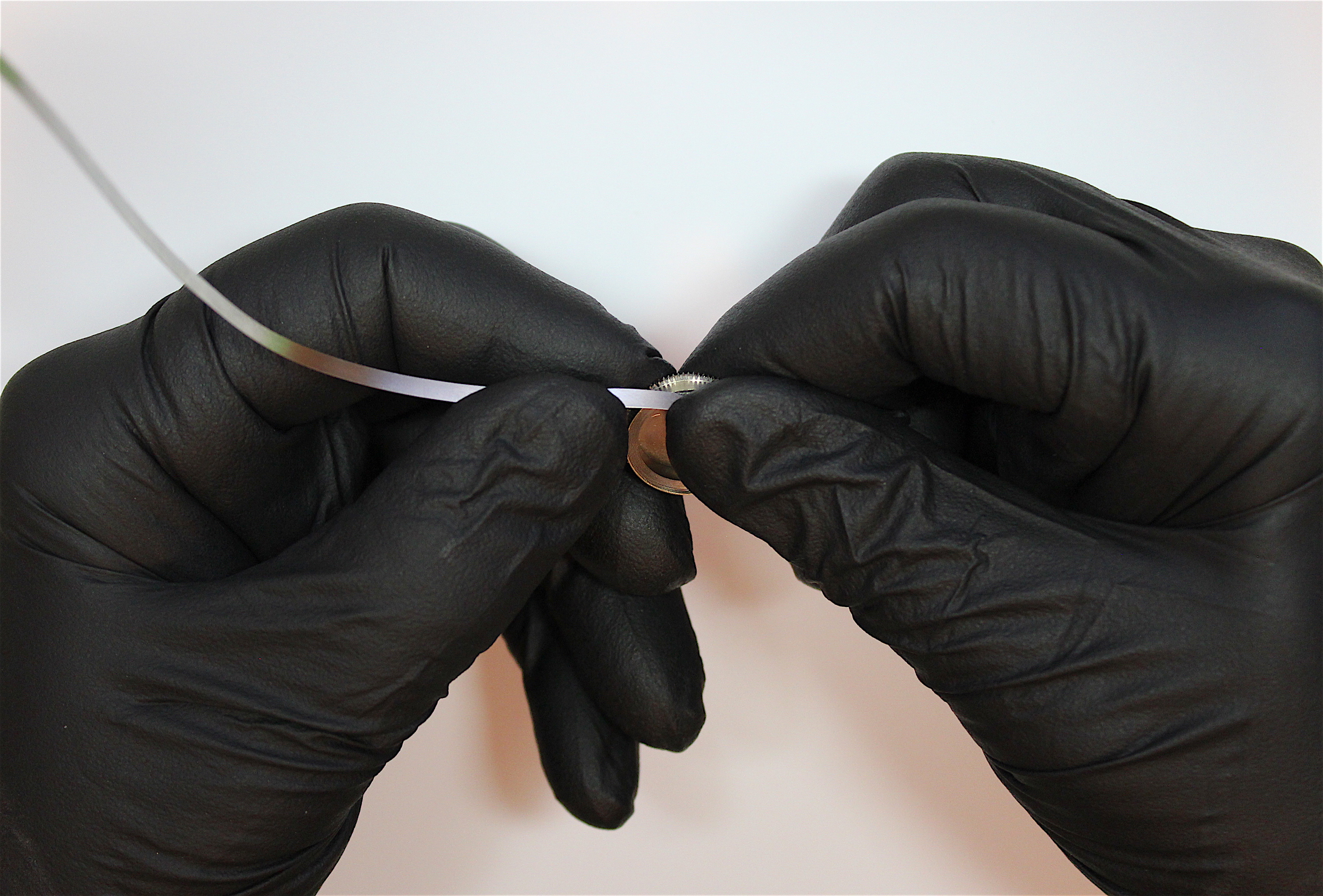

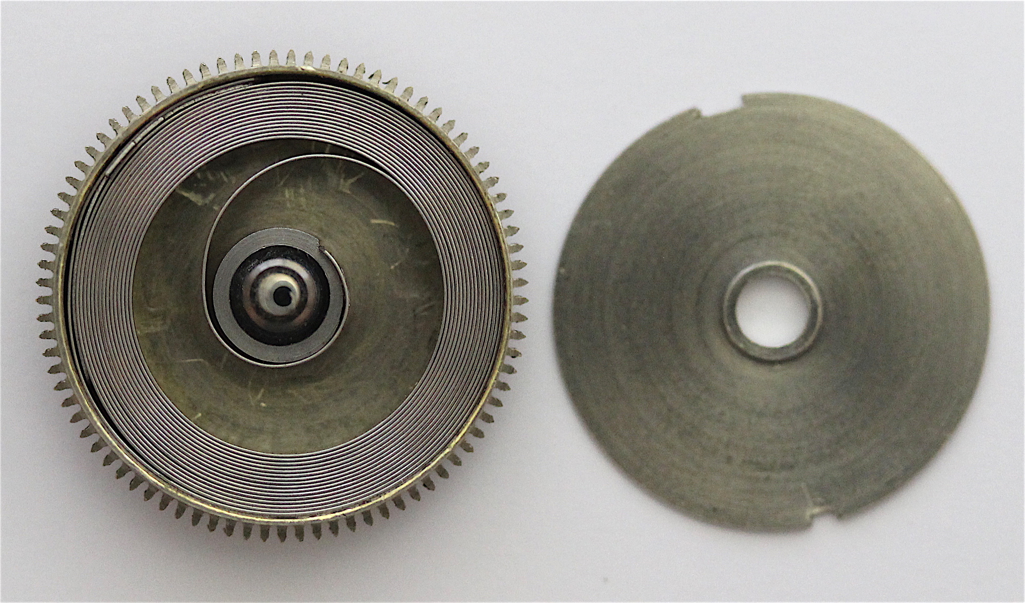

So today is Sunday here, too hot to enjoy outdoors (33 degrees C / 91 degrees F) so I decided to continue with Hammy (as I now call her).

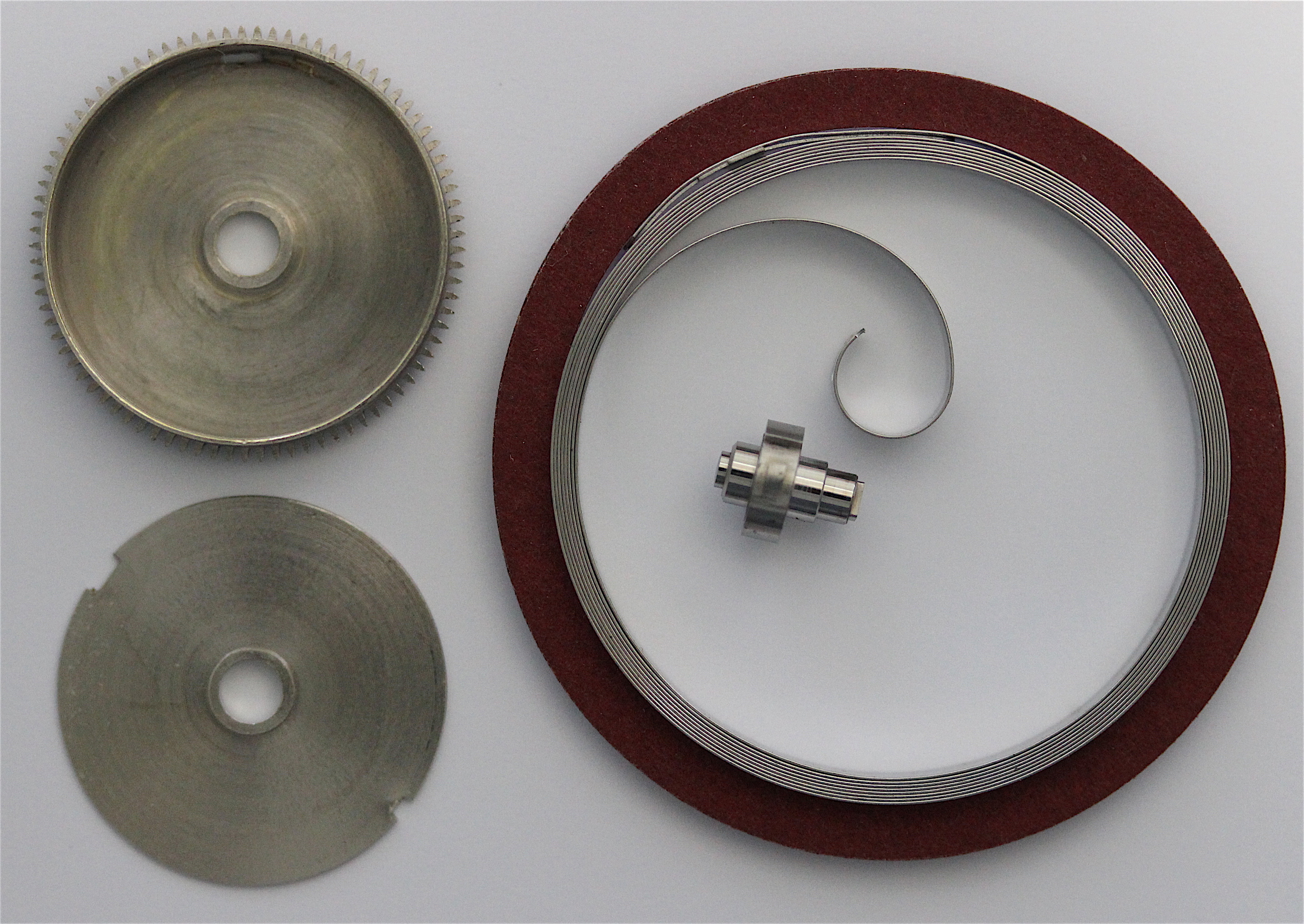

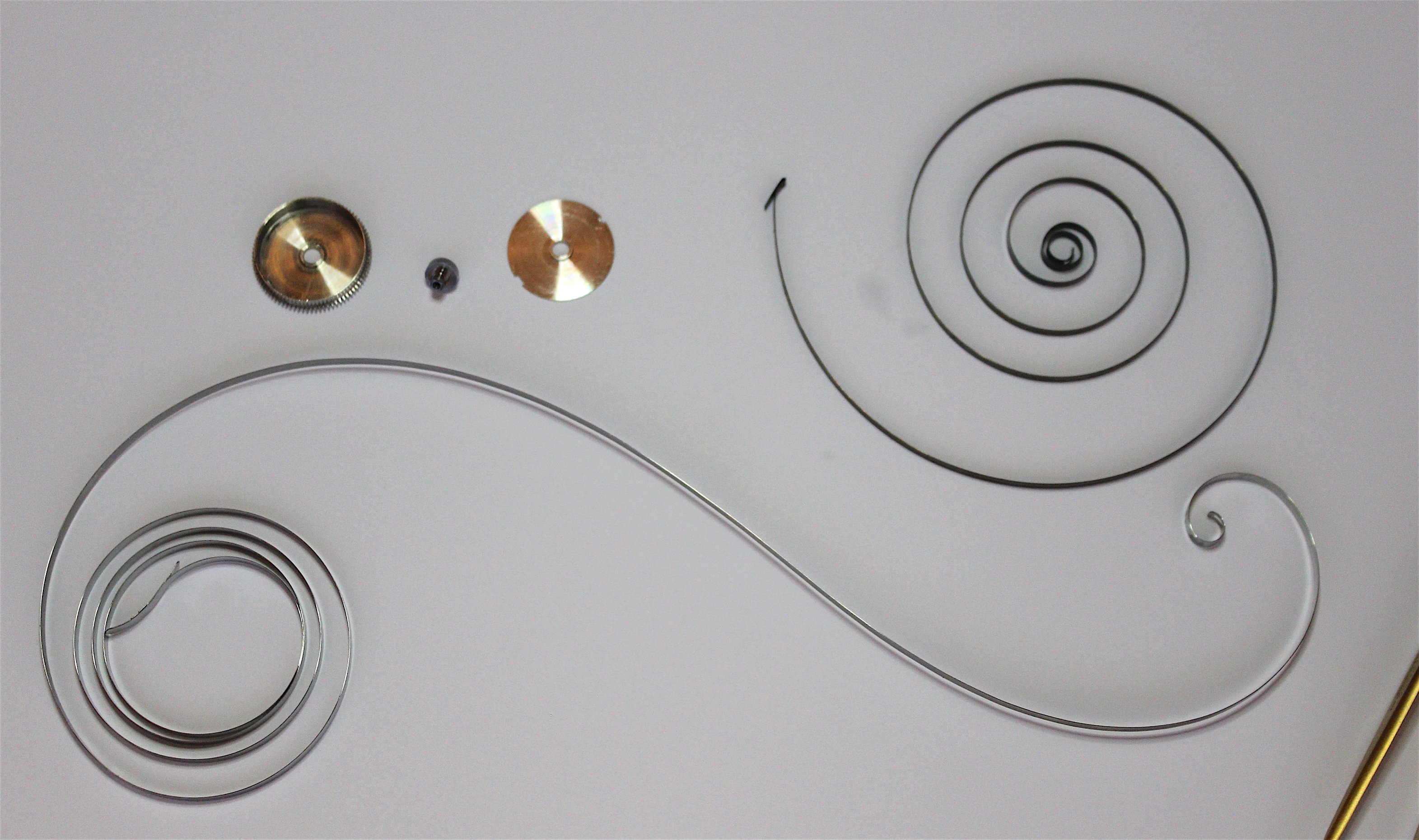

I unpacked the new mainspring and cleaned it of any old oil, here it is next to the old one, some difference!

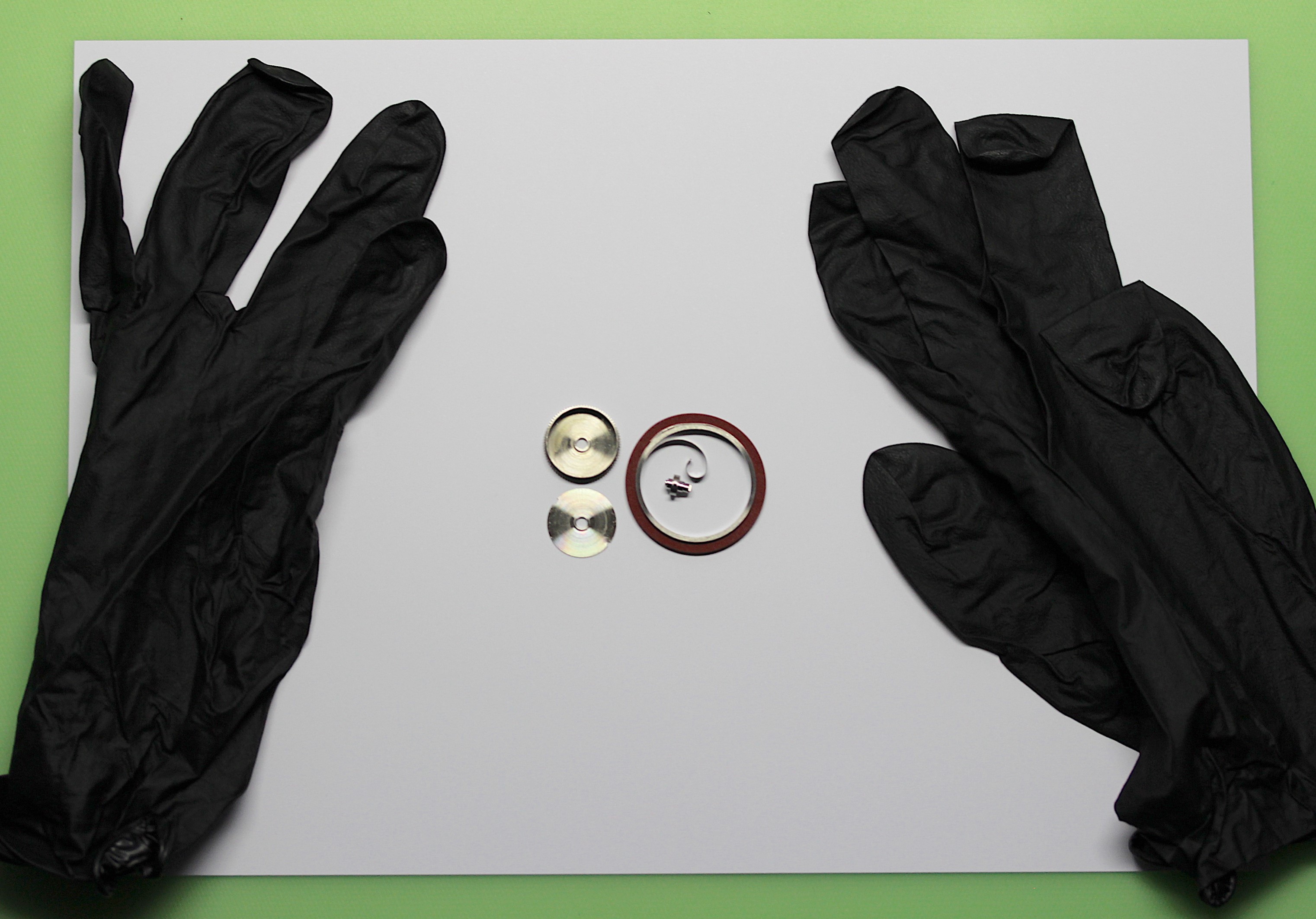

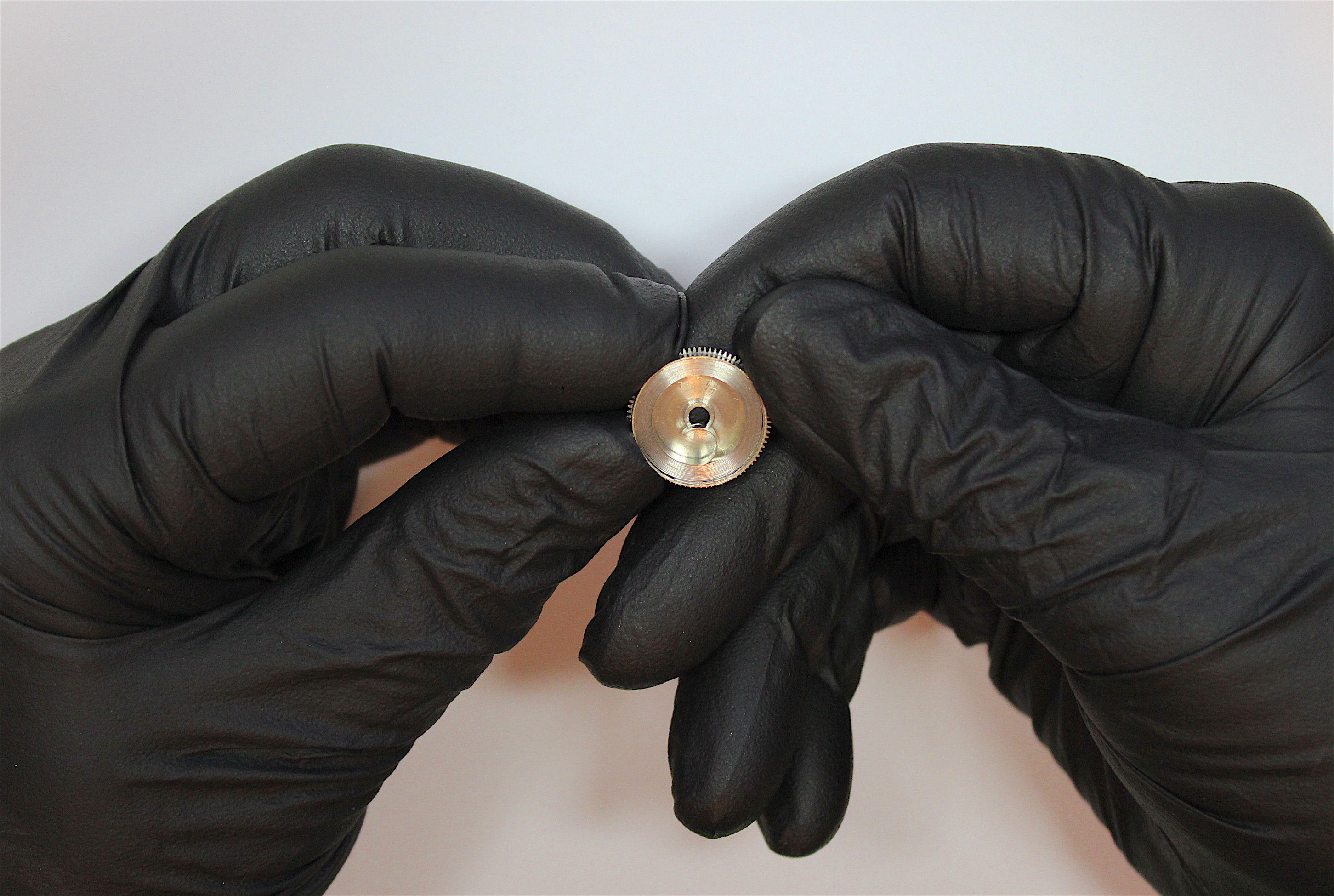

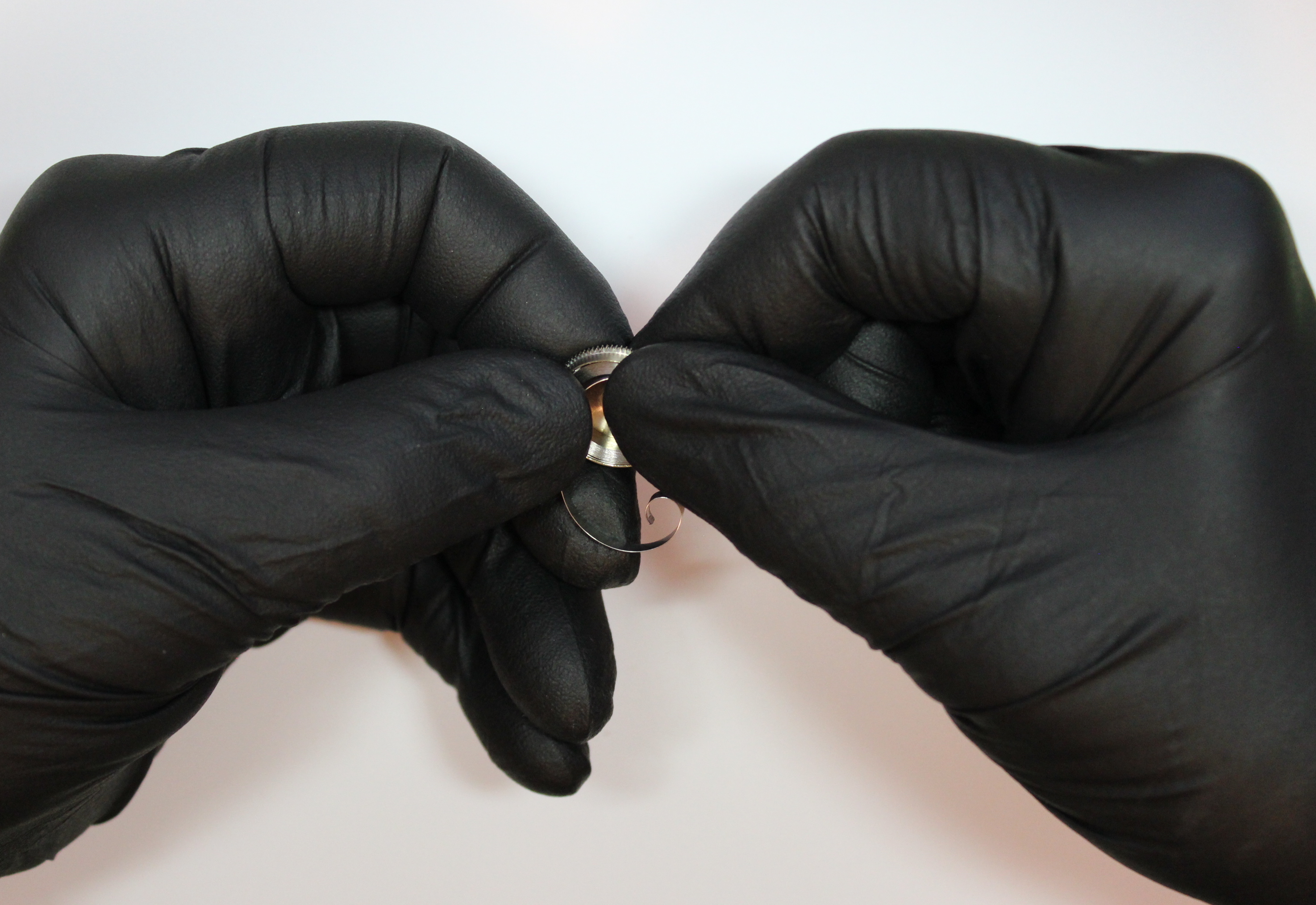

Next we don the gloves and start winding the tail of the spring into the barrel, making sure the tab has engaged in the slot. This is the hardest part as I'm winding against the curve of the spring and it keeps trying to get away, fingers are sore from keeping pressure on.
Now it's at the easy part, the final few turns.........
and it's done!
And a final look at how it went.
Before..........
And after......

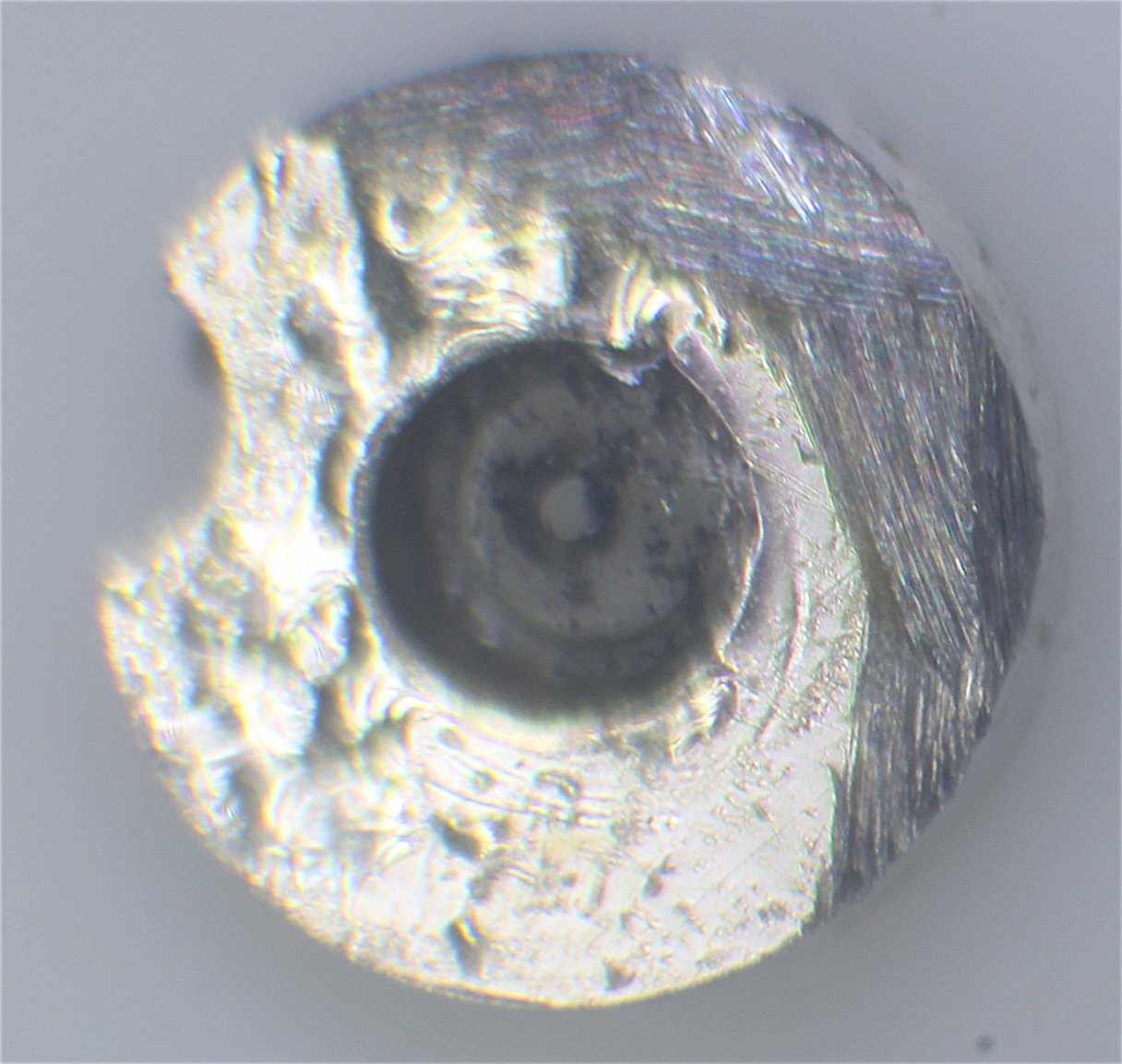

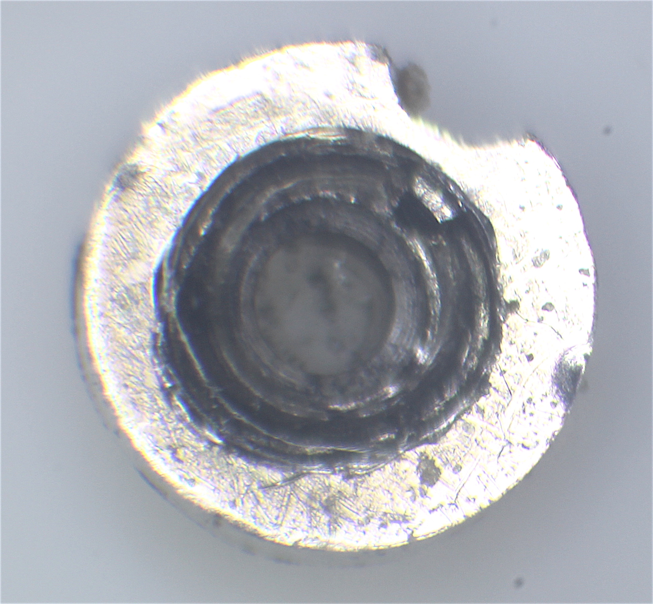

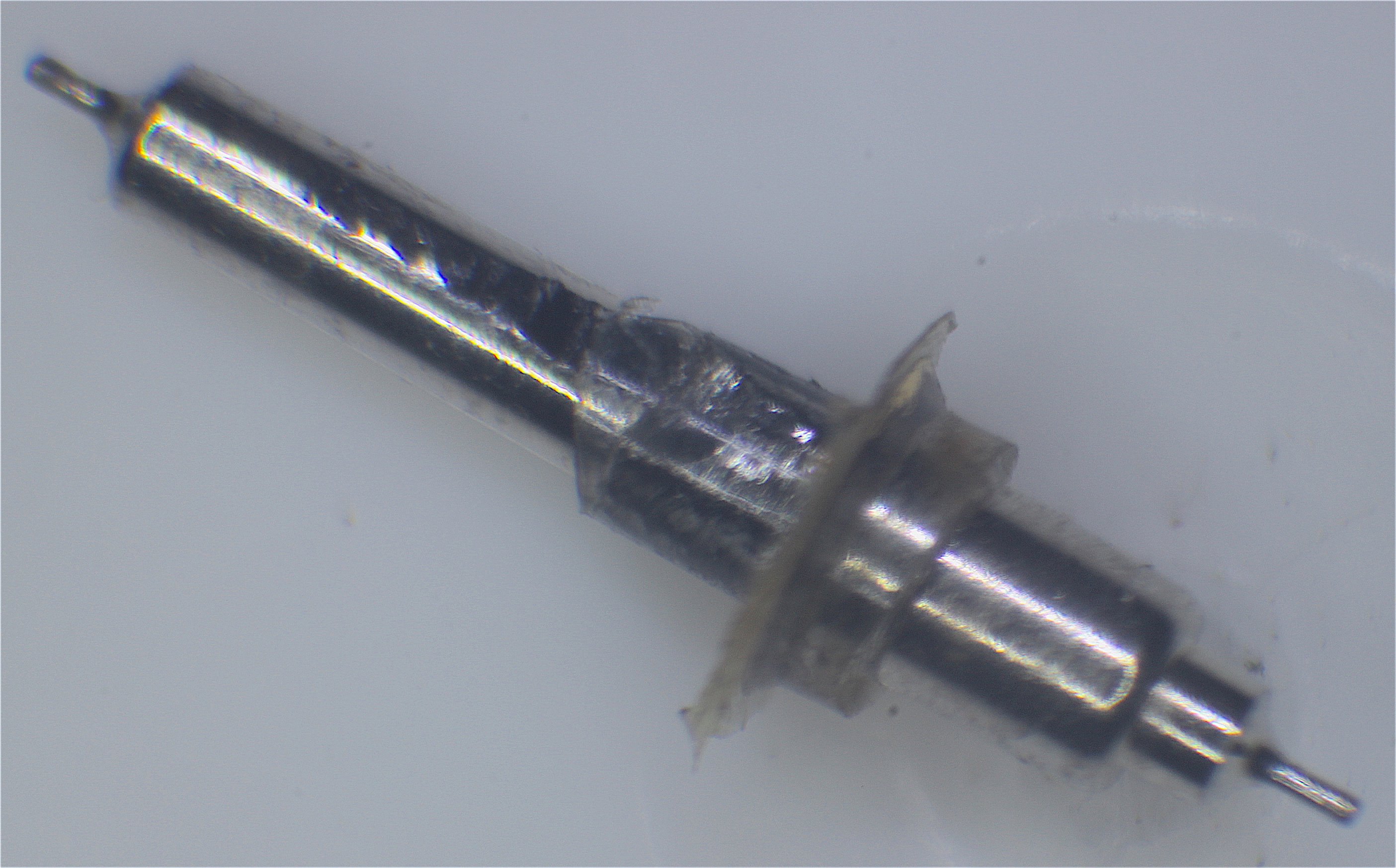

So after placing this project on hold due to the "issues", I thought I'd show the last three pics to illustrate the "watchmaker's craft".
Emphasis on "craft".

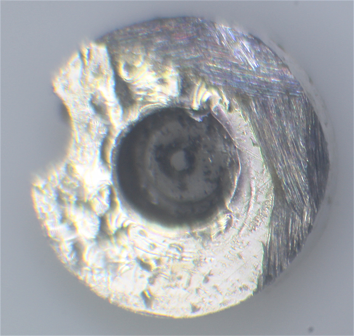

The balance staff, although it had both pivots intact (to a degree) did not quite meets the specifications required for a Hamilton 992B friction fit staff.
Never mind said "the watchmaker", I'll just MacGyver it on with some superglue, thus the balance staff, although being too short, got a balance wheel "friction fitted".
Here is the balance staff after I managed to get it apart from the balance assembly. What a gem. You can still see the residue of the superglue, never mind the plier marks.

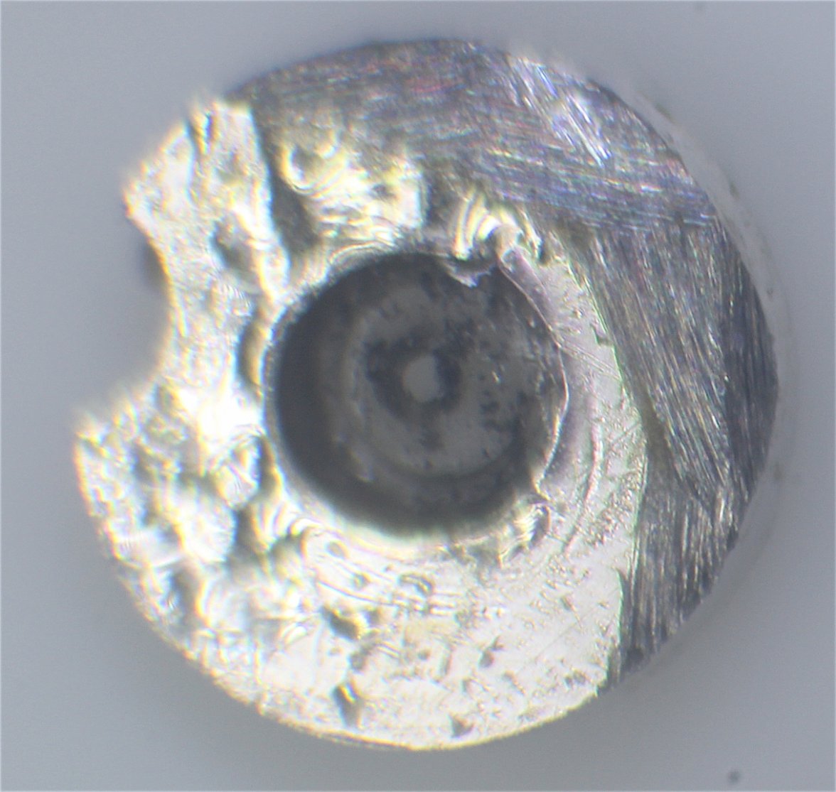

The bottom roller was a bigger problem, it didn't even fit the balance staff. Not to worry, just add more superglue. This is a shoy of the top of the bottom roller table. You can see the filling in the centre. All superglue!
Once our intrepid artisan had glued this thing all together, he found that it was so off centre and tilted that the bottom roller was striking the bridge that holds the lever.
Never mind he thought "I'll just grind a bit off to clear it".
Here is the final bit of evidence of his "skills".

15,188
44,620
With the use of factory original parts, servicing the 992B is so simple, you have to wonder why this bodger chose to attempt the repair the hard way! I wouldn't aspire to being a blacksmith, so I wonder why this butcher aspired to being a watchmaker!
