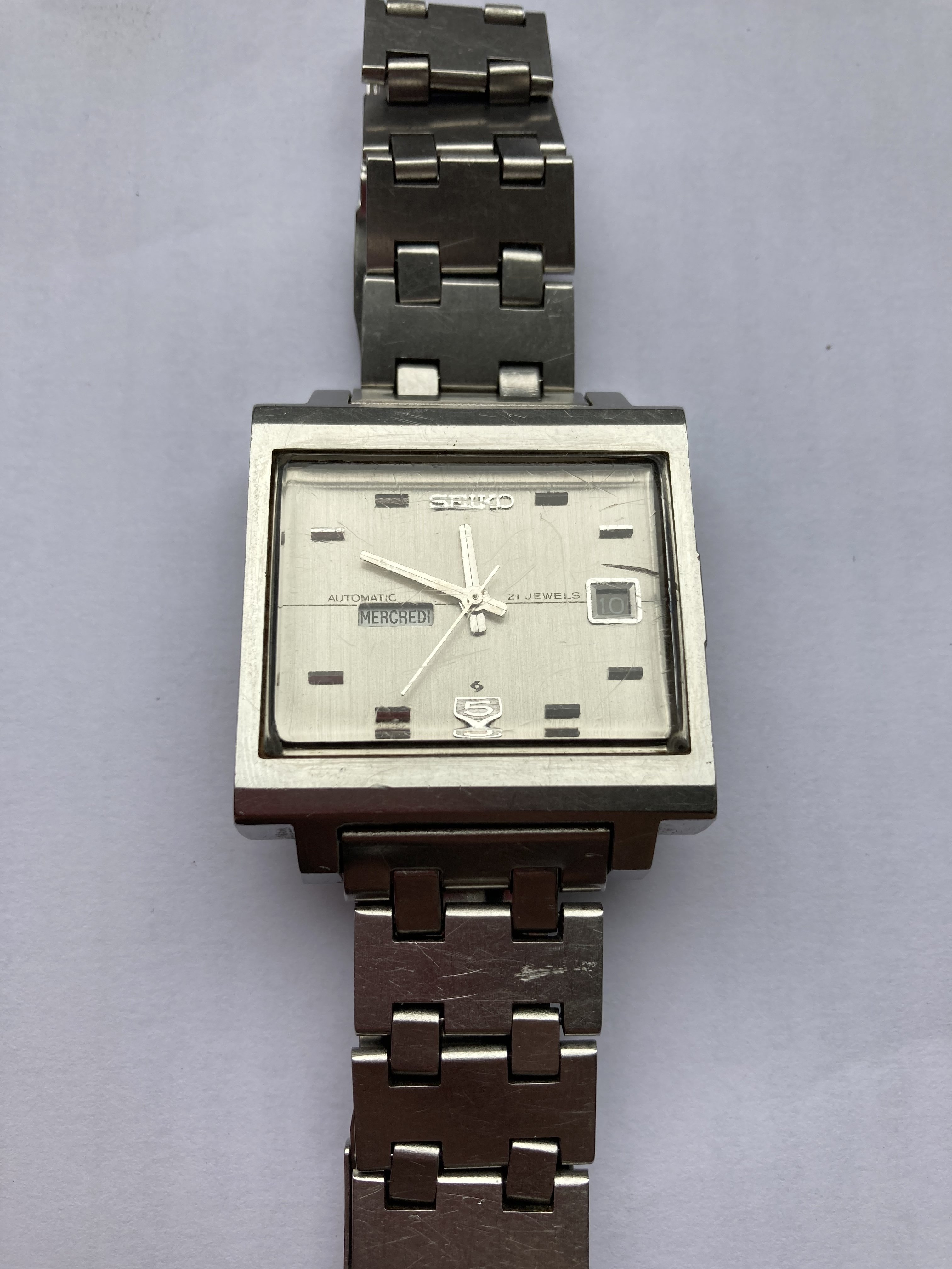

Your wish is my command!
It’s nothing special, a beater (and my, does the Crystal look beaten) that my grandfather would wear to work regularly, I like the style.

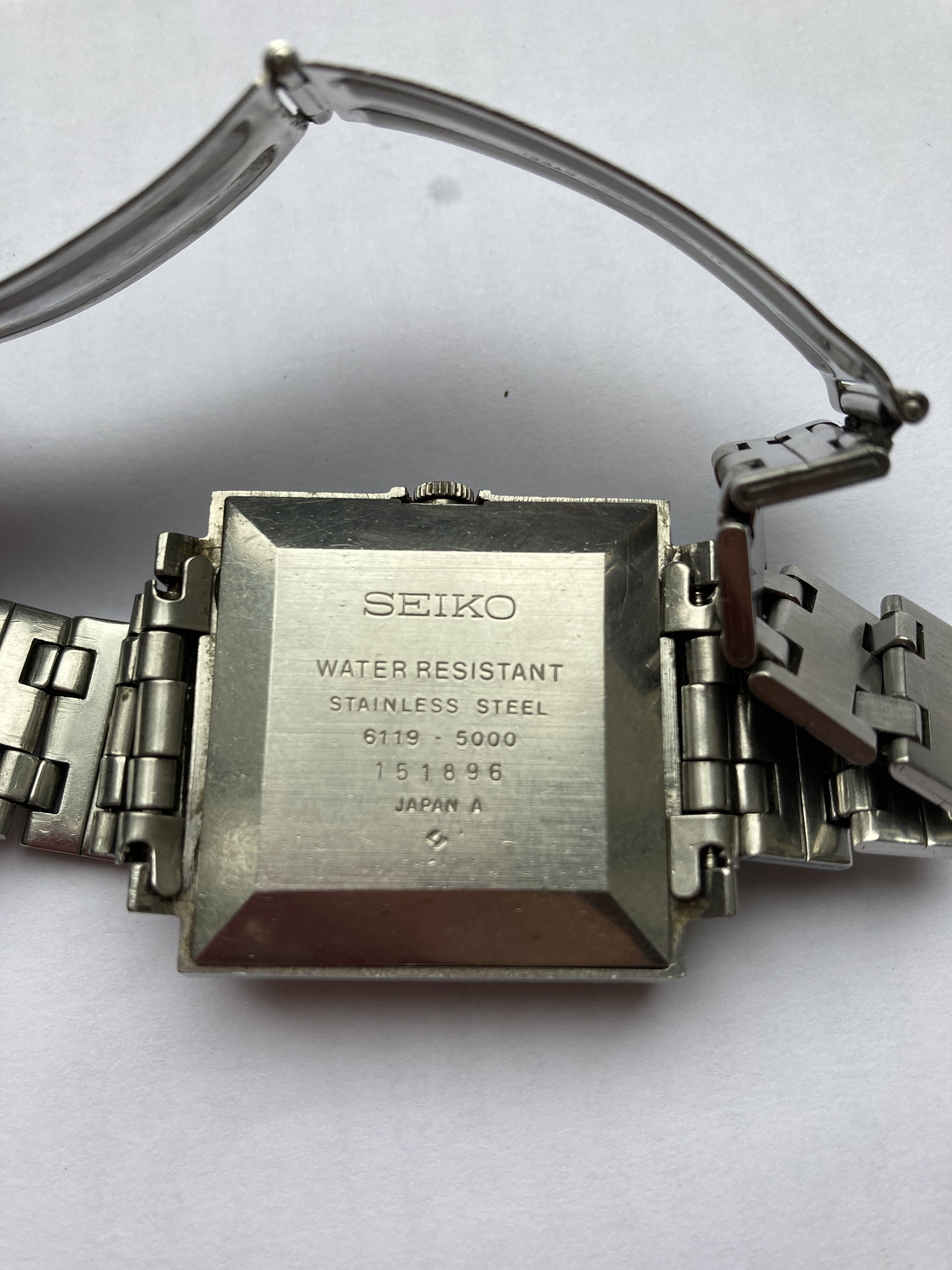

I still haven't figured out how to manually wind it, so if any of you OF members happened to live through the 70's with one of these, I'd appreciate your input.

Odds are you can’t manually wind it. Welcome to Seiko Magic lever.
Well, that was a fun bit of research for me, every day is a school day when it comes to this watch hobby of mine.
Considering this Magic lever, does this make it a more difficult movement to service?

On quite a few low end Seiko caliber, handwinding is not possible, it was traded for a quick set date. You'd have to step up to the Lord Marvel, King Seiko or Grand Seiko lines to enjoy both.

Not really.

Nope pretty standard to this day on 5’s.

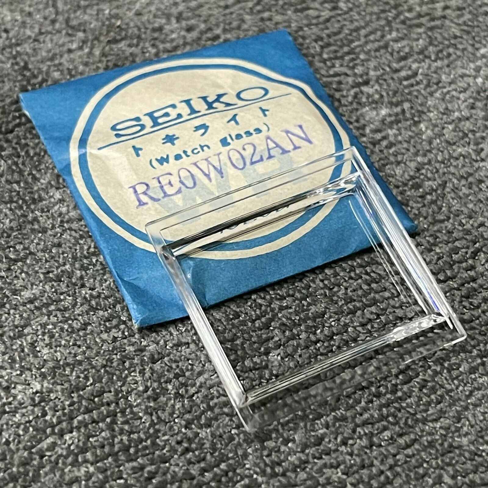

And I'm on the hunt for a new crystal, as this one is battered and I don't think it's plexiglass. The old polywatch won't cut it with this.

Pressing on painted hands does put pressure on a small area of the hand, and sometimes this can cause the paint to flake off. Not a common thing, but it does happen. The hands on the OP's watch don't appear to be painted, and are not the type of hand IO would expect any major issues with removing and replacing.
