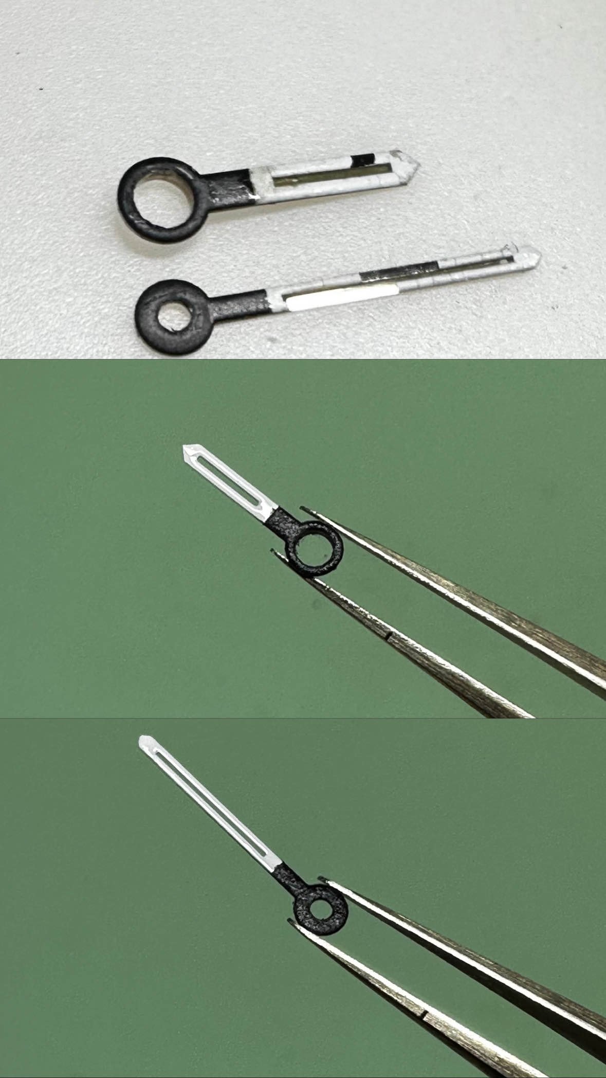

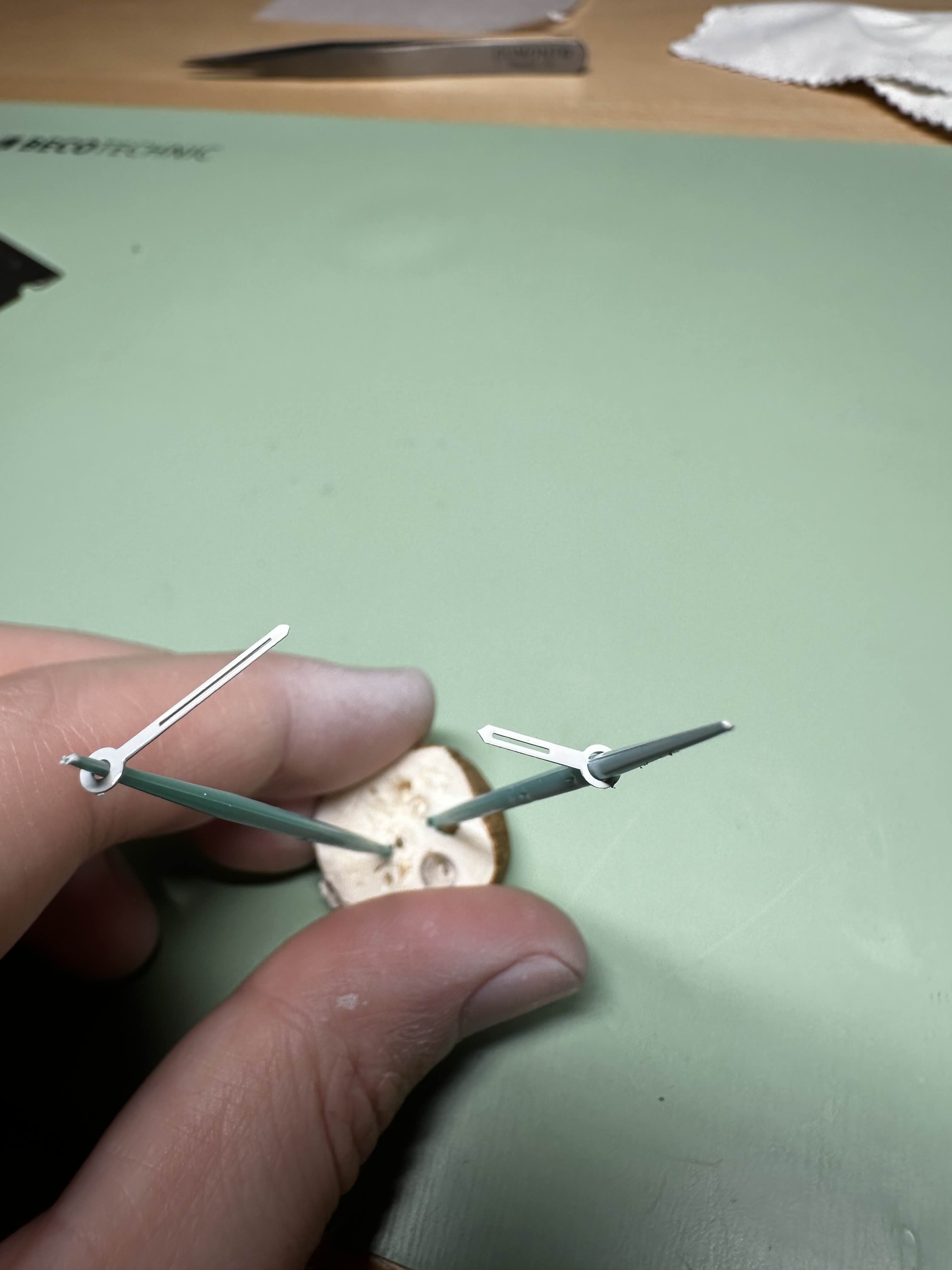

Servicing an old Chronostop, now that the movement is done it's time for the hands and casing components.

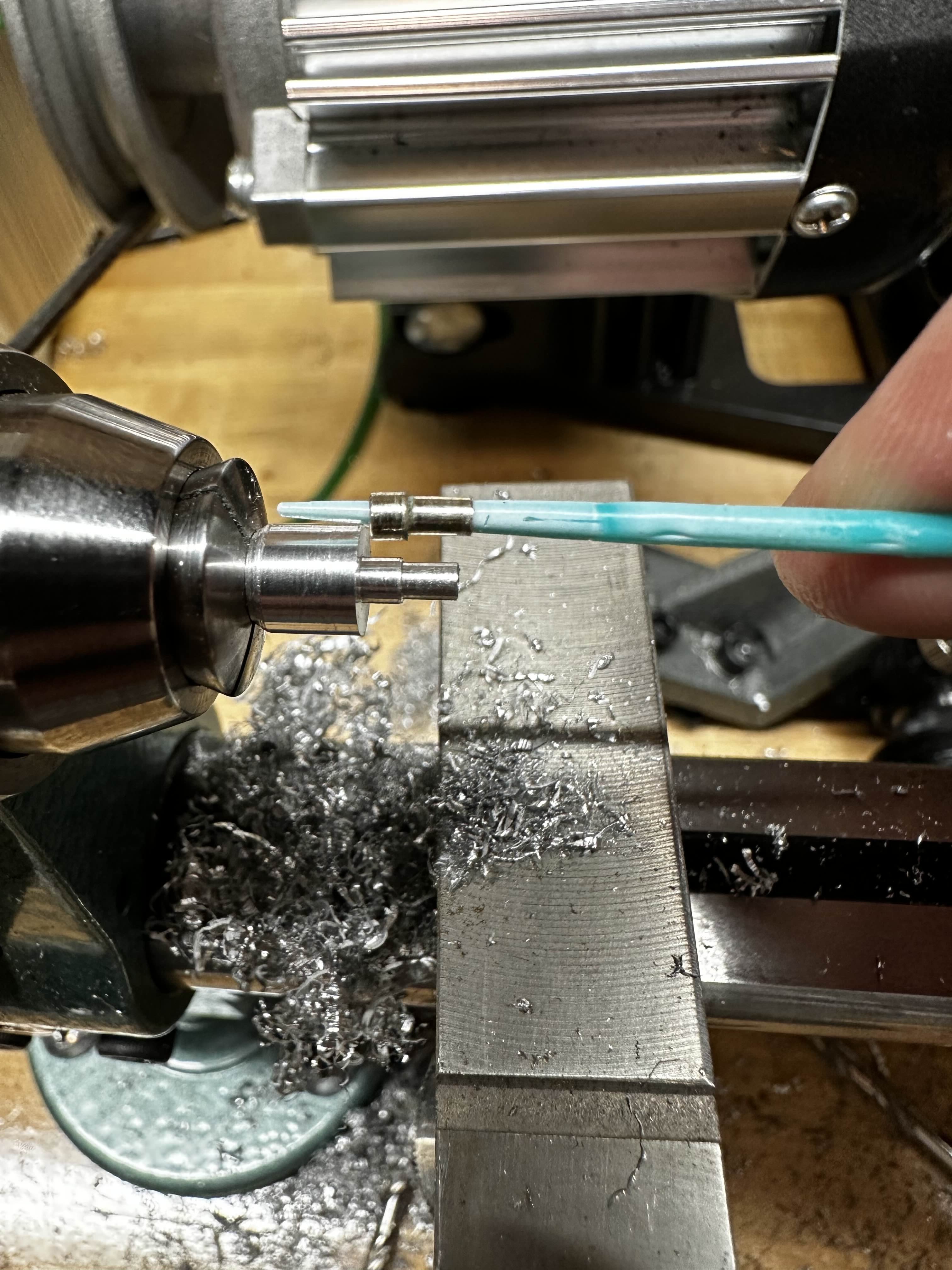

also needed a new tube
Case is away with a friend for lapping and refreshing that sunburst on the bezel. The dial has some damage so if anyone has a fresh 920 dial for sale, let me know!

ha, yes I know you can buy them. Figured I'd save money on something I could just turn in 30 minutes instead of paying inflated prices for vintage spare parts. Dimensionally the same and turned from a piece of scrap.
30 minutes isn't bad for a simple case tube. New ones are hard to beat price wise though, so $18. Unless your hourly rate is quite low, a new one is the cheaper route if you have access. Of course if this is a watch for yourself and not for a customer, it's completely different.
