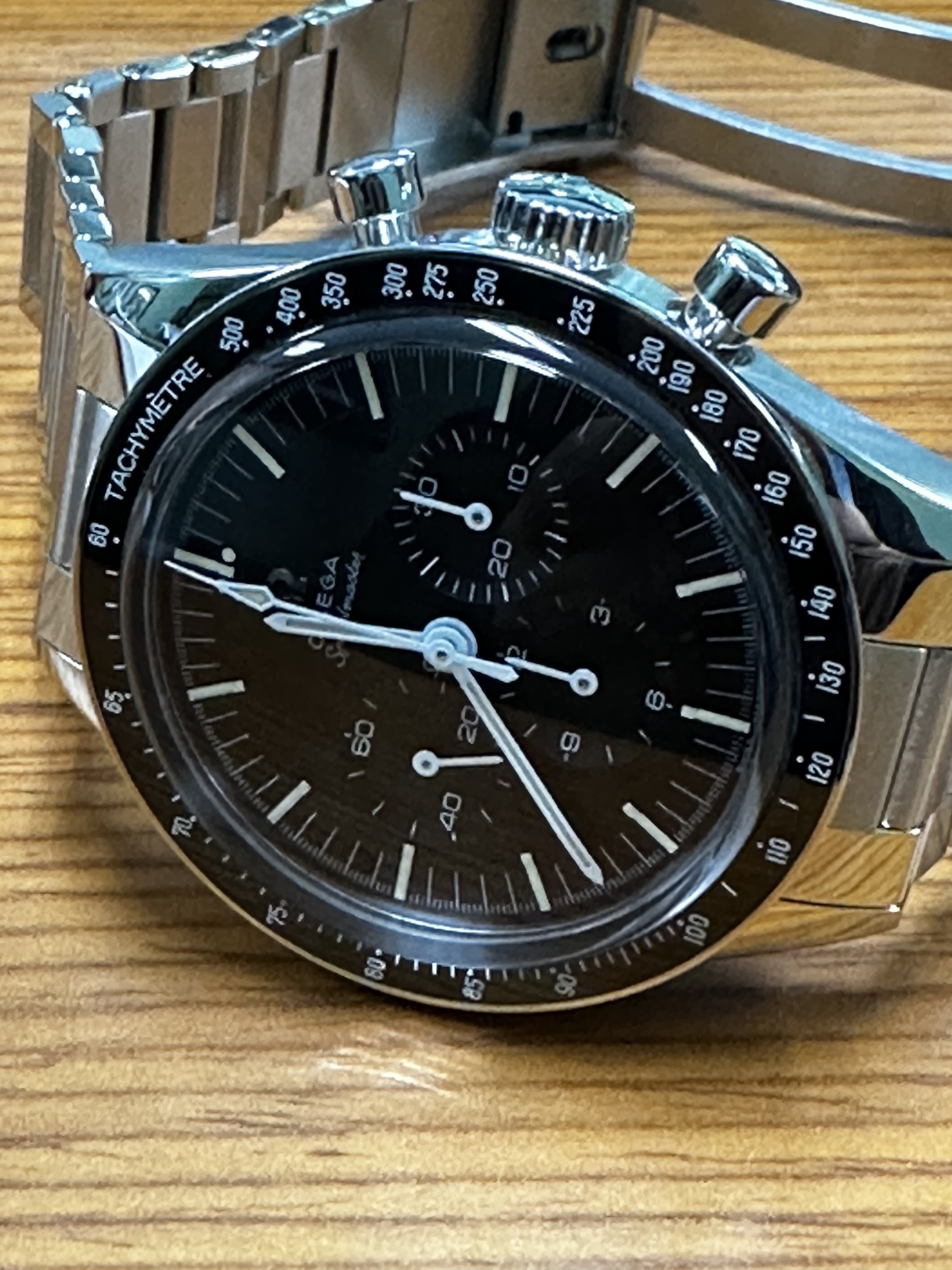

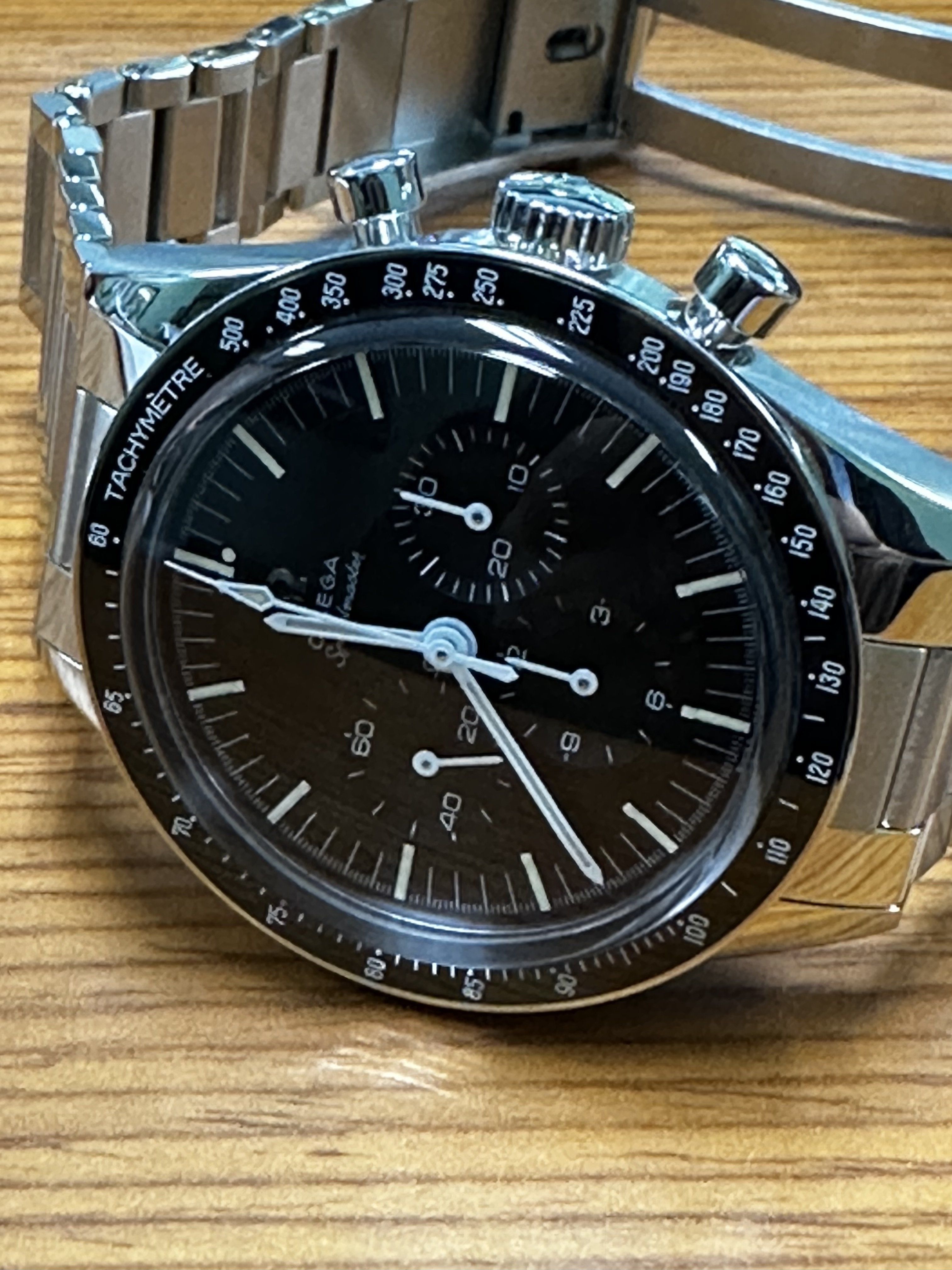

For all you guys who daily your 321 or even a 3861, do you all take them in yearly for a pressure test? Or just wait the 6-8 years and just full service them? And can ask a question without a pic
