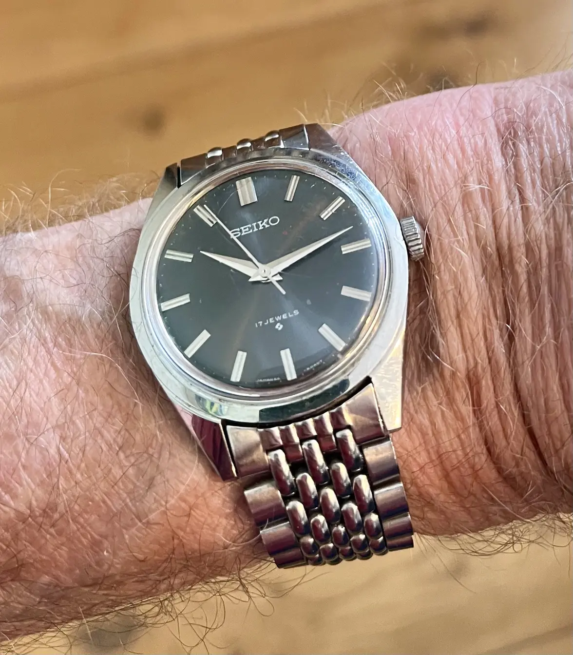

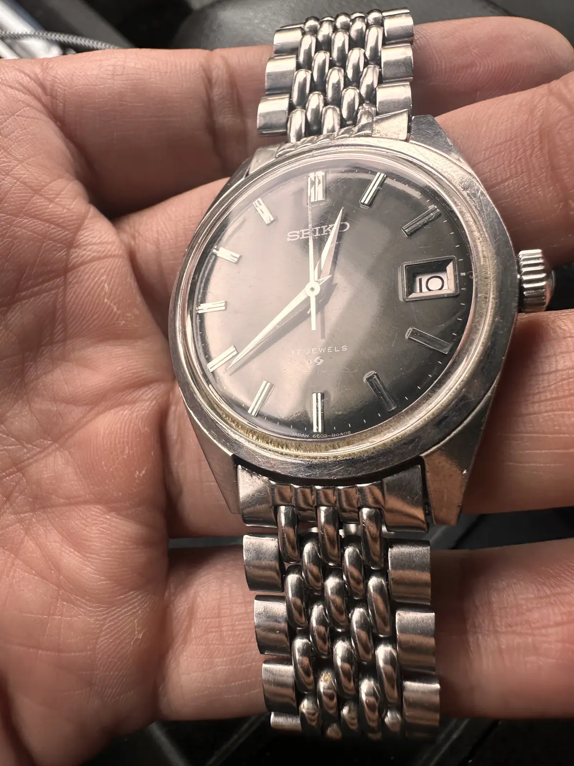

I picked this up today pawn shopping. Paid 60. Everything on it runs.

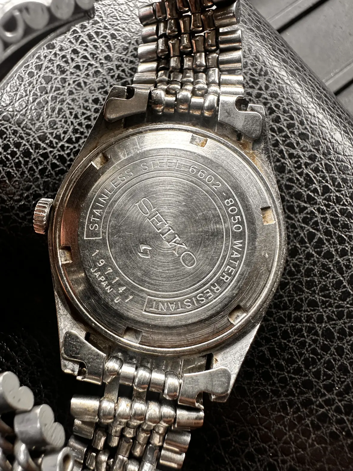

Movement reads 6602-8050
General question: should the date be adjustable on its own or is the only way to adjust it by sending it around the hours twice for each day ( right now I can’t seem to adjust the date alone)
Looks like Seiko wants 290 to service this watch. The crystal looks a bit worn. A general service I’m sure is in order.
Anyone recommend a 3rd party for this. 290 seems steep.

Nice find, I really like it. Especially with the bracelet. This movement may have a semi-quickset date, where you can advance the date by going back about four hours and than advancing again past midnight.
I'm not sure what currency "290" refers to, but I'm not sure how much less you can expect to pay for a decent service in most locations.

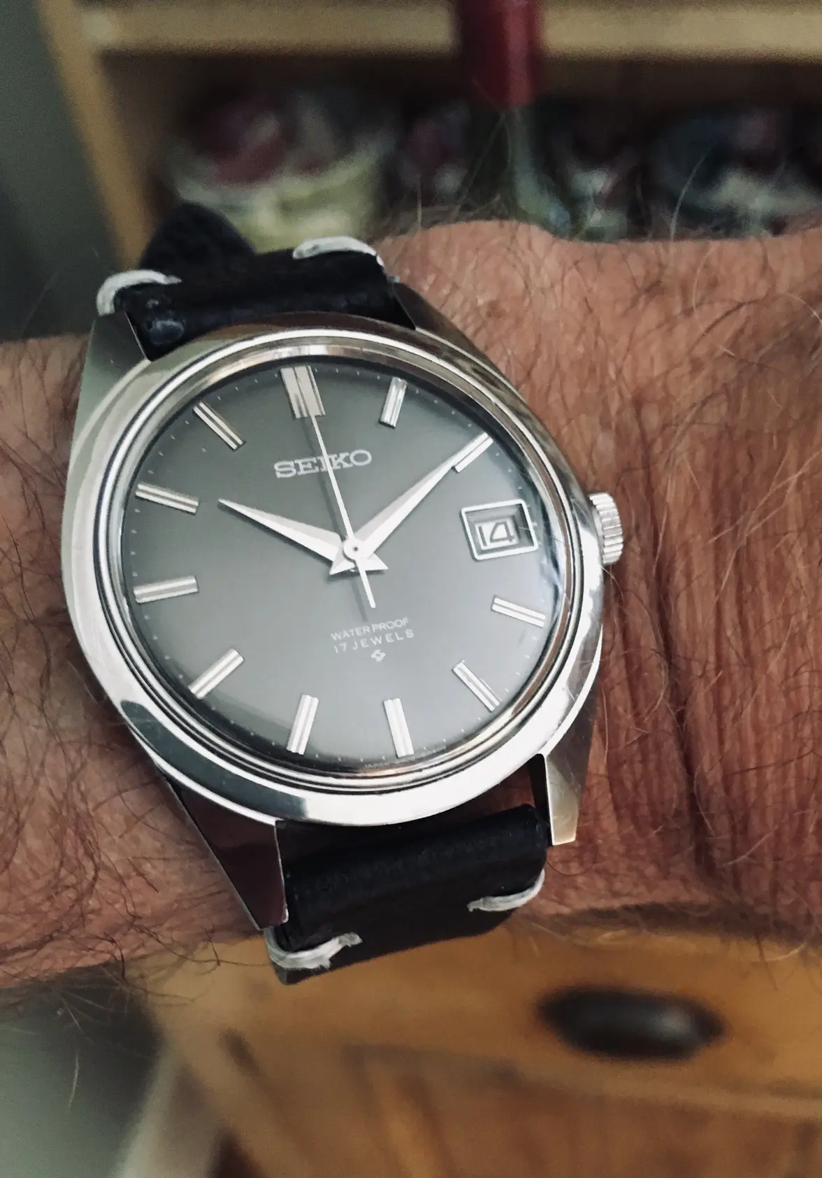

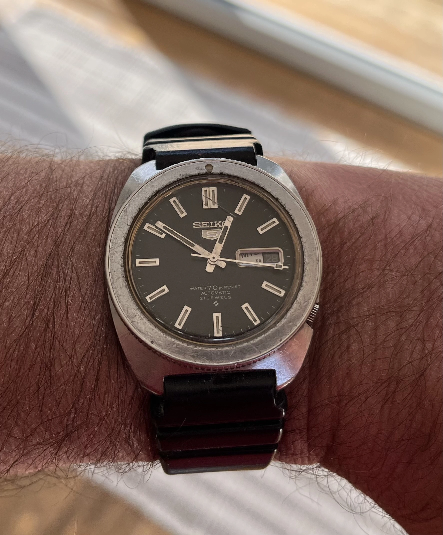

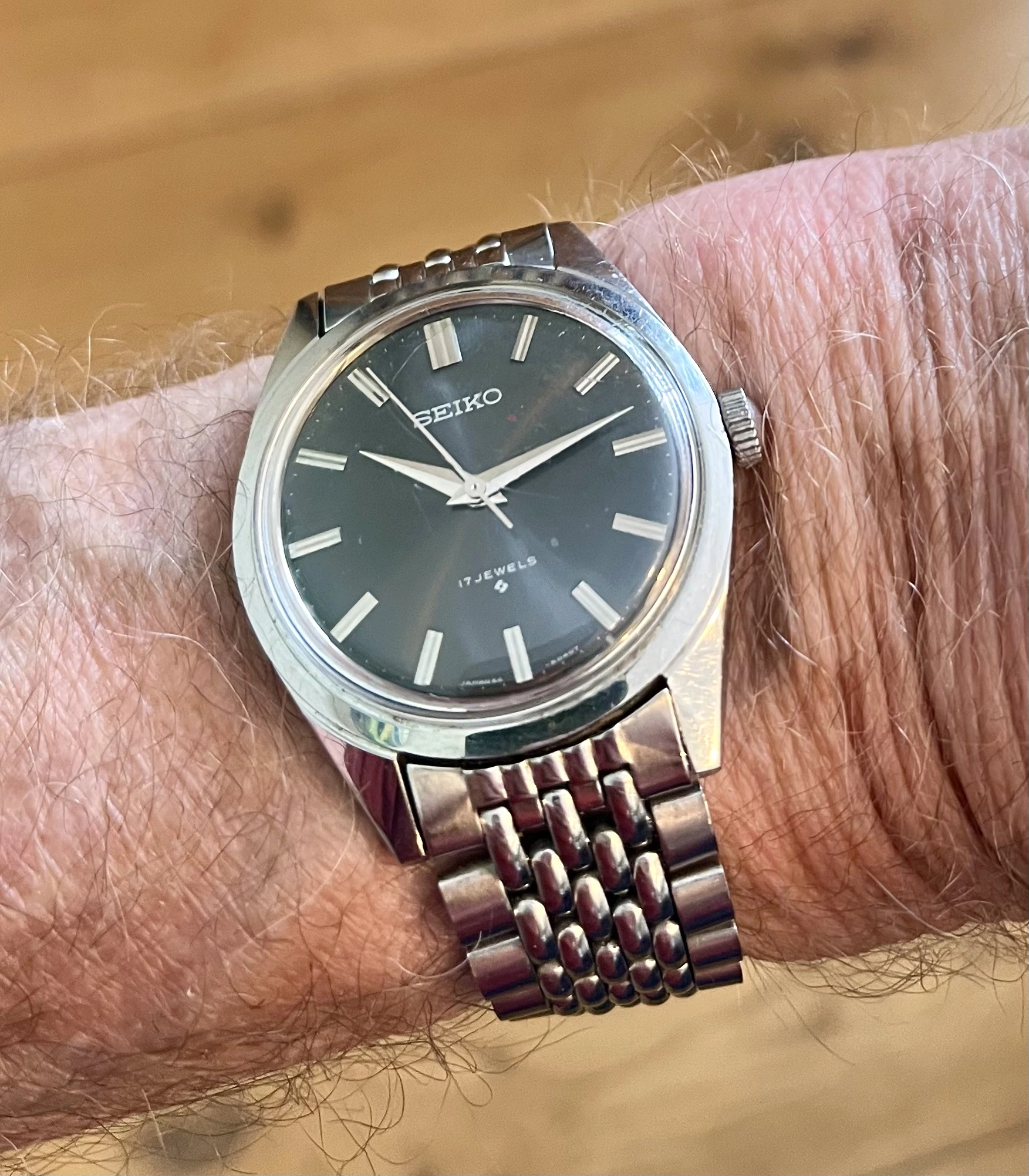

Nice watch - I have two identical 6602-8050s and a very similar 66-8050 and the movements are all reliable and worth the price of a service although not necessarily by Seiko although you don’t mention where you are or which currency.
If you post where you live someone should be able to recommend a local watchmaker.
The date advance is the traditional wind to just past midnight so the date changes, wind back to 8, wind forward to 12, and repeat.

I’m in Texas (USA). Im not against sending it to Seiko. In fact I’m normally a factory service kinda guy. Just didn’t think it would run 300 bones. I will likely send it off and see how it looks on the return. Any idea on a year of production on this one ?
Cool hack on the date window.

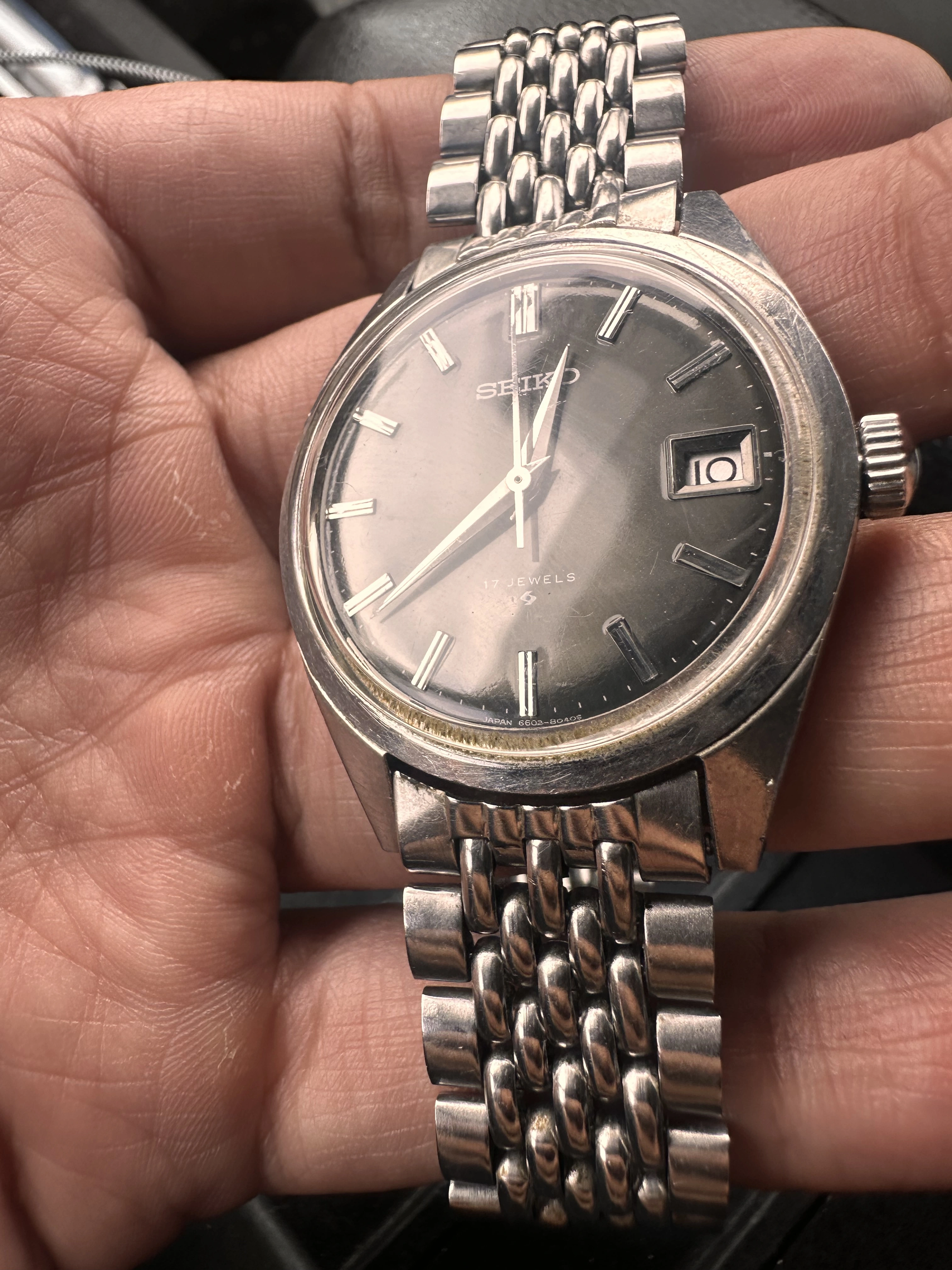

After looking at mine a bit it’s really not bad. The crystal surfaces scratches are very minor and the rest is just a polish job. It’s keeping excellent time and the date hack you all suggested worked. Had to go counter clockwise then 9 o’clock to 12 o’clock would change each date. It’s pretty audible when it clicks. I like it. I can also hear it ticking pretty good when I put my ear to it. It’s cool in my opinion. The bracelet rocks.
