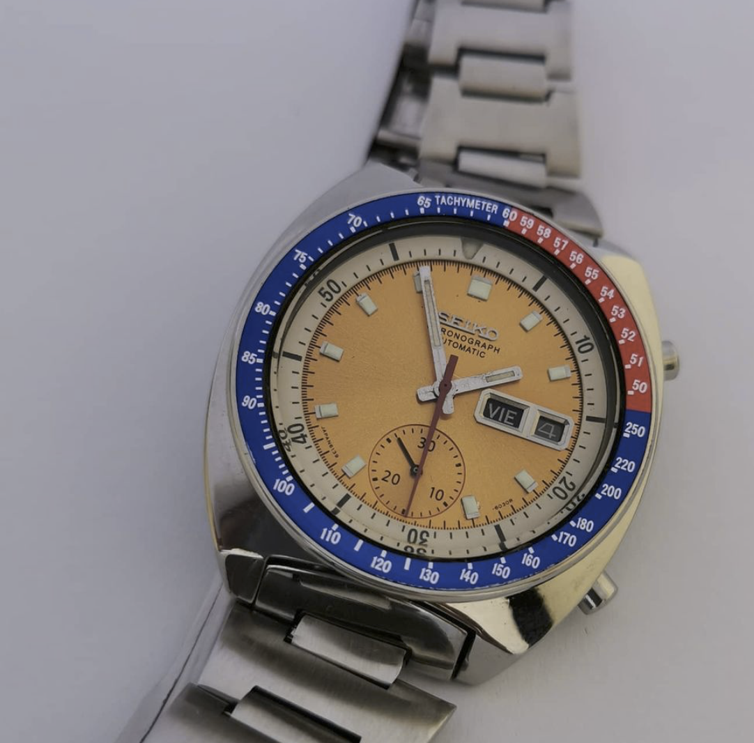

Hi guys,

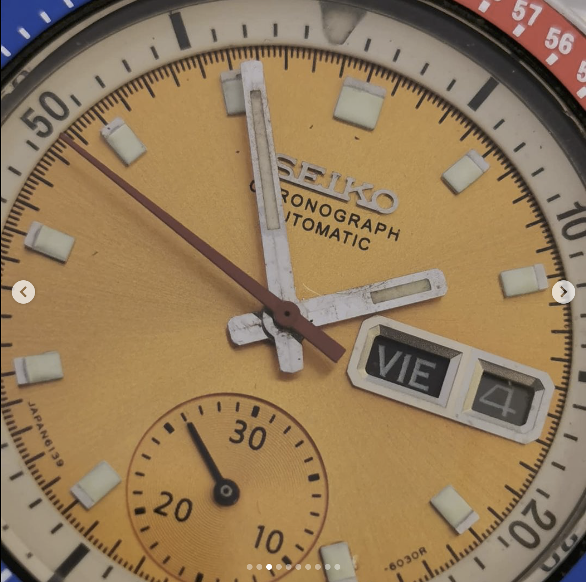

this Seiko 6139 - 6002 was offered to me. It would be my first Seiko and I'm pretty excited, but I have a concerns whether it has been redialed or retouched. Here are my observations:
1. The subsecond dial hand isn't correct. I can find a replacement, not a big deal.
2. The subsecond dial. I'm not sure whether it has been refinished. I looked at other watched online and some have slightly different font...
3. Looks like the minutes markers have been relumed. The tone of the hands lume is much darker.
Any insight and observations will be appreciated!

Yes, the op’s isn’t a true pogue I know but how about his questions? I agree some things don’t look right and I’m finding this more and more common with “vintage” seikos. There were a few I came across but I compared them closely with pics of known originals and even with my “hobbiest” eye I could spot they weren’t original.

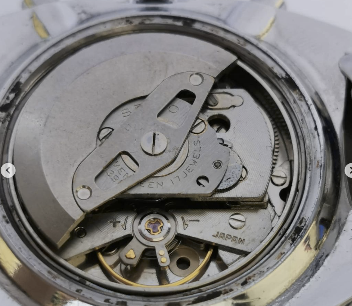

Movement looks very tired, case is a bit worn/polished, and every 6030 I've seen is a Speedtimer. I think this dial has been re-done, but it's pretty good, just not right.

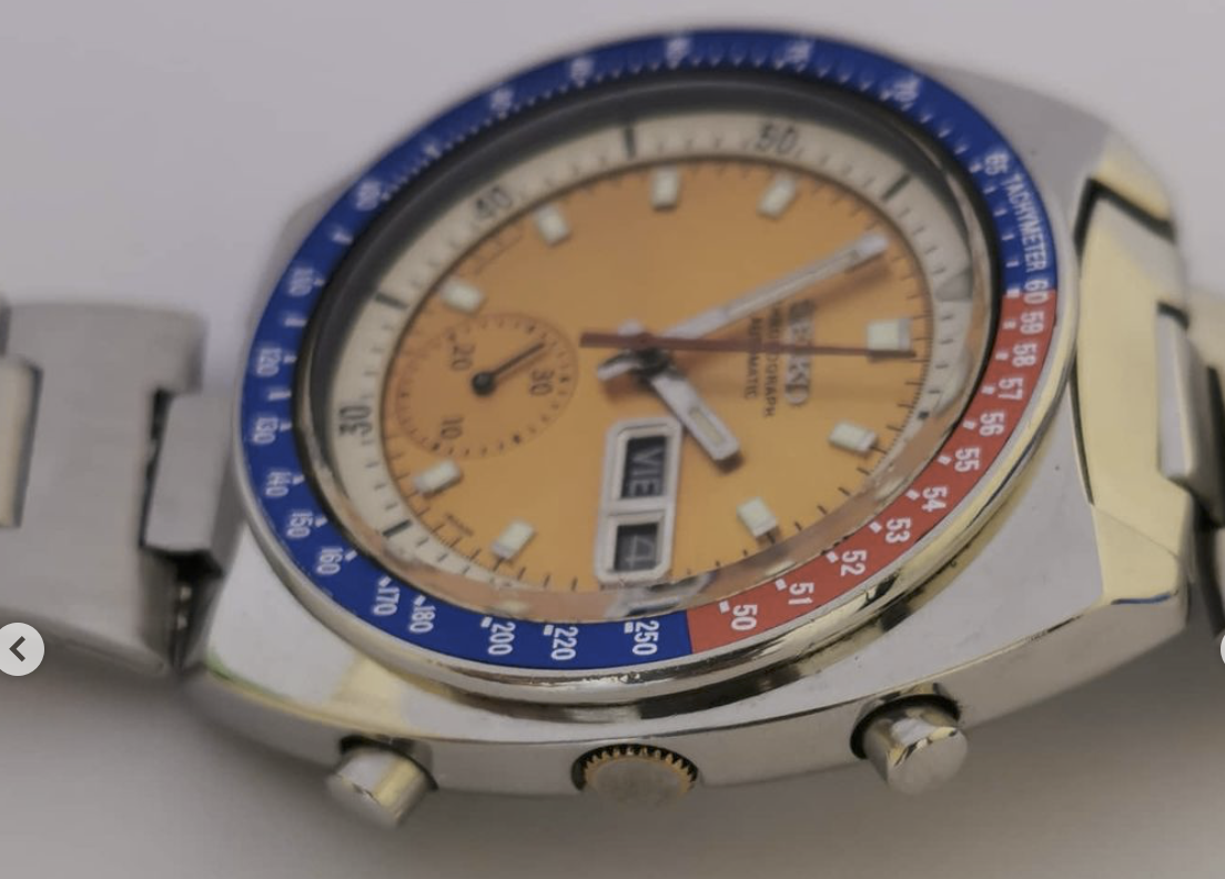

Not good. Remake dial is one thing. I have never seen one this overly polished.
There are a lot of 6139's still available. I wouldn't touch this and would keep looking.
Patience will be rewarded.

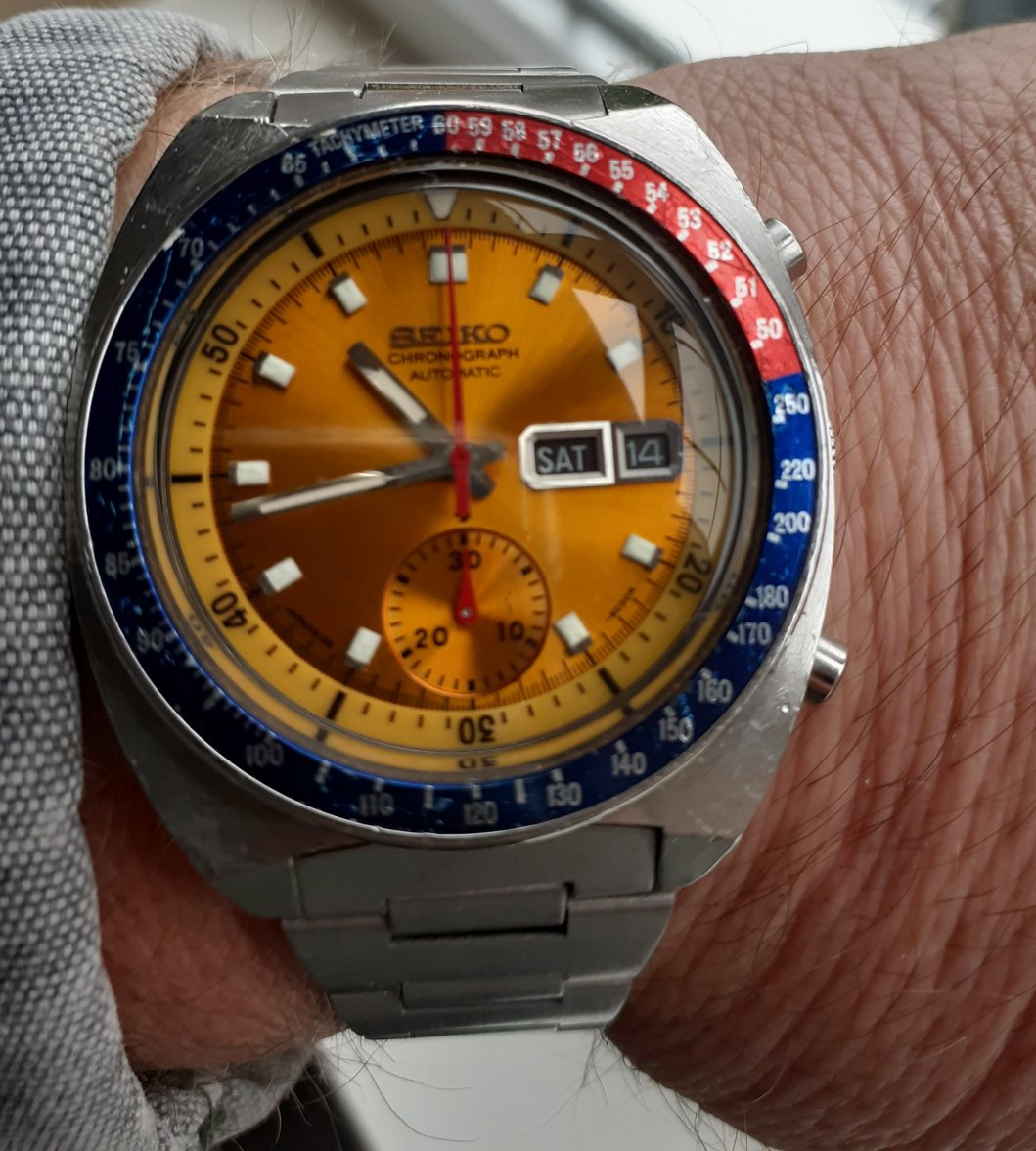

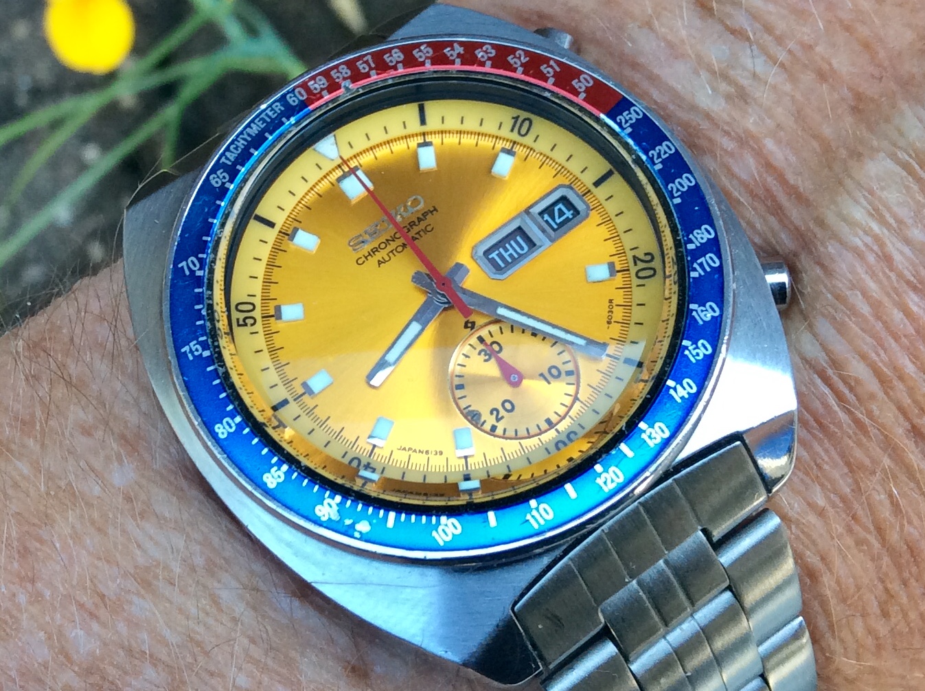

The dial looks aftermarket and the subdial hand is incorrect ,and bezel insert is aftermarket . And it looks far too polished to be of interest, save your money and do more research then take your pick as there are plenty more 6139s in the sea of Seikos . My 6139 6002 from July 76 , ( the bracelet is aftermarket ) .

They can be an absolute minefield to find a correct one. Lots of Franken and bitsa watches out there. Find a seller you can trust, preferably on OF and lots of research.

All sorts of things wrong with this one. Dial, bezel, hands, polished case. Stay away.

Clearly aftermarket dial, watch the vinyl grooves at the subcounter!

Everything aftermarket here but hour and minutes hands and, maybe, sweep hand.
