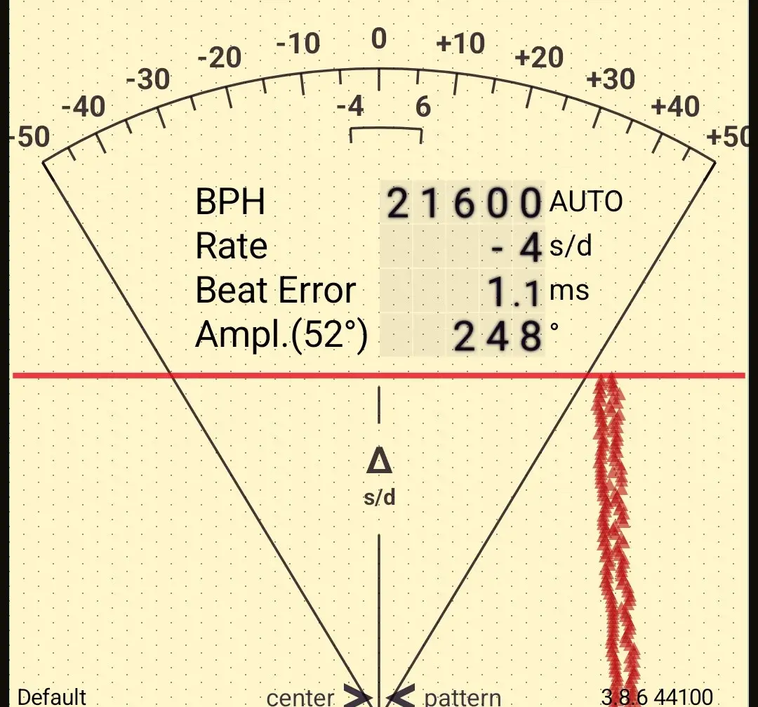

1,978
2,139
That looks like a ton of beat error plus low amplitude. Assuming it worked well before you removed it, I suspect there is either shmoo or damage in the gear train. You'll have to start taking it apart a little at a time and examine whether the jewels and pivots are all clean. I suspect end-shake is fine on them if it worked originally.
Another thing to do is to pull the balance and see whether the pallet fork 'snaps' back and forth correctly. I presume you're getting a really lazy one based on the power transmitting.

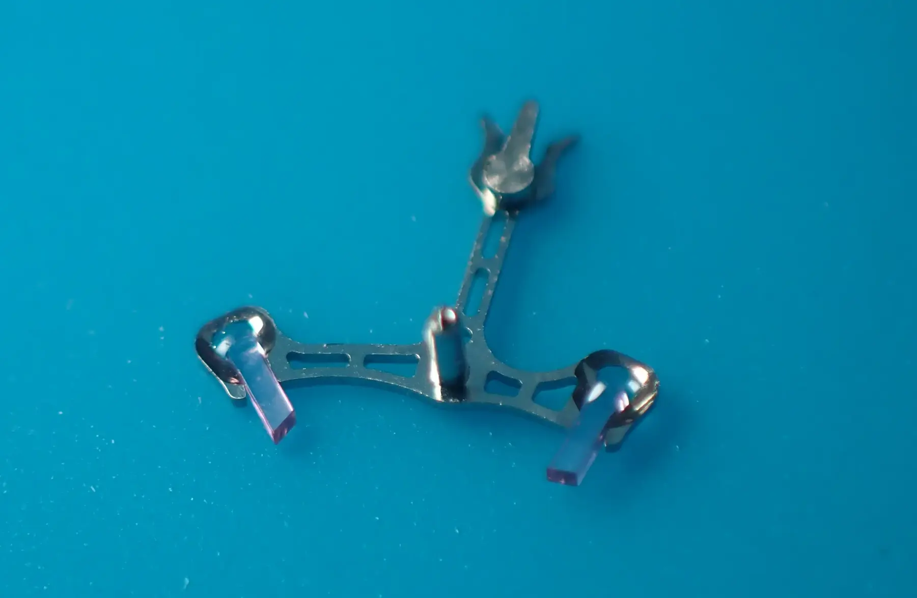

ONE thing you can check first though: DID you pull apart the balance jewel settings? Could you ahve reversed one of the cap jewels?

ah, reversing the cap jewels. Always happens to me. I'll be damned if I can't tell the right side from the wrong...

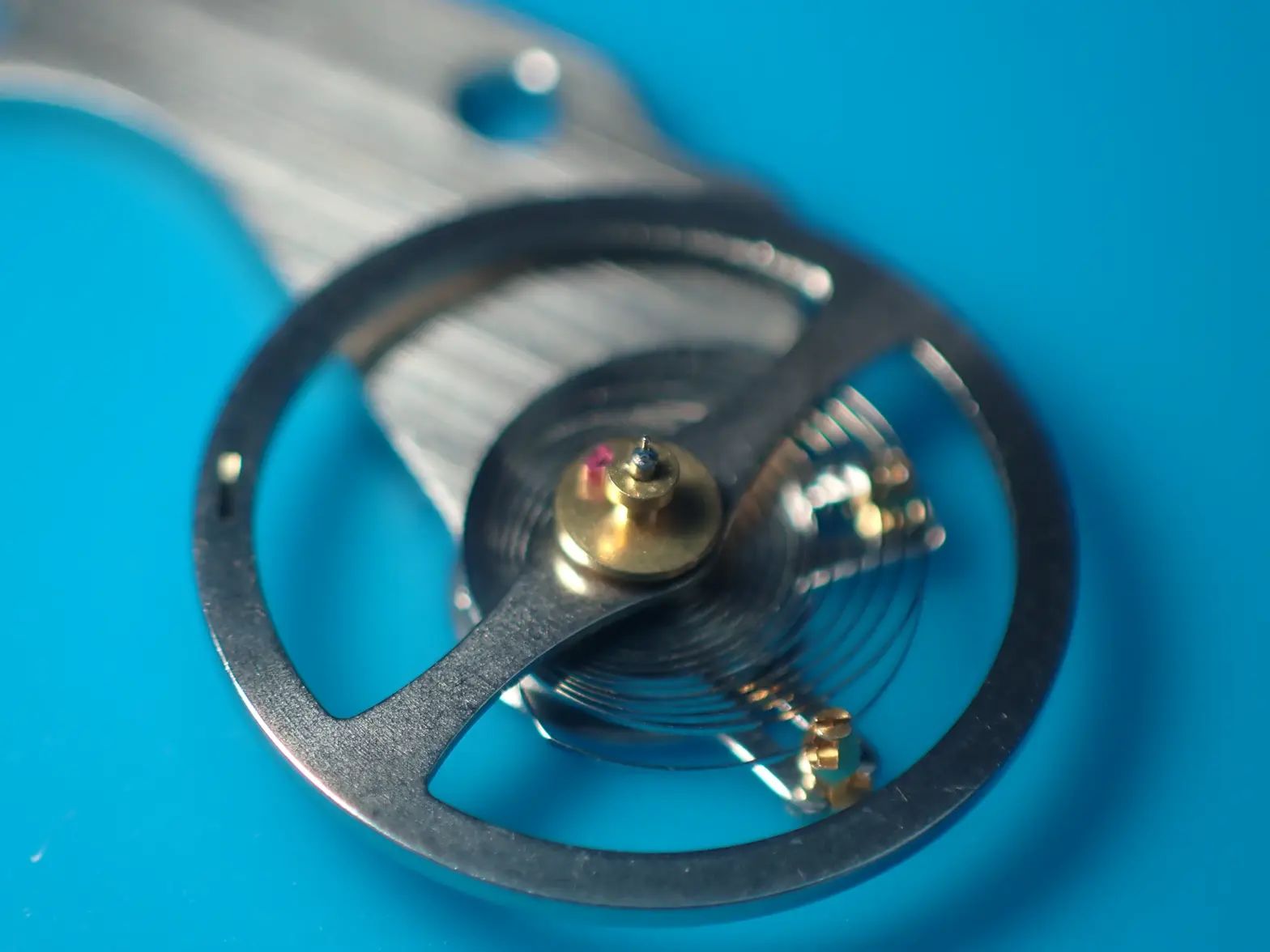

In the pic above, is the balance pivot sitting in the jewel and not just on top of the balance cock?

I swapped over the balance and I think we've found the culprit.
I guess I must have somehow messed it up...

I was beginning to suspect hair spring after I saw it laying down in that previous one (like Jim asked about!). You should try to place the pivot in the cock and look at the spring in the microscope. I got a feeling you've either bent it up, or, more likely, got itdoing an extra trip around the regulator screw or something.
IF so, you can likely gently just move the bridge and balance around to untangle it a little without getting into too bad shape.
