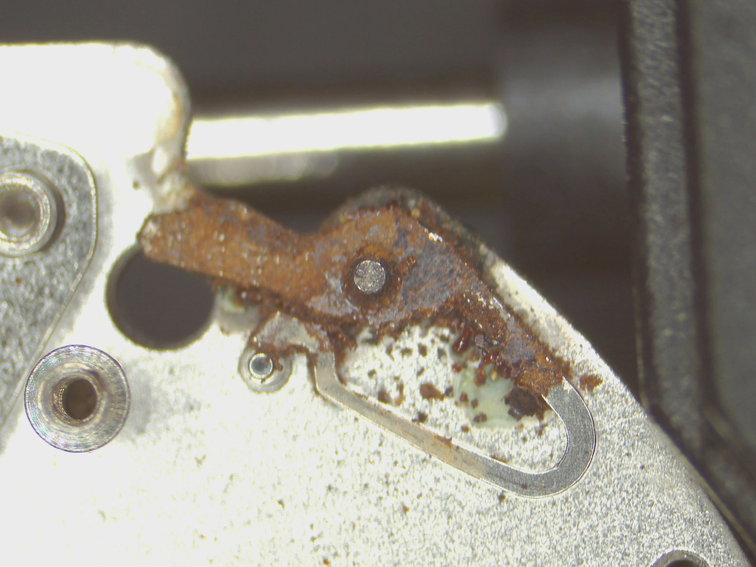

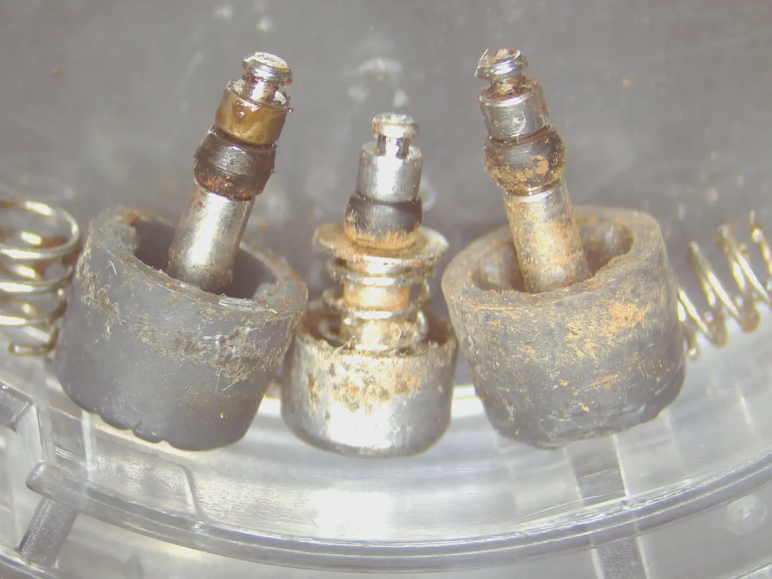

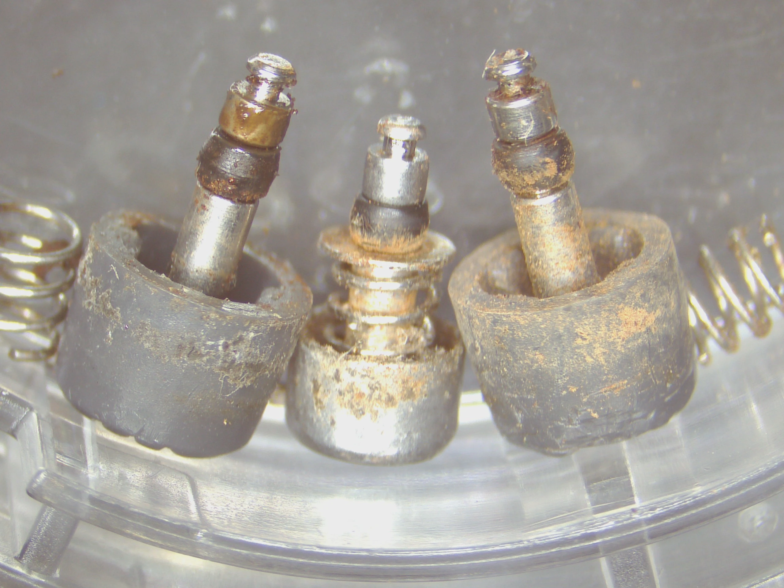

However, after opening and removing the movement and pushers, I needn't have bothered. The pusher on the left does not have any lube on it, just H2O.
Pusher seals had ceased to function as designed and the result was the reason the watch didn't work, the "chrono start" switch lever was frozen solid with rust.
馃槵
Some cleaning and treatment with Bergeon Rust Remover and I think it'll be fine.

I've done lots of 7A's and yep, the pusher seals are not good and have often let water in. Which is a shame as they are a lovely movement to work on, probably my favourite quartz. Metal wheels abound rather than the more recent plastic rubbish; it is built to a high standard. About the last Seiko quartz that was designed by the engineers and not by the accountants.

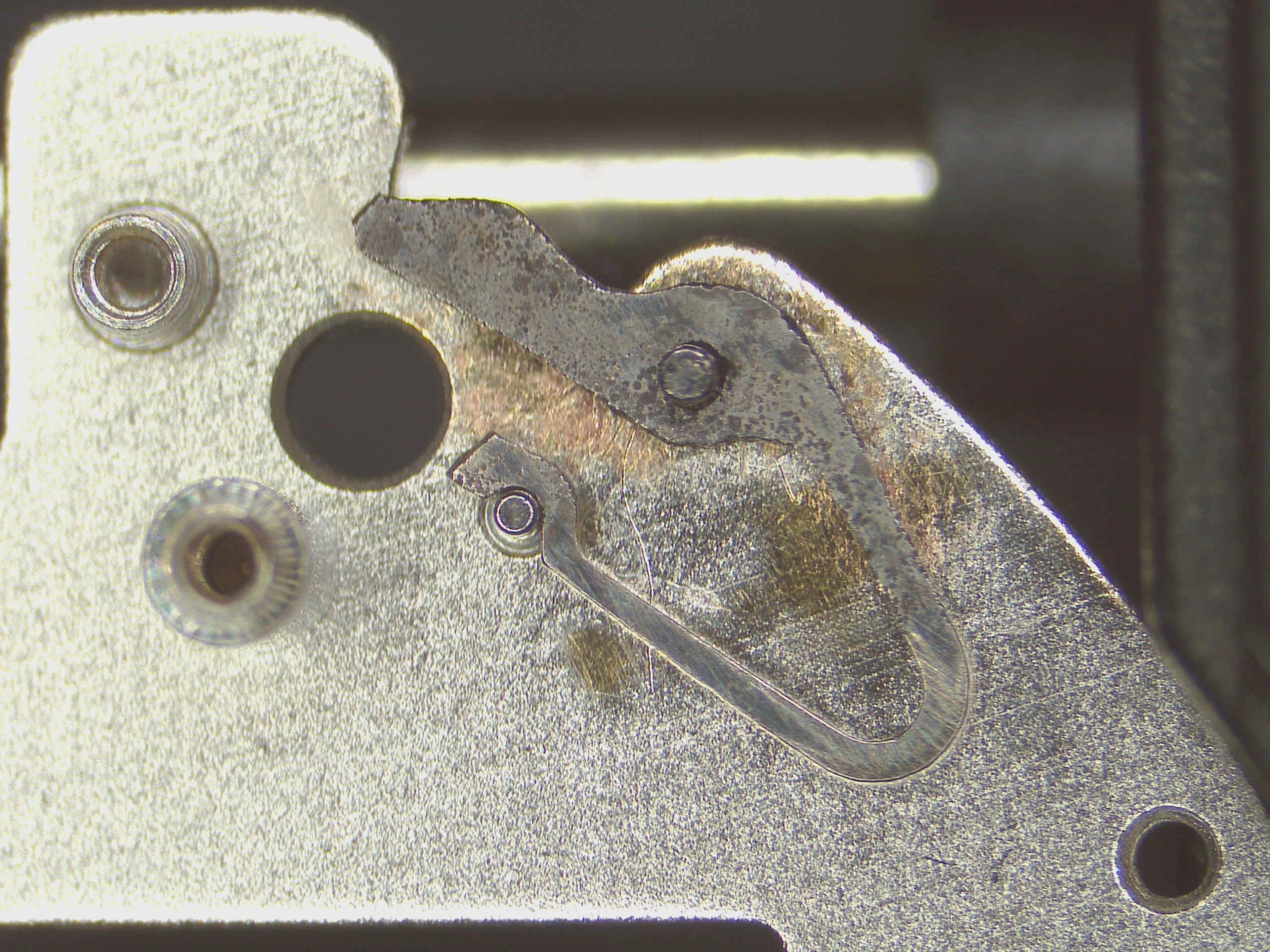

That's a good save on the spring, looks like that one will be fine for a good while yet.

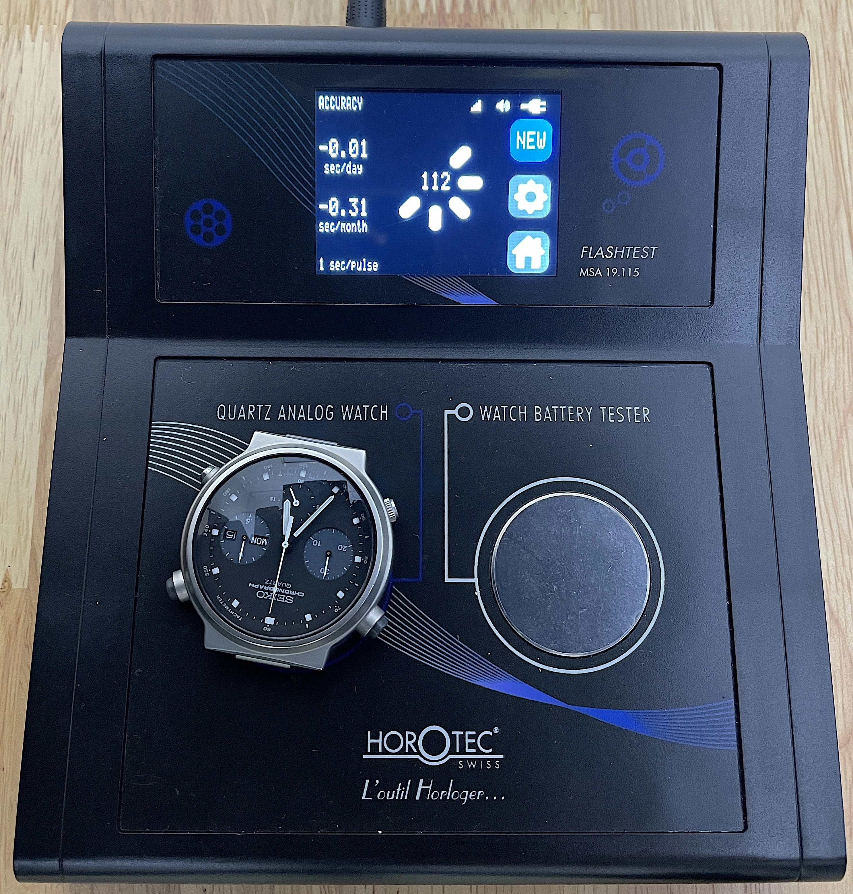

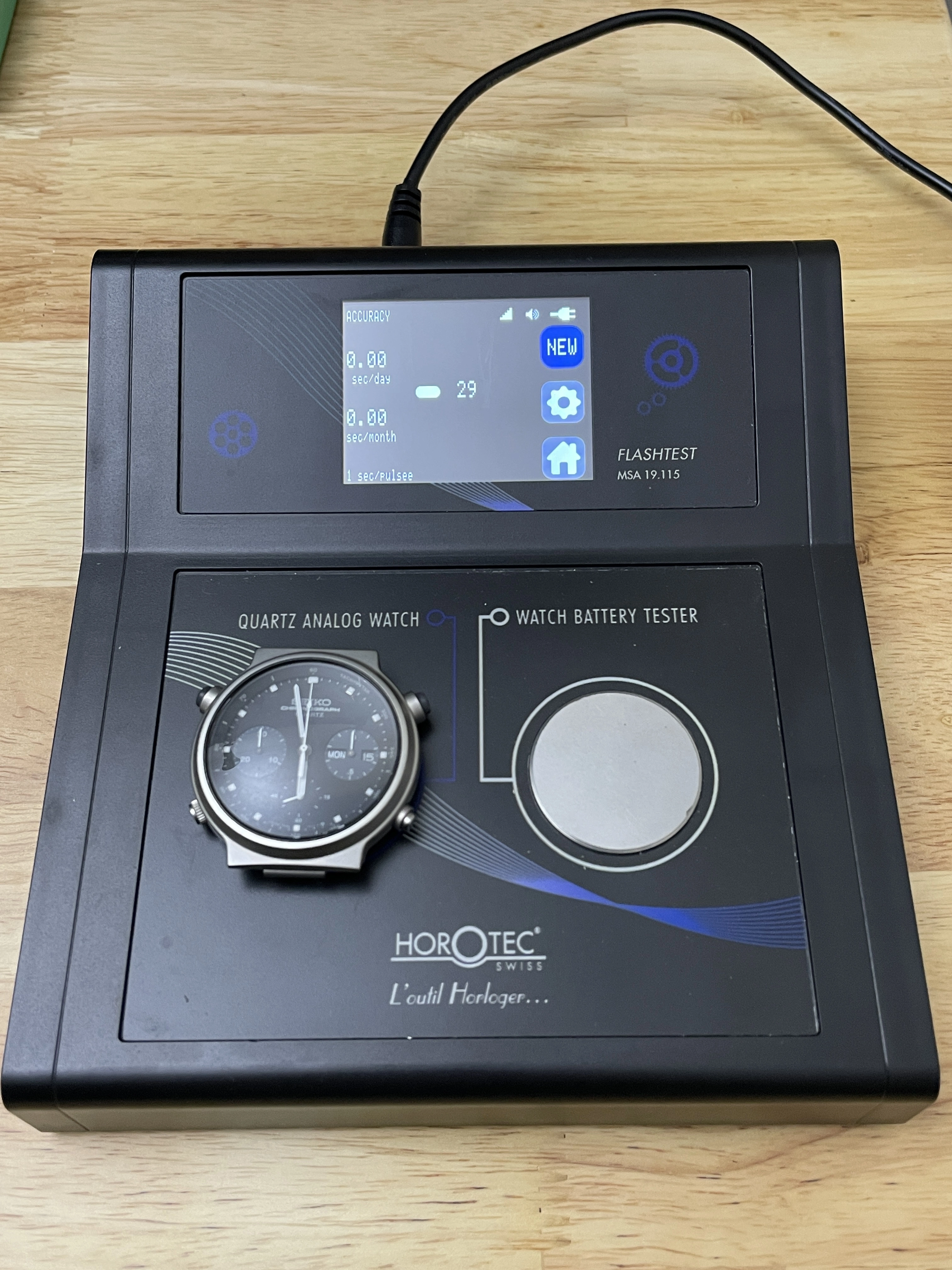

Not bad for a 41 year old quartz movement.
馃槈
I think I'll take it up a notch to get a + output.

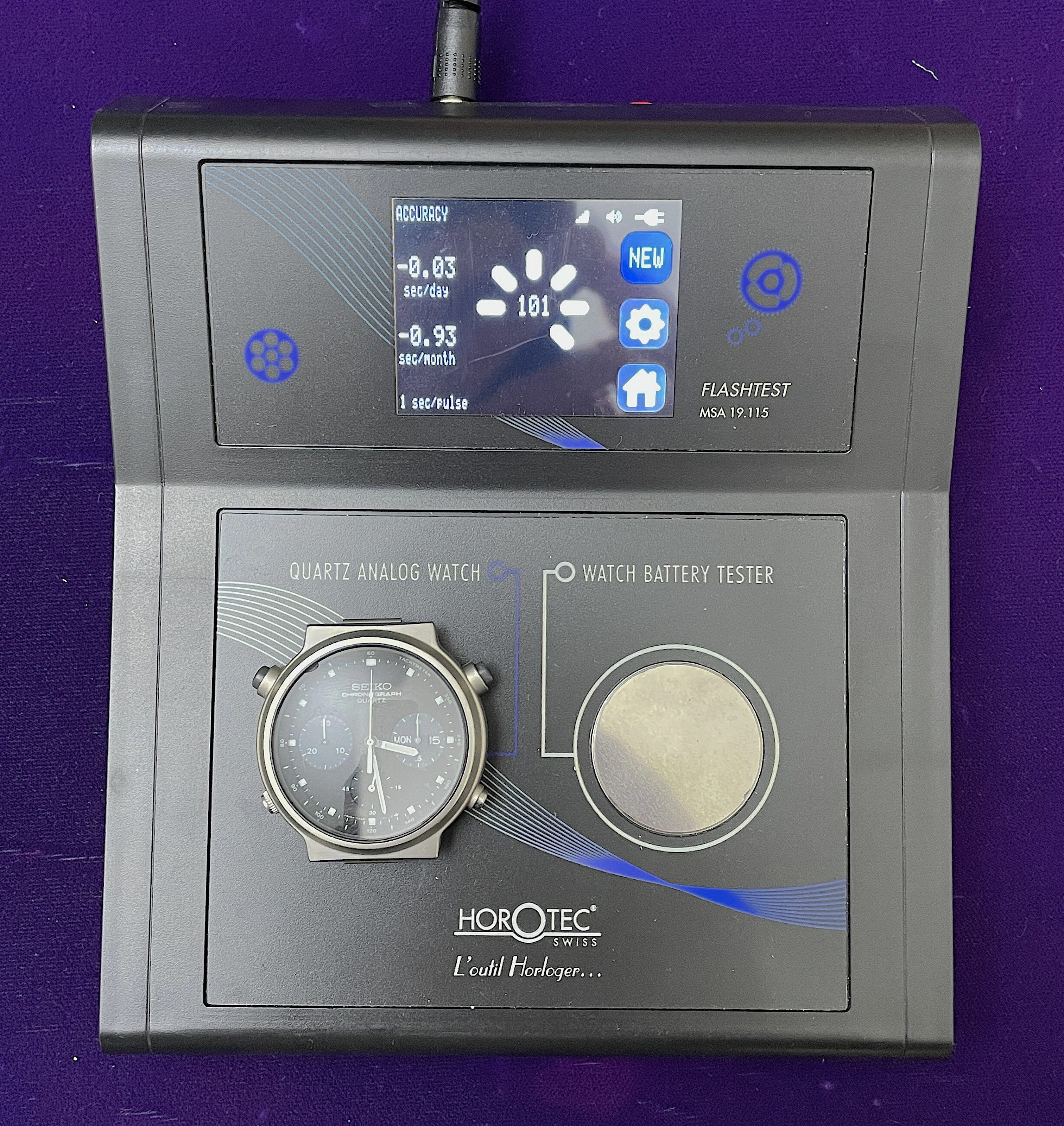

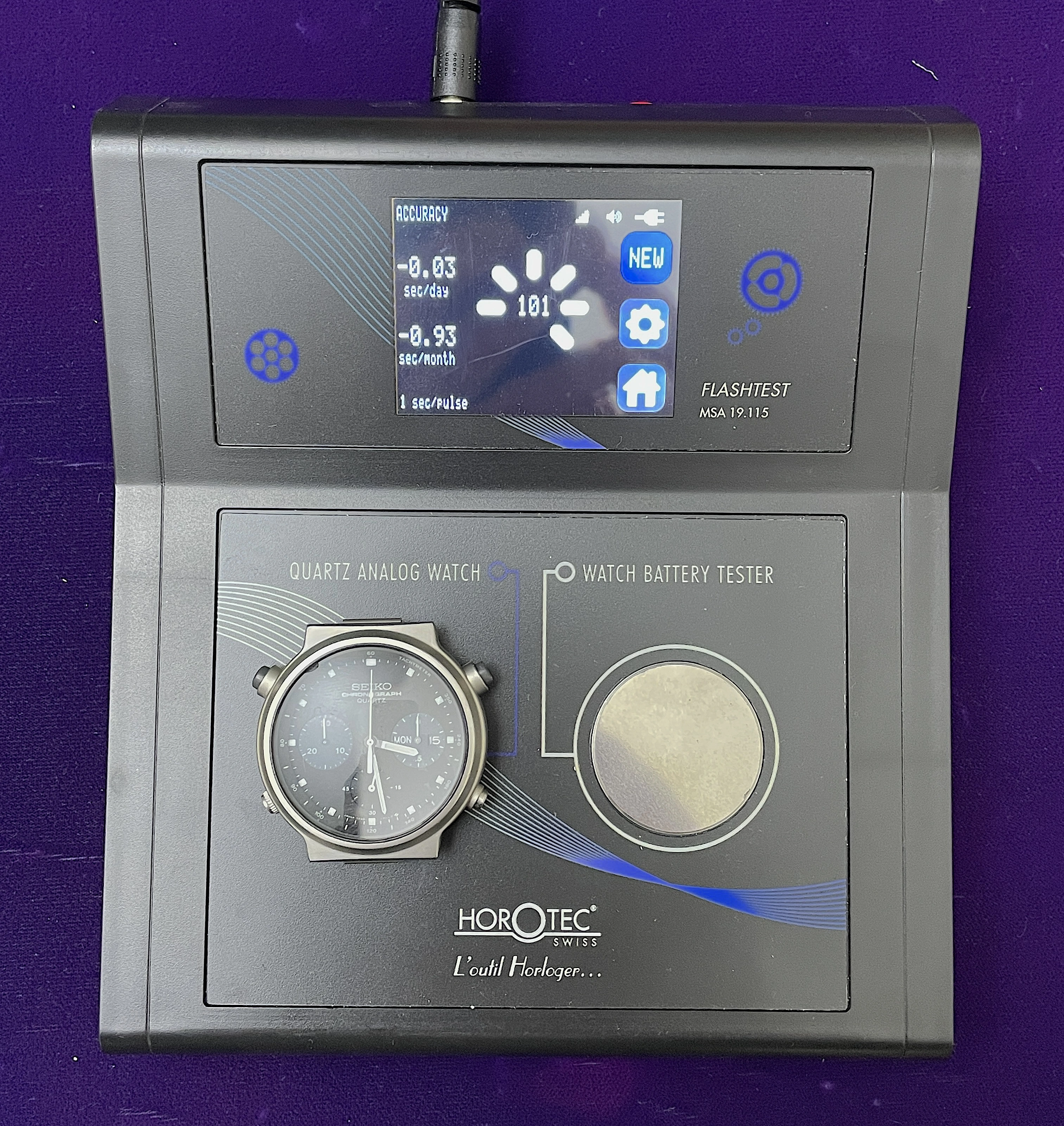

I think this is as close I'd like to go.
Still "losing time", but the next notch up on the rotary step switch takes it to +2.3 SPM.

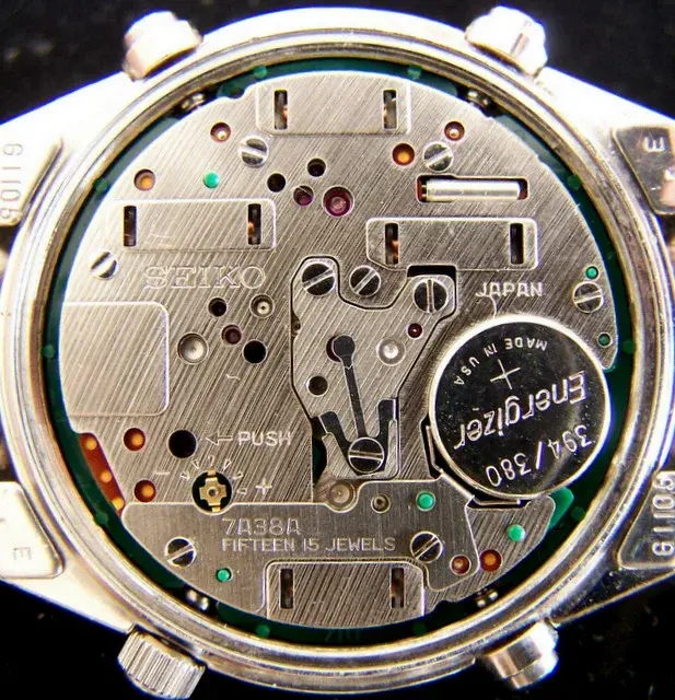

How are you advancing the timing? There is an adjustment?
There is an adjustment on the movement. See the below image. RIGHT above where it says 7A38A there is a little adjustment.

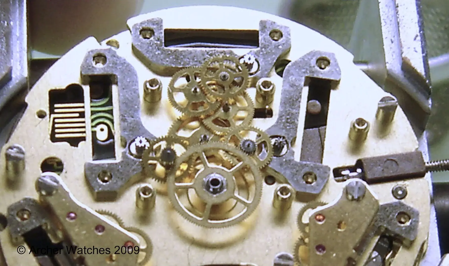

These can be tough - quartz are worse because the rotor always wants to pull to one side on you. This one was a treat...
10 pivots, including 3 rotors, plus 4 posts...all on one bridge.
