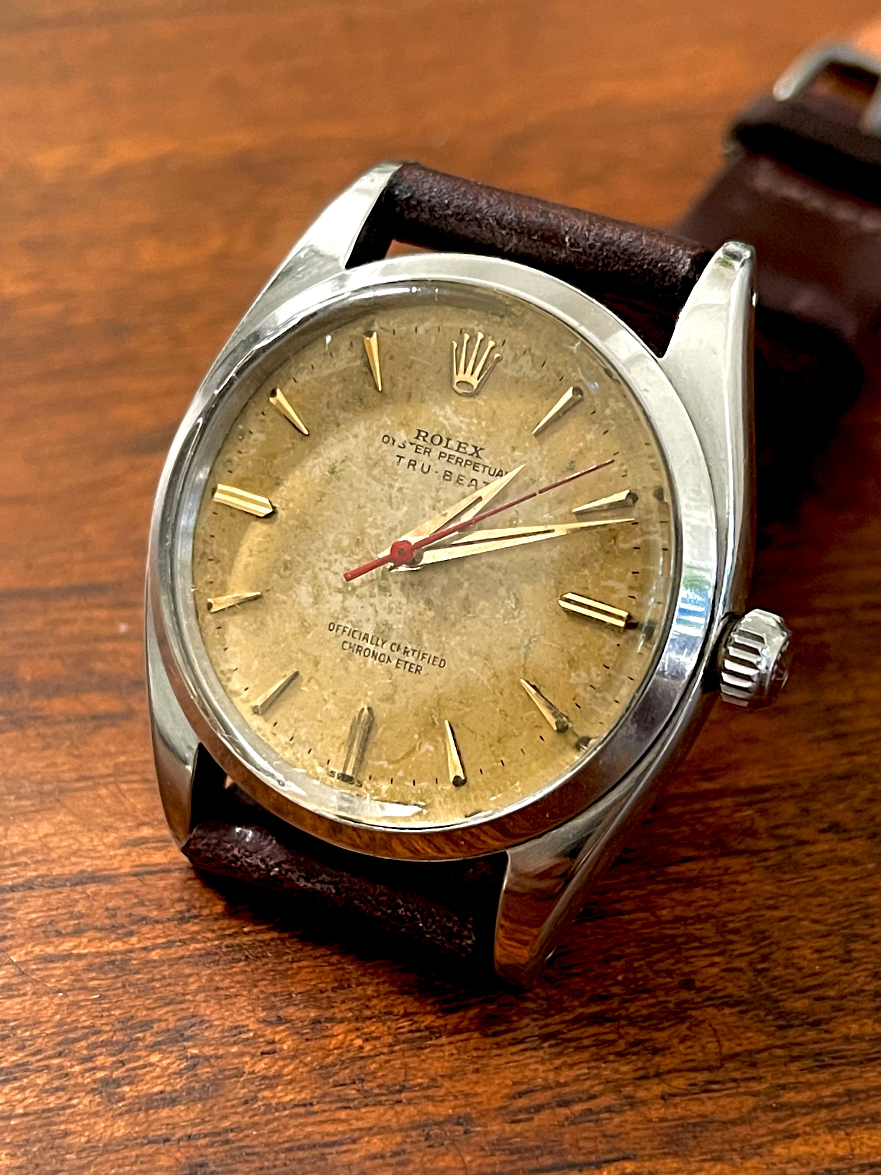

This is one of the last of the Tru-Beats. It is a 6558 with a 1962 Zepher style "Tru-Beat" Rail Dial T-SWISS-T.
I don't think I have ever seen another like it. The watch is a pain to get to tick correctly all the time.
Today was a rare day when it seems the mechanism is working for several hours without hitting
an occasional "glide" like an Accutron or locking up.
It needs to be worn just enough to keep it ticking properly without wearing it out quickly. The
case is in great exterior shape. A little pitting under the back cover, but overall one of the nicest
Tru-beats I have ever seen in person. Sorry about the pin sticking out, didn't notice the braclet
was coming off the bottom lug. Anybody know if these are going over $40K yet? I believe average
condition is going for $30K? I think the Tiffany sold at $40K in 2015.
This is a slightly hard to get 6558 reference and not the 6556 reference.

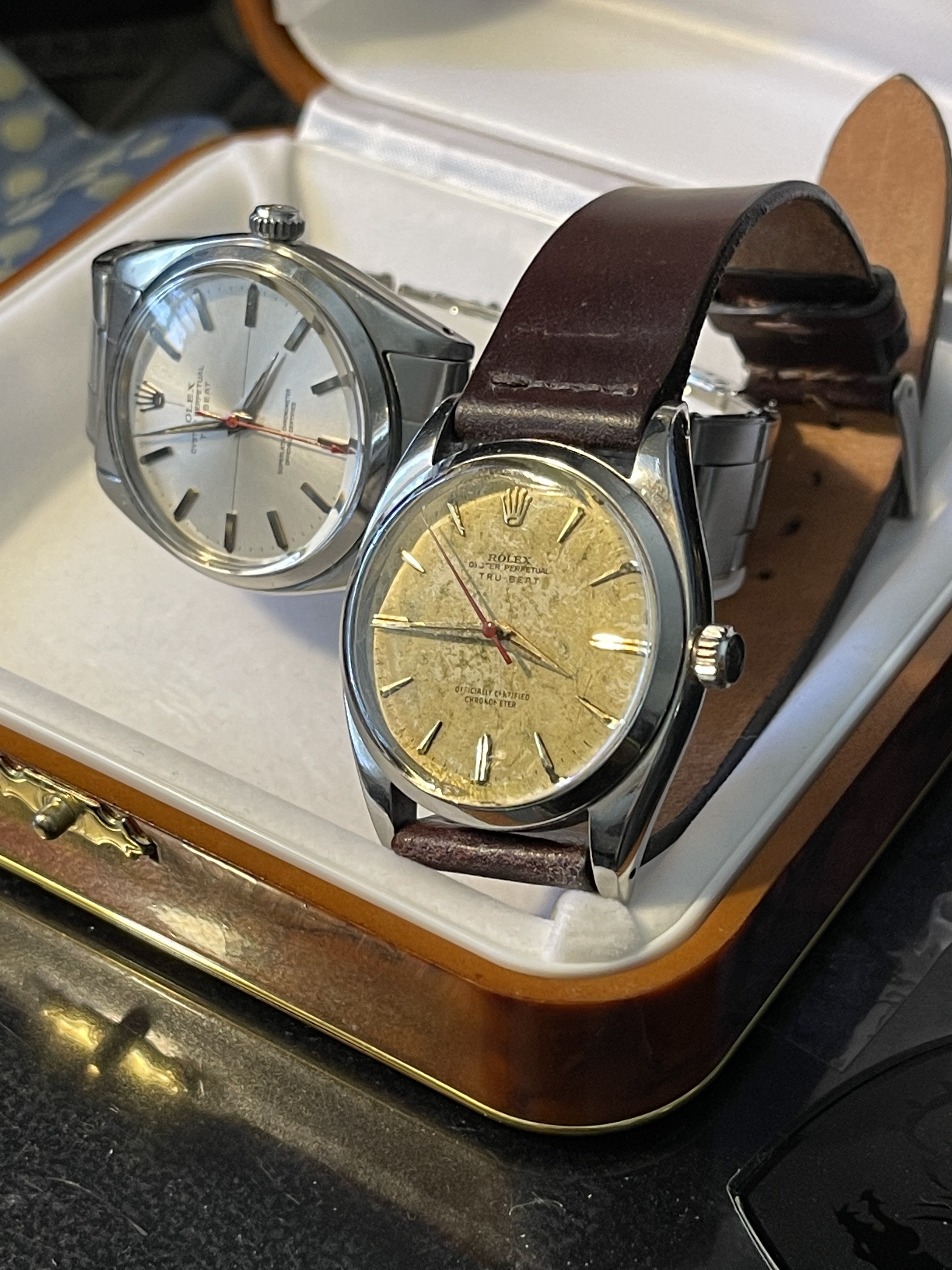

I have another project watch that is also Tru-beat but it doesn't have the dead beat seconds.

I think I forgot to mention the best part of the Tru-beat, it has the very desireable and hard to get "Tru-beat Arrow" second hand. This is unique hand to the Tru-beat.

I gave the watch to my watchmaker and allowed him to take apart three Tru-beat donors. One was fully working by the way. I wanted to have him get this 1962 6558 working. I had him strip for parts a 6556 from 1952 and another 1950s OP that happened to have a 1040 in it. The gears wear out, the springs wear out, the 1040A and 1040B are not exactly the same. Too much oil, it doesn't run, not enough oil, it doesn't run. Slightest misalignment and the seconds hand doesn't snap to each second. Yeah, I can see where it was just too much trouble back in the 1960s to service them. Most likely the number of customer complaints probably ended the model quickly.
It took my watchmaker three tries to get it to tick properly (fully disassembled and reassembled). I don't think he ever wants to see the watch again. My example may have been particularly tough because of the 1950s Tru-beat 1040A parts in a 1960s 1040 B base movement.
