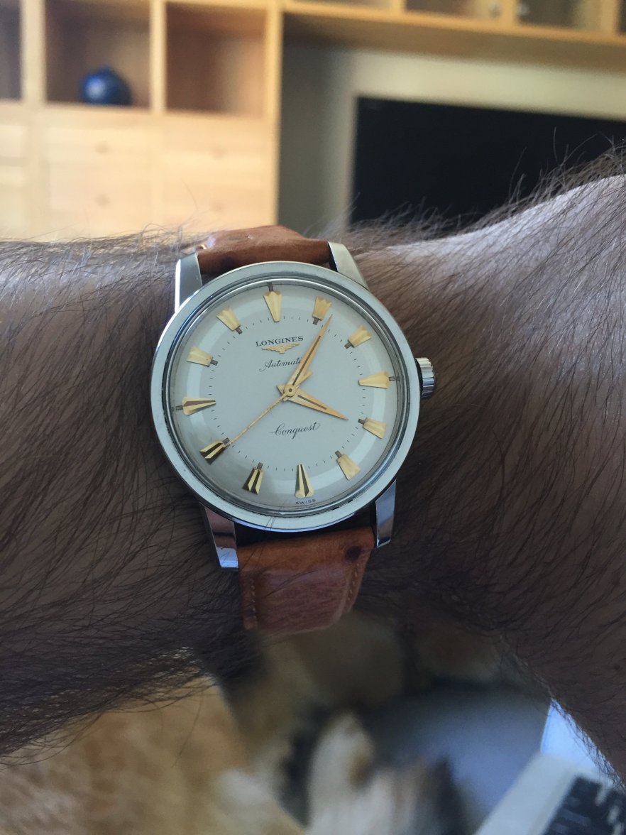

    Thought I would close out this thread with a quick update on the resolution. After seeing this post, @Barking mad was kind enough to reach out and offer to sell me the exact reference I was looking for from his collection. Within a week of beginning my search, I was able to obtain a great example at a great price and was, in the process, spared a potentially long search and all the headaches that go along with it. This for me is one of the reasons I think this forum is so great and why I check it almost everyday (even if I don't post much). Thanks Pete and thanks OF and mods for making it possible and keeping this place going.
    I already posted this in WRUW on Sunday the day after it arrived, but thought I'd provide a little more detail here since I am quite pleased with how it turned out. Wrist shot below:

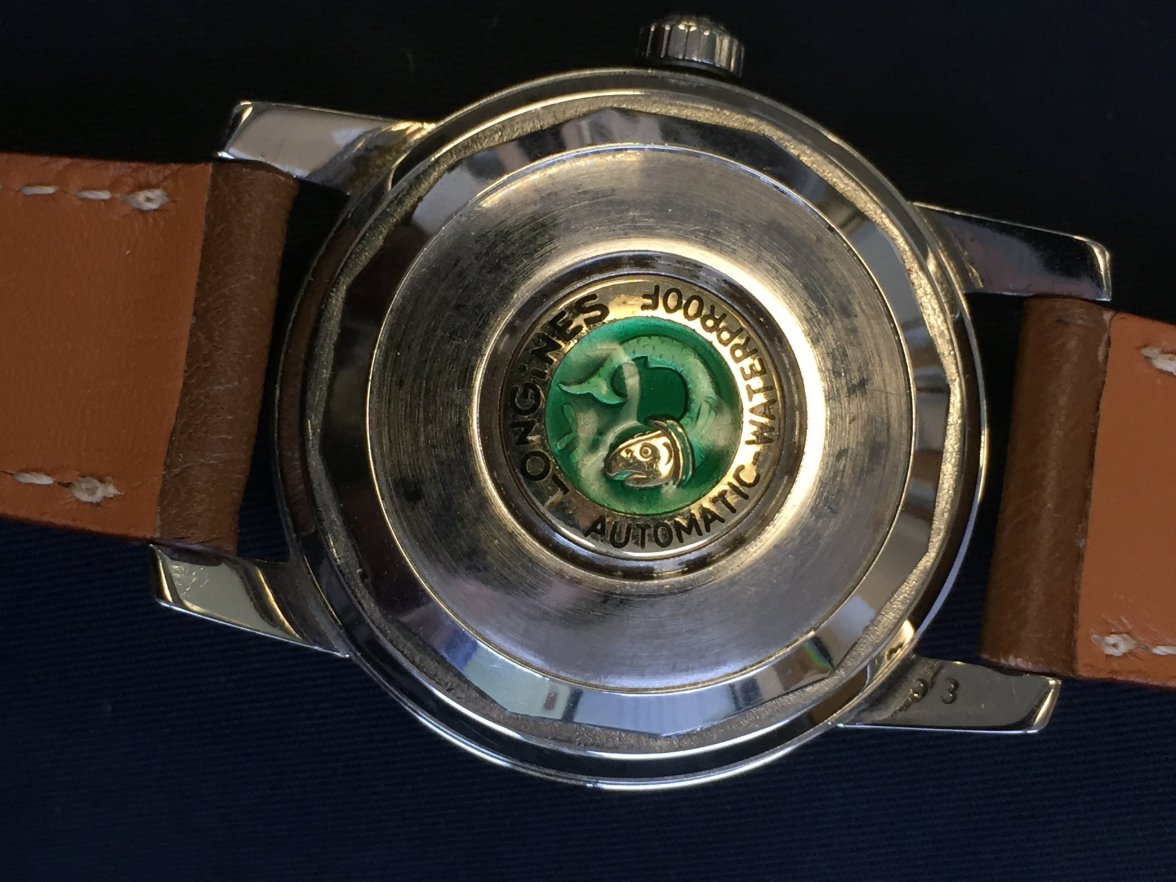

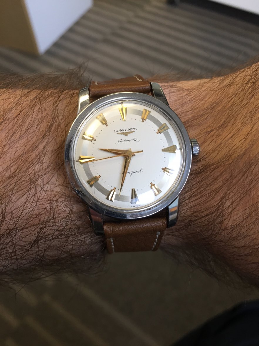

    Awesome watch! Big fan of the black dial and Longines bracelet. I have included a caseback/medallion shot below (apologies for the lighting), as requested, as well as another wrist shot on the new B&S strap that I ordered for this watch. Thanks all!
  18. Kmart Apr 12, 2017
    1,228
    3,770
    That medallion is awesome.::love:: Coolest one around in my opinion, even more so than... dare I say it... the Constellation :eek:
