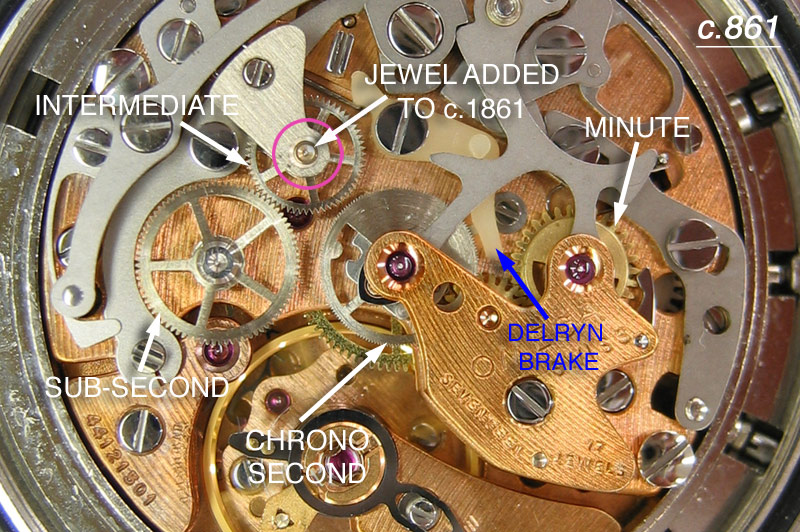

You mean like the brake made out of Delrin in the 861, which is a high tensile strength synthetic plastic if I'm not mistaken?

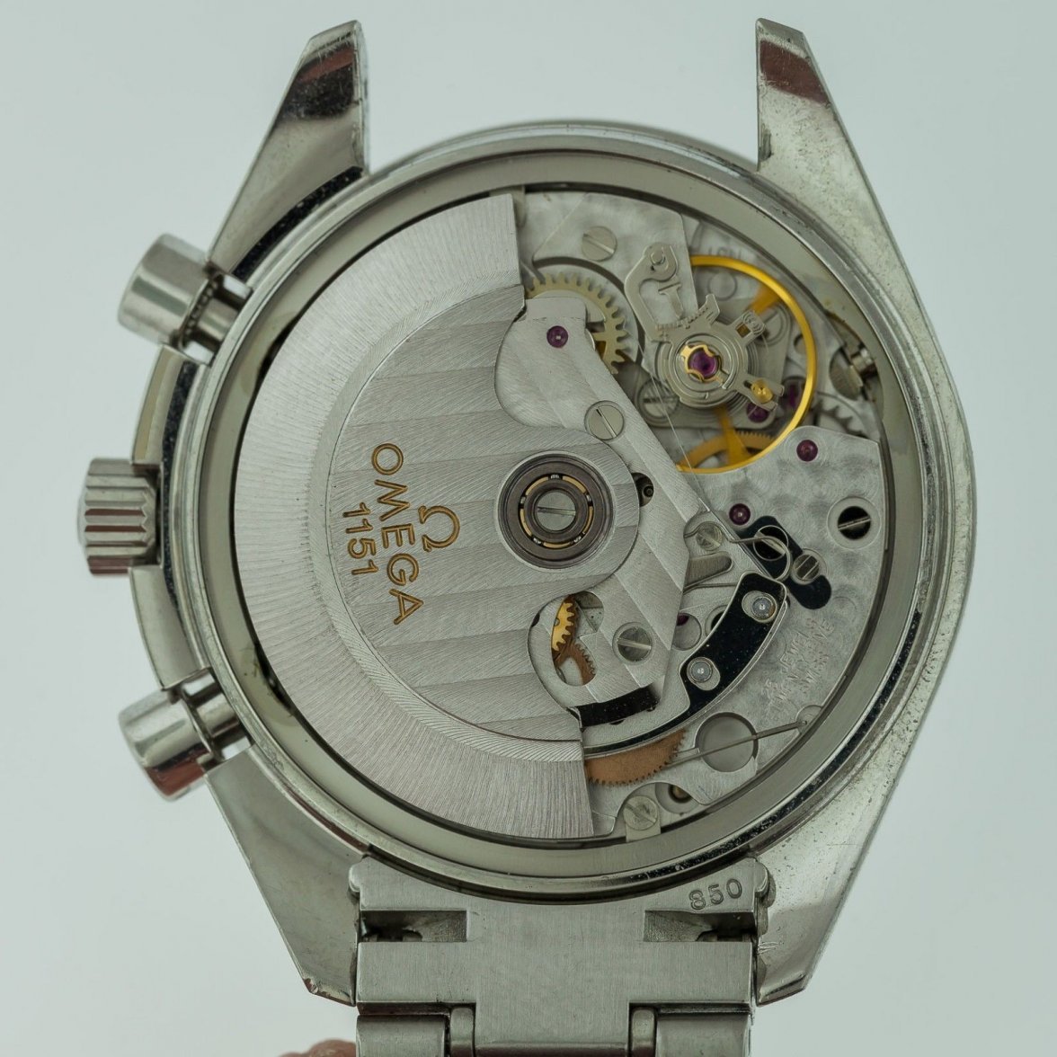

And compared to this 馃檮
453
605
Hey you just said like the one with plastic? Not sure what movement that is, but this is the 1151 Triple Date, just where is the plastic, I'm sure it's in there somewhere? Archer, where is the Delrin?

Hey you just said like the one with plastic? Not sure what movement that is, but this is the 1151 Triple Date, just where is the plastic, I sure it's in there somewhere? Archer, where is the Delrin?
