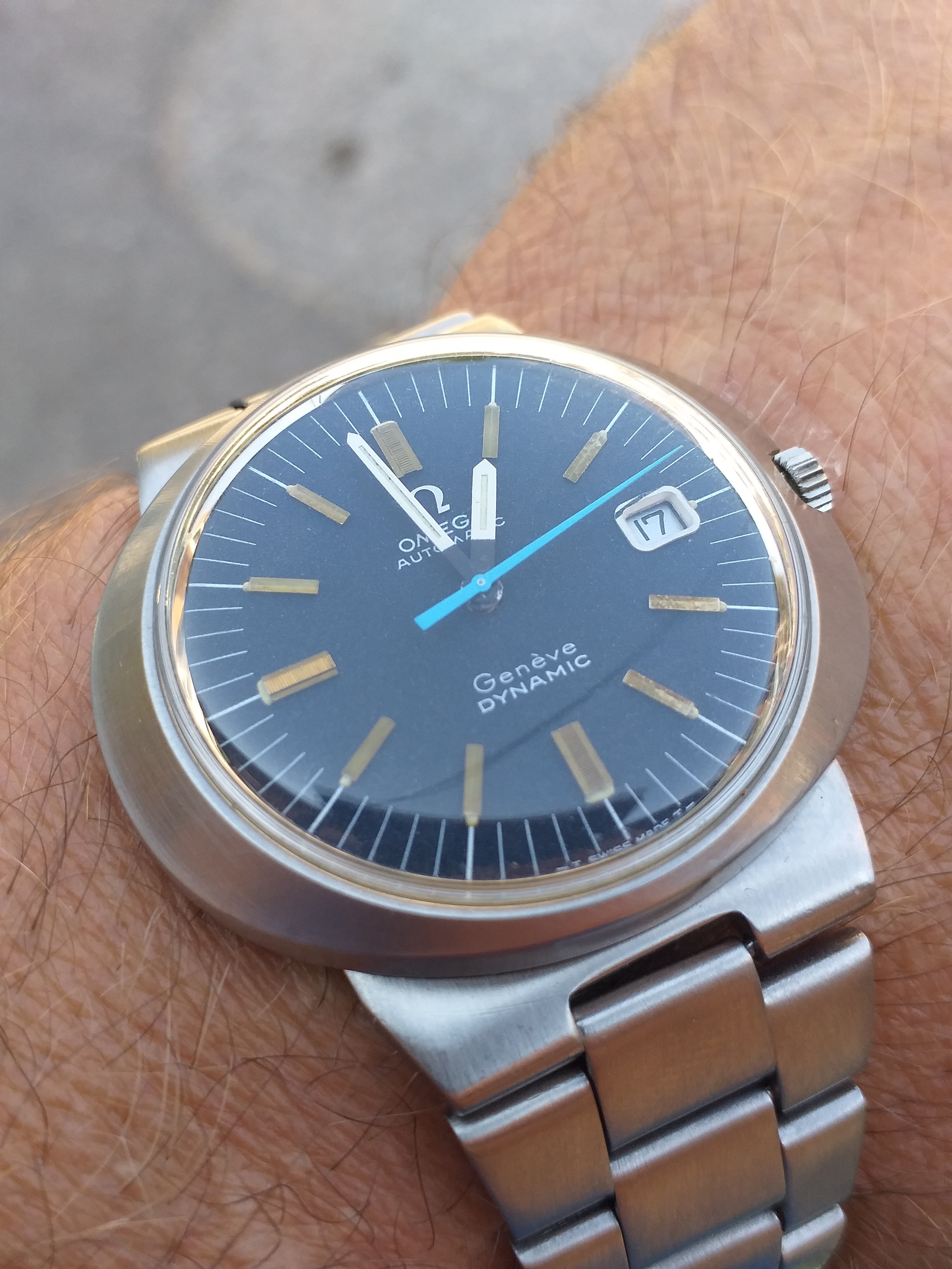

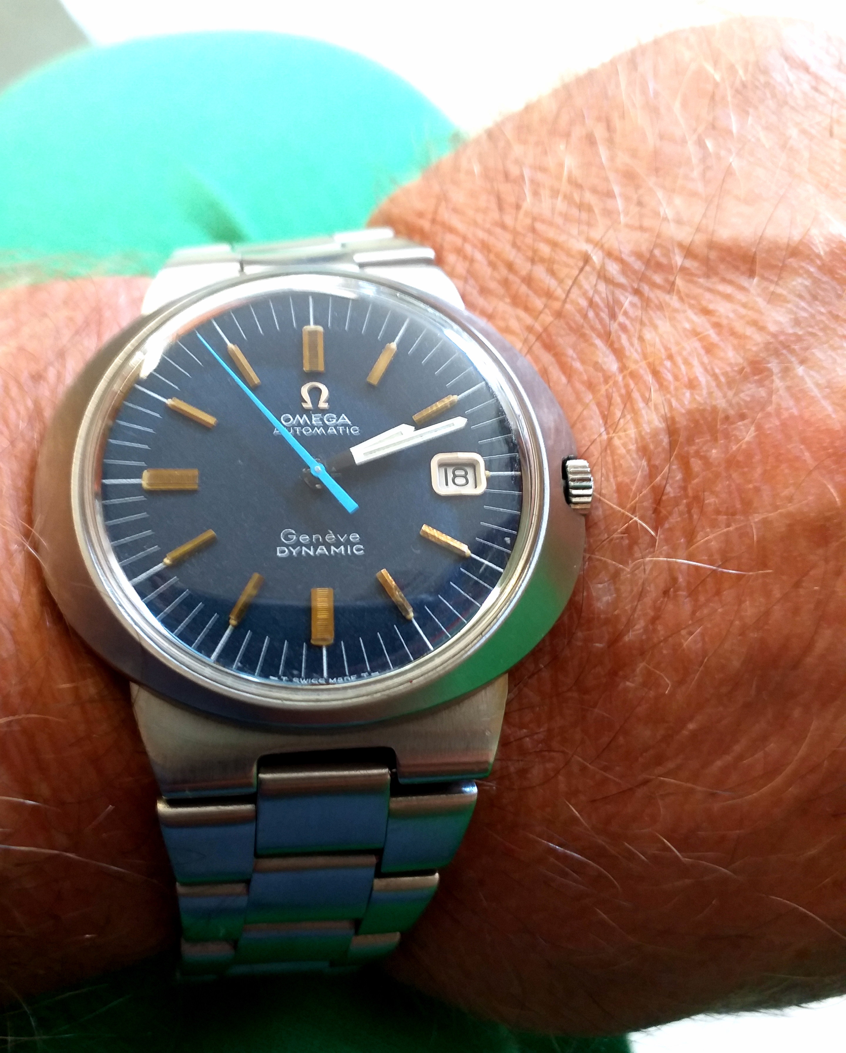

Seeking info on an Omega Geneve Dynamic online purchase.
1,754
15,022
The dial is redone, the case dont look like any known Omega Dynamic model as far as I know.
It should be a cal. 752 or 1022
792
845
OP, I wouldn't take any of the comments the wrong way. Being a community filled with many collectors, they are all passionate about watches and asking for more information may have spiraled in a way you didn't expect. It happens to the best of us starting out. When I made my first few purchases, I made some mistakes that members of the forum were graciously able to enlighten me about. It wasn't always what I wanted to hear, but it was what I needed to hear.

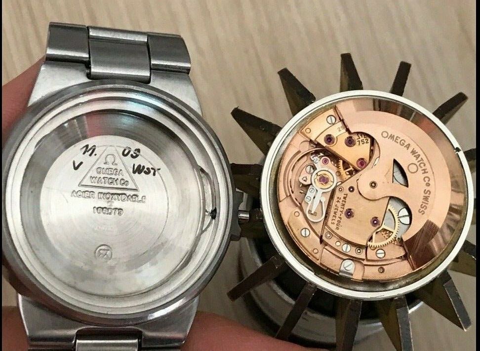

That being said, you asked if the watch was "fake" and for any issues, so I, like others, will be straight with you. At first look, it does seem like others say a machined 166.079 case. I also believe that the dial is not original and is a repaint. The lack of "Dynamic" and the font look odd to me. I took some time to check ebay and I actually came across this watch's listing. The markings inside the case don't look the ones I've traditionally seen on dynamics, so it may be possible that this case is not original.
Now these problems aside, if you like it and don't care about these few "originality" issues, then you don't have to worry about it. in purchasing the watch, your personal happiness is what matters---just expect some collectors to not see eye. I liken it to fun rat rod vs a classically restored or original '57 Chevy. Alot may like and enjoy the hot rod, but the collectors and hardcore enthusiasts will look down on it.
I do want to say one thing though, I can now see how much you paid and I want to give fair warning. I won't share it because its not mine to share, but for me personally this watch would be worth substantially less than an original and the price you paid can get you a nice original in great shape. You have alot of value between the cal 752, dynamic hands (which are hard to get), and OEM bracelet, but not enough in my mind to justify your cost. If it was cheaper, It would be really easy for you to source a replacement case on ebay (they come up all the time). if you don't like a dial or find a damaged dial, its a matter of spending $100 and sending it to a refinisher (if you are fine with that). The same seller has another dynamic for the same price with the coveted blue "bulls eye" dial that actually looks all original at first look.
In the end of the day, it is up to you and what you like. Next time, If you seek something all original, I would consider posting here in advance and everyone can give you an unadulterated view. I'll even be willing to personally review some posts for you, if you want to DM me. I'm not a pro like others, but I have learned what to look for and can weed alot of things out. Good luck and best wishes.

Must say, my first post here has succeeded in making me despise my new watch.
It’s apparently “mangled” and “looks strange”.
Probably fake.
Wonderful.
Mission accomplished.
I’ve written the seller to see if he has any further information on the watch. If not, and in the light of the fact that the experts suggest that it is an ugly watch at best and a forgery at worst, I’ll request a return.
Well, you did ask...
"I haven't seen another one like it and was hoping that someone might be able to tell me a bit more about it."
This might sting now, in particular if the seller refuses the return, but this is education for you. First thing is, do your research before you buy. You aren't the first one to buy a watch and then ask questions, only to find out it isn't right, and you won't be the last.

@Archer any thoughts on these case markings? It doesn't look like the dynamics that I've seen in the past, but I know Omega cases sometimes differ if there are multiple case manufacturers on older models.

Ref 166.079 is a standard Dynamic cal 752.

Yep. That is what this reference should look like, apart from the day/date window of the cal.752 versions.
No idea if the OP is still around, but he seems to have a "genuine" Omega that has been butchered and redialled. The case might even be a third party replacement, but it's so odd that it's hard to tell from the available pics.
If OP is wary of internet "experts", I have been collecting and analyzing this model for around 10 years. Never seen anything like this & the dial is 100% refinished.
If OP likes it & will use it, then he's getting some value out of his watch. If he wants a "genuine collectible", this isn't it - nicer ones are usually to be found with a bit of effort.

I think the OP feels under attack and has moved to a mental place where nothing we say will satisfy him, but I would add that he is under the false impression that he has no way of checking his movement. In fact there was a movement shot on the original ebay listing, and it is this photo that which @masteroftime shows above. Thus we can see that the movement is right for the model and certainly geniune, it is the cut down case and dial where the controversy lies since the case number shown there is indeed that of an oval case dynamic. The watch sold for circa £590/ $800, pretty steep noob tax.
