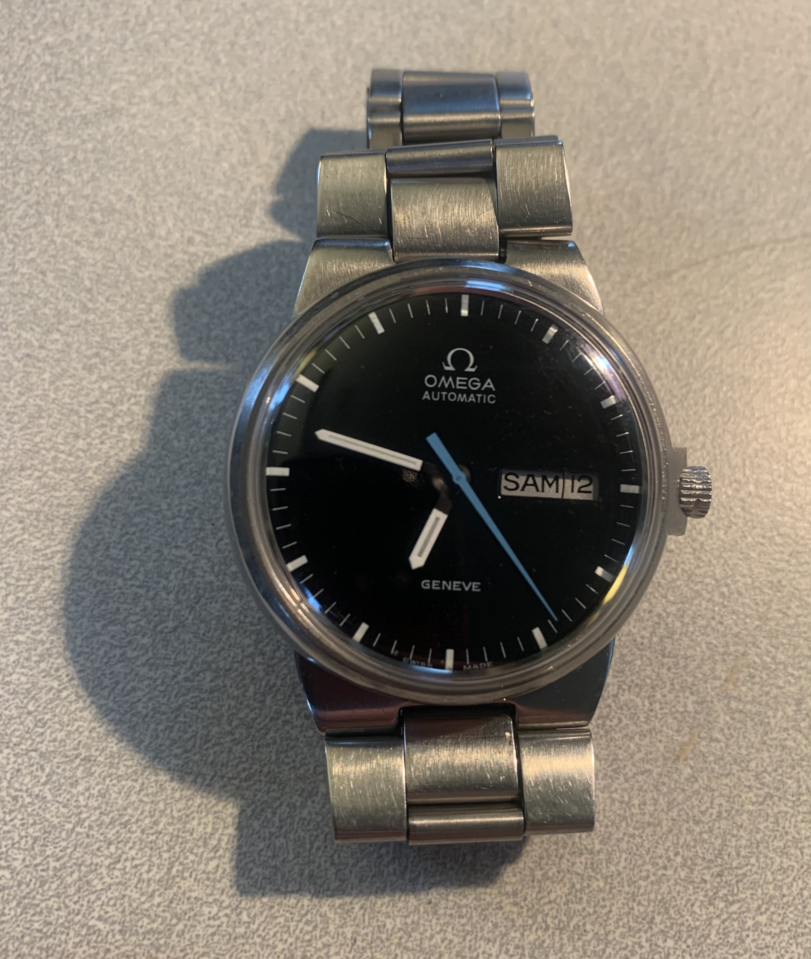

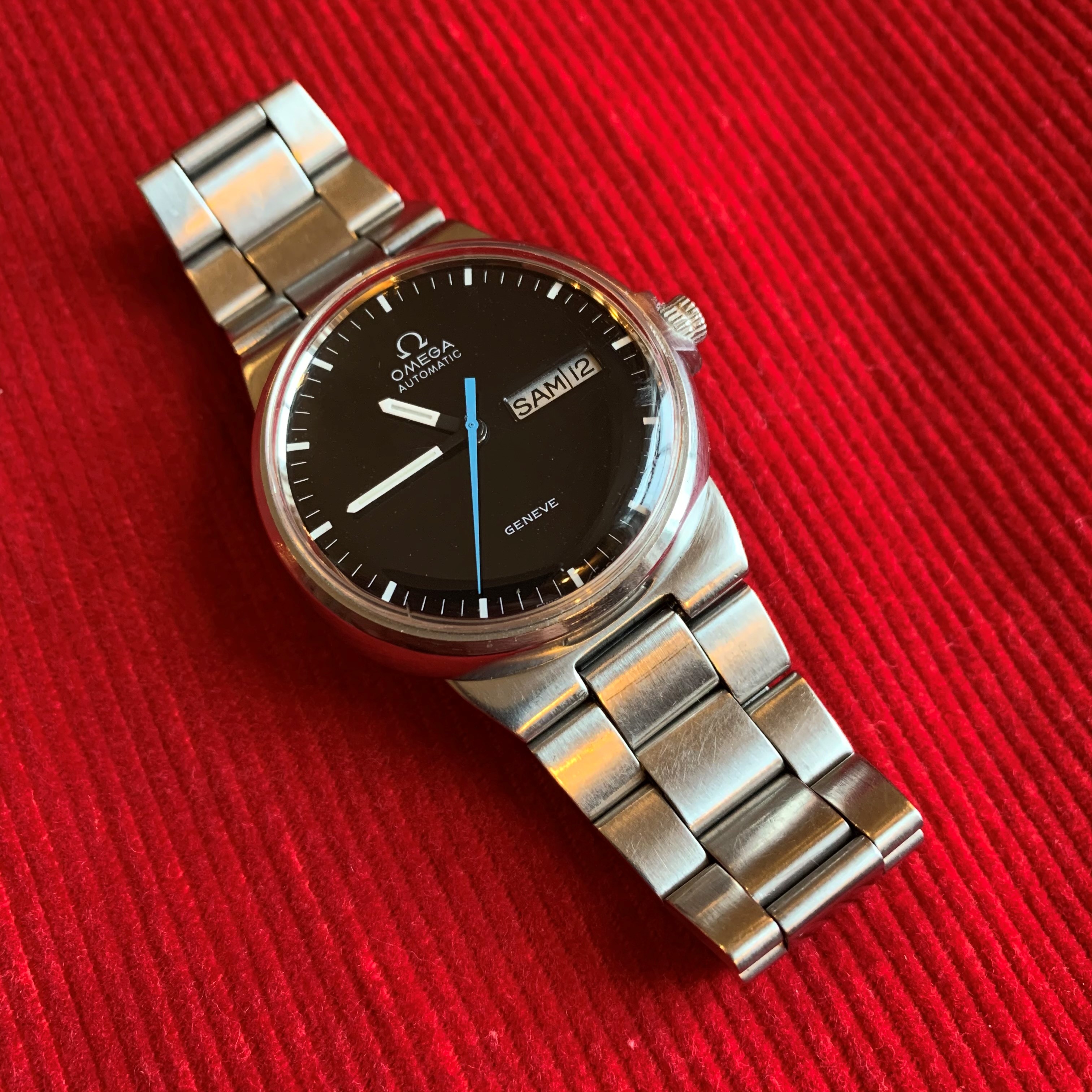

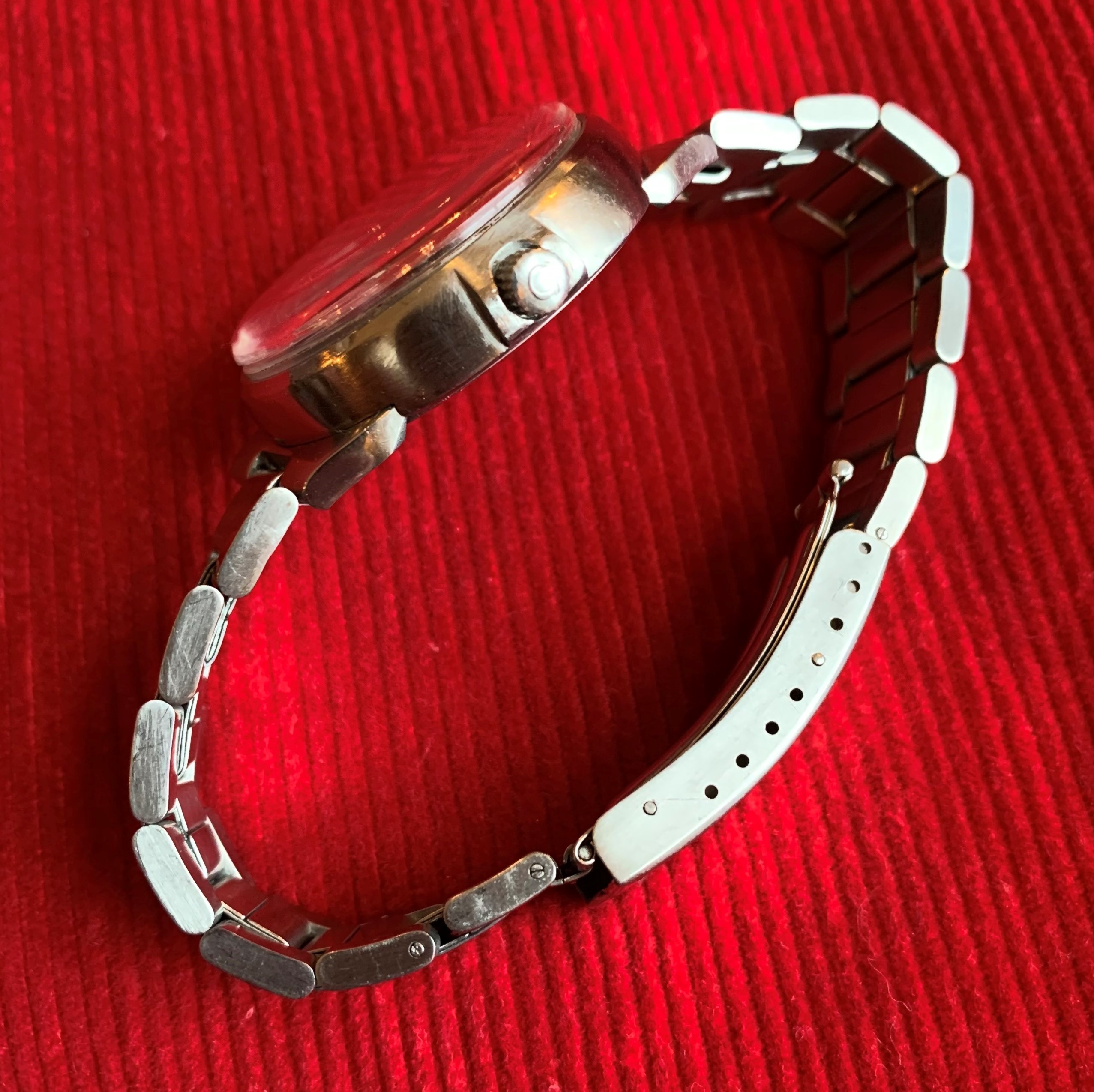

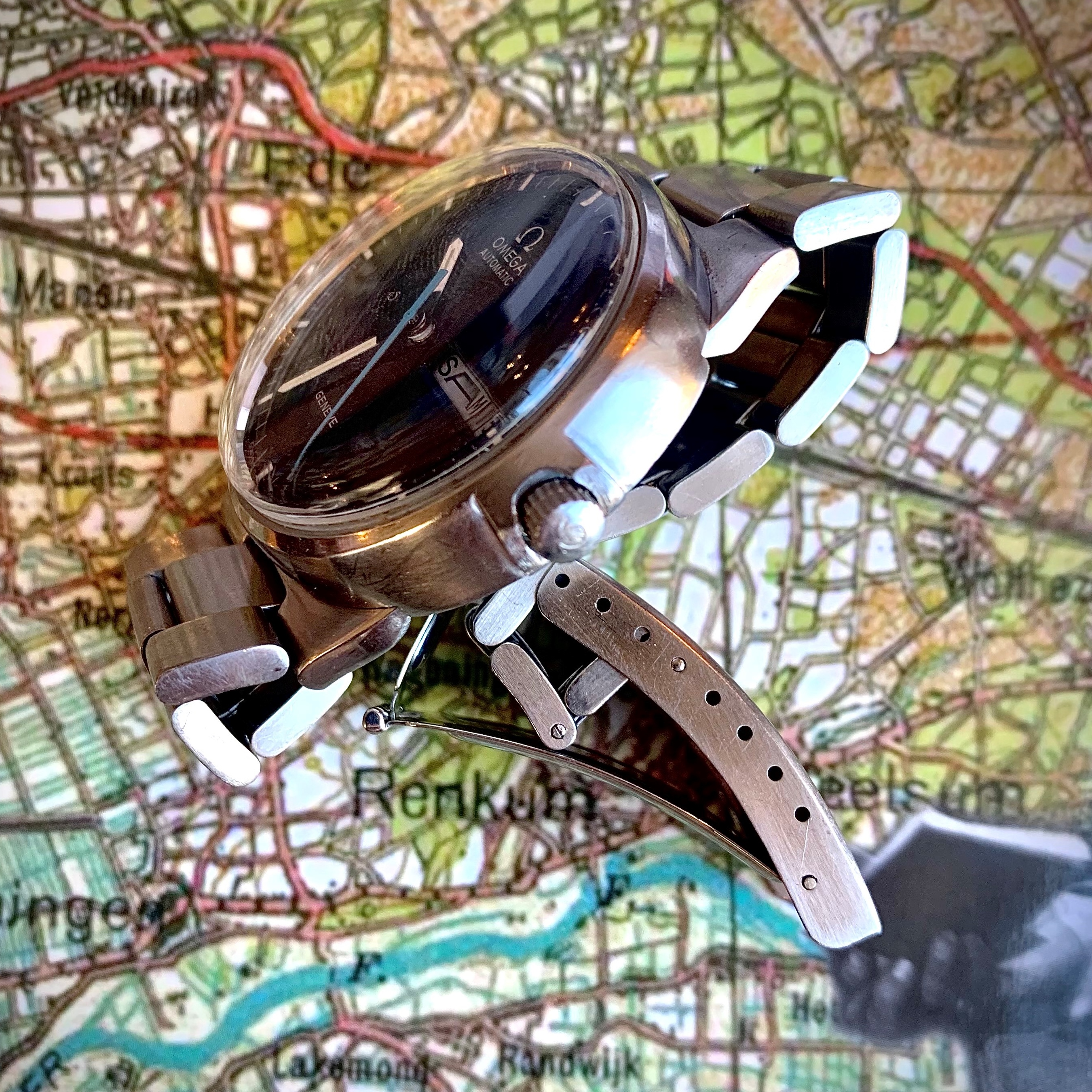

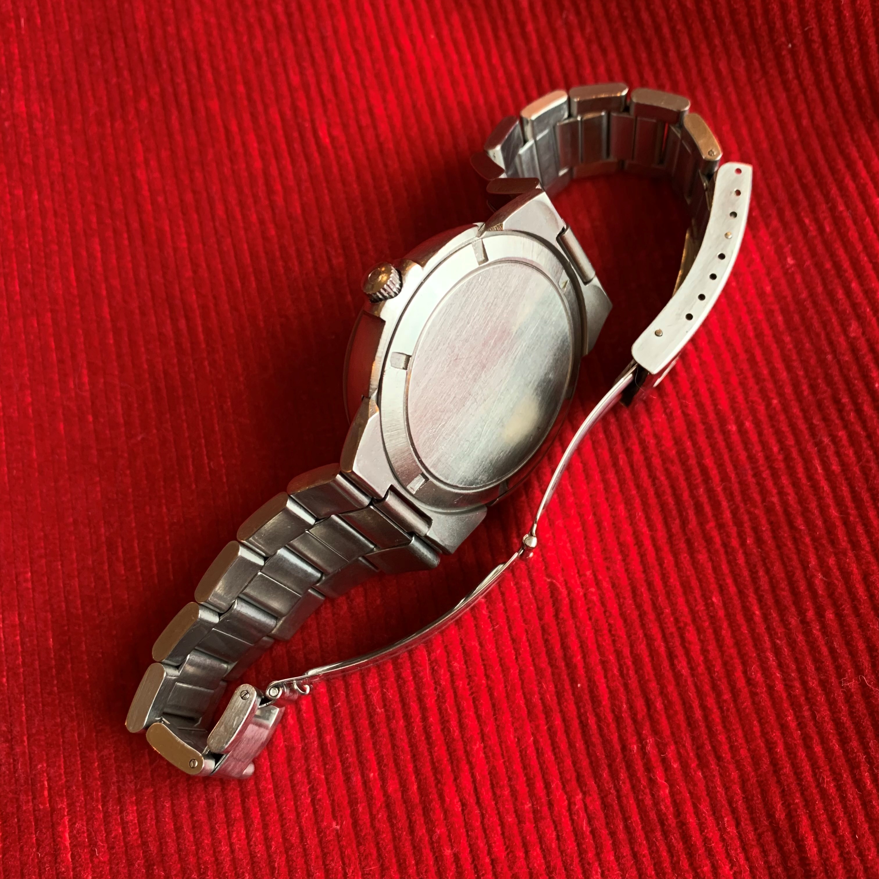

I had been looking to by a Geneve Dynamic and saw this watch offered online. I was captivated by the deep black face so I purchased it. The watch has a round face rather than the oval face of the Dynamics that I've seen.
I haven't seen another one like it and was hoping that someone might be able to tell me a bit more about it.
I have not removed the back because I don't feel qualified to do that. (I will, if it's safe, in order to get photos of the mechanism . . . but I'm concerned about breaking any seal.)
The watch face measures 1-5/8" from the crown. The watch is approximately 1/2" thick (including the crystal). The crown has the raised Omega logo.
I think the crystal is plastic? Not sure.

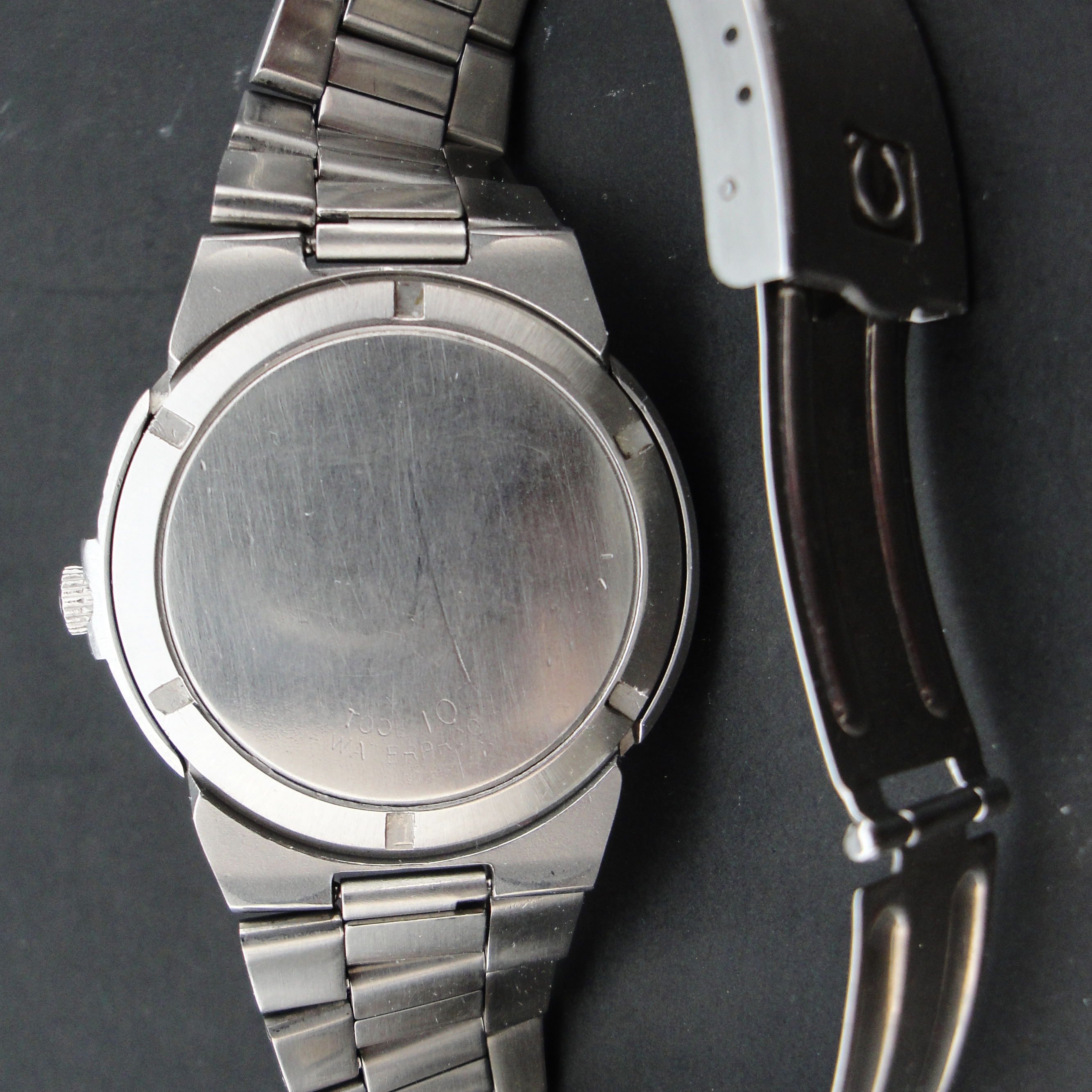

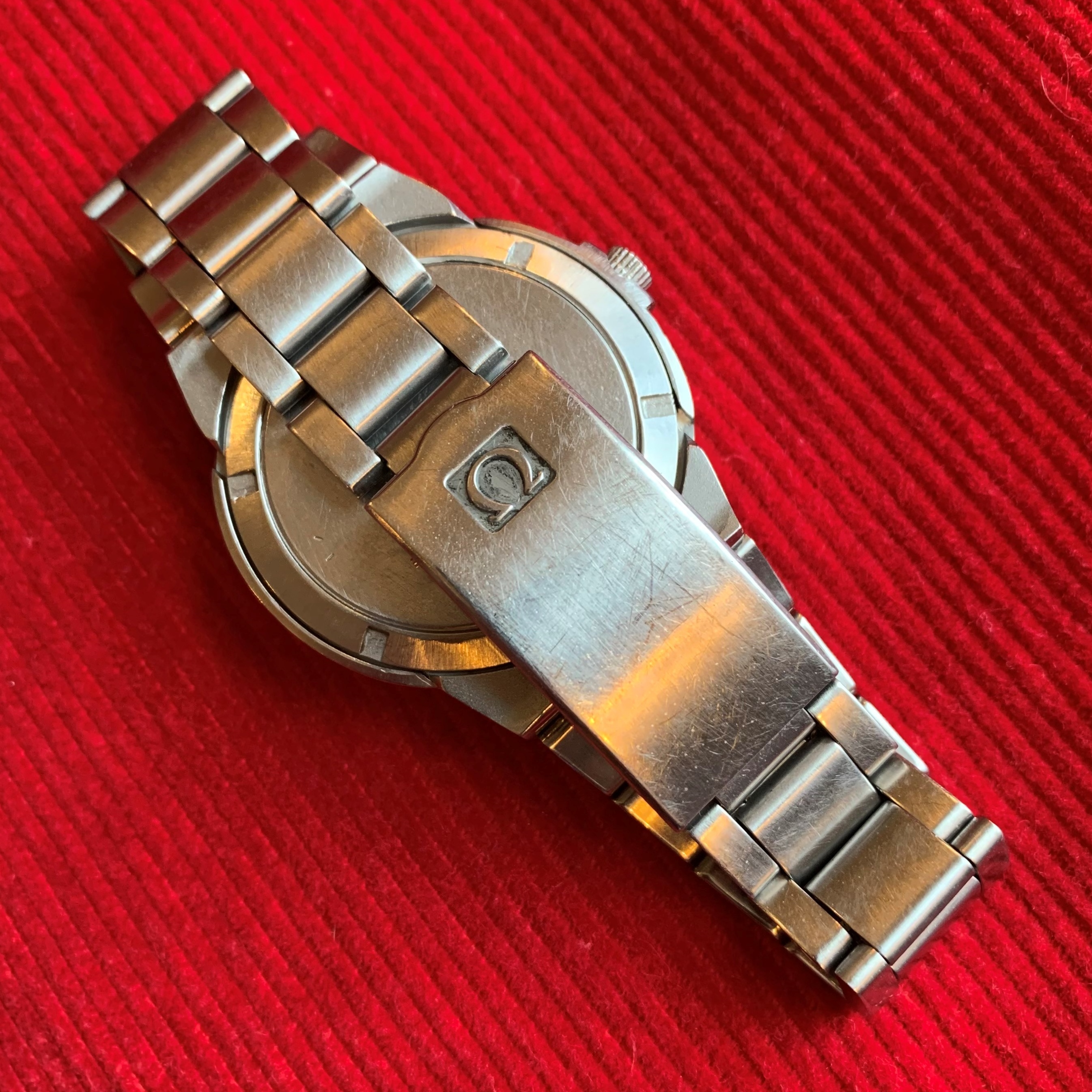

The back of the watch is marked "T00 10 Waterproof".

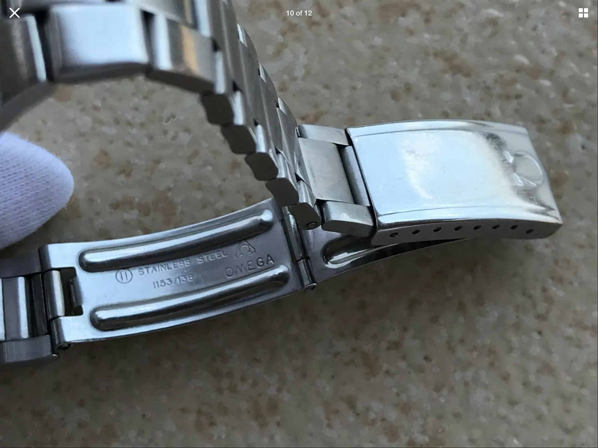

The band is marked "32 Stainless Steel 1317/378".
The days are in German.
Hopefully someone has information on the model and the date of manufacture.
The watch was purchased on eBay from an apparently reputable dealer. Obviously, I hope it is authentic.
Thanks in advance! (My first post.)

Is this a Dynamic ..? looks very different from those we see everyday .. very thick, dial looks redone .. and if it is a Dynamic, you cannot open it from the back .. it goes open by removing the Xtal .. you can only demount the back part that keeps the bracelet in position..

I’ve not seen this reference before. Genèves cover a wide range of references and although this has a similar dial and hands to the Dynamic in my avatar, the case is too thick and lacks the oval shape that is the hallmark of the design.
Genève has no grave accent on the second E, can’t see Swiss Made (though photos aren’t the best) and the Omega logo doesn’t look right to me, but I’ve not looked closely enough to know if this is a known variant. Date window also doesn’t look right to me - I would expect a SS lining to the aperture if the day and date are side by side.
It will be interesting to see what the experts say!

The back is actually marked Tool 107 & Waterproof as are other Dynamics.
I don't know what to make of that. It has a lot that looks right but the case shape is very odd and the dial gives me concerns. I wonder could it be a heavily modified machined down regular Dynamic Gen 1. The way to tell for sure is to check the case number but you'll need to get the movement removed to see that.

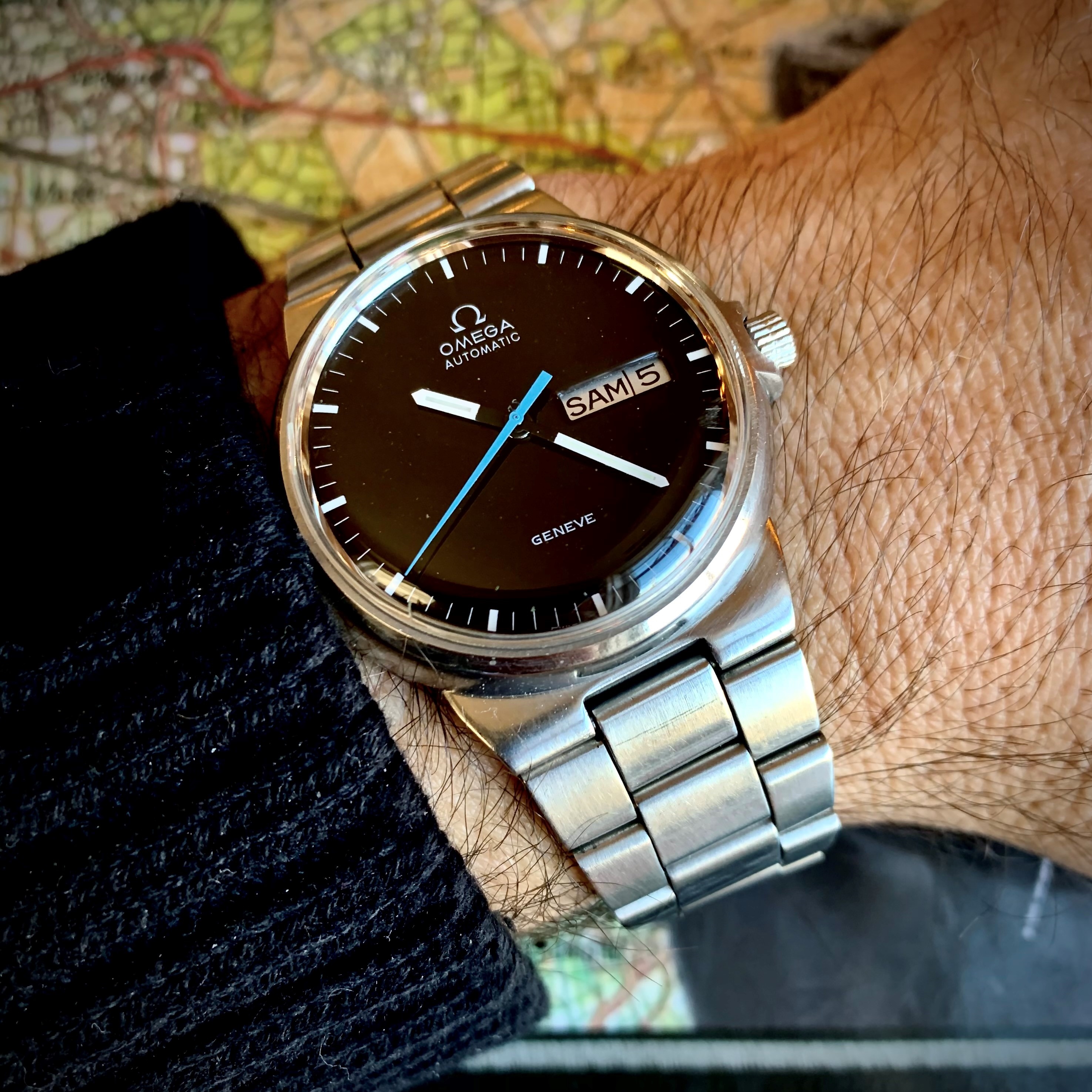

I have serious doubts that left the factory that way. If it did, it is certainly rare but my money is on a mangled regular oval case Dynamic Gen 1, probably with a redial. Note on the regular Dynamic, the case may be oval, but the dial is circular, like this...

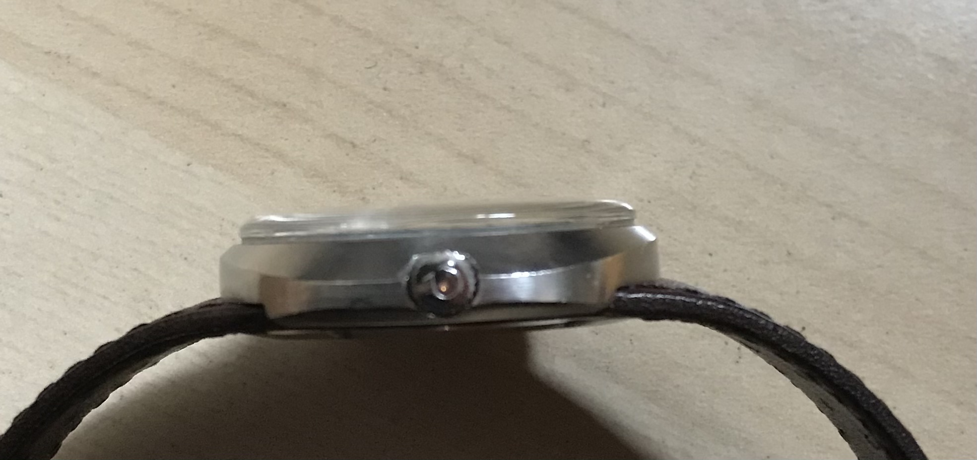

I would be really wary of this watch, unless someone has one that is the same and can show it on here. @padders is right about the dials being circular, and the handset looks right for a Dynamic, as I’ve said. I’m really not sure about the case though - I’ve tried to photo the side of my Mk I and I just can’t see how an original case could be made to look like the OP's side view.
Mk I dials would have a different Omega logo and the accent on Genève, too...

The case number 166079 is listed as follows:
DIAMETER : 41.50 MM
You might want to ask the seller what the diameter of the case is, not including the crown.
My feeling is that this is an original Dynamic case that has been heavily modified, so it will come up short of the 41.5 mm diameter.

Ah, no worries. I will definitely take further photos from more helpful angles if it assists in identifying this watch. The "Swiss Made" text is definitely there. However, in looking closer there is one thing that does immediately concern me. The "6" and "12" positions are slightly off-center. They appear to be skewed slightly to the right. I've included a photo to show this. What to make of that?
I do like the looks of this watch and I hope it is "as advertised". However, I have no desire to wear a fake. If this watch is not legit I will have to initiate a return.

Do you think this is an original dial? It looks so strange to me

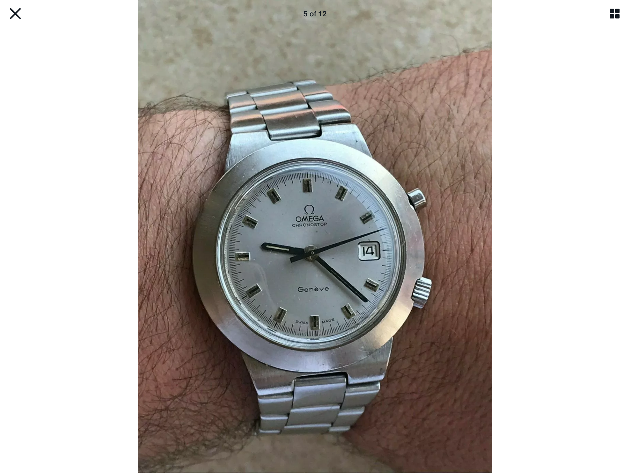

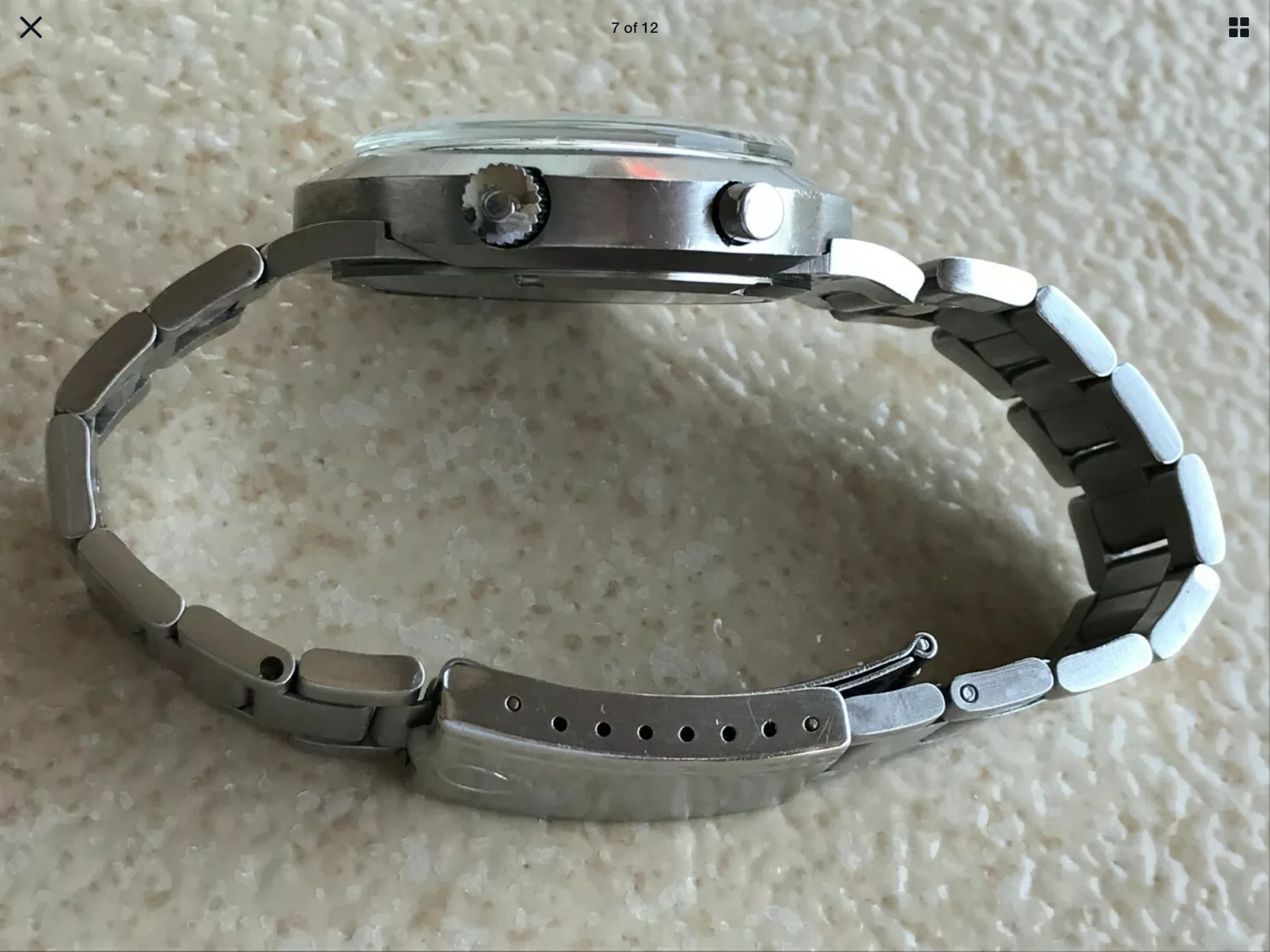

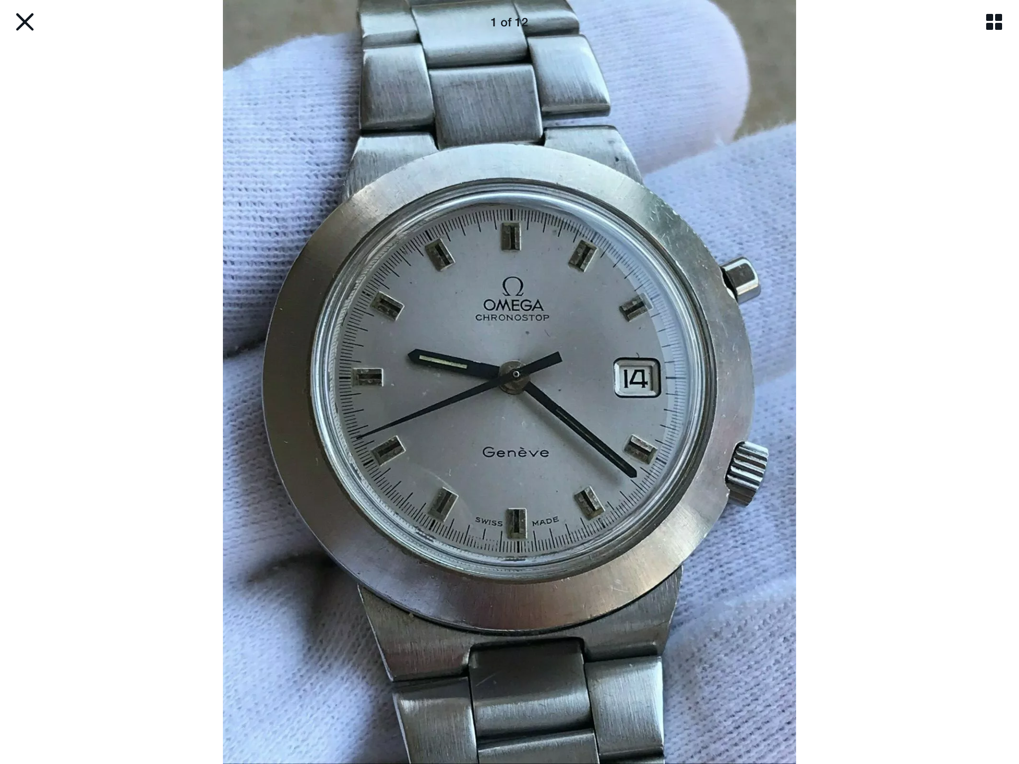

Here’s another watch that I was considering from the same seller. I now notice the misaligned dial on this one as well. Is this a common thing or is it an indication of something not quite right?

Don’t shoot the messenger. Mangled was perhaps a poor choice of word which has clearly grated on you but had you searched on the details the seller gave you before buying (especially the case number) you would have seen that what you bought has been heavily modified and looks nothing like any other. This is a collector forum and even the smallest changes from the original look are remarked on. The cut down case is not a small change and isn’t easily remedied whereas a crown can often be replaced. Nowhere that I can see has anyone above suggested the watch is fake.
You chose to buy what is presumably one of your first vintage Omegas from an eBay seller in Albania, which would also not be a course of action many would recommend without doing your homework first. Hopefully you will have some recourse but it may not be straight forward.
I am not sure what mission you feel has been accomplished other than enlightening you to the true state of your purchase, which is presumably why you asked in first place. If you would have preferred a sugar coated version then I am sorry that isn’t how it played out, but the message wouldn’t have been dramatically different.
ps the dial isn’t misaligned, the whole head has rotated slightly in the bracelet ring, it should be easy to line it up.
