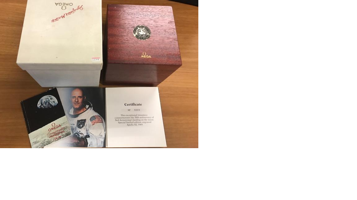

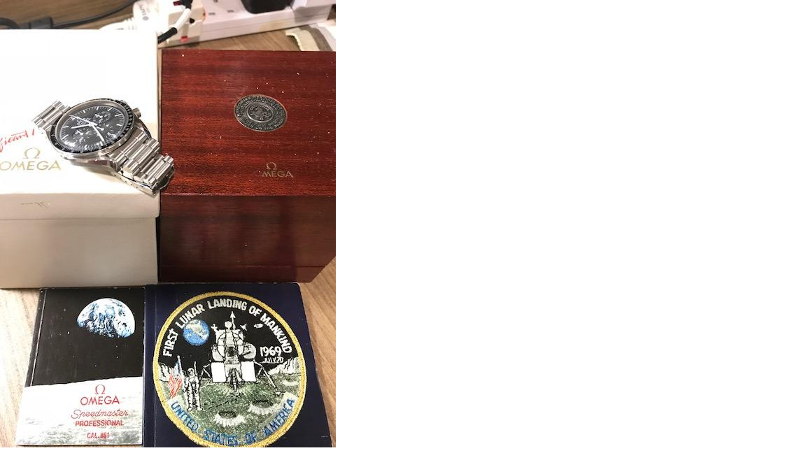

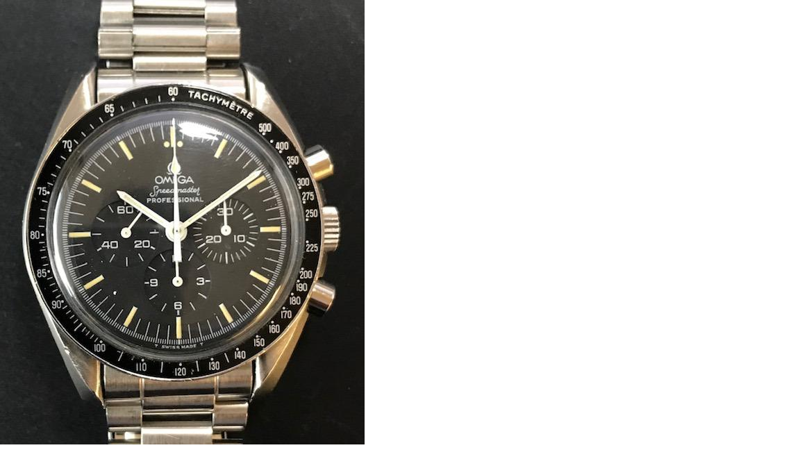

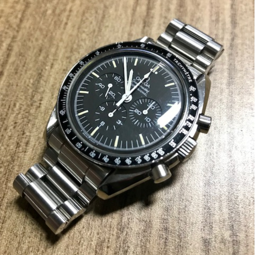

Hi there,
As I am looking to acquire this watch. I would like to get some advice on the authenticity of the Omega XI 20th Anniversary 145.022 Speedmaster, this watch was released in 1989. The watch comes with a 1450/808 bracelet, white omega box, special (wooden) box, manual, and a certificate in the form of a booklet signed off by Thomas P. Stafford. The bezel is a later original Omega replacement, which I am not sure if it is period correct.
Could someone shed some light on this? Or provide some pointers on what I should look out for?
Your opinions and advice would be greatly appreciated!
Thanks,
Kevin

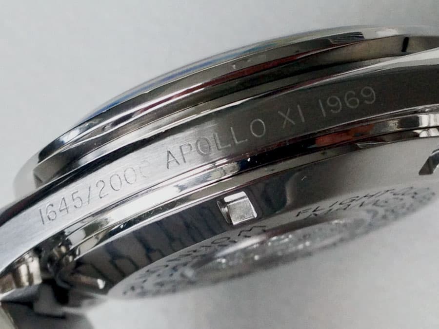

There are three batches of the Speedmaster Pro Apollo XI from 1989. There were 2000 numbered pieces for the USA market. There were another run of 4000 pieces for the global market and another 250 for the German market only. There is one thing that makes these three batches different though, the description in the side of the case. A total run of 6250 pieces of which only 2250 were numbered.
The US version has a XXXX / 2000 Apollo XI 1969 inscription, where the German edition has the XXX / 250 Apollo XI 1969 - 1989 inscription. Then there are some differences in the inscription for the US version, where some only use XXXX / 2000, others use XXXX / 2000 Apollo XI and finally a number of them have the year of the Moon landing engraved as well.
From the photos you have provided, the watch appears authentic. The correct wooden box, patch and certificates. The bracelet and end pieces are correct as the watch came with either a bracelet or leather strap( German Market). The bracelets used were 1450(808) and 1479(812). The insert, as you suspected, is not correct for this particular reference. The word "tachymetre" should not have an accent above the letter "e".

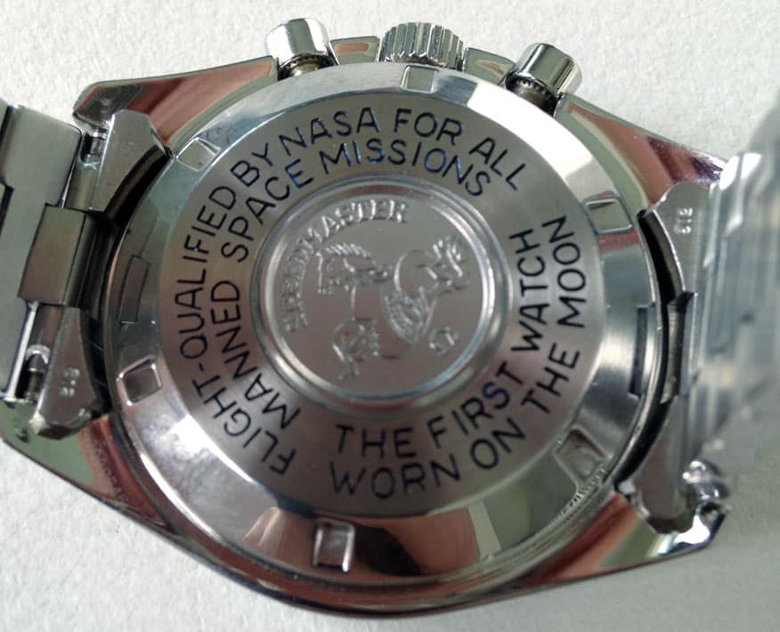

2. Back of caseback should be engraved ( see image)
