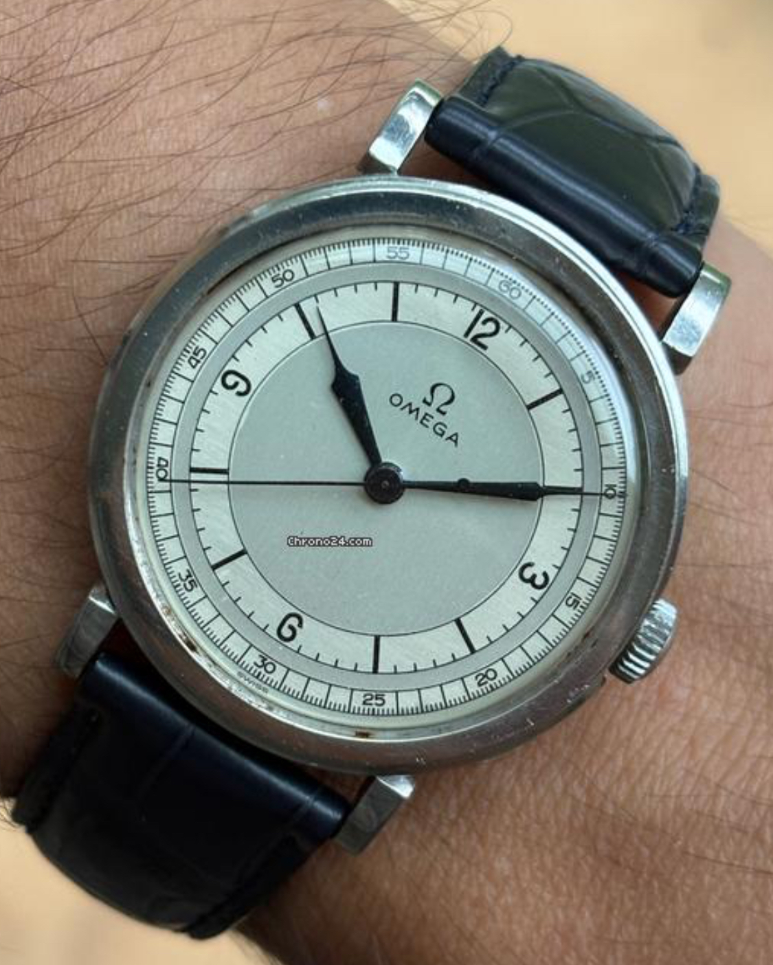

I’m eyeing this piece on chrono24. It appears to be a medicus from late 30’s early 40’s.
Can anyone shed some light on originality or reference number?
Thanks in advance.

Looks very clean to me, though not familiar with this reference.

This is a reference CK2015 I've had one previously. I would say this is a fairly good refinished dial.

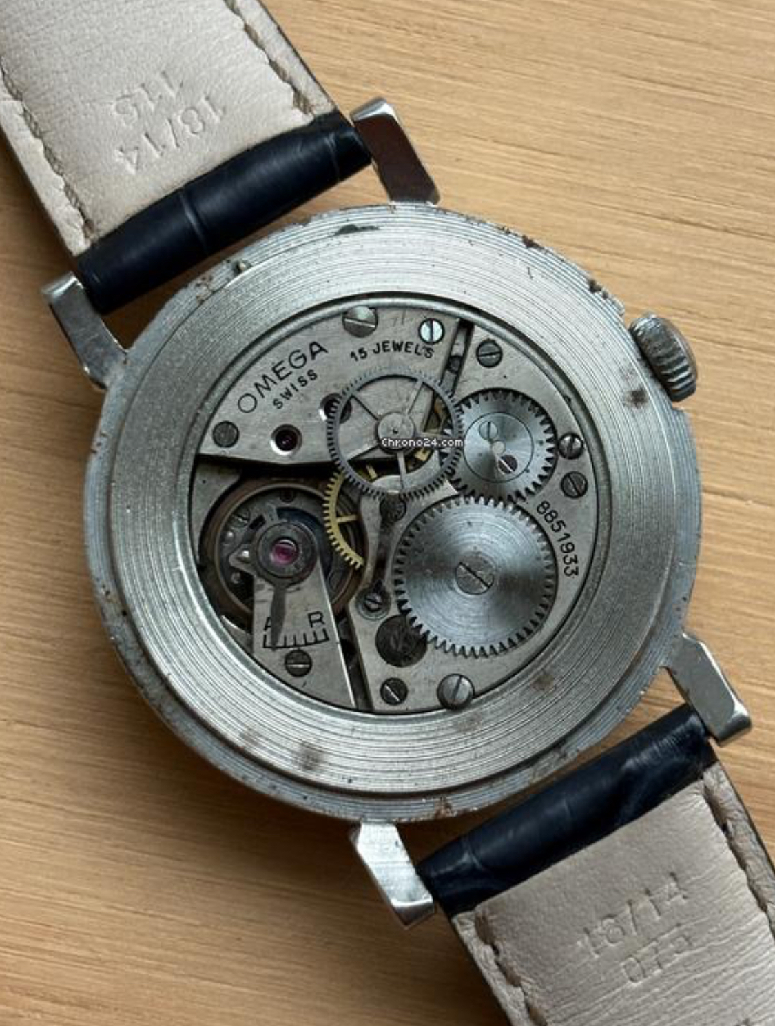

Not an expert in this reference, but I would be suspicious of how clean the dial is compared to the rest of the watch. There looks to be rust inside the case back, and also between the bezel and dial around the 6-o’clock position. I would expect at least some dial aging/damage, but your dial looks like it was made yesterday.

This is a reference CK2015 I've had one previously. I'm tempted to say this is a good refinished dial.
And I’m always suspicious when the seller doesn’t state if the dial is original ….

thank you, gang. I think it’s probably safe to say it’s a reprint then, though very charming
