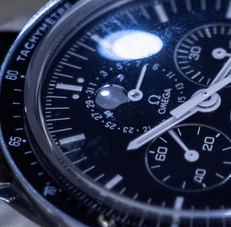

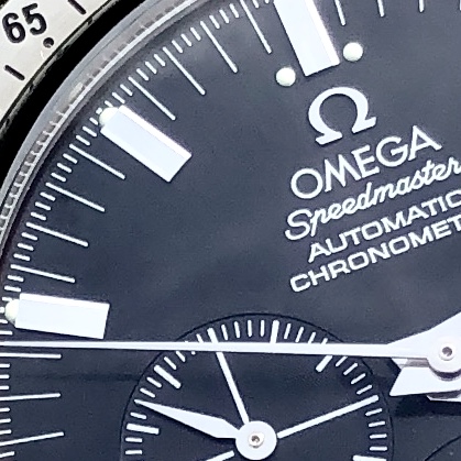

The 866 and 1866 based moonphases also have 1/5 or 1/3..... except.... check out the "silver moonphase" 3575.30.
On the Omega website (https://www.omegawatches.com/en-us/watch-omega-speedmaster-professional-moonwatch-35753000) we have 1/5 second subdivisions.
But the same reference (from an OF FS post):
and every other photo I've found of the actual watch, shows that... no, it actually has an *1/6* seconds track! In fact it's the only reference I've been able to find with 1/6 second markings.

Interesting that. I hadn't noticed one before with a 1/6s track, I had assumed it would look too busy but it looks like they tried it at least once.
