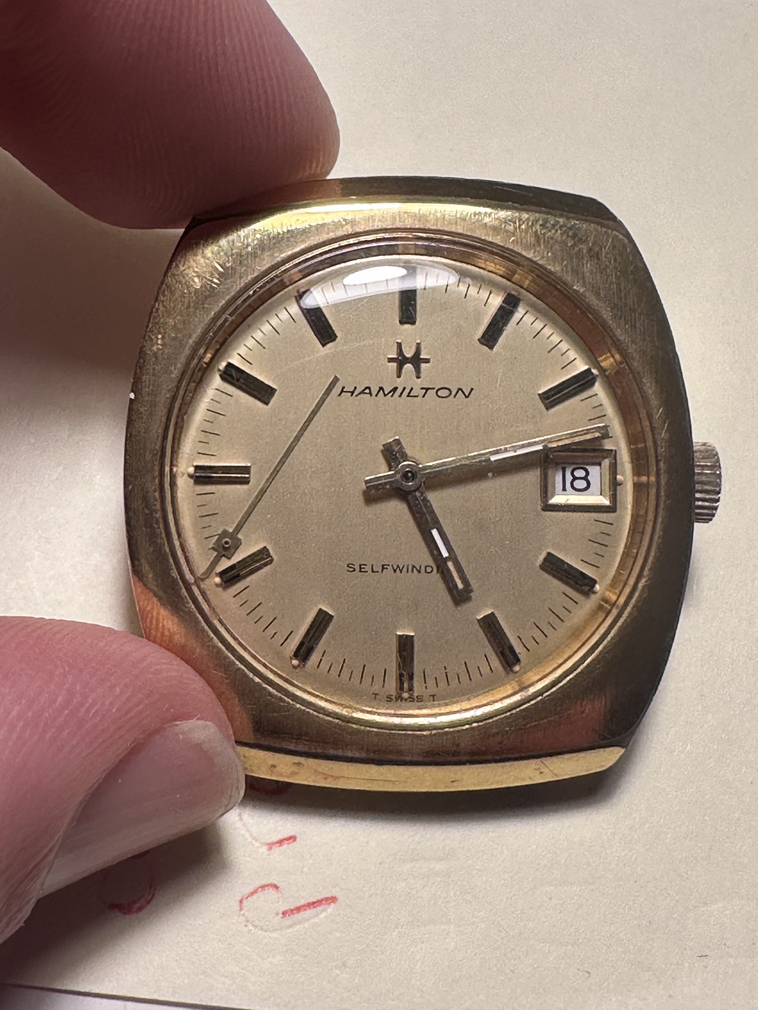

I inherited my grandfather’s watches. One of which is a Hamilton (gold plated). I do not have any gold colored watches and while it has some sentimental value, I never actually saw my grandfather wear this watch.
The seconds hand fell off but the watch runs and keeps (decent) time.
Is reattaching the second hand necessary for stability /maintenance of the movement ? Or can I remove the second hand from the case (I would the hand for the future if I want to add it again) and wear the watch without concern?
Thank you for your help!

You’d be aok. It will make no difference to the running of the watch if you leave it off.

They are easy to attach. Local watchmaker would only charge a small amount if anything.

It's a nice looking watch, probably from the 1960s - early 1970s. Why not get it properly serviced, which it will need after its years of service, during which the watchmaker can re-attach the second hand. Then you can wear it without fear. And it's not something anyone would see every day, or year, decade....

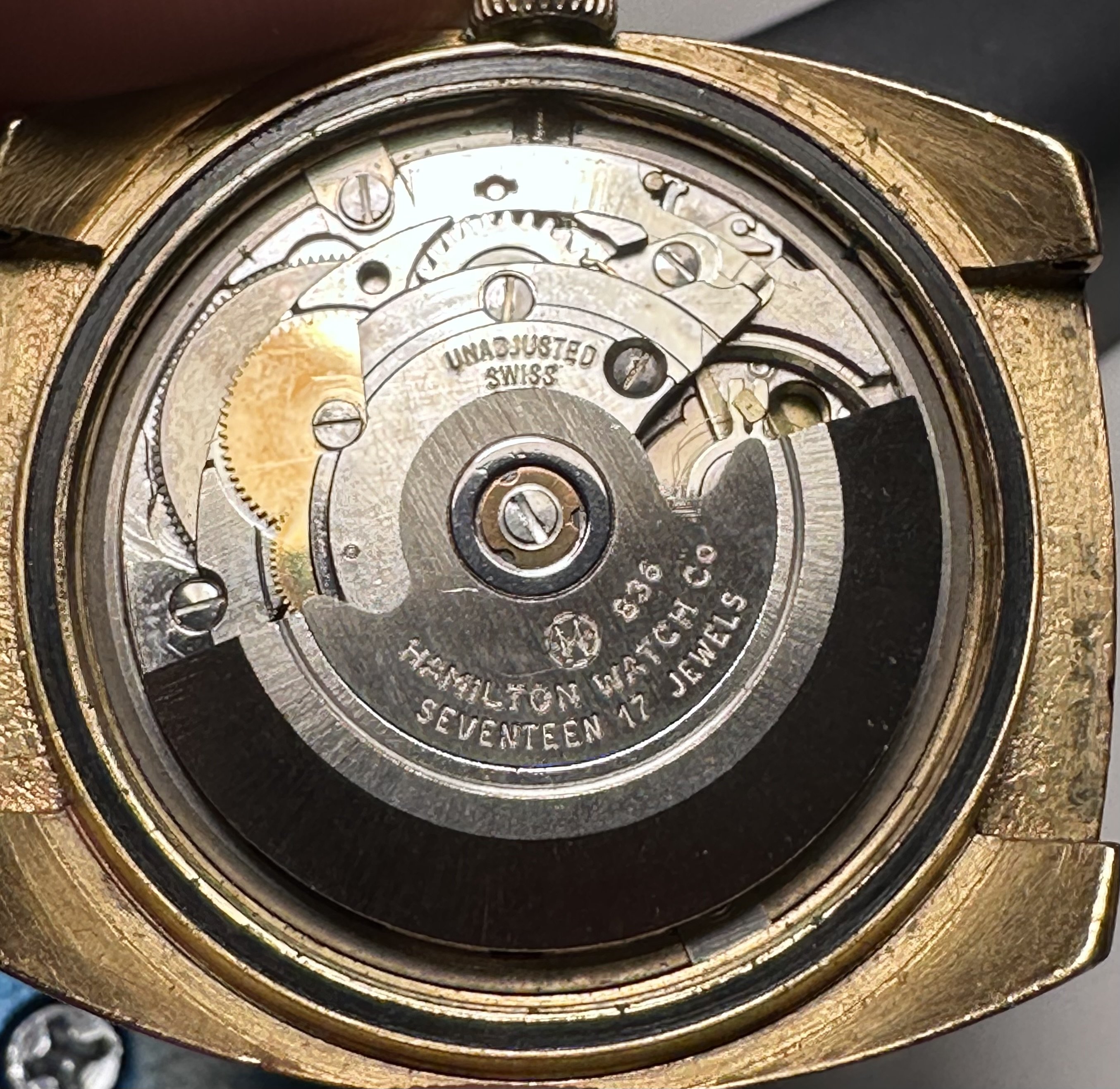

I see the dial says "Swiss", I wonder if there's Buren micro-rotor movement inside there?

Hand hole could be a touch loose. You can leave it off or maybe a watch maker can tighten the hand and reinstall

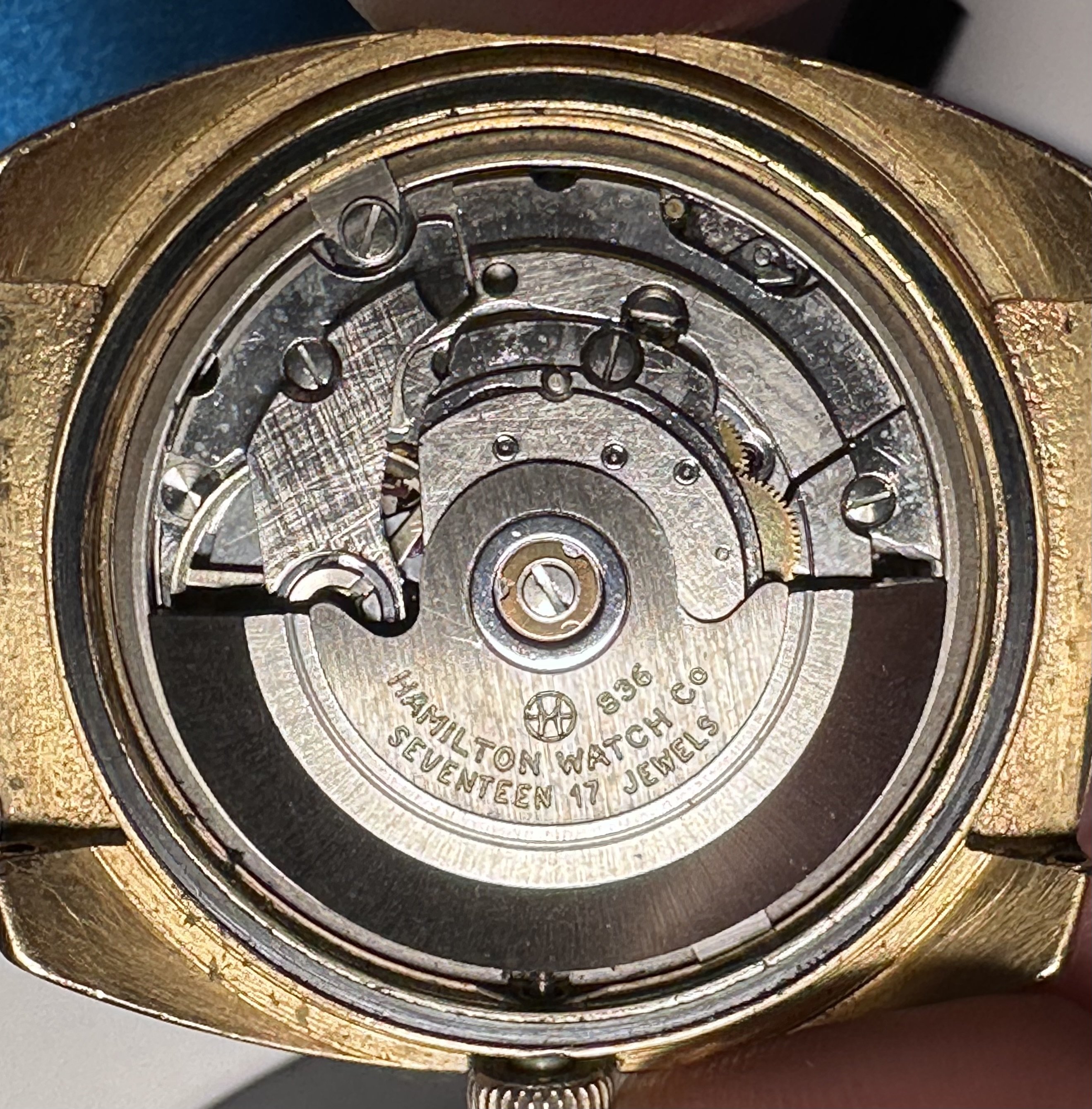

The automatic 836 is an ETA ébauche, a solid runner with quickset date. This watch dates to the mid 70’s.
