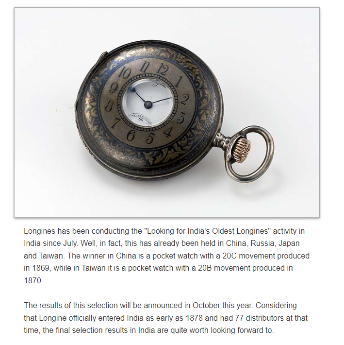

I do not know the lowest 20A that has been found. You might want to look at the serial numbers for the Oldest India watch, which is noted in this discussion thread.

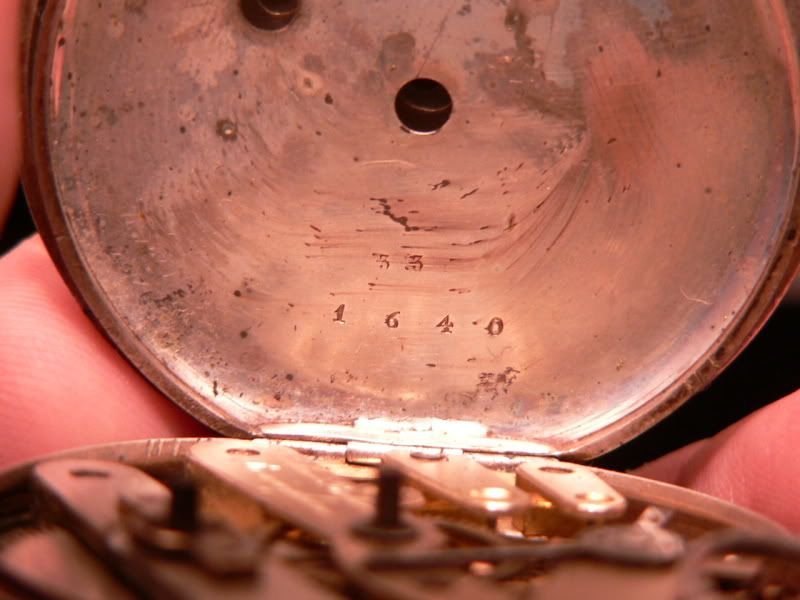

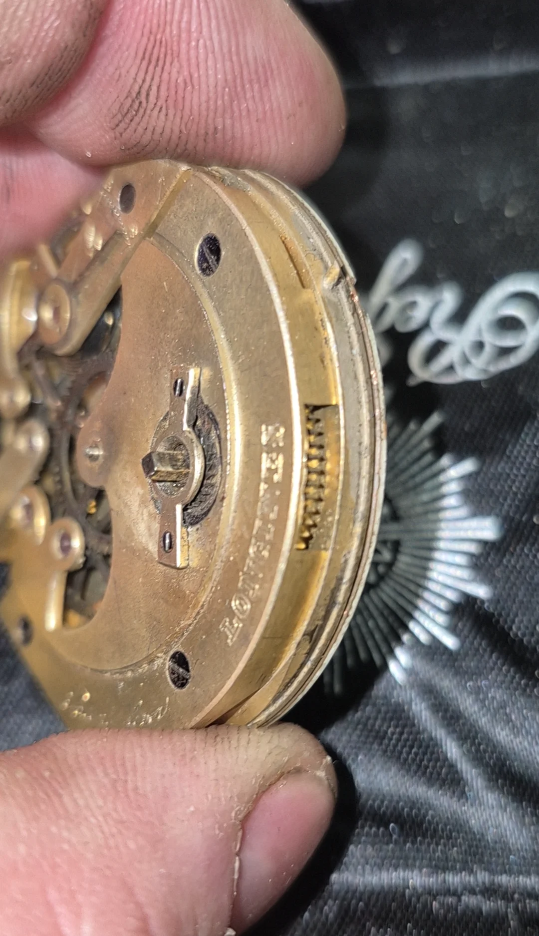

Holy smokes Seiji! That is outstanding. What is the movement serial number, and what date was it produced?
1,439
4,191
I have an AA4, but this watch is not mine. It is serial number 1640 and it was produced 1867.

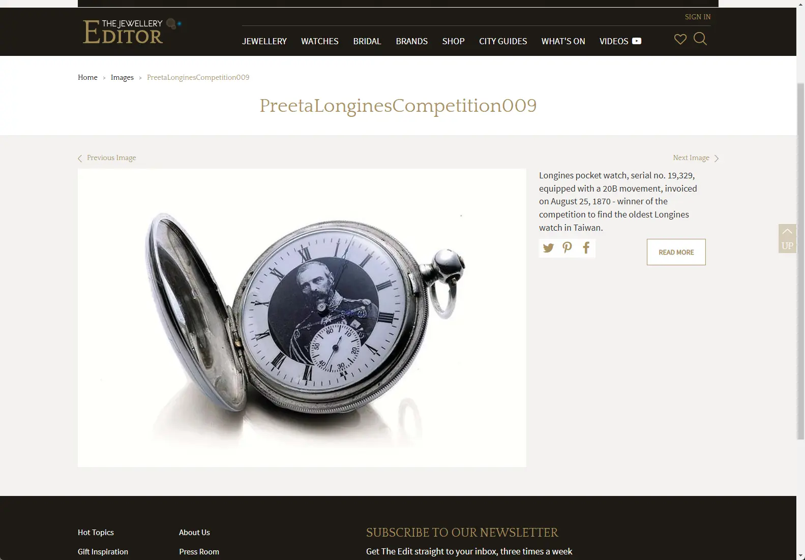

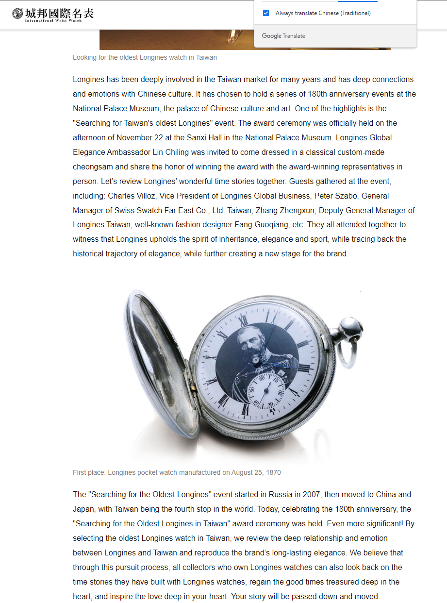

I'm being told this is an 1869-1870 Longines 20B serial number 23311. I wonder if this would be a contender for oldest in a country.
