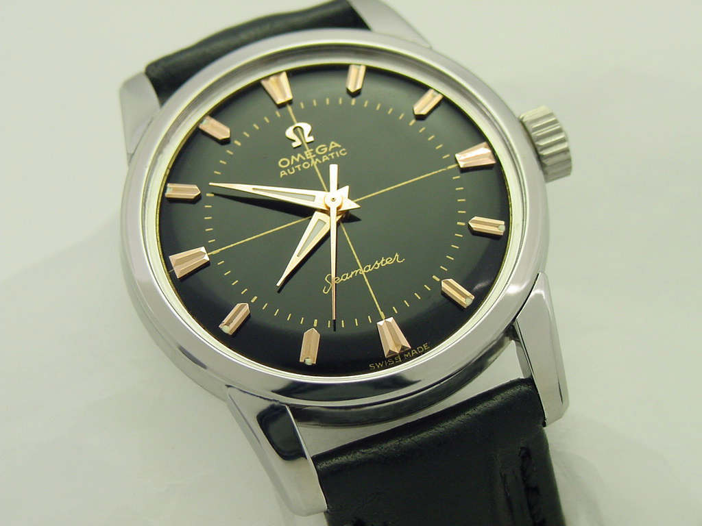

    This is the 'kind' of watch I am looking at and I am sure there are many variants. I would just like to be more informed

    Be very wary of black dialed vintage Omegas because most of them are refinished dials. We'll help you on a case by case basis. Post links to the watches you find and we'll vet them. Most of us absolutely hate to see anyone make a bad purchase, and there are a lot of shenanigans going on with the brand because it's so popular.

    Agreed. Unless it is a dive watch like the seamaster 300, 99% of the black dials are refinished dials. The black dial seamaster chronometre is almost impossible to find in original condition with the black dial. The same situation exists for vintage constellations where there an original black dial is only slightly easier to locate.

    Thank you both for the reply, I wonder then why so many black dial seamasters are redialled is it because the original deteriorates or are we really surrounded by people determined to deceive us. Is there a dealer or resource that will admit the changes made to a watch and charge a fair price for it ?
    I mean if 99% of black dials are replaced I really dont see that I have a choice! I must focus on at least getting a good example of a re-dialled seamaster. Your guidance will be a great help here , thanks Steve

    You can find original ones. Omega made a lot of watches so there isn't just 3 or 4 black dialed pieces out there. It just takes a little longer to find them and a keen eye for what's correct to get a decent one. Personally, I prefer a black dial and have owned a few.
