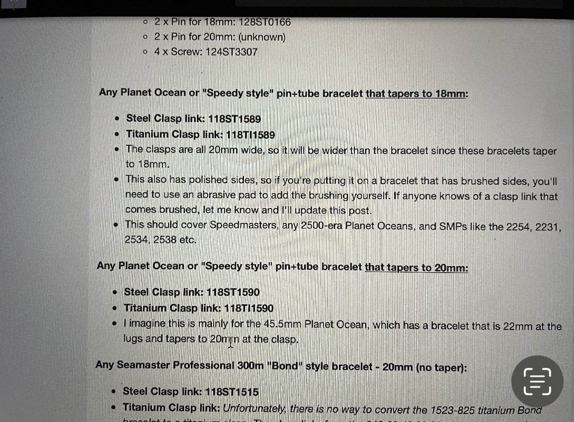

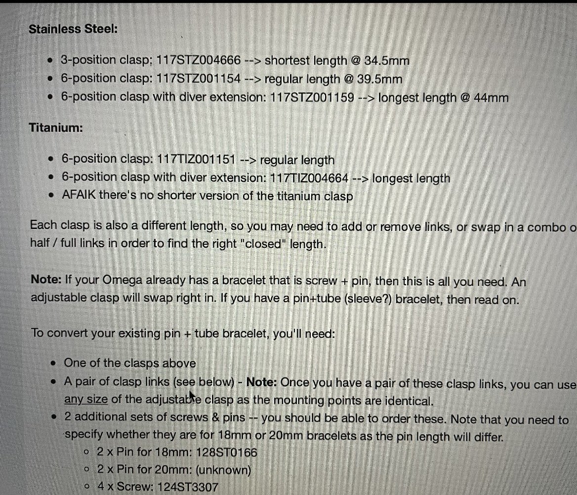

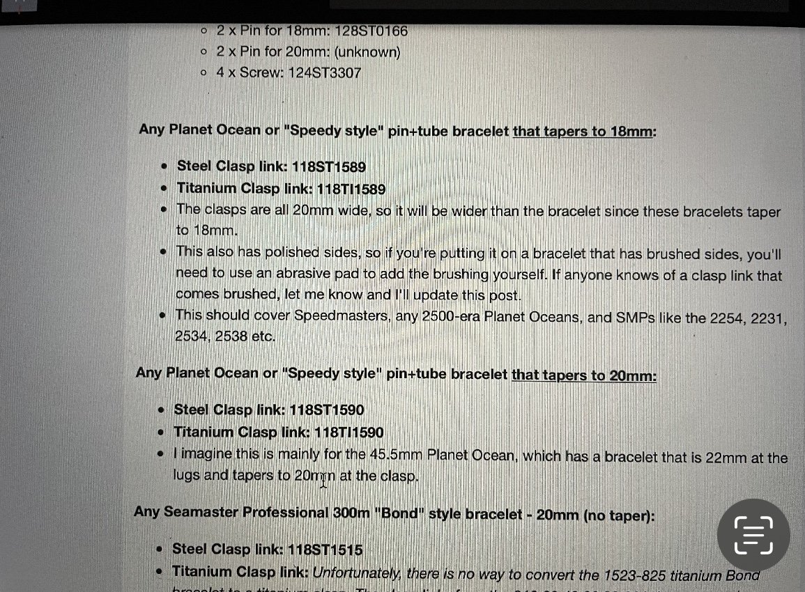

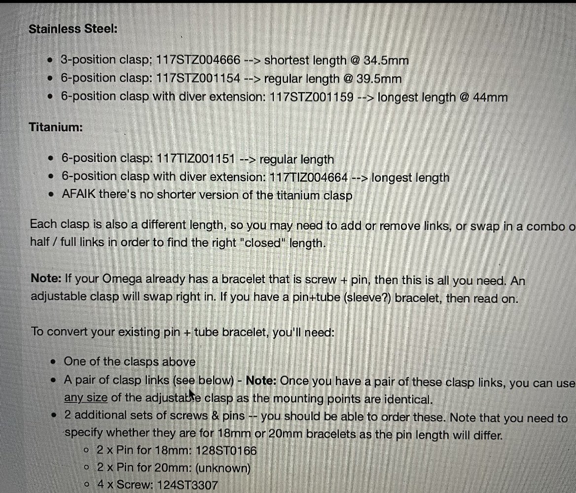

I have an older Seamaster 50th anniversary GMT. It has a 930 Speedy style bracelet that tapers from 20mm to 18mm.
I bought two new clasp links that taper from 18 to 20mm, a 6 position micro adjust clasp, and tubes and screws to attach everything. The clasp is 20mm wide but you really don’t even notice it.
I love the fact that I can easily adjust it on the fly, it makes the watch wearable year round without having to resize the bracelet.
I got the information from a post on another forum.
These are screenshots from my laptop so I apologize for the quality.
i do not know if this will work on your bracelet as I’m not familiar with all of the different Omega bracelets.
