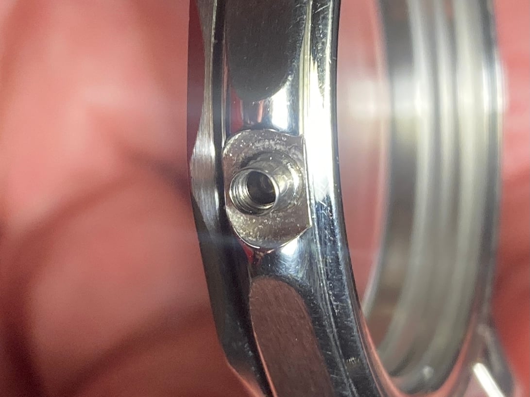

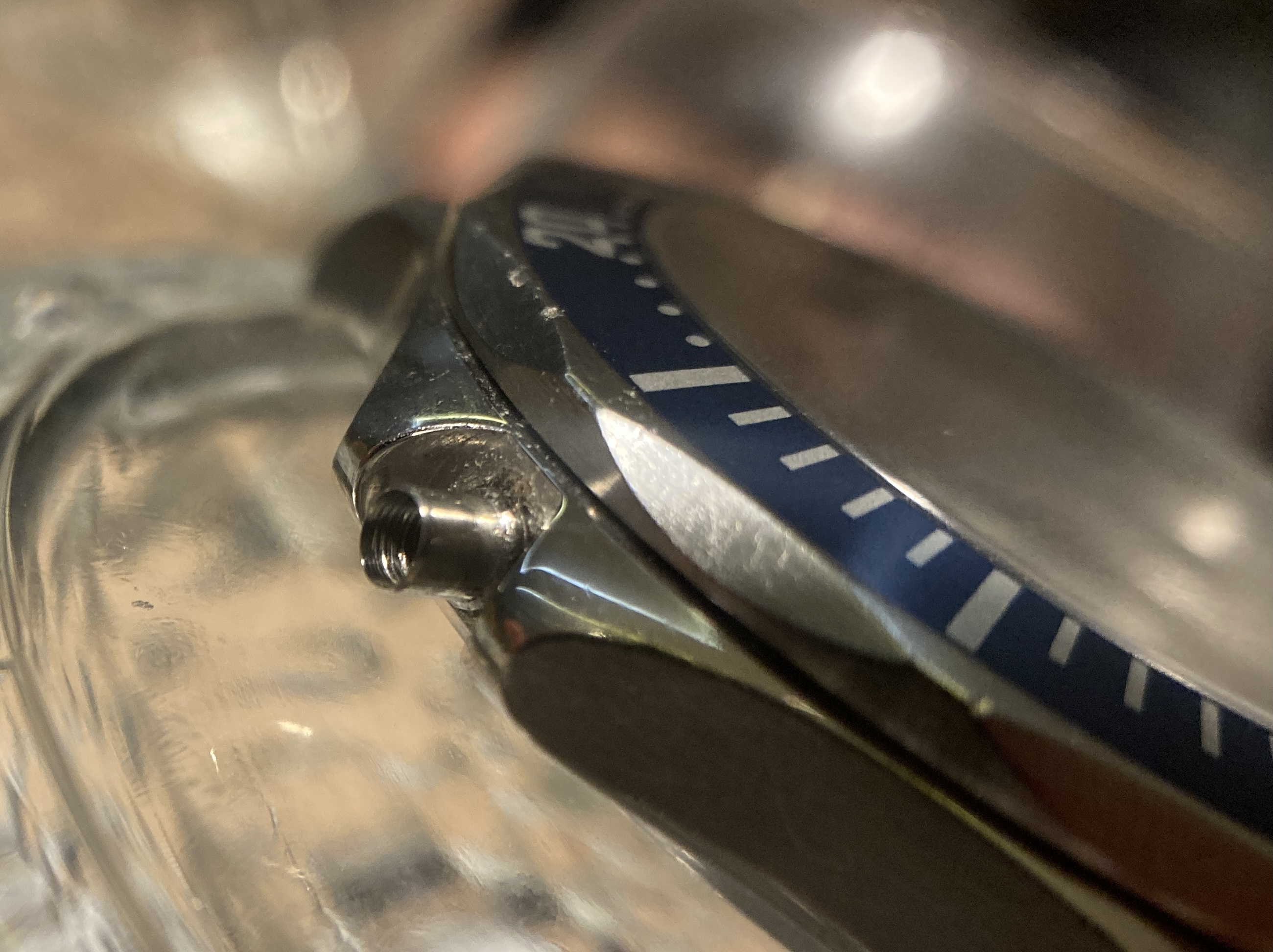

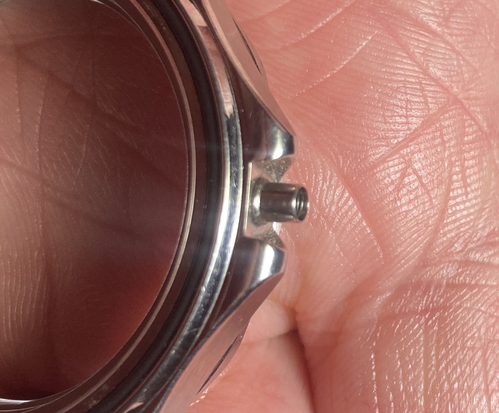

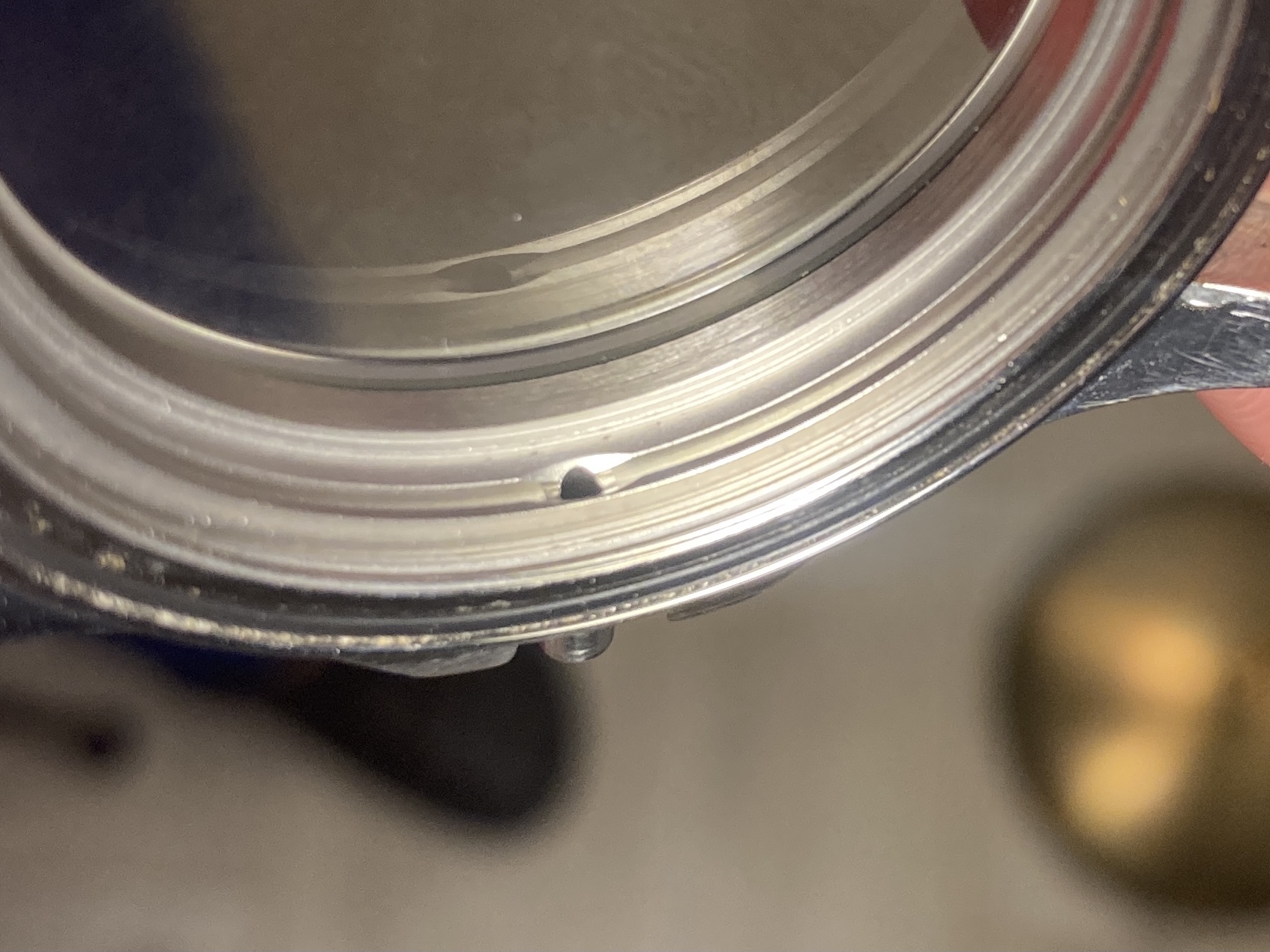

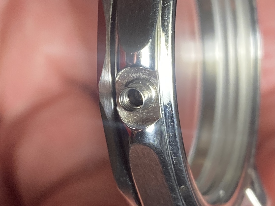

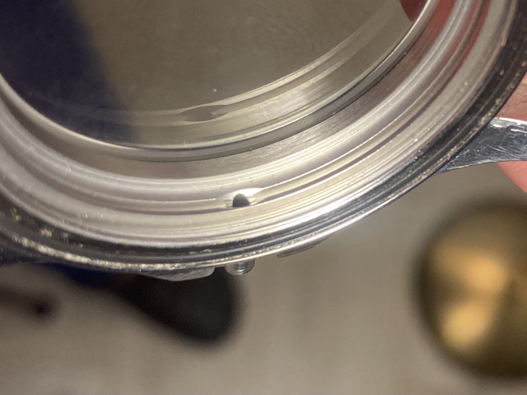

Hi Guys, my first post here.
Recently my Omega's crown stopped screwing in (Semaster Pro 300m automatic 41mm 2531.80.00). I took out the movement and took pictures of the tube and inside stem hole. Looks like the thread is stripped. I was not able to check the thread of the crown because the thread is very deep at the bottom.
I'm wondering what tube to look for, screwed or press fitted. I should change the crown as well and that is rather clear. Can you tell me the part number of the tube? It seemed to me that after removing the movement, it would be easy to tell by the thread on the inside of the case or its absence. Meanwhile, the stem hole is quite small and it's hard to see anything inside.
Case Number printed on the caseback: 168 1623
According to an old Archer’s post, there were three tubes used on these Seamasters:
090ST4201 that is a press fitted tube
090ST1231 that is a press fitted tube
090ST4203 that is the threaded version
As far as I know, 090ST4201 does not have a collar in the middle, so this tube will not fit. What is left is 090ST1231 pressed version or 090ST4203 threaded.
Can you tell which version to look for by looking at the photos of the inside of the case and the outside of the tube?
Thank you in advance!

You should always replace both, so what you need are:
Crown - 069ST42147
Case tube - 090ST1231

I'm actually in this same situation. I bought a new crown thinking the crown was the issue but it seems to be the tube. I've found where I can order a new tube on ebay but i'm not sure how to safeley remove the old one. Does anyone know how it can be done without damaging the case?
Thanks

You disassemble the case - the HEV is removed, the bezel is removed, the crystal is removed. You heat the case at the location of the tube, and use an easy out to turn the old tube out. If it snaps off, you are in trouble, so not really what I consider a DIY job...

Thanks for the help. I'm not sure I understand you correctly. So, the tube needs to simply be pushed out from the inside of the case outward? Is it simply held in with tension? I'm more than happy to do it myself, as long as i know the correct method 😀
No, it's threaded as @Archer explained. An Ezi-out is a reverse threaded screw extractor.

I think Archer was referring to it being a push fit glued in.
