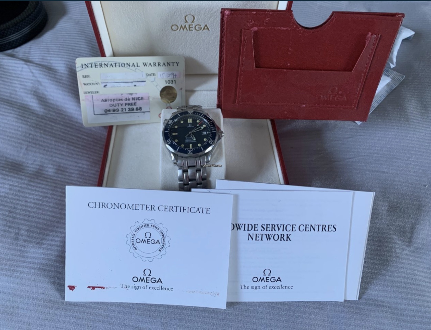

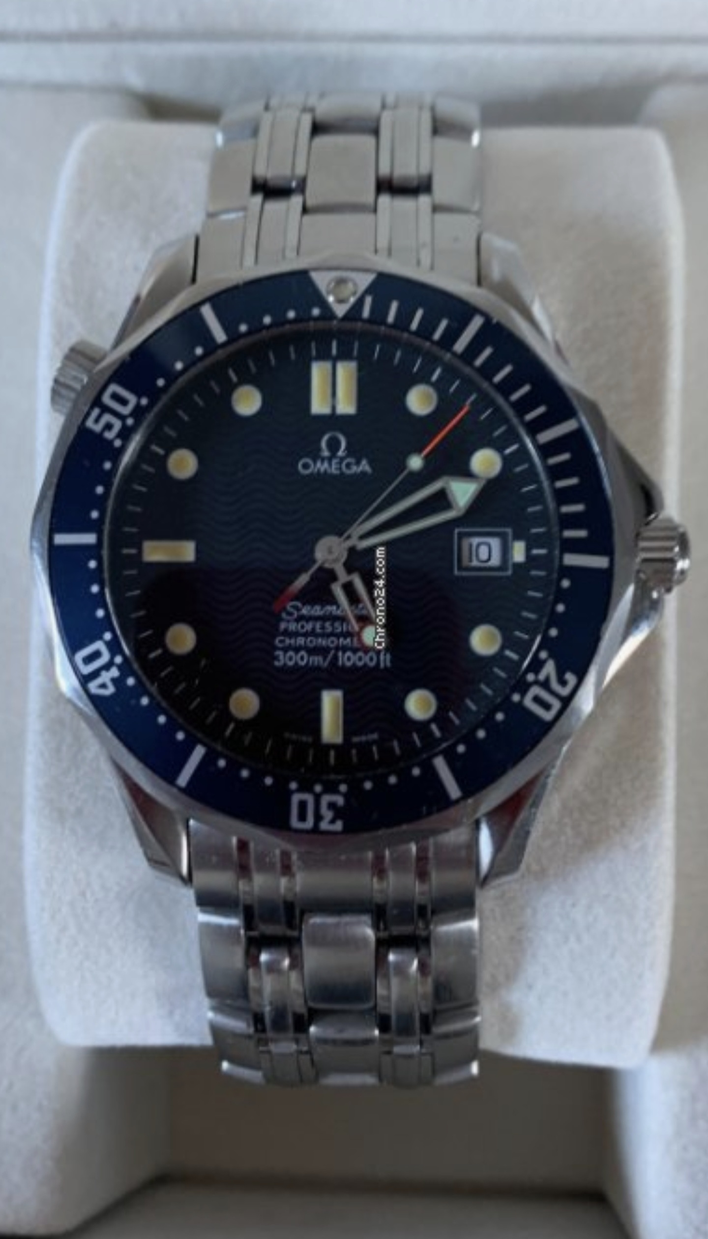

So glad I found this thread. I've been looking for a 2531.80 for some time and I also didn't understand why the tritium dials don't (at the moment) seem to sell for a premium. I'm guessing that will change in years to come and that made me choose this 1997 model over later ones I've seen with the white lume. I just picked this up from Chrono24 for £2400 which I think was a bit of a bargain. Reading above - this one is the same in that the hands have not developed the same patina as the dial (I wonder why that is?). Any way it looks like a beautiful watch and I can't wait to receive it. And who knows. Maybe in a few years the tritium dial version will be the one everyone wants 😀

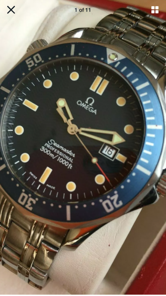

Hi. Can someone please help me understand why on the tritium Seamaster Diver 300m watches do we often see hour markers with nice, yellow patina and hands that look much newer? I had assumed this is because the hands are service hands, however, I can’t imagine that every one of these watches has service hands. I’ve personally yet to see one example of a tritium diver 300m from the early 1990s with yellowed hands. Any ideas?
30,289
78,184
The tritium hands don't yellow when they age, but they do look different than luminova hands. They tend to have a slightly greenish tint, and the grain of the lume is quite coarse when compared to luminova hands.
