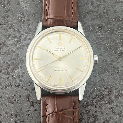

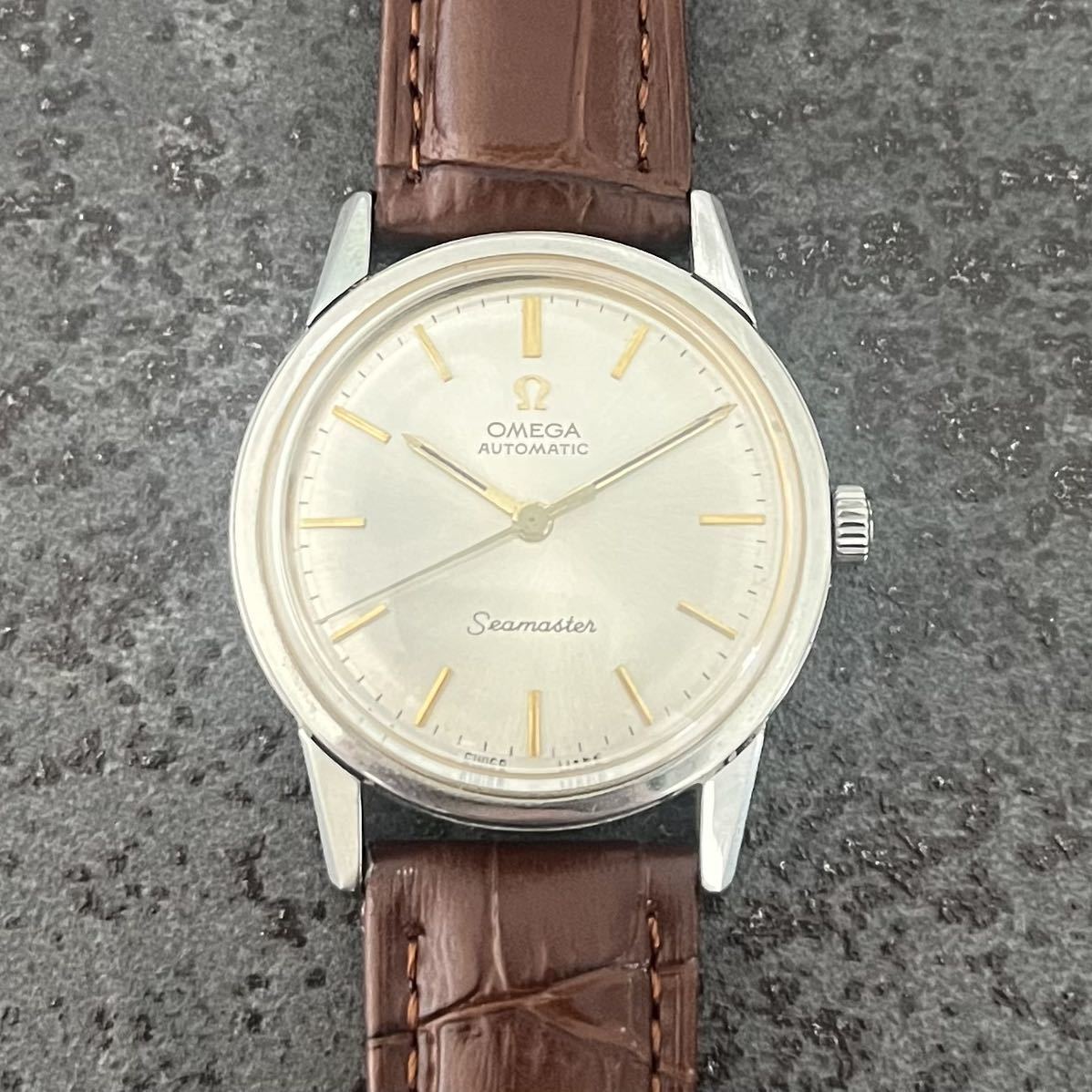

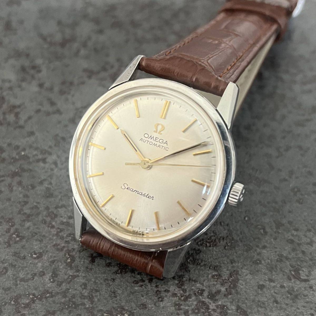

I am definitely getting better at spotting a repainted dial, but I need a little help on seeing if the hands of this watch are original as they do not match the indexes. Any thoughts? Any other red flags?
13,556
23,504
Looks redialled to me so the hands are the least of its concerns.
13,556
23,504
Thanks I'm leaning, so any tips about spotting the redial?
Font appears slightly off
Swiss Made spacing is incorrect.
Minute markers look too heavy/thick.
Minute marker spacing seems inconsistent.
Most of the above could be explained by the angles and distortion by the crystal but I still think it’s a redial. Front on picture would confirm

Here is front on shot....

Im getting that feeling that I am gonna keep looking. Thanks everyone.

I see it now, M is too Big, A is too Big. plus other things folks have mentioned.

I stand by my comments about being a redial.
For example, check out the minute mark spacing either side of 10 o’clock.
