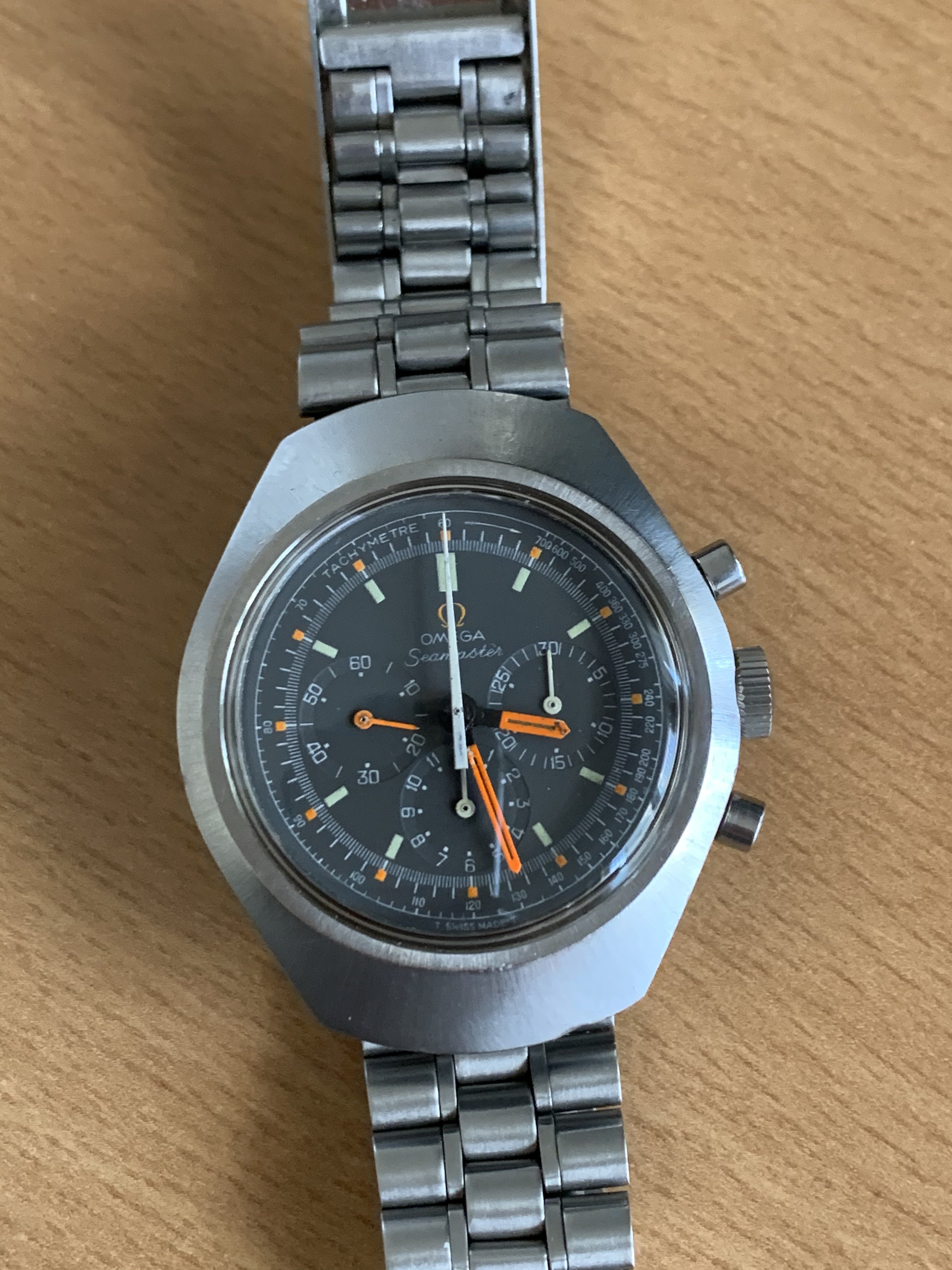

Hi!

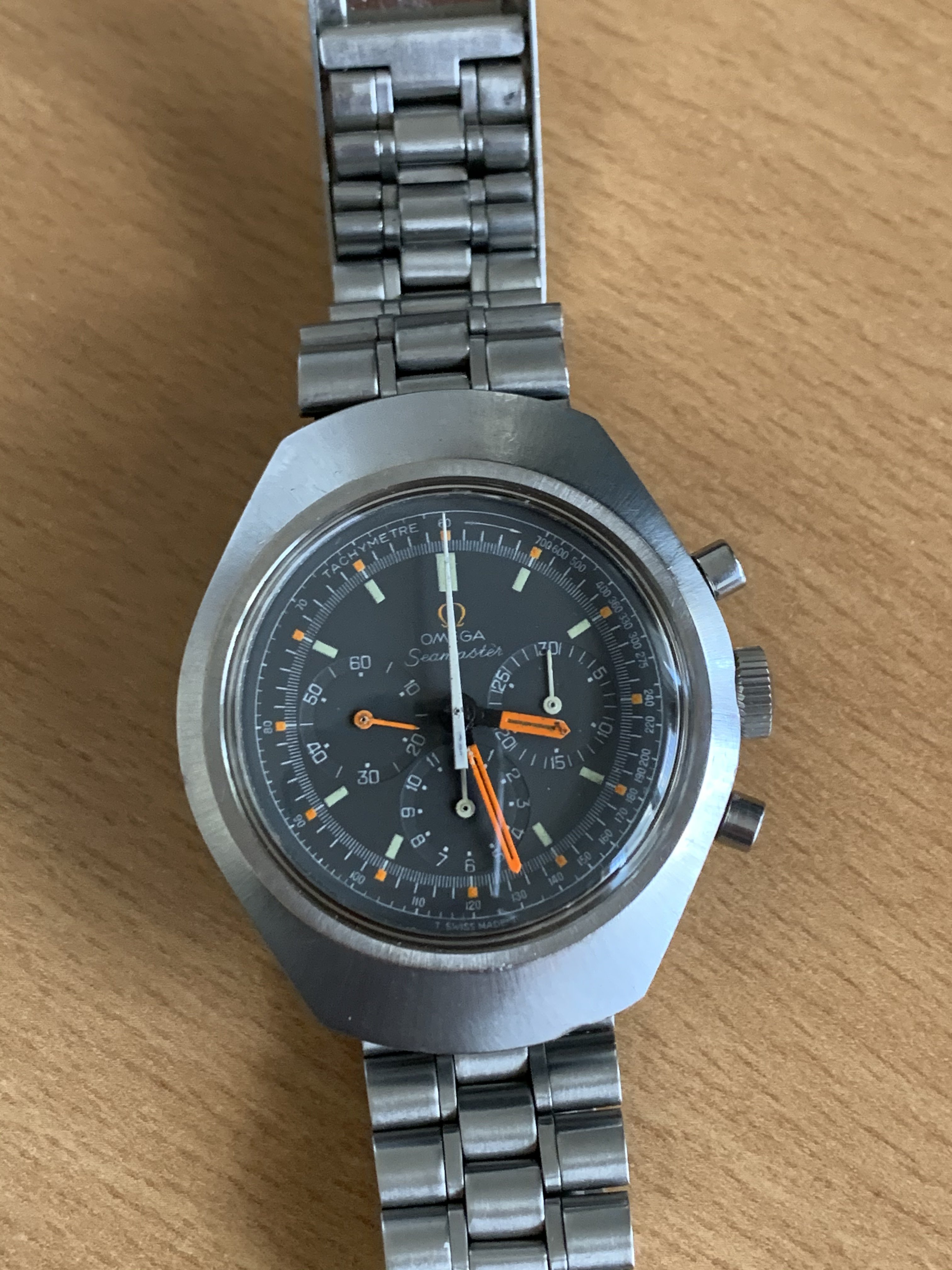

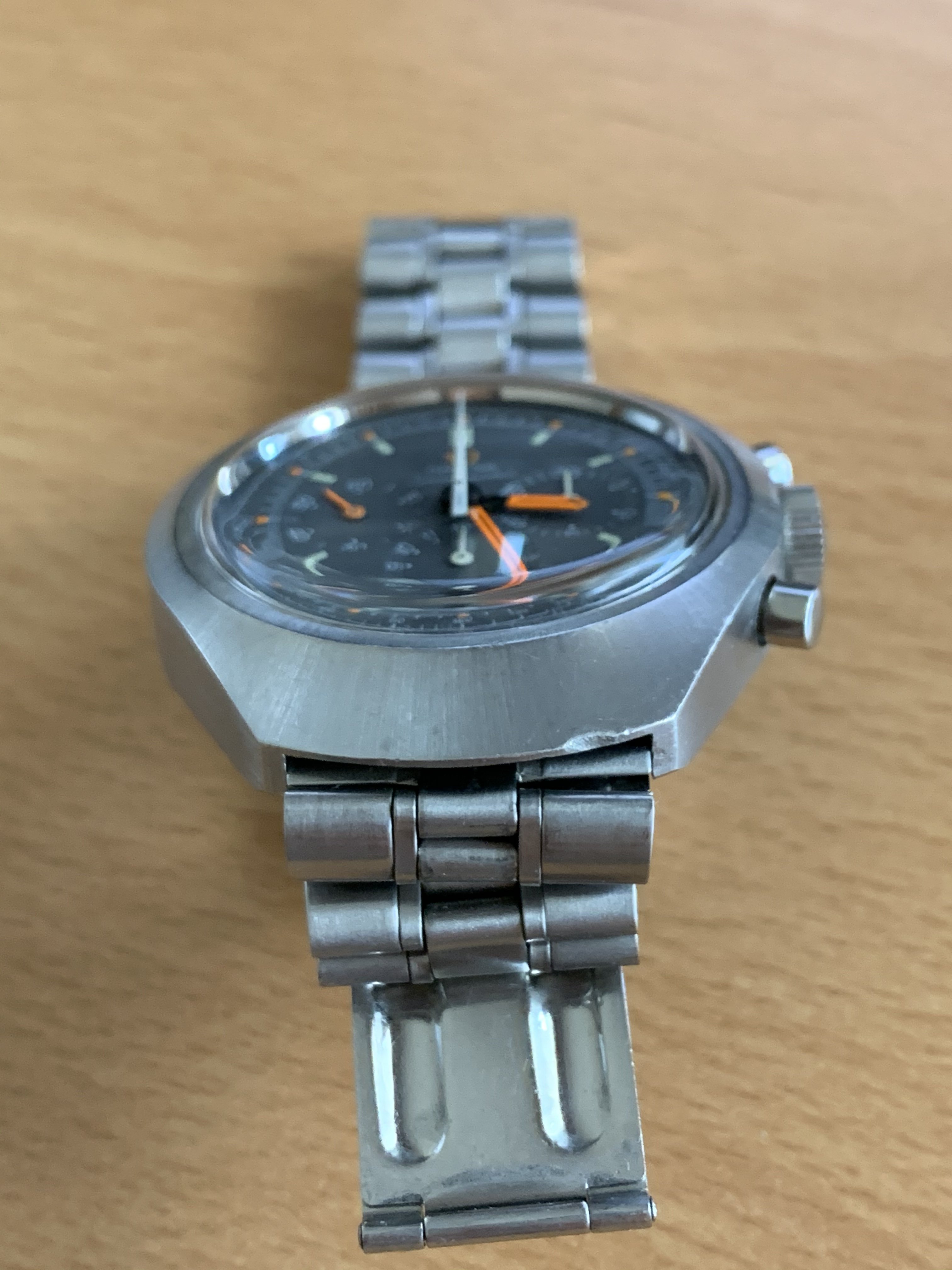

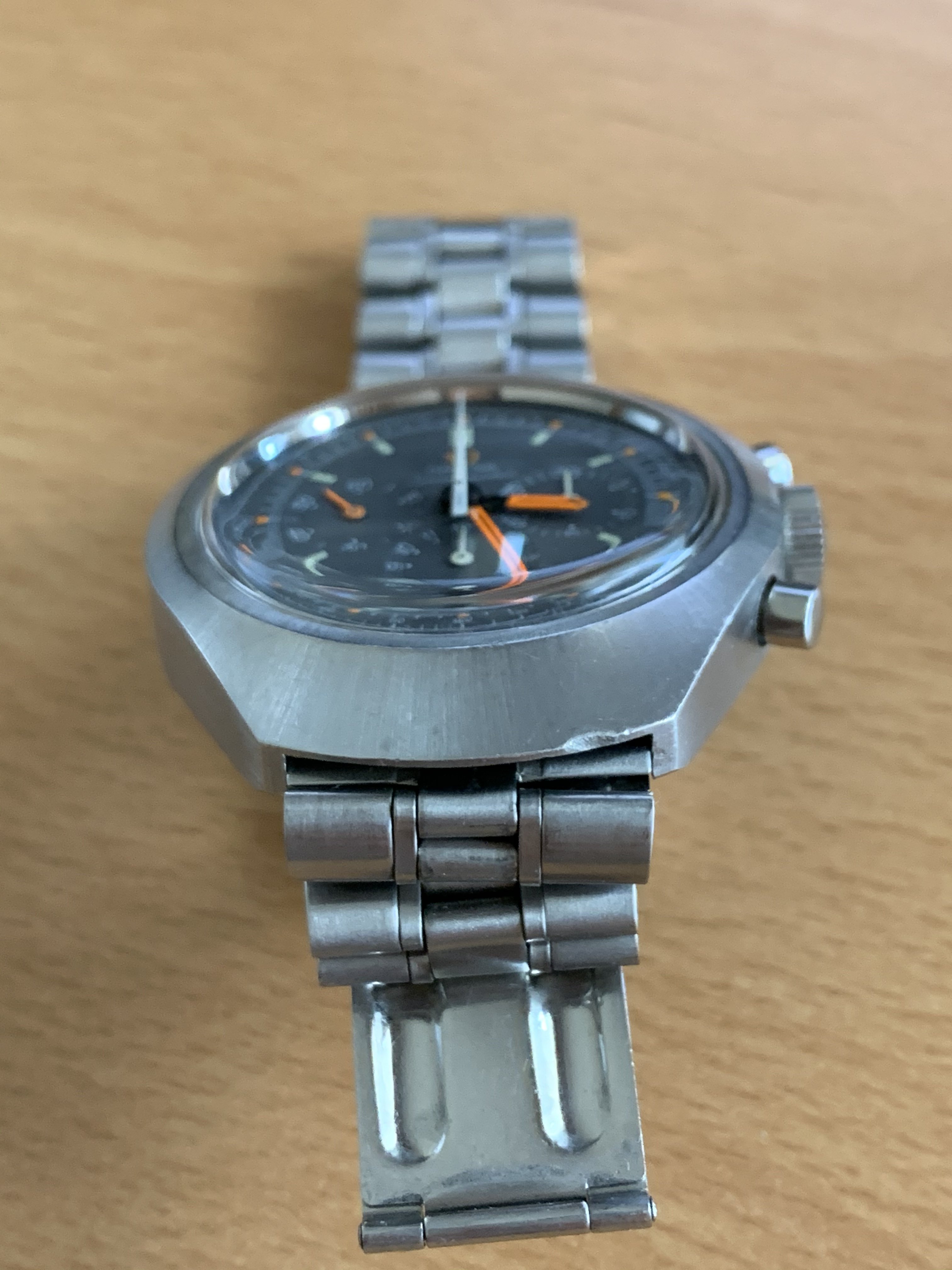

Recently I’ve purchased this nice 145.024 from a vintage dealer. I really like the watch BUT unfortunately it has (for me) a very noticeable dent at the lower side of the case front.
Could a Omega service polish (ok not totally) this out or improve the problem?
Should I give the watch back?
What’s your opinion? Would it have a strong impact on the future value of the watch?

Hi @DrSpock,
First up... it's just a Jedi... or at least that's the nickname that Chuck gave it. 😀
The whole flat jedi, other jedi, jedi wearing jodhpurs, Return of the Jedi eating a sandwich, etc is nonsense dealer speak 😉
This is something that could be laser welded, and then refinished to the original finish.
Folks like Swiss Time Services in the UK do this work, or Tanner Moorhouse in the US, and a there are a few wizards in Germany and Poland that also take it on.
Depending on where you are, you'll be able to get a suitable recommendation. 😀
As to what you do with the watch... that's down to you... future values... the magic 8 ball is sadly not coming up with anything helpful. 😉

Hey, thanks for the reply. That’s good news, because I like the style of the watch, and would prefer to keep it.
389
3,497
That dent is not going to be polished out. As @tyrantlizardrex commented, laser welding to build up the missing metal and then repolish/refinish it to match the existing finish is your best bet. Laser welding is not cheap, so it's your call on whether it's worth it.

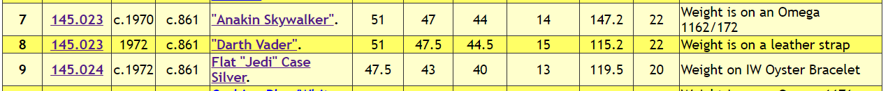

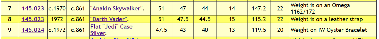

From ChronoMaddox.com -
Anakin:
Darth:
... both of which are 145.023, and since the 145.024 is a different case shape, and flatter...

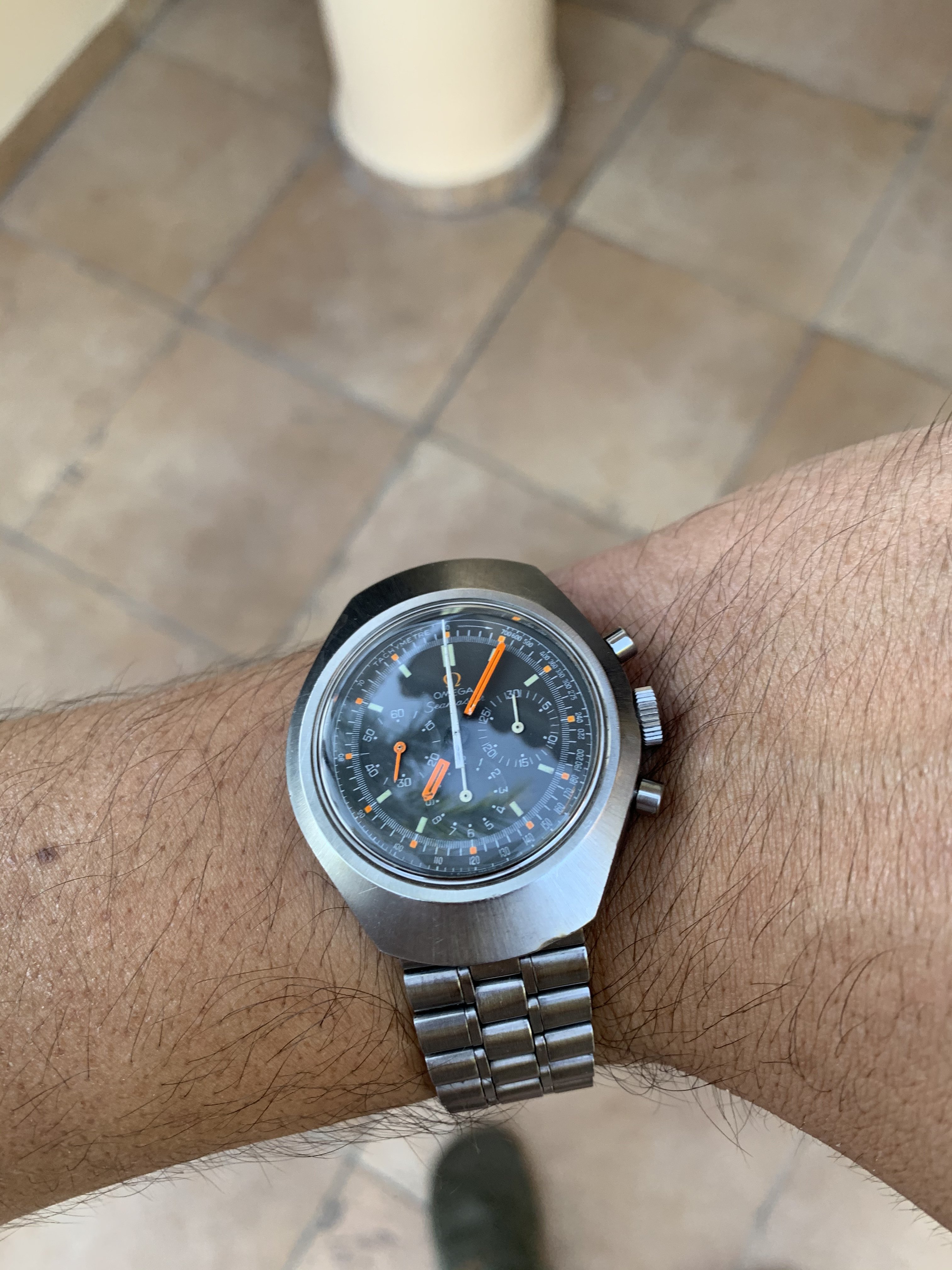

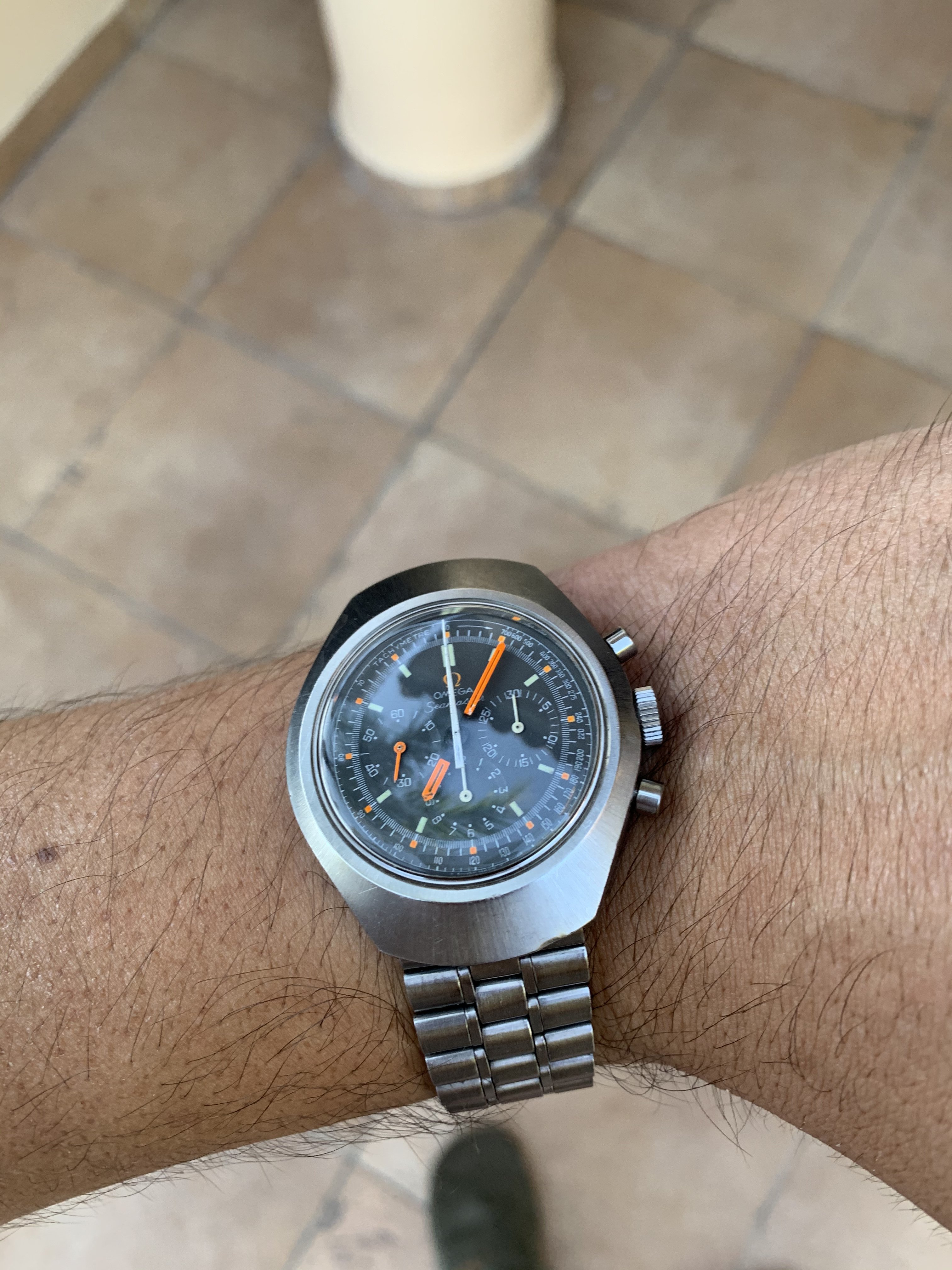

After a couple of days wearing it, the dent doesn’t bother me so much anymore , but it’s good to know to could have it fixed if I wanted to
Here a wristshot:
1,325
1,872
Here a wristshot:
Glad about that - these are huge lumps, so you are sure to make some more dents and scratches yourself along the way
