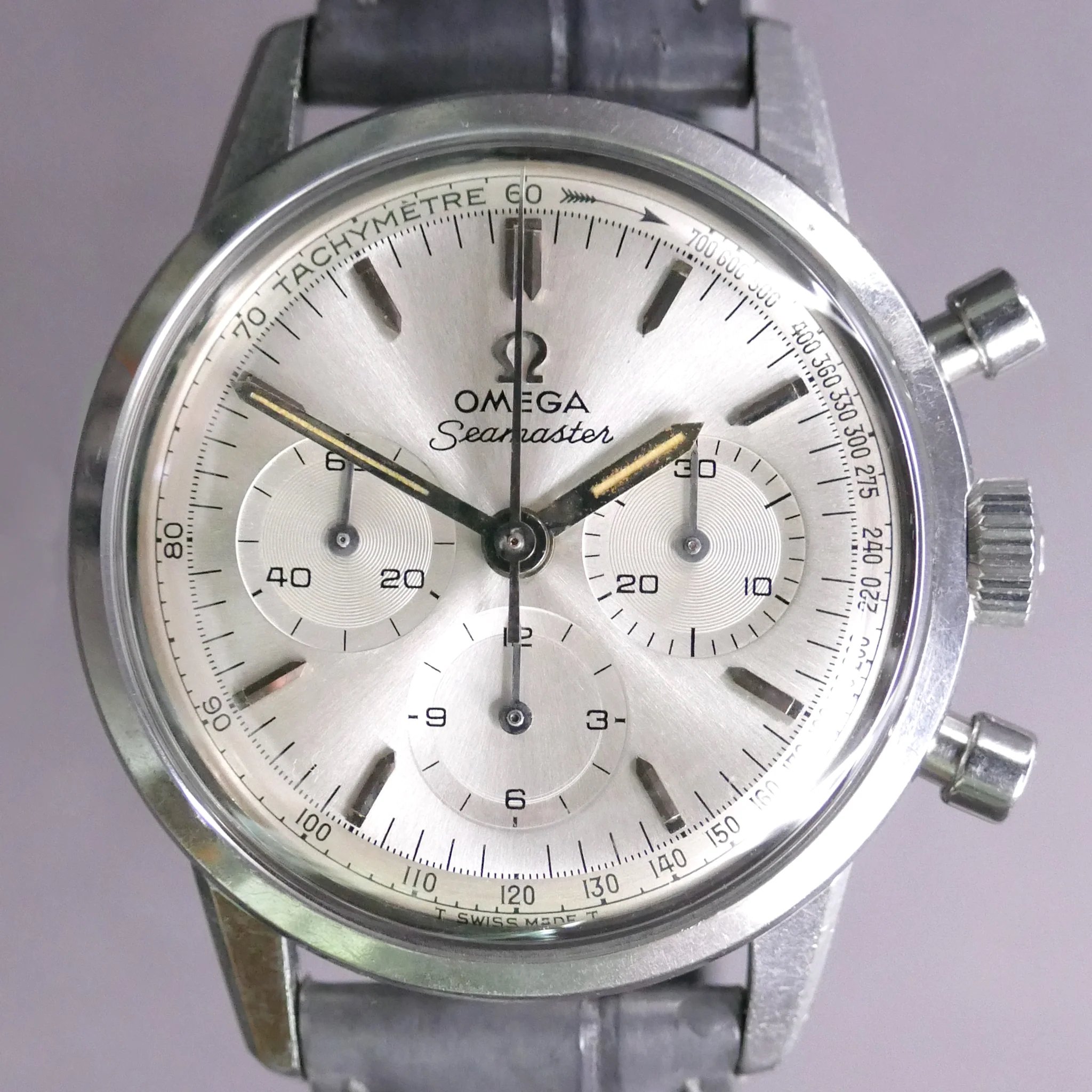

Just curious, has anyone ever seen or come across any vintage Seamaster Chronographs with the 12 hour subdial without snailing? There is silver sunburst in the center of the dial, and typically it "skips" the chronograph registers... and I've never seen where the sunburst goes across the subdial as well.
Thoughts?

If you’re asking if the dial is genuine - it is. The concentric circles can be hard to photograph

I agree that dial looks legit. It's interesting though, that the sunburst finish runs visibly right across the sub-dial.

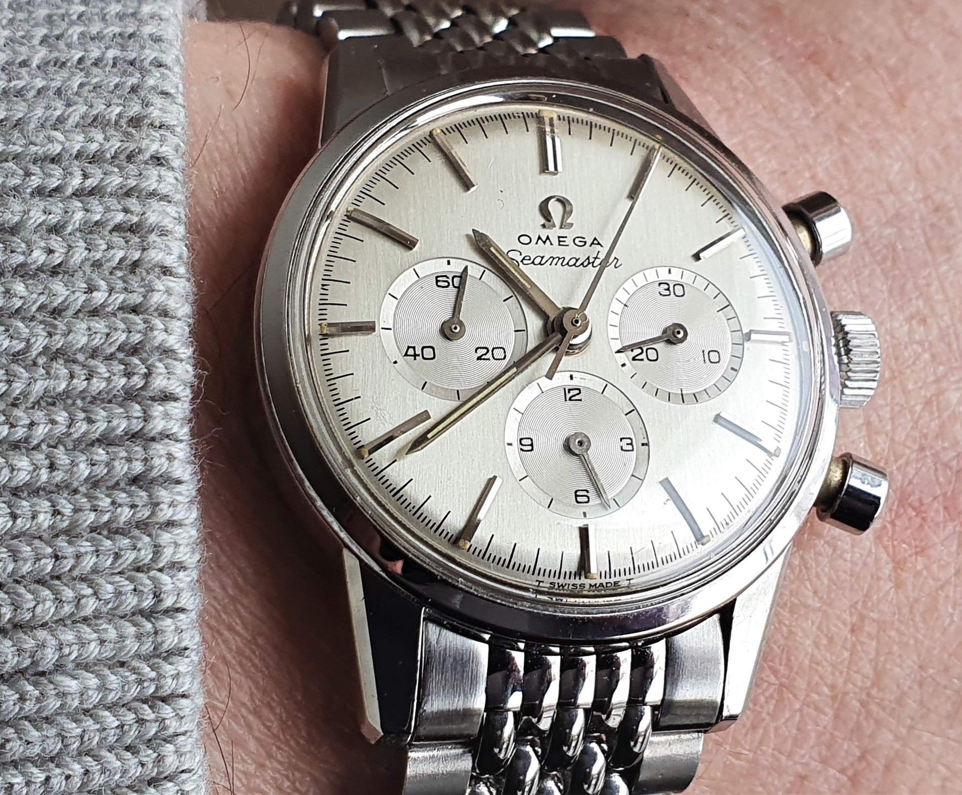

Should there be lume at the outer ends of the dial markers, to match the hands?

That’s the thing, everything dial wise looks kosher on this except the 12h subdial with the finish running through it, never seen that on any 321 Seamasters (or vintage chrono’s in general), but here we are. Tried looking at other photos of the same watch but doesn’t look like there’s concentric snailing anywhere?
2nd point. Do the hands look okay? Somehow the hour hand looks a little “fatter” than other examples of similar references…
Doesn’t look like a non-lume example, seems more like someone removed all the tritium. Hmm.

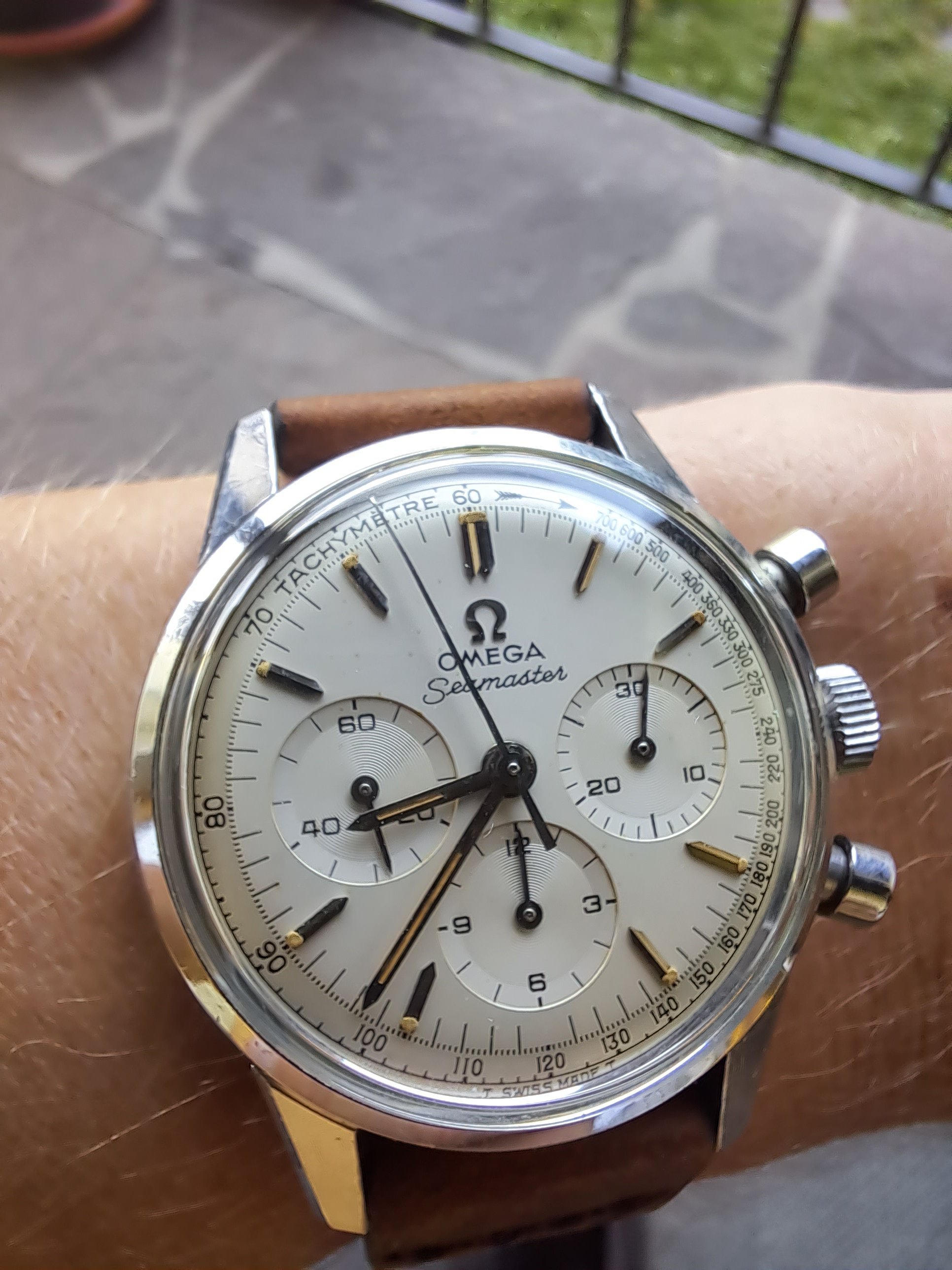

I have 105.004-64 but without a tachymeter, so it will be difficult to compare

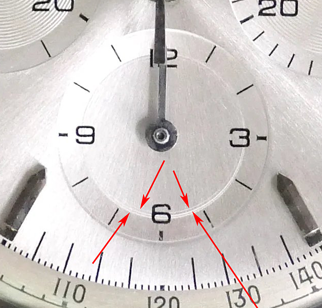

Looks like there are traces left...and the edges of the sub dials are not as crisp as expected.
I vote redial.
I vote redial.
I had the same thoughts too. But the printing is too good (too “accurate”?), unless it was a redial by Omega? But why would Omega themselves make a mistake like this? Or someone was able to get the exact print ball/pad?

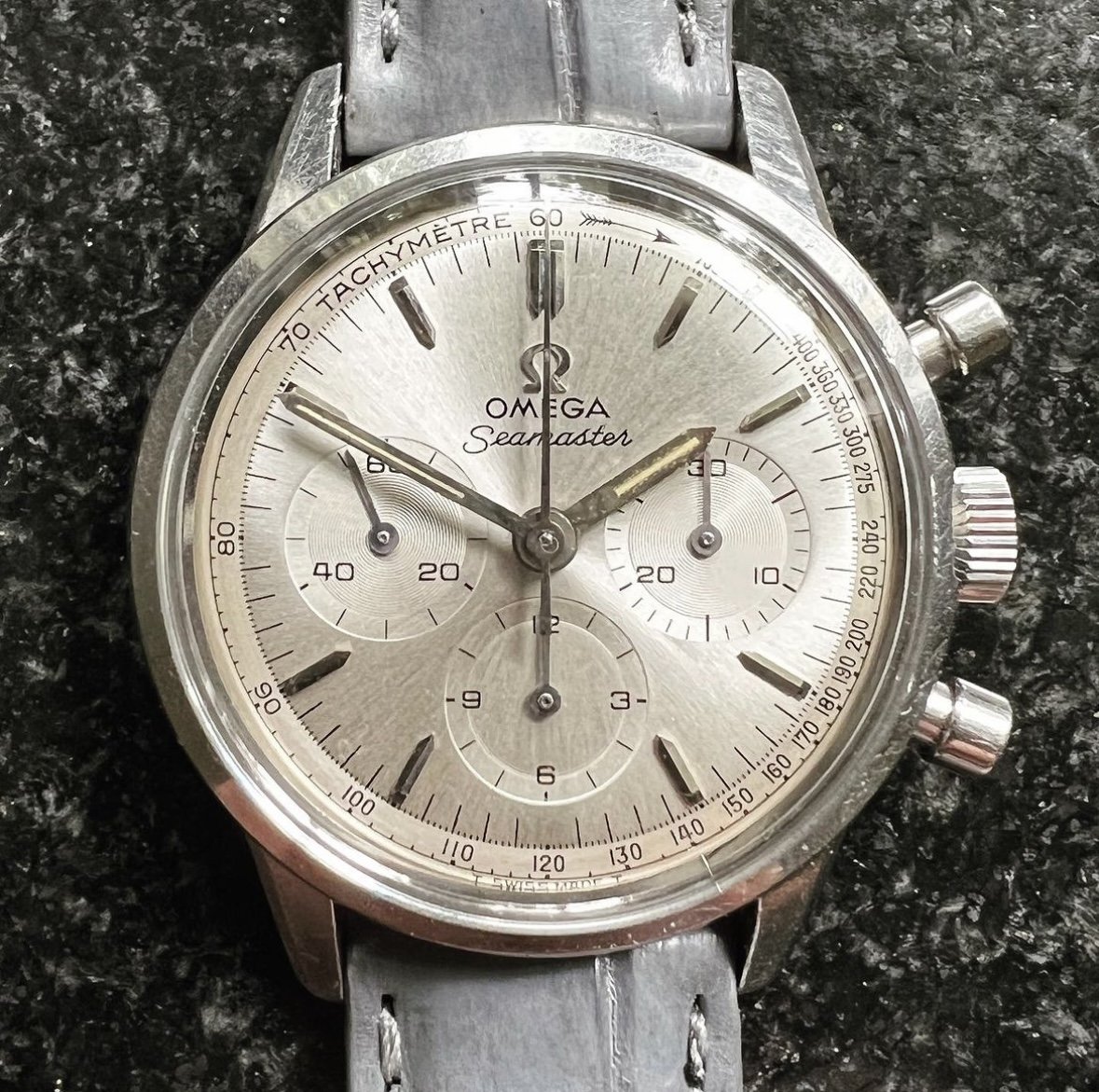

Here’s another pic from IG:
https://www.instagram.com/p/CvnHIo1rxtF/?igsh=MzRlODBiNWFlZA==

Looks like the sunburst is going across some parts of the other subdials also..

To me the hour hand seems to be too thick compared with other examples.
The dial was worked on before. They took away all the lume from the hour indices.
Just one subdial without concentric circles (and it seems that it isn't just the photo) would make me a bit nervous.
