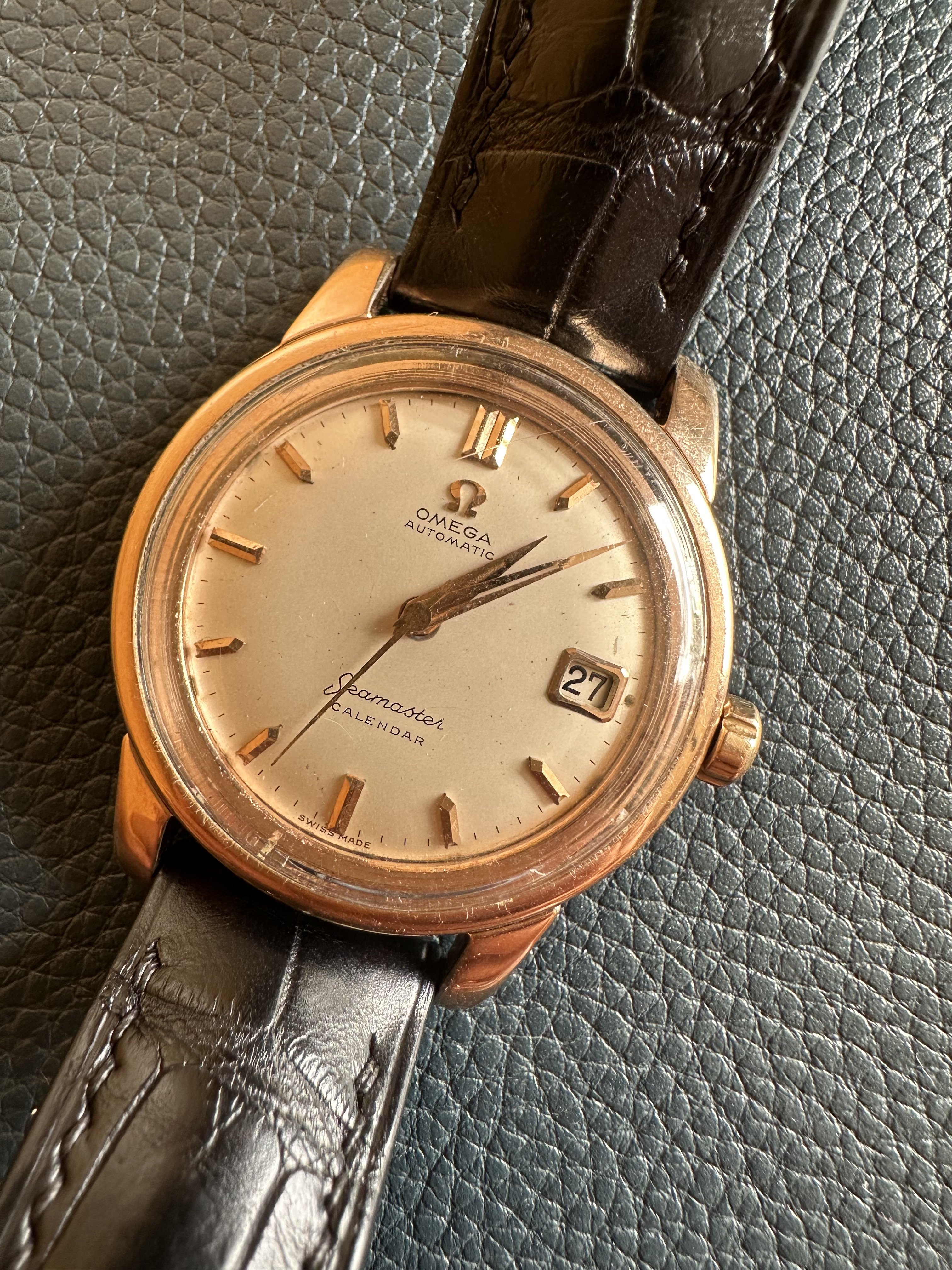

Posts 229 Likes 1,769 banshee ·Nov 26, 2023 Hi guys, I recently purchased this rose gold capped Seamaster Calendar, cal. 503, ref. 2857/2856. One thing that’s a Mistery is the internal bezel(between crystal and dial); I couldn’t find more examples like mine on the forum. Any suggestions on what’s going on here?
Posts 2,816 Likes 6,951 seekingseaquest ·Nov 26, 2023 Looks like someone put a regular size 2849 ref Seamaster calendar dial in a jumbo reference, and the internal bezel is to fill the gap.
Posts 13,493 Likes 31,814 X350 XJR ·Nov 26, 2023·Vintage Omega Aficionado seekingseaquest Looks like someone put a regular size 2849 ref Seamaster calendar dial in a jumbo reference, and the internal bezel is to fill the gap. This.
