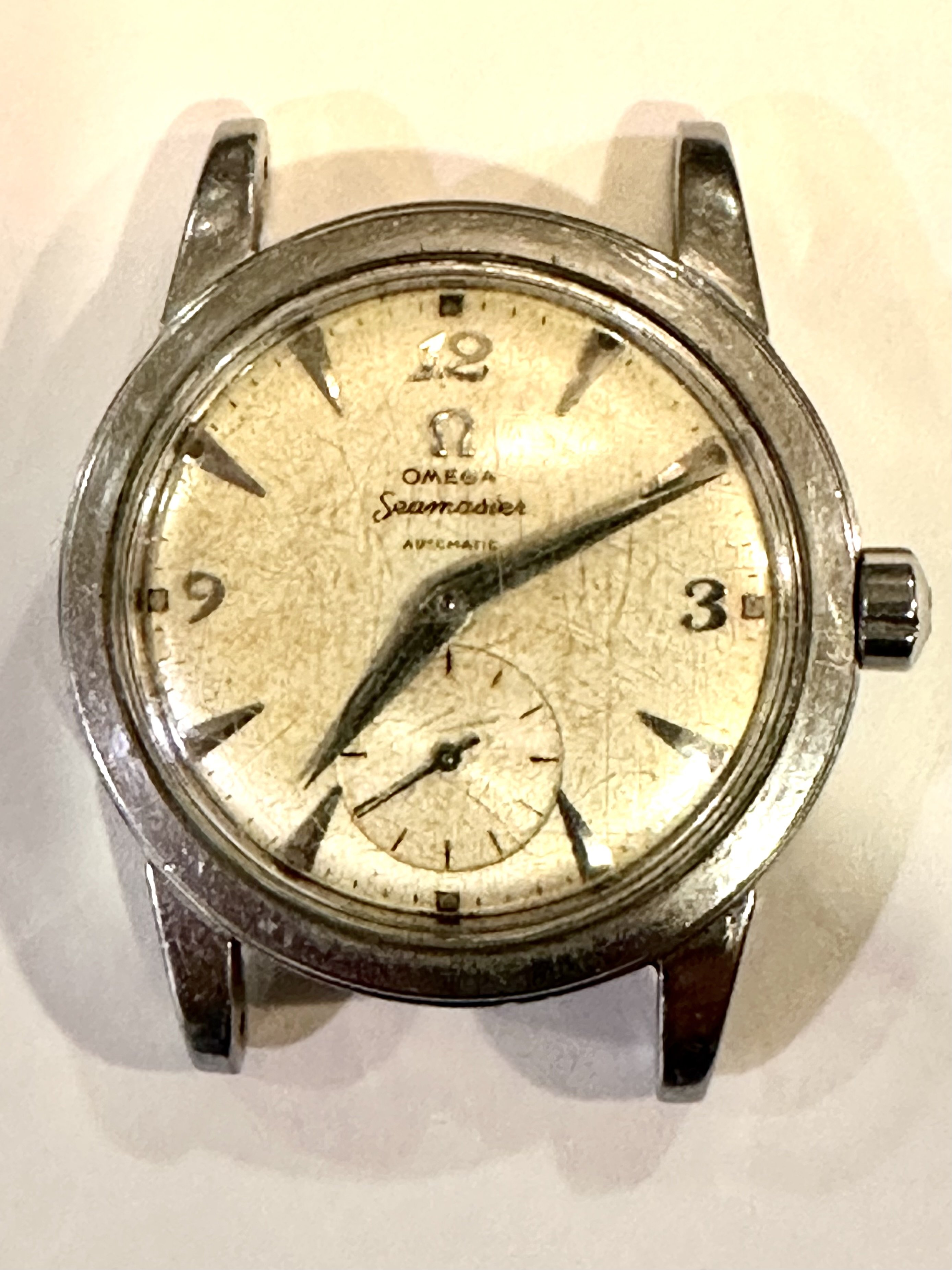

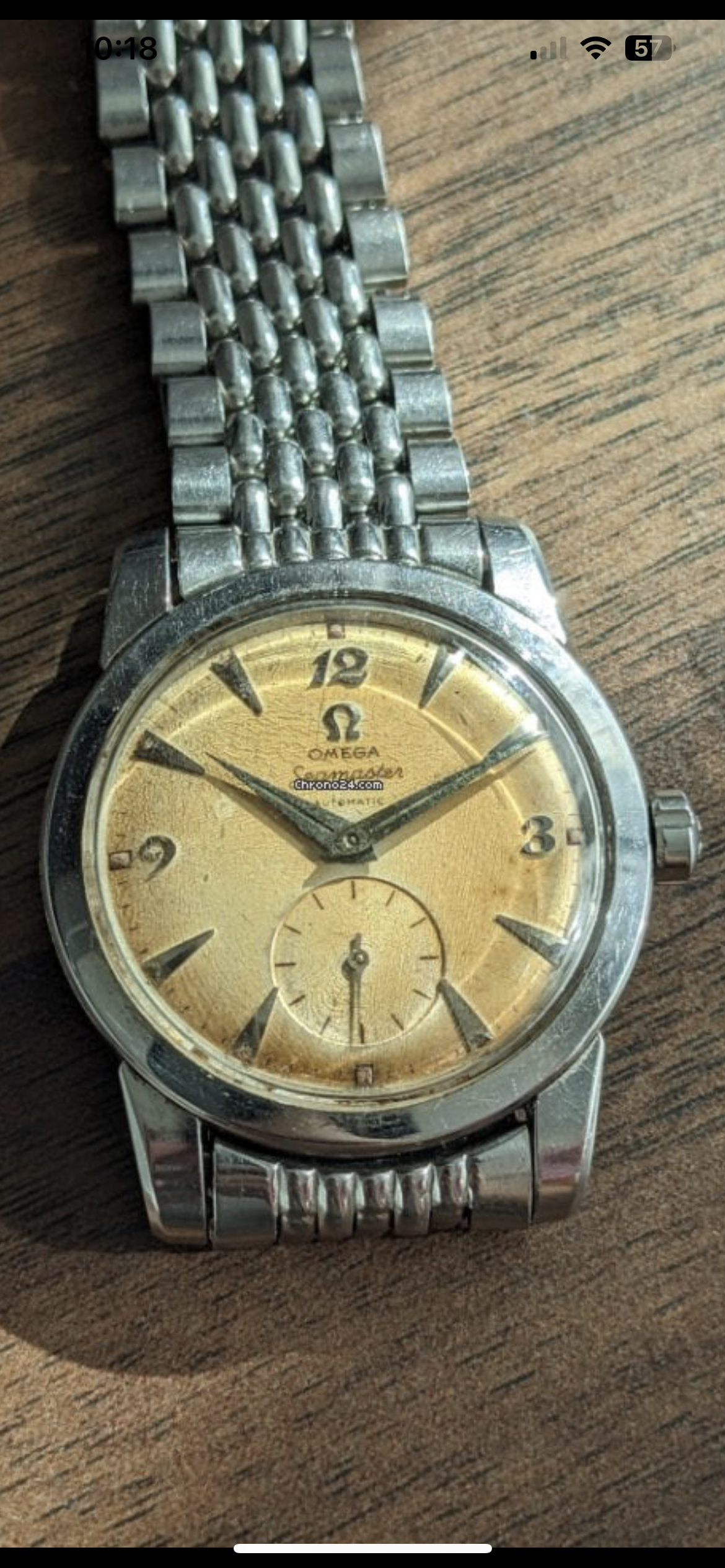

Greetings all! New to the forum and to Omegas. I have received my late father’s watch from my mom. This Seamaster has been in a lockbox for over 30 years. It is 34 mm and the watch has a noticeable internal bump to it when rotated…leaving this novice to believe it was internally damaged. After weeks of admiring the watch and doing some research, I gave the watch a winding and rotated it repeatedly, hoping not to further damage the watch. It has kept perfect time for a week now.

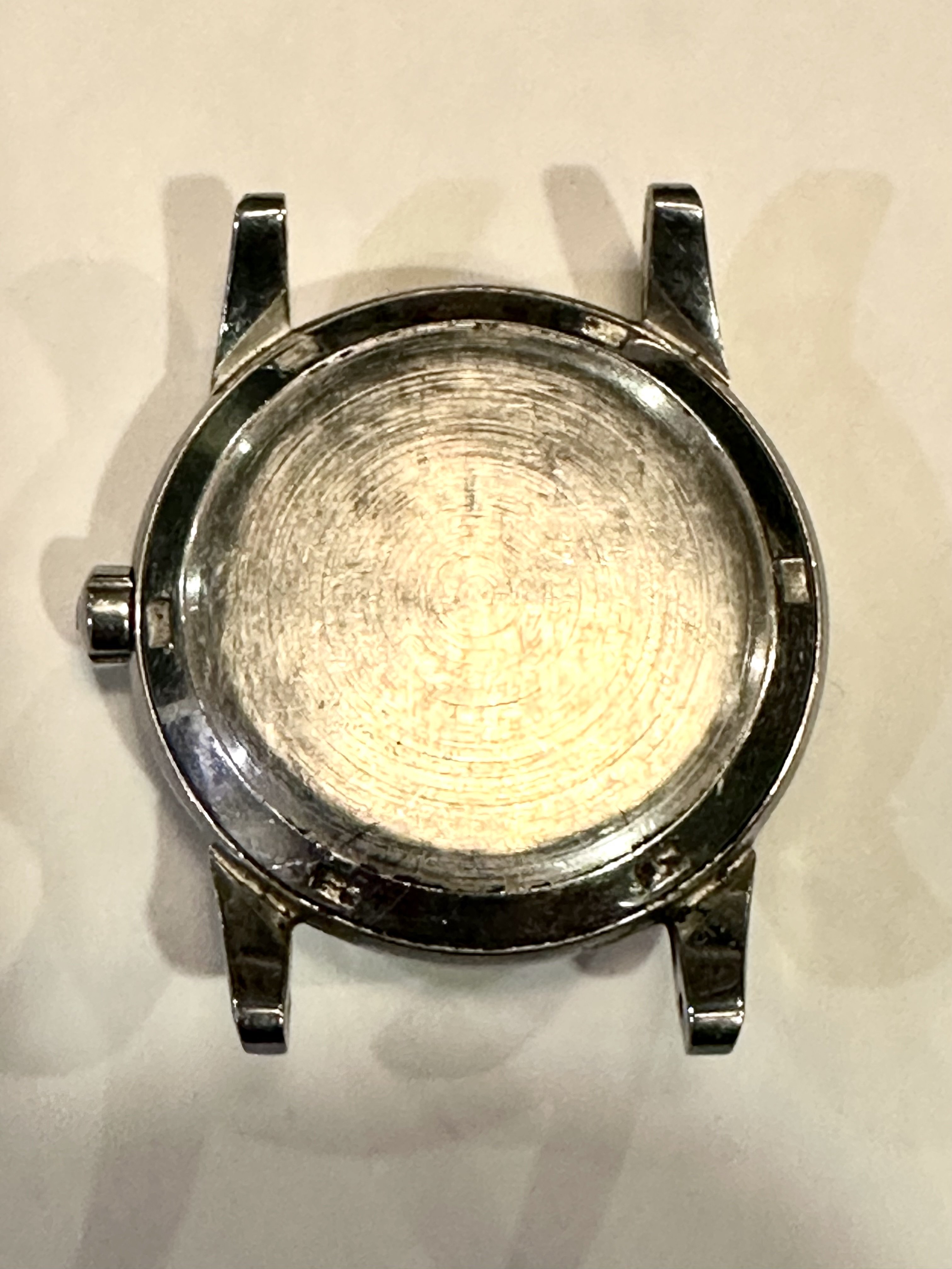

I can’t remove the back, so I don’t know the serial number. I am going to have the watch restored and after speaking with Omega, am considering sending directly to them.
Any ideas about the model or suggestions for service and restoration (or any other advice) would be greatly appreciated. Thanks in advance
There is nothing wrong with your watch. That is how a bumper automatic watch works.
Regarding service, Omega can certainly do the work you need, but it is going to be expensive and they may insist on refinishing the dial, which I would not do here.
There may be independent watchmakers in your area that can service the movement and give the case a light polish and charge only a fraction of Omega’s price.
Here is information on your watch from Omega.
https://www.omegawatches.com/en-us/watch-omega-seamaster-omega-ck-2576
Yours is one of the nicer original examples I have seen in a while.
Hope this helps,
gatorcpa

I am located within driving distance to Atlanta, Georgia. I am skeptical of the few places that I’ve been able to locate and speak with over the phone. I’m willing to ship the watch to a highly reputable independent company. I would like to keep the patina of the watch face, have a new crystal installed, have the internal workings and case refurbished. Thanks!

I would be careful with the case too. Don't refurbish it, a good cleaning is all that is needed. Polishing will degrade the sharpness of the edges and greatly reduce the value and honesty of the watch.
Go ahead with the new crystal, that alone will make the watch look great and not hurt value.
Bumper autos are fun to wear. Enjoy it.

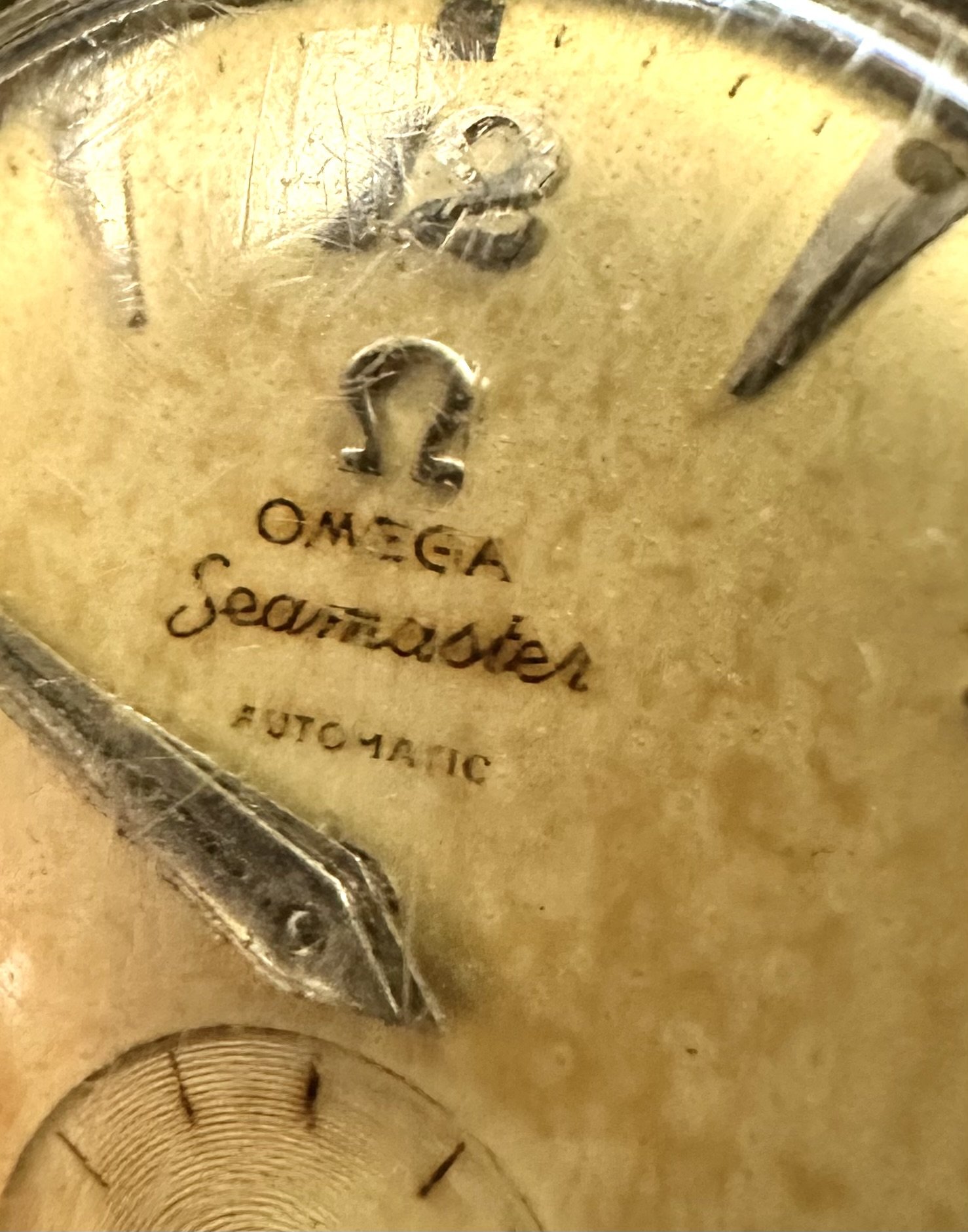

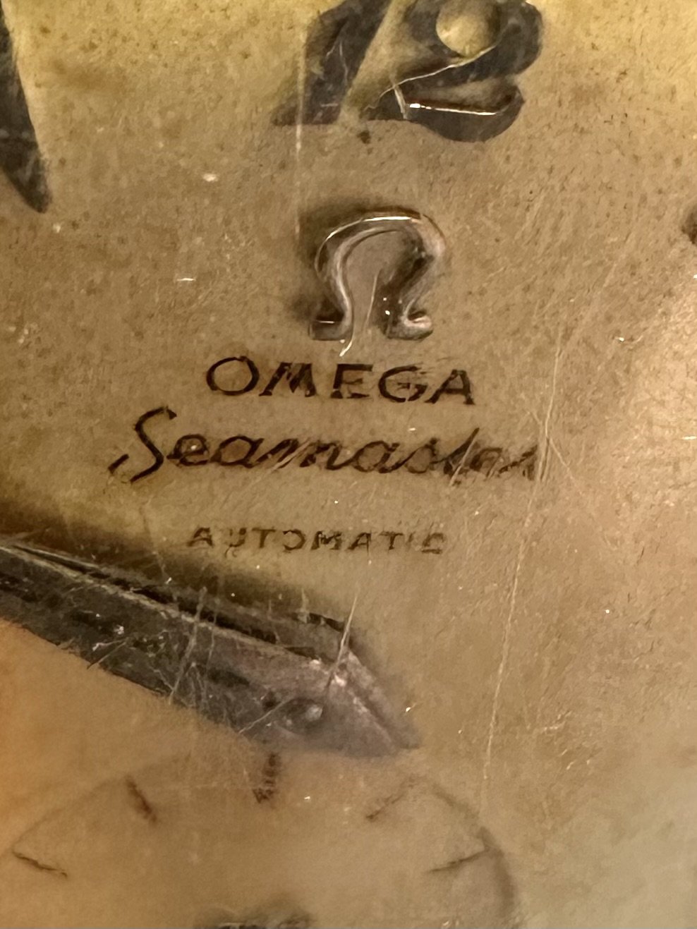

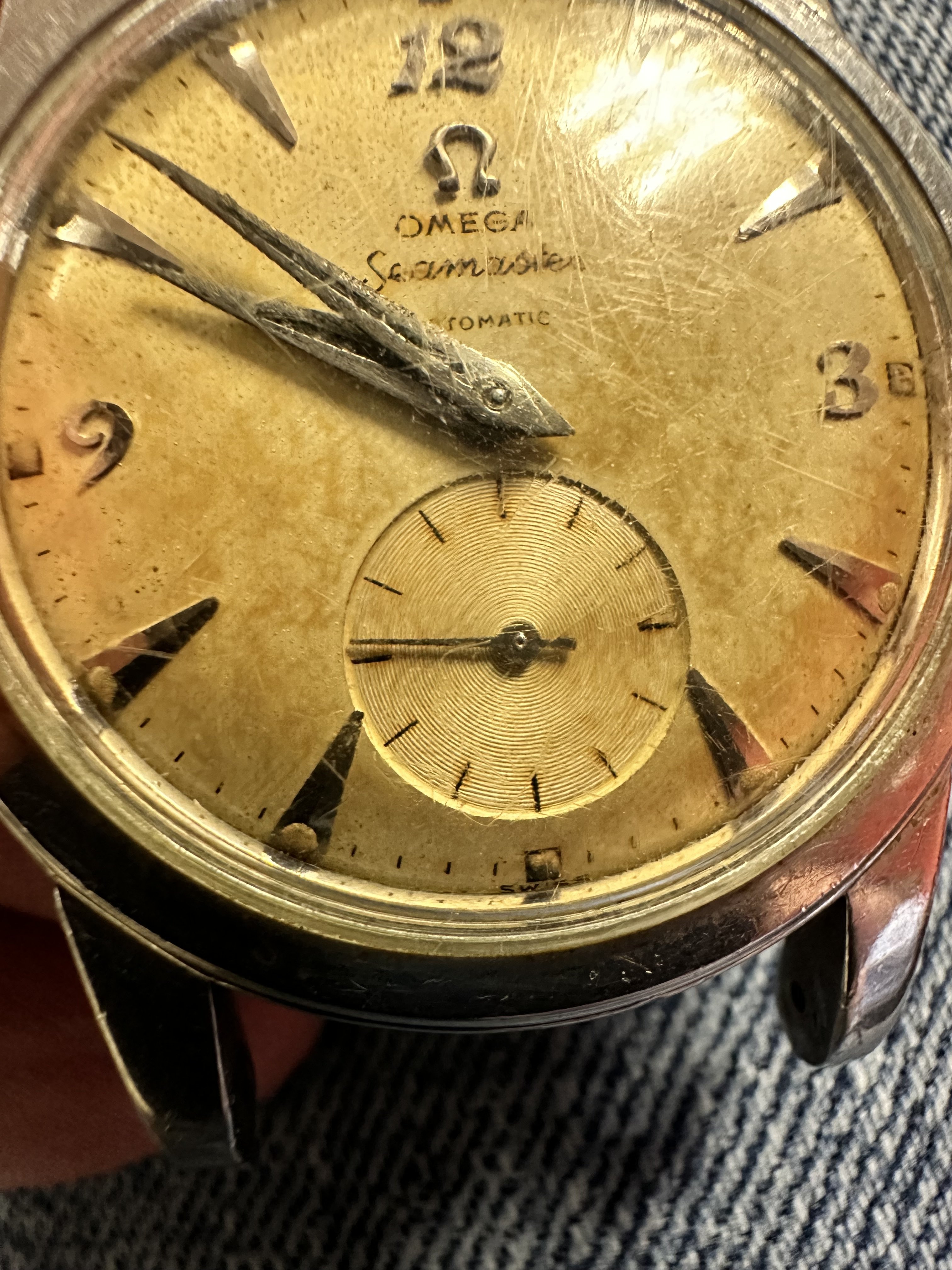

I have some concern that the dial may have been refinished in the past. The seamaster font appears heavy and the "e"s are different. Automatic may be incorrect and minute marks are inconsistent.
The word SWISS may be tucked under the crystal, but I can see it.
Better pics would help to be sure.

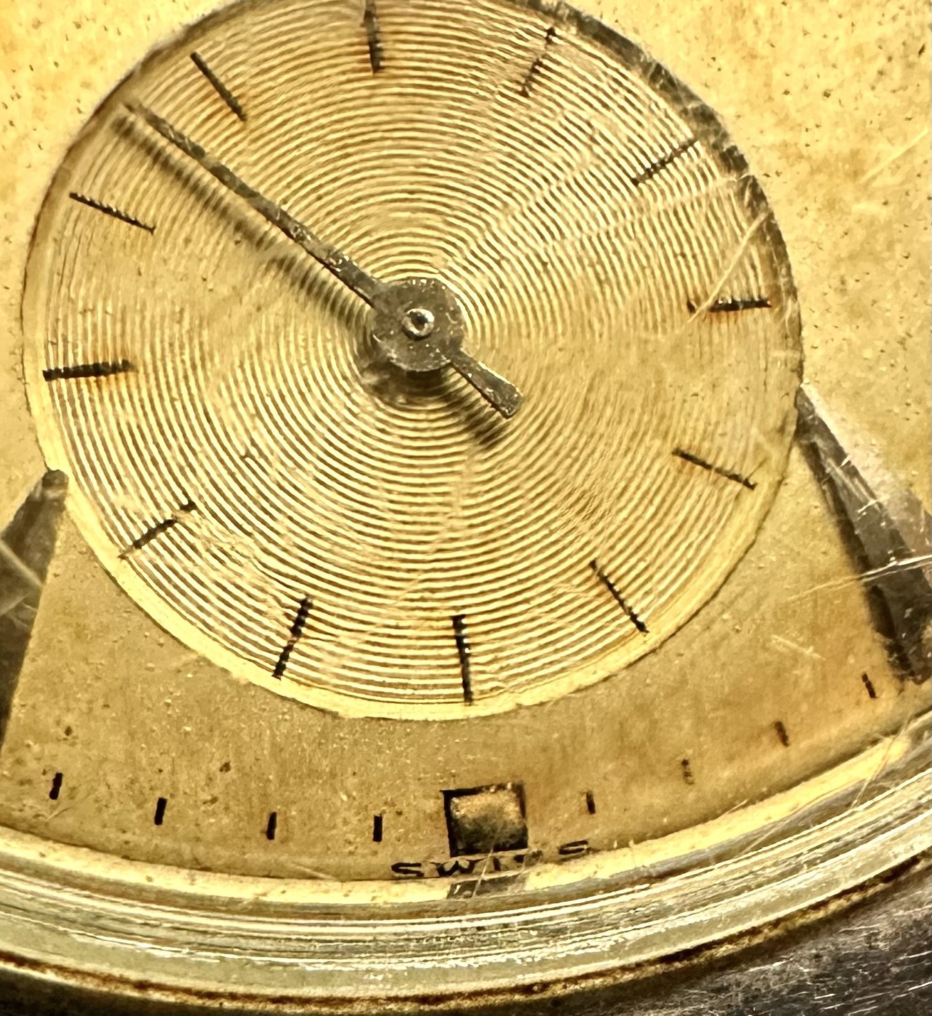

Here are more pics. I originally stated in my hasty post this morning before work that the watch had been in a lockbox for 30 years. My father past away 30 years ago…that watch has been locked away for likely 50 years. There is little to no chance it has been touched by anyone to alter/re-do the face or inner workings. The word “Swiss” is visible. Any imperfections to the letters on the face are due to scratches on the crystal.

A new crystal is going to really help that watch look beautiful. Thanks for the close-up photos; the lettering looks much better than it appeared in the initial photos.

These pics do help. I can see that the crystal scratches are causing the letters to look off. I think it is most probably original now. Minute markers look better too. Sub-dial looks good too.
A new crystal is going to transform this watch!

Nice original watch. The Seamaster font appears correct for earlier bumper era heres another example from sales post on C24 looks like your exact reference 2576-4. It looks good on Omega Beads of Rice bracelet the one in photo is 8220/11. I would only use independent watchmaker with Omega parts account who is respectful of wishes regarding vintage watch.
I would not ask for any case restoration or polishing. Just have it serviced and replace with Omega crystal. Then you are wearing the watch just as your father saw it. If you restore/polish case you can’t go back.
Enjoy and wear in good health !!!! Welcome to OF please post pics after service
