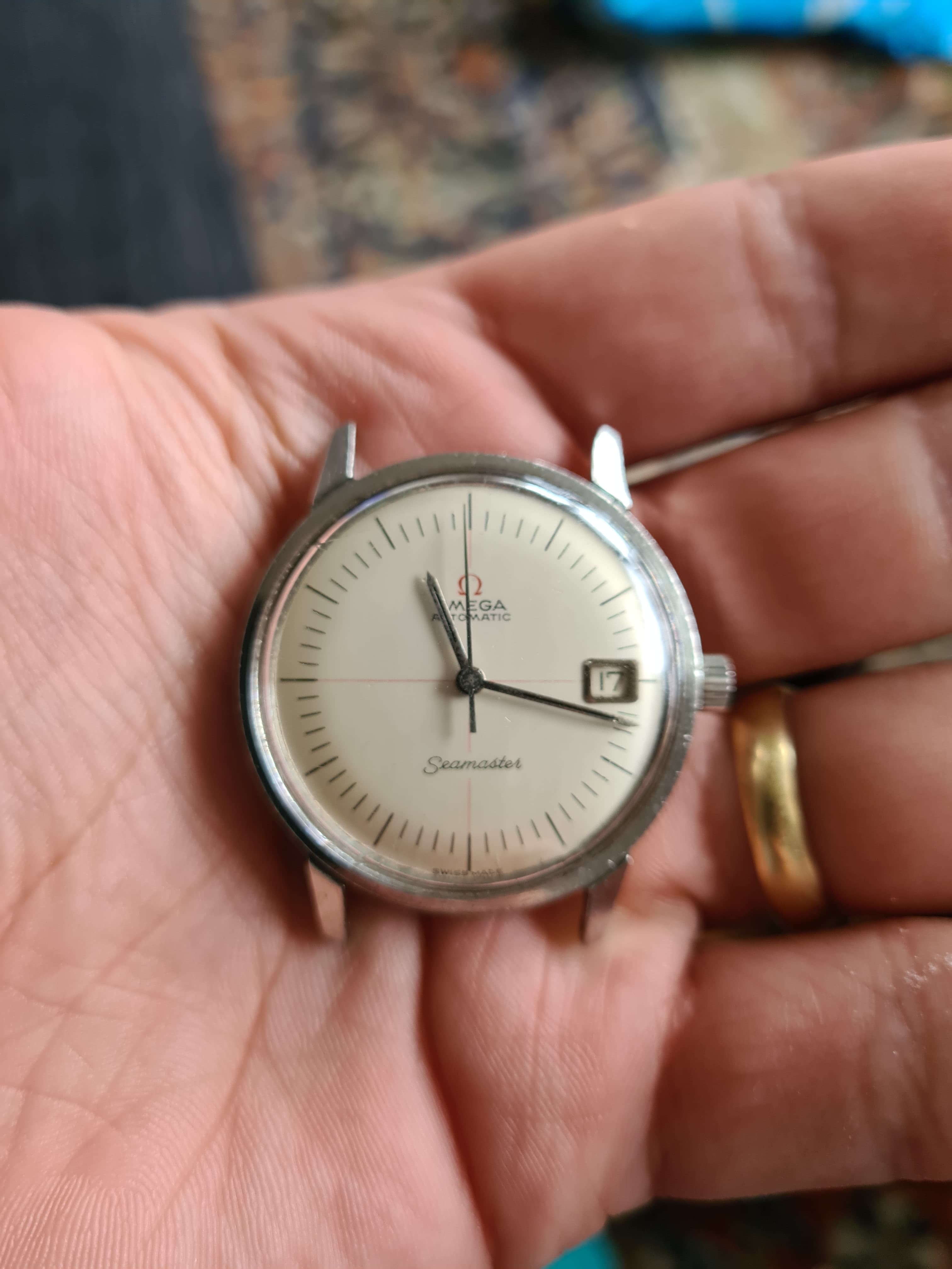

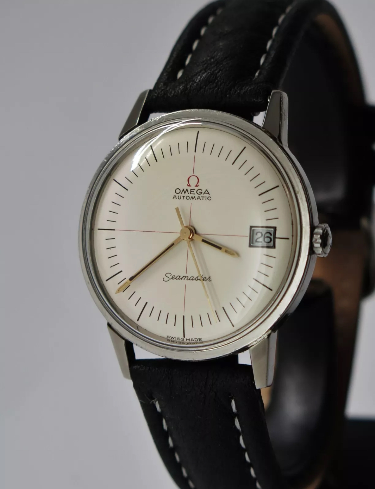

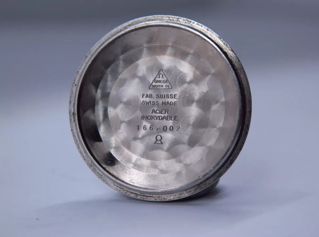

Greetings, folks. I’ve been down the vintage watch rabbit hole for years, but only recently started getting into vintage omegas. I am considering buying this mid-60’s Seamaster albino technical from a private seller.
I’ve noticed there are several forum members who share my penchant for Omega’s more experimental dials from the 60s and I’m hoping for a little help from your well-trained eyes.
Does everything look correct with this one? And if so, what’s a reasonable price range?
Thanks for any input!
5
Apologies, just realized I left out pricing information. Seller wants approximately $1,800 with shipping.
5

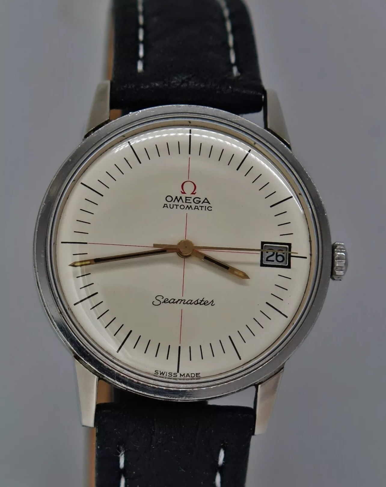

Thanks for the reply. The hands were the first thing that jumped out and made me want to get some additional feedback.
13,489
31,802
Agree, gold hands are off.

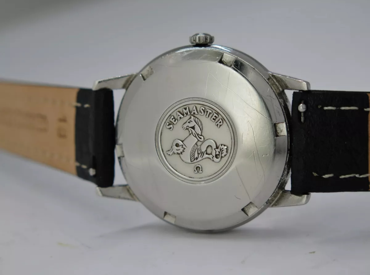

Case isn't in the best of shape either.
6
3

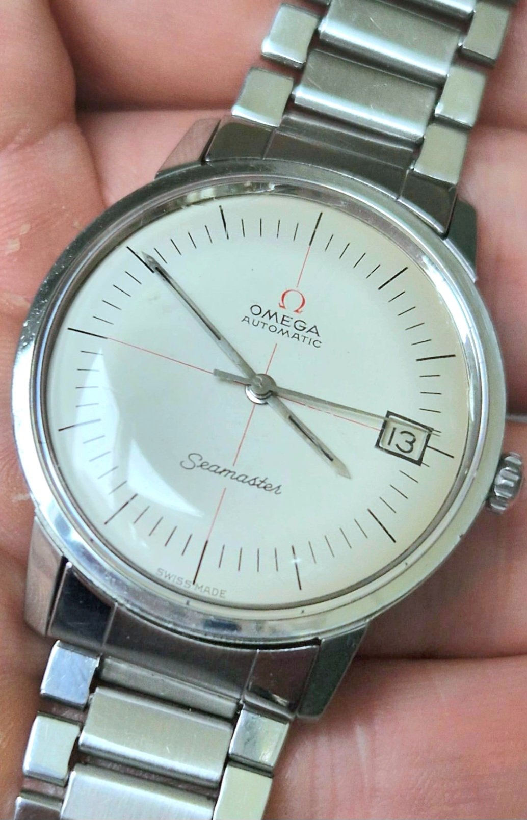

Also want to showcase mine!
Steel hands, but compared to the other two, a different date window
13,489
31,802
Hands can be sourced but with overall condition, maybe $500-600 certainly not $1800, tired and damaged case incorrect hands, you're really only buying the dial.
