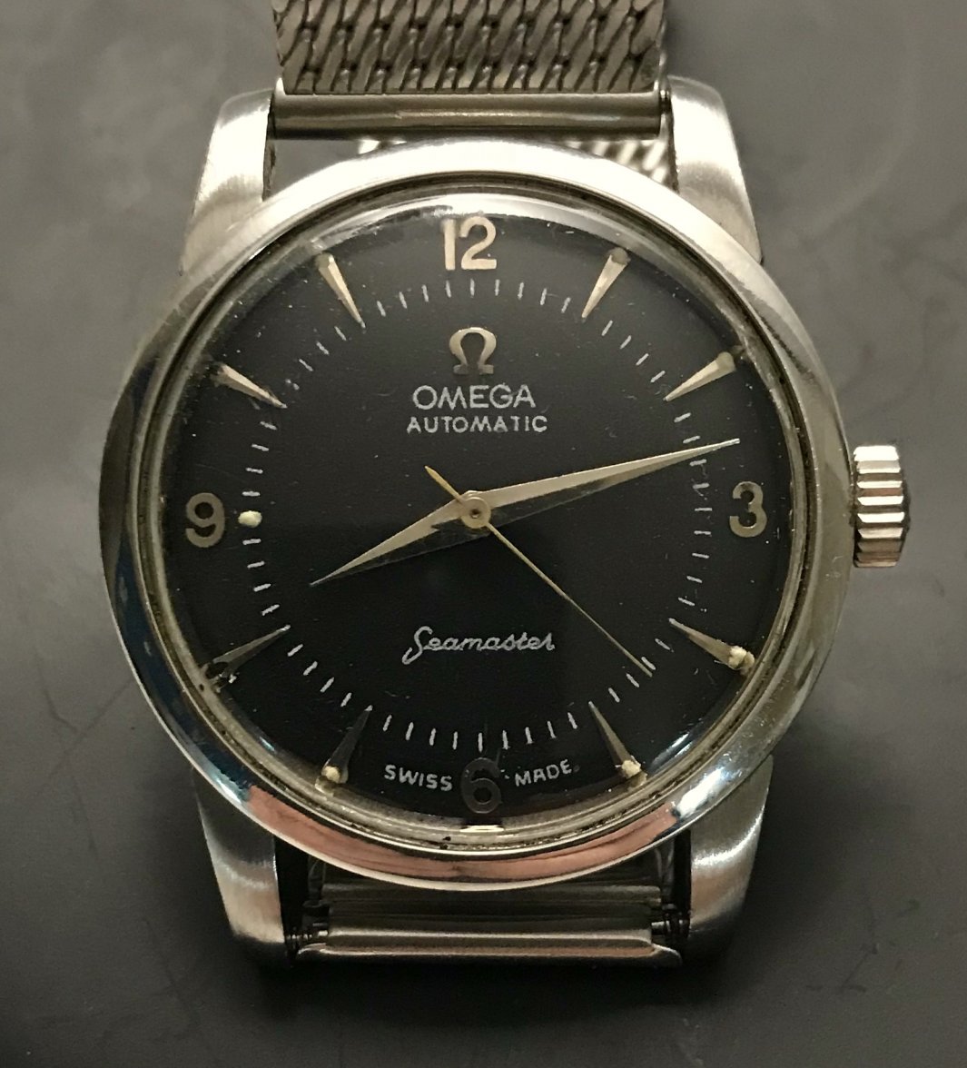

Hi folks, have just joined the site and already taken advantage of the Calibre Date List that somebody helpfully posted. So, I have a 1954 Seamaster… but seeing other examples online I have a few of queries I'm hoping someone can help me with:
i) are the blobs of lube (no longer functional) an original feature? They seem to be blocking out the tail-end of the markers and look a bit sloppy. Should I try to get them removed?
ii) the crown is signed with the logo but is the milled style original to 1954?

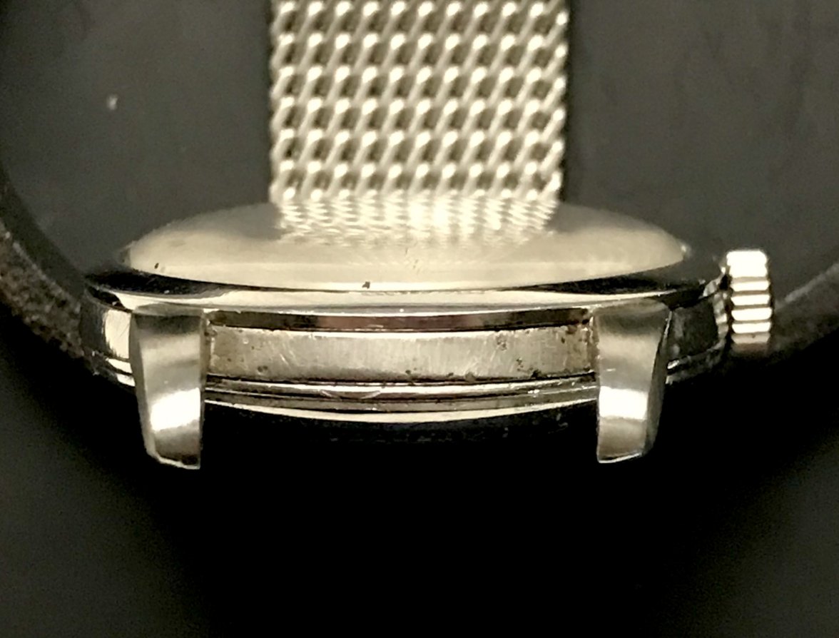

iii) the side of the case between the lugs is very rough (unpolished) compared with the visible parts; is that normal?

I have no idea about the case but that is an awful redial

Definitely a redial. If it’s your fav everyday wear, then perhaps we don’t need to go into it and just enjoy!
If you’re asking about originality, in terms of collectibility and value, there’s not much there. But they doesn’t stop it from being an enjoyable wear.

The dial has been repainted. Not terribly well, I'm afraid.

Okay… for future reference, would you mind telling me how that is so obvious?

Several tells. The most obvious to me:
Location of Swiss Made
Poor quality application of text
Poor quality application of minute markers.
Positioning of minute markers in relation to minute hand. The tip of the hand usually lines up with the minute track, so either the hands are incorrect or the dial has been redone.

Blimey… they could have drawn the hands on with crayon and I'd probably still have bought it. Thanks for the response Davidt!
