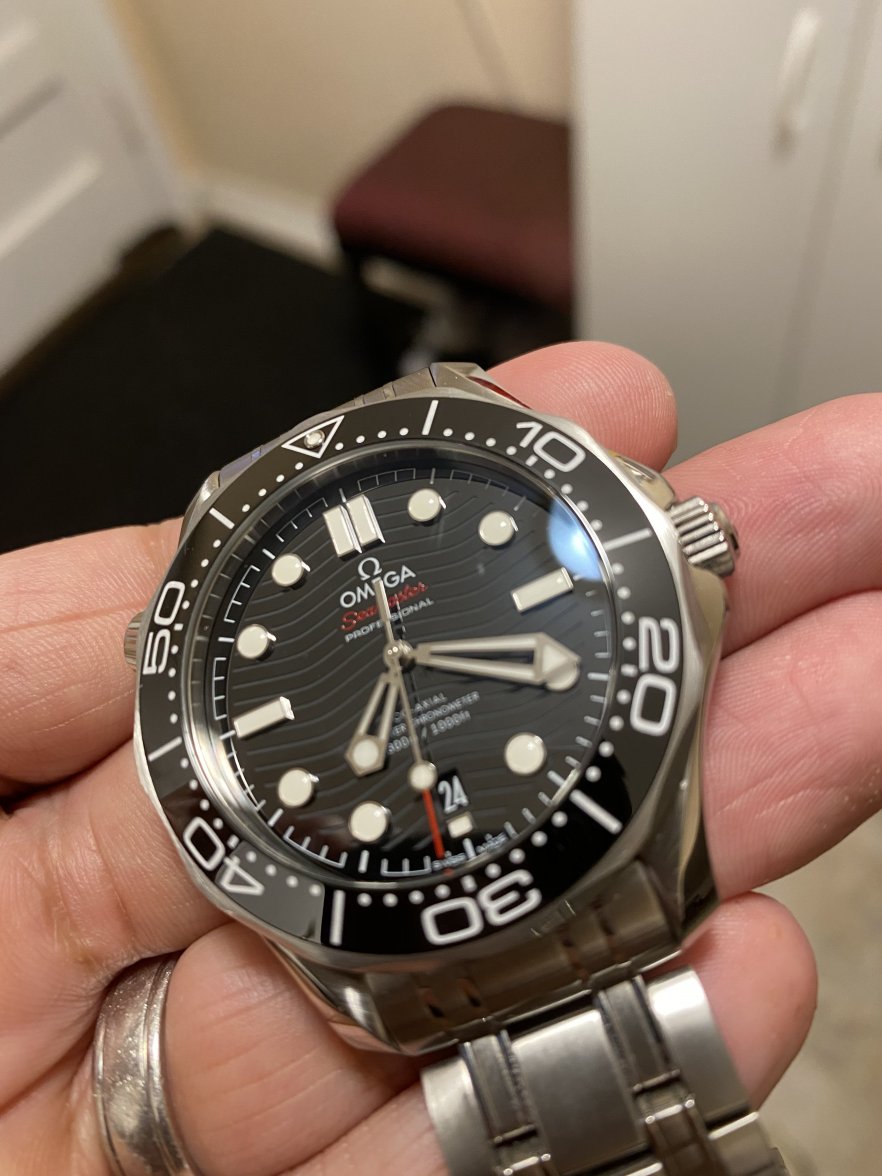

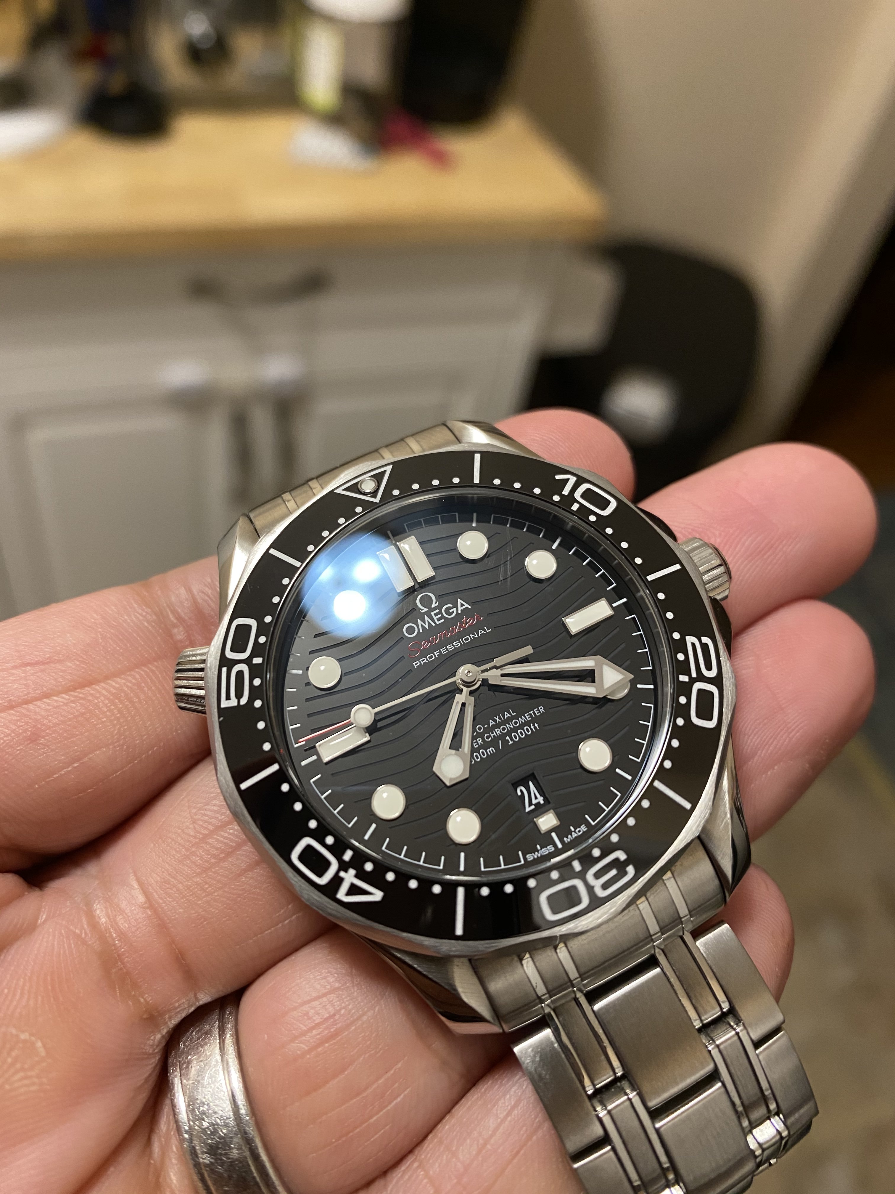

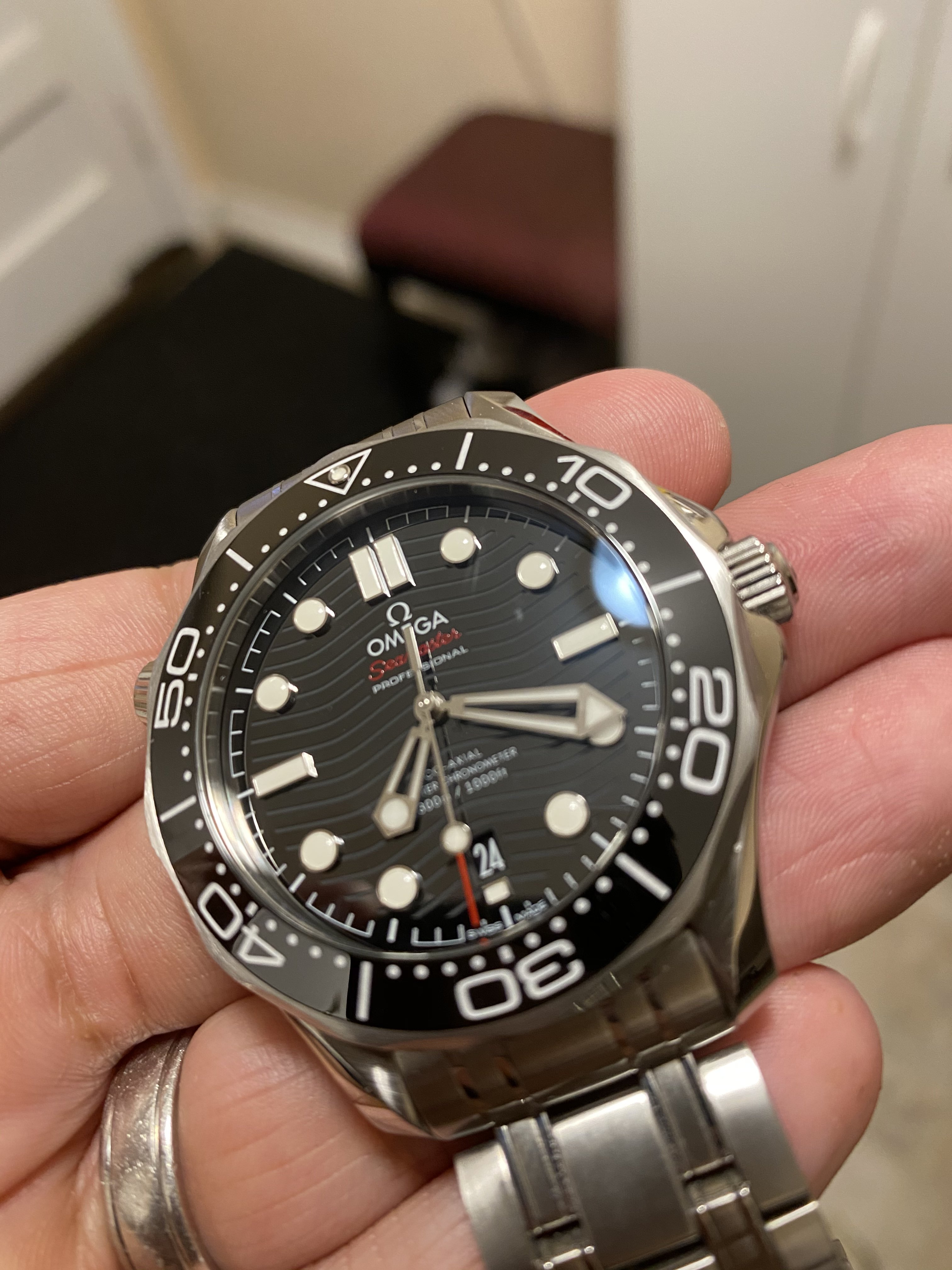

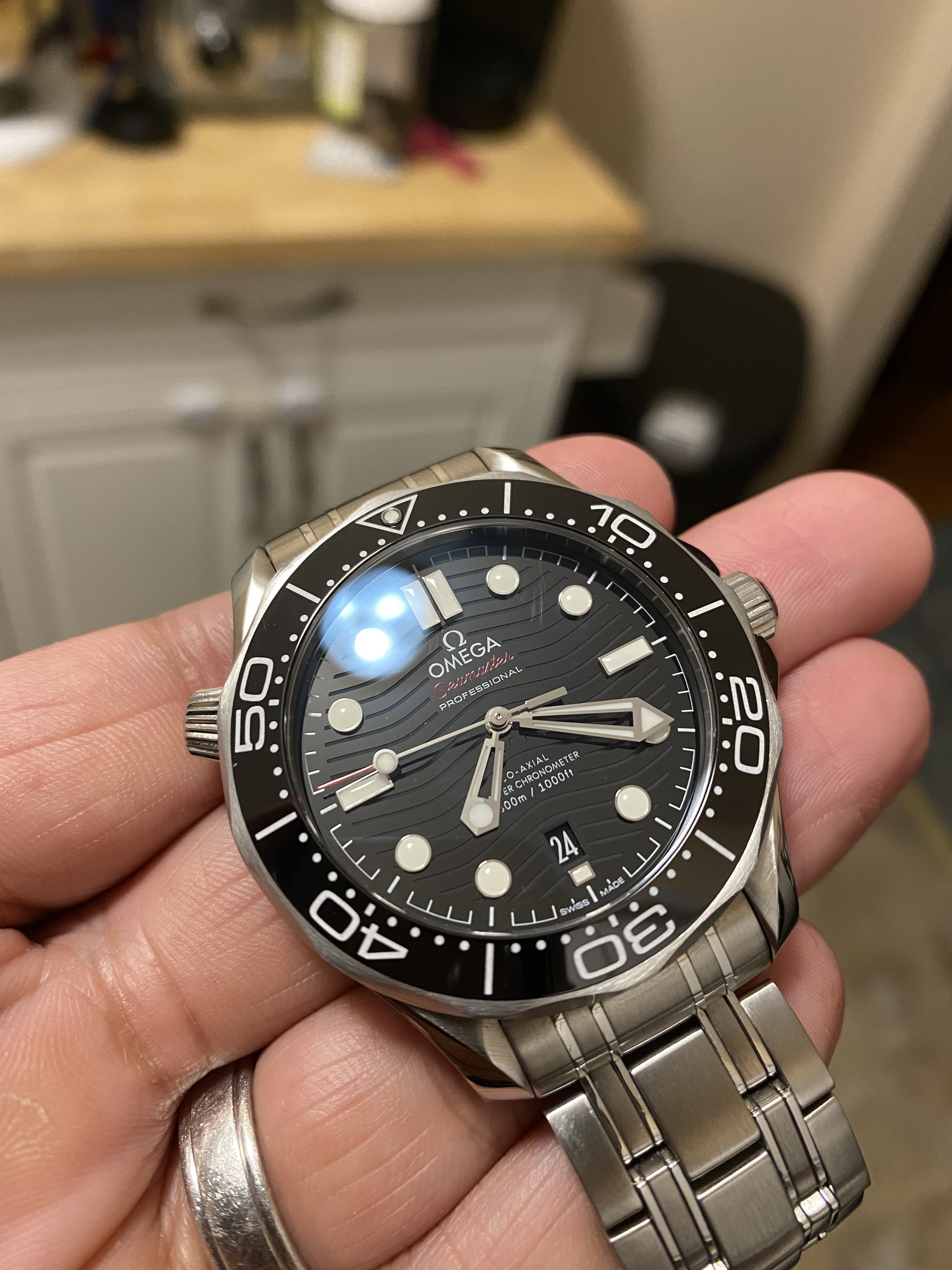

Original owner of my 4 month old SM300 and I’ll admit I don’t baby it but I was surprised to see scratches on the sapphire or AR coating - just not sure which one. I can’t feel it and it’s only visible at certain angles. A few years ago I did have a scratch on a Seamaster that was definitely on the sapphire as it made contact with my wife’s diamond ring - there was no question about that as it was visible from every angle and had a depth to it.
With this one, I’m not so sure if it’s the AR coating or the sapphire. Picture attached (it’s close to the 1 o'clock marker). Are there any ways to definitely tell without taking it to a watchmaker? Either way, I didn’t think the watch would be this delicate. It’s definitely a let down for a $5k+ watch.

Yes it's scratches on Ar coating...you replace Crystal or move ar coating...
I know it's crazy because you spend mutch money but this is the real truth.

You have three choices. Live with the scratch, replace the crystal or remove the AR coating with polywatch. If you decide to remove the AR coating, make sure that you tape off the bezel first. The AR coating is similar to the coating on prescription eye glass lenses. It’s reasonably durable, but it’s far from scratch proof. It makes one appreciate the hesalite crystal on the Speedy Pro - prone to picking up scratches, but they polish right out.

I've definitely vigorously wiping with damp microfober towels, but it's still there. I'm totally ok living with it. I just want to know, how do I know it's on the AR coating and not the sapphire itself?

Put your finger in scratch ..if you feel it it's from sapphire...if not from ar coating..
I am sure it's from Ar coating..

To me it looks like a scratch. That said, I would think you might remember an encounter where a scratch to sapphire would've occurred as opposed to AR, but perhaps not. What do the marks look like compared to the rest of the crystal when light is on them? You can see the blue effect of the AR in your original pics, I would guess that scratches would appear whitish and AR scratches would just glare.
Of course, I could have absolutely no idea what I'm talking about.

I think your question was addressed and answered, your AR coating is scratched. The crystal is fine, it's the coating that's scratched. It doesn't matter the value of the watch, an AR coating is the same regardless of the price of the watch. Personally, I don't like AR coatings, especially on sports watches, as they can be damaged in normal wear even though the rest of the watch remains near perfect. It is one of the downsides of AR coatings. It may make the crystal almost disappear in normal light conditions which is great for viewing, but you do have the issue of scratches. Remove the AR coating and you'll be fine, your sapphire crystal is pretty resistant to scratches.
