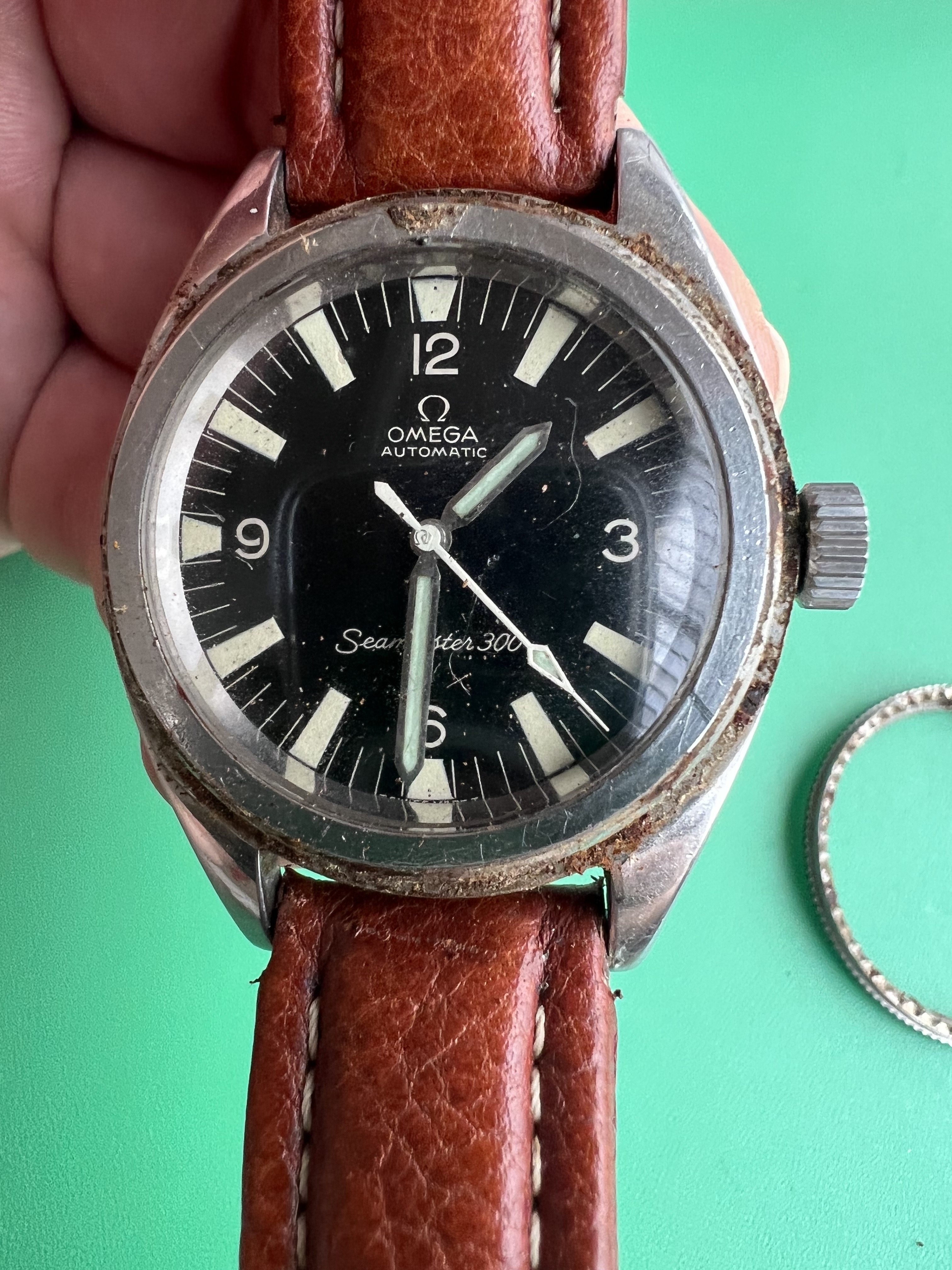

825
1,808
Grime time!
Yes. It’s a new arrival and I was investigating the cause of the stuck bezel. Seems to be filth.
