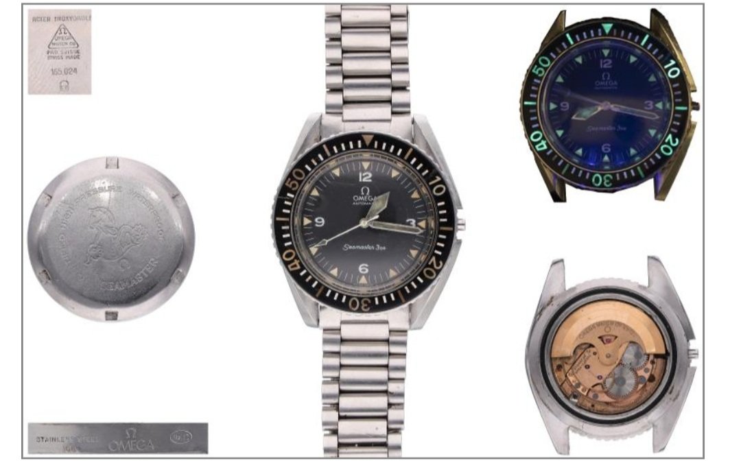

Seamaster 300 ref. 165024 atipical dial

Hello everybody, I am Daniele and I am new here, nice to talk to you all.
Is there anyone who could help me about this dial?
Thanks in advance

Hi, I have never seen such dial, does it look original? Maybe repainted?

Likely an Omega service dial - but not a nice one!

Thank you very much Dash 1! Does it mean the value of the watch is low? I ask you since this watch is going to be sold at an auction and I wanted to make an offer.

Looks like the dial from a CK 14755, which was only available for a short period. See this link with a picture from a catalog showing it:
https://omegaforums.net/threads/need-info-about-seamaster-300-165-014-dial.60332/
But that was a different case, so this dial is not original to the watch. Might be from an older watch, might be an incorrect service dial. Can't tell from the low quality pictures. I'd be concerned about the lack of a crown -- how long has it been missing? Is there any rust hidden in the movement?
1,677
8,439
The dial is not correct, however you look at it. So the watch is not going to have much value. Automatic pass for me.

Thank you very much Donn.
I don t have any infornations about the crown and it is possible that some rust is in the movement.

Thank you for the answear calalum.
I thought to make an offer since the auction starts from €2500 and I suppose to be a good one to own a Seamaster but I didn't know it is a fake

An incorrect dial does not make the watch a fake. Better not spread that kind of assumptions.

You are right, I did not use the proper word

Yes, I would say the value is low on this one. It’s usually much better to pay a higher price for a nice one in the end.

I think this watch was sold like 2mths ago on ebay...If I remember well, it went for cca 2700 pounds.

Now is going to be sold on an auction in Italy from a bank. The owner gave it to the bank in order to have money back. For this reason I don't think it is the same you saw on ebay

May be different watch, but I doubt...I was bidding on it... CB case, wrong service dial, missing crown...I may find a pic somewhere stil..

If you want you can make an offer, the auction will be on 13 December, it starts from €2000

Errata corrige: it starts from €1800
