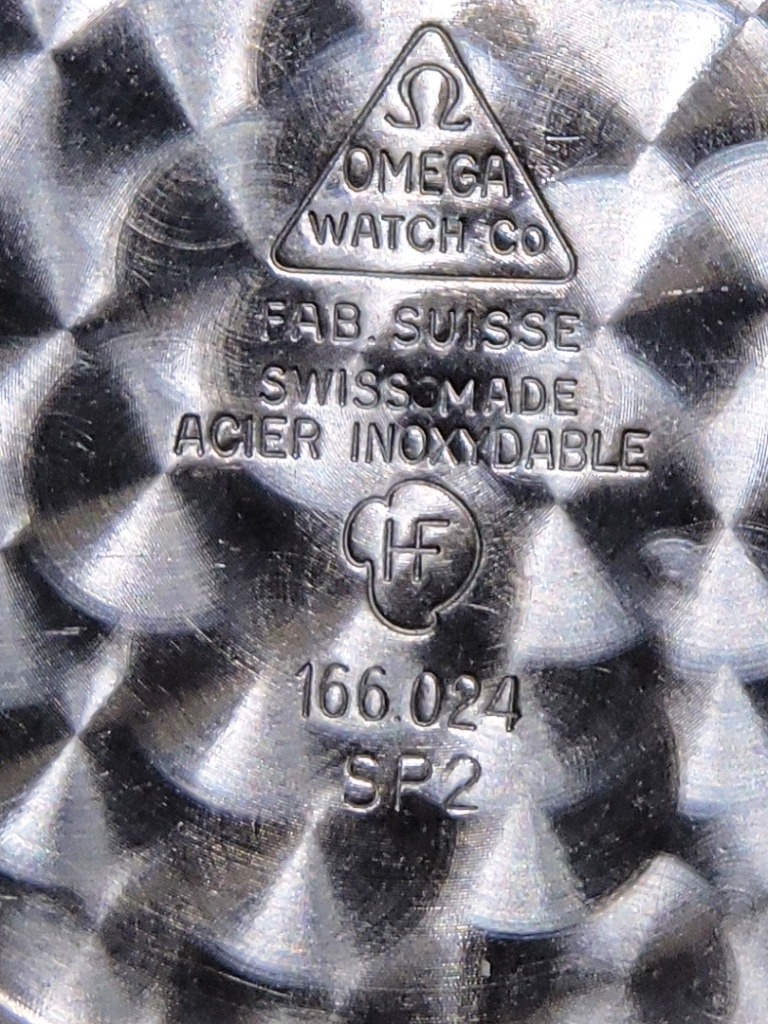

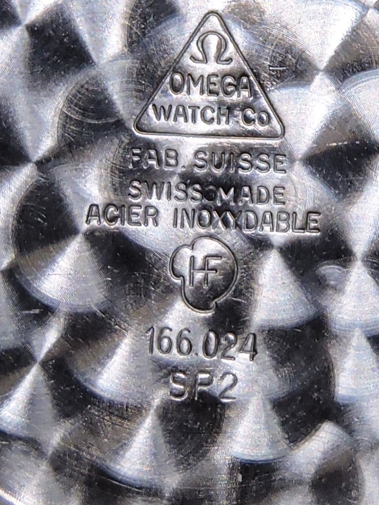

Hi Guys, Was the 166.024 SP2 the final Omega Seamaster 300 made and what year as in No F on the scale ?
regards Rob
101
133
I may have answered my own question, watchco/abouttime have 166.024 dated (19) 67 on sale at this time, which would indicate that the 166.024 SP wasn't the final production run Omega made of the 300.
Unless Omega finished making case backs for the 300 in 1967 and used those in succeeding final models not to be confused with the replacement case back 166.0324, which I think was run up in the late 90's,correct me if I'm wrong on that point.
Why I ask is that if I fitted a 166.024SP to my 69, 300 would that be period correct ?

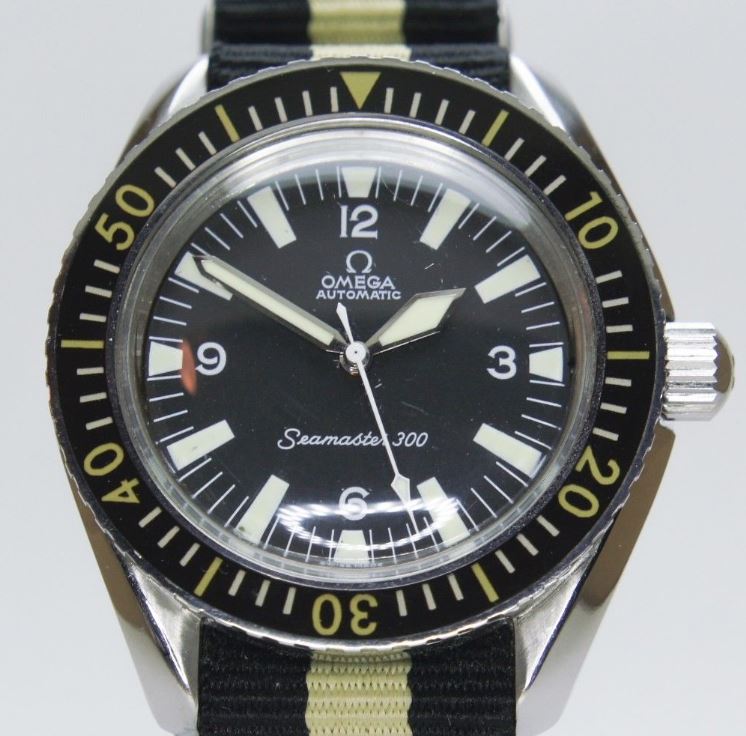

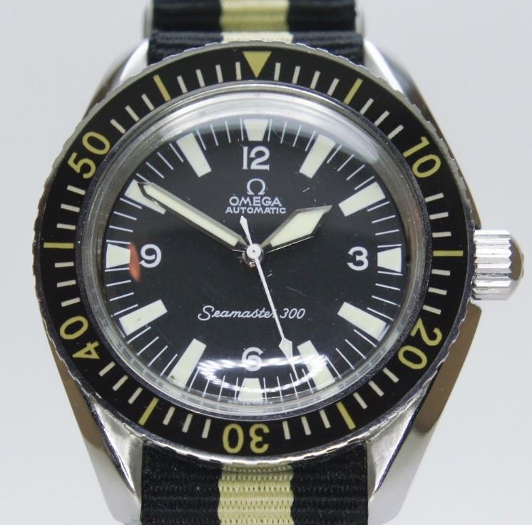

This 4 looks better and closer to first gen 4 than any other fake I've seen, maybe a little bit too pointed ha ha

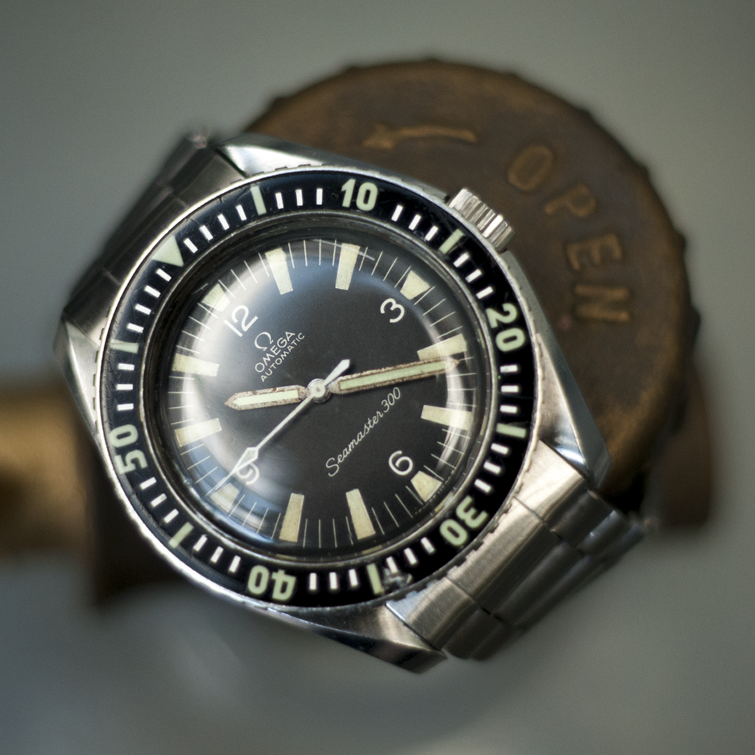

Great update on the F types, very interesting about the RN SM300's having a lot of F4's.

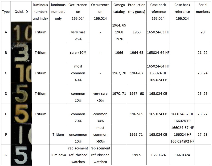

Hi everybody, this is my first thread here, and I would like to share some information I collected over the years about Seamaster 300 165024 and 166024 bezels:

Hello many thanks for the table. Great job sincerely. I own a ref 165024 (and not 165.024) with 20million cal 552 bought in France June 1964 and the bezel is correct with your type A table. I still have the original box and papers. Rds
