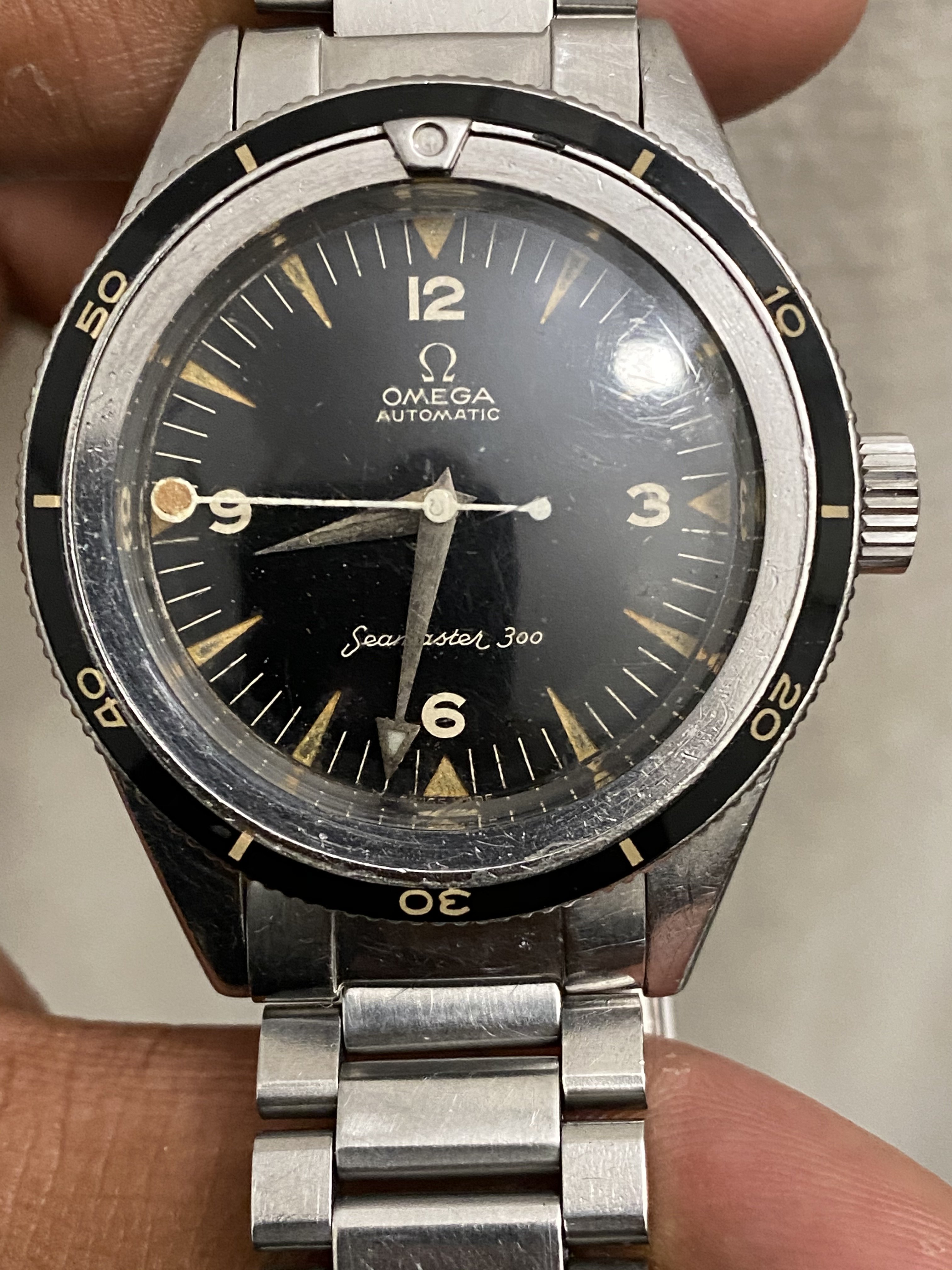

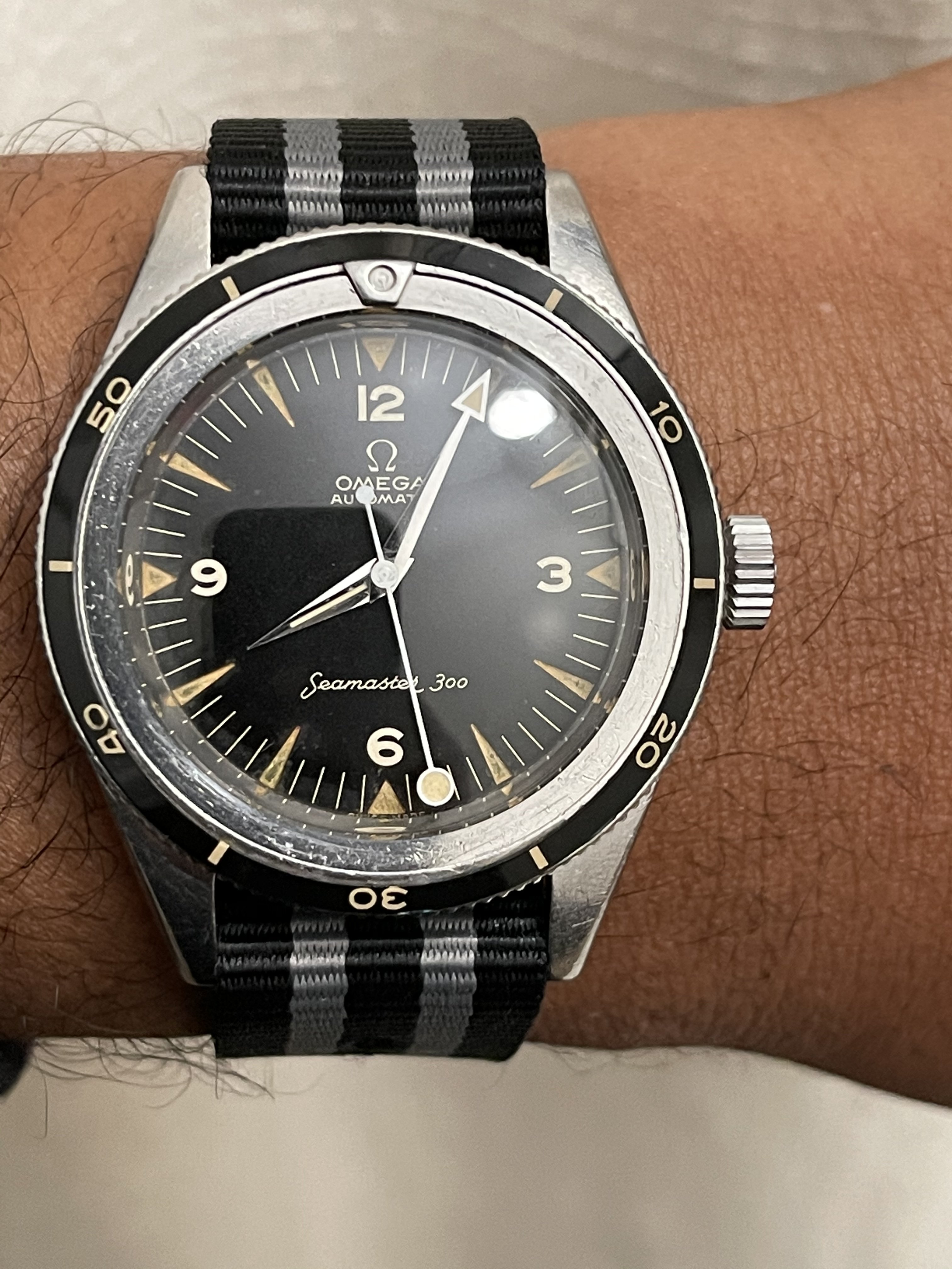

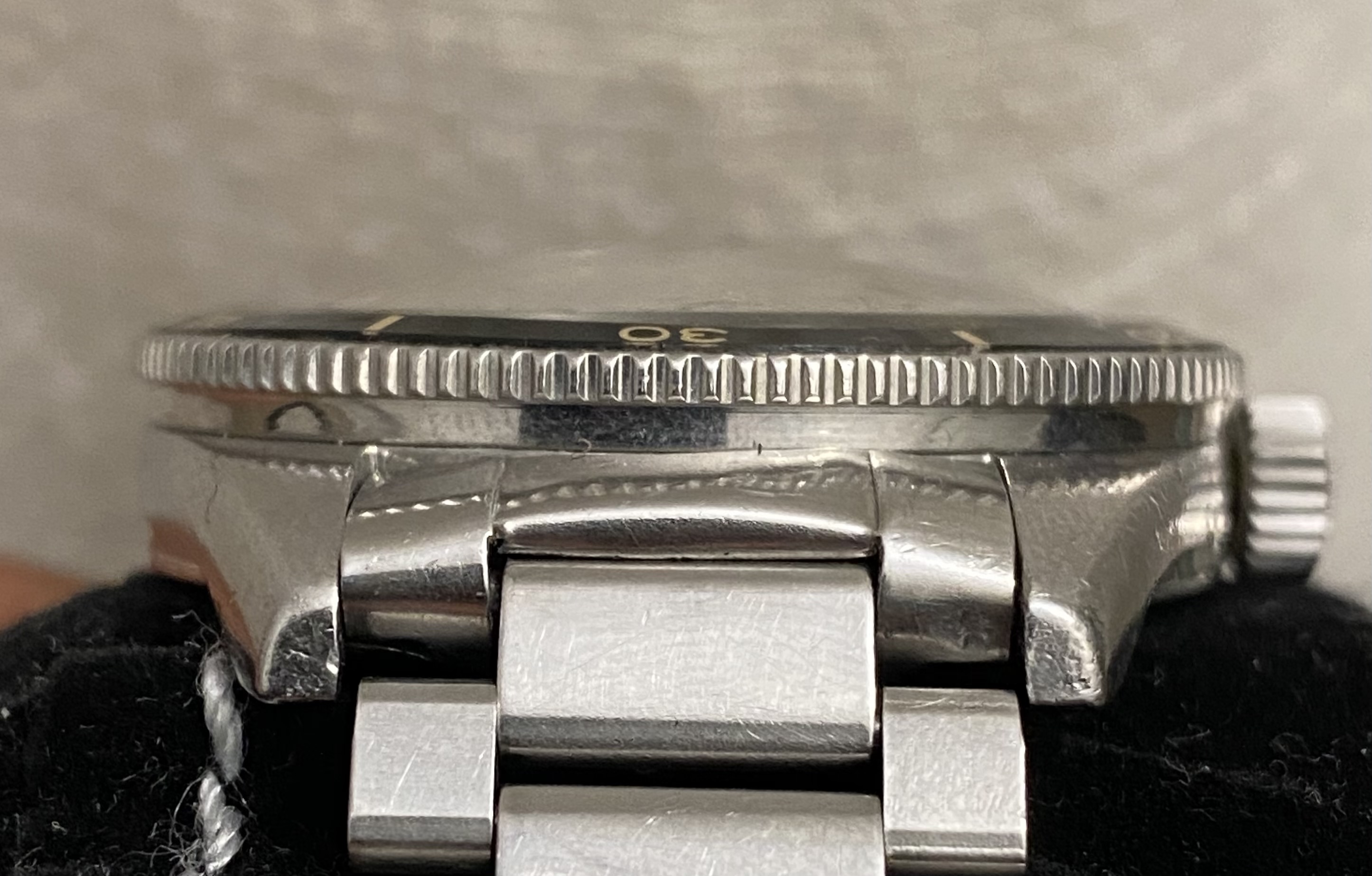

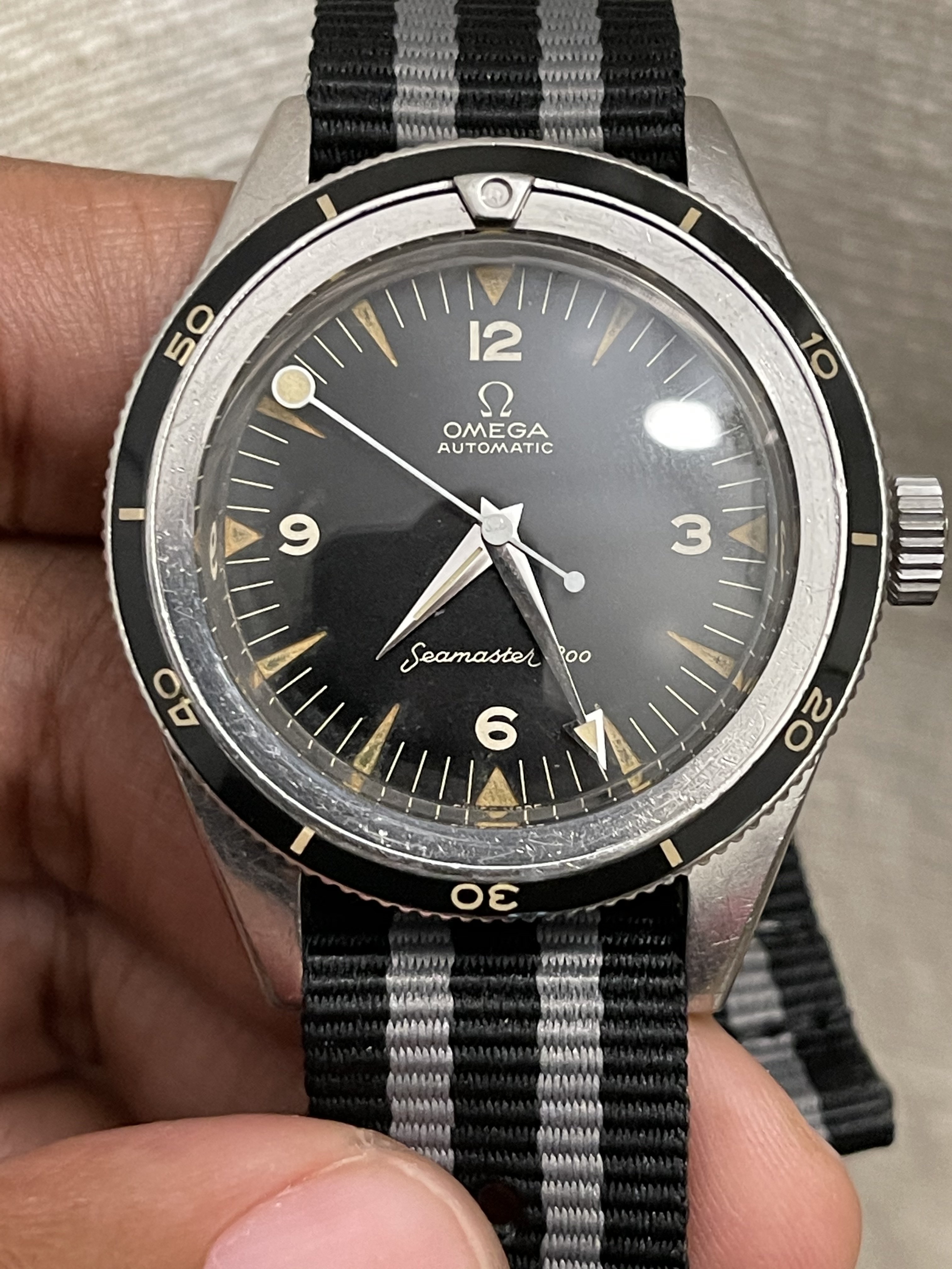

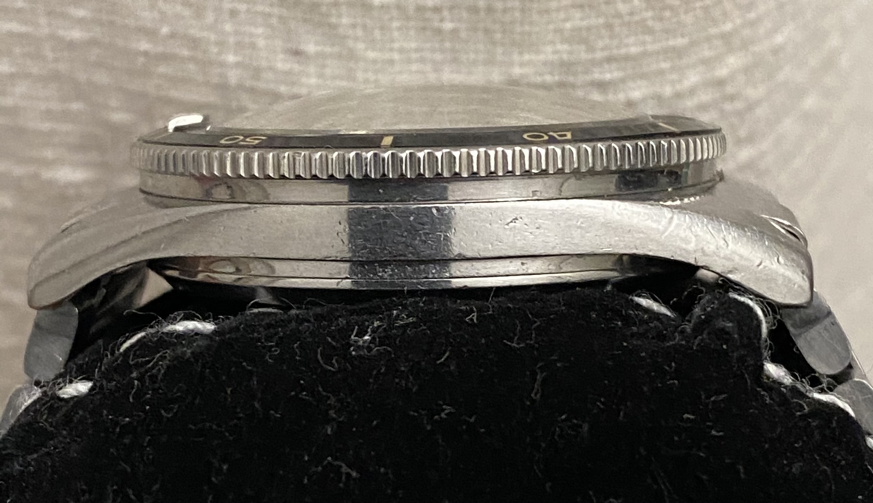

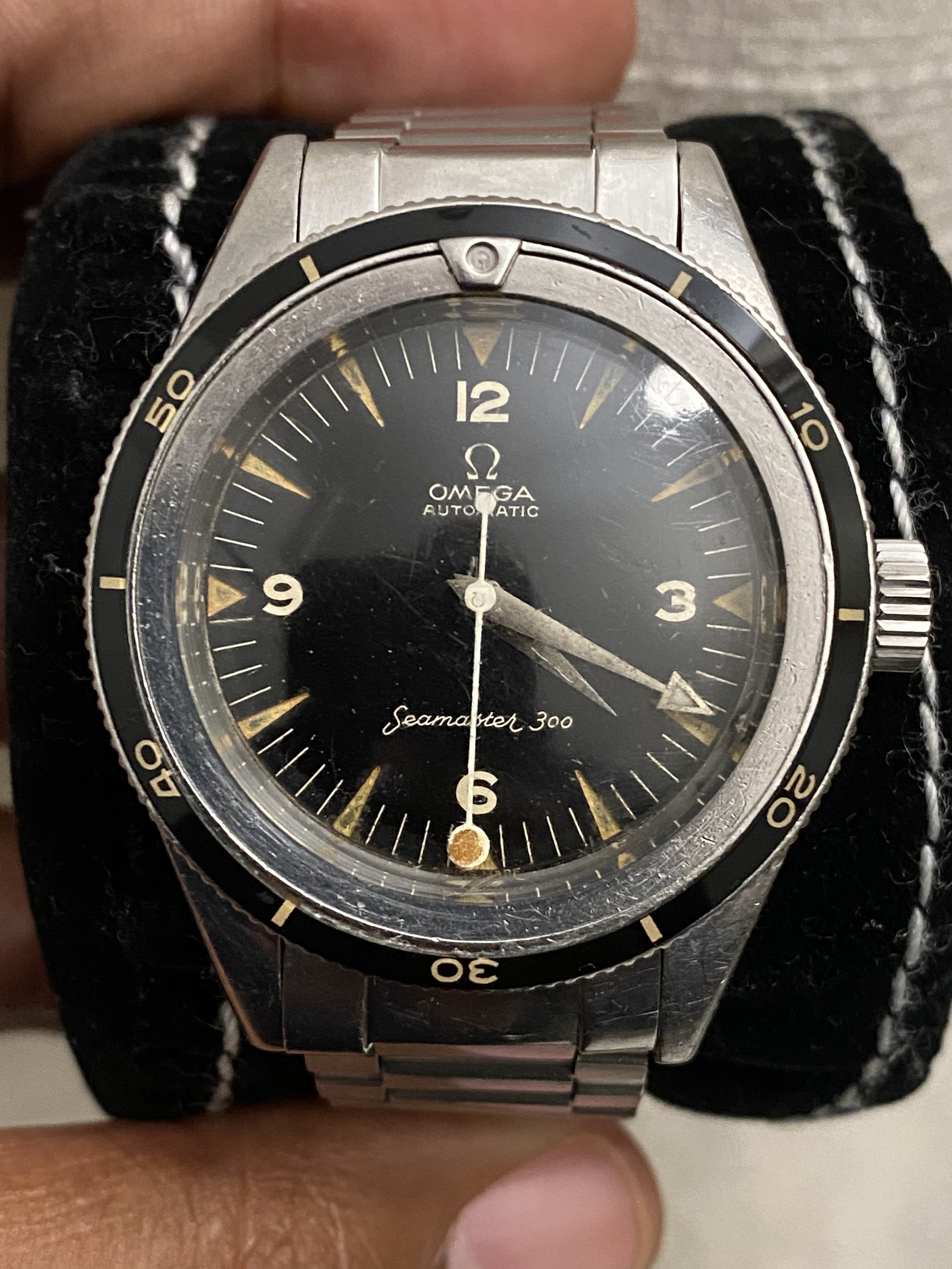

Hey all,
Hoping for your thoughts on a Seamaster 300 2913-7 I recently picked up. It's far from perfect, but the price seemed fair to me and I have a 10-day return option so I decided to roll the dice on a nice looking beater...
Stuff I love:
  • LOLLIPOP!
  • Reproduction bezel looks good
  • Dial has a nice patina
  • Original or period-correct crystal (I think).
Stuff I know needs attention:
  • Hands poorly relumed
  • Pip missing lume

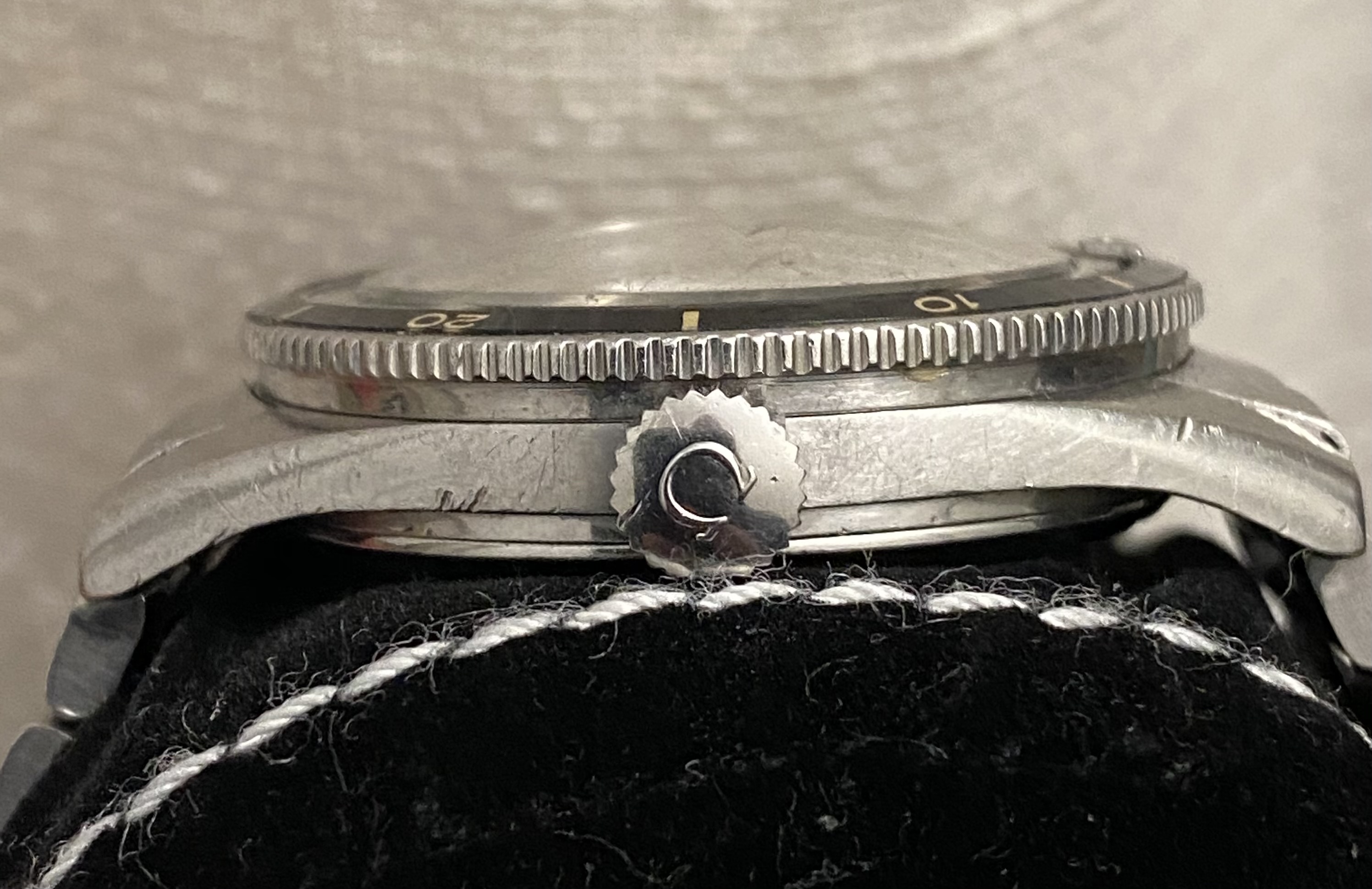

  • Service crown
  • Case a bit rough
  • Incorrect bracelet
  • Possible parts replaced (rotor).
Questions I have for @kox and the other experts:

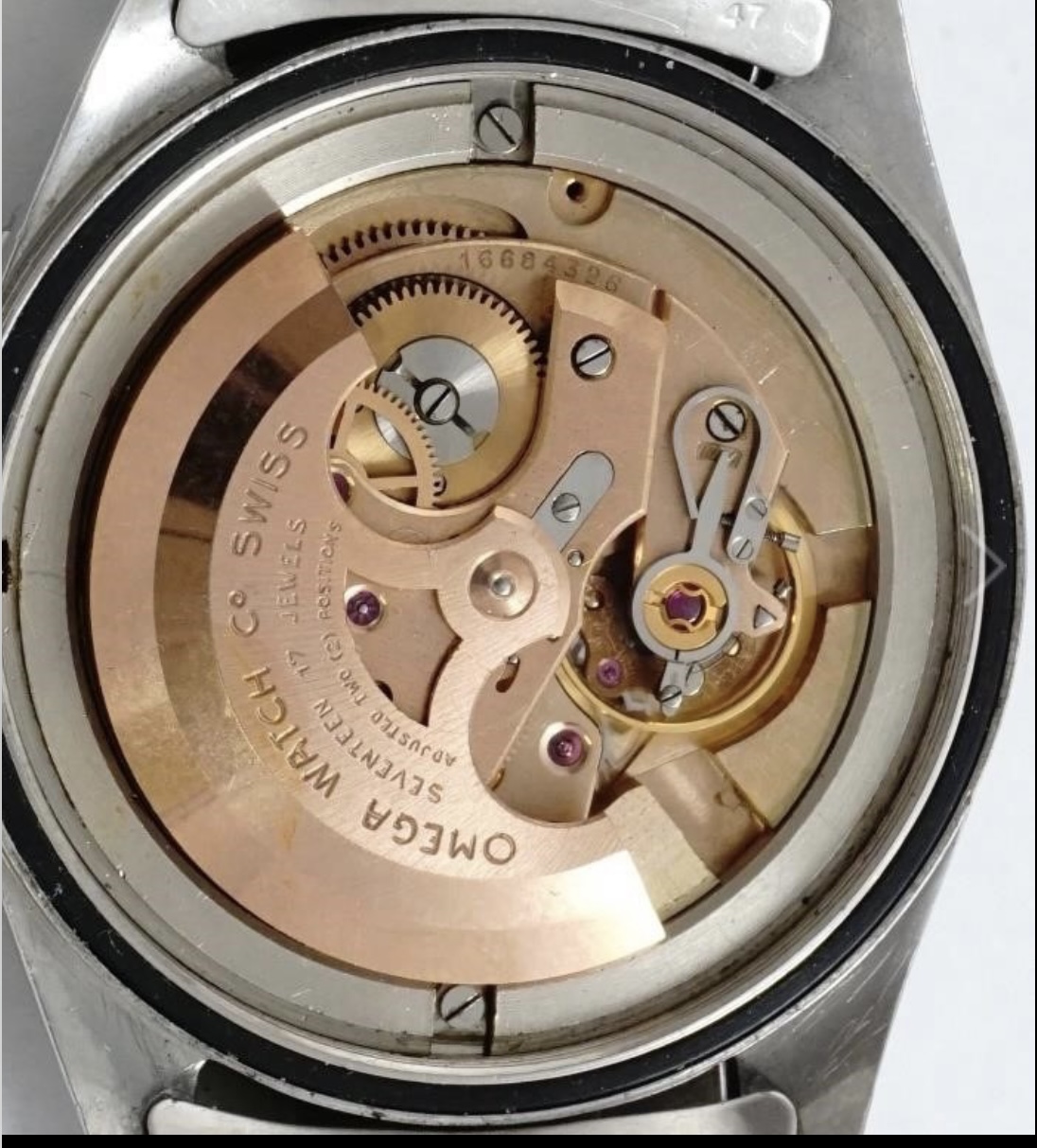

  • Does serial no. seem in the appropriate range (16.684.XXX)?
  • Rotor reads 17J, but I believe should be 19/20 for 501. Could this reasonably have been swapped during service? How much should this worry me?
  • If I want to source the correct crown, is 24 tooth, flat foot, 6.8mm diameter x 3.35mm thickness, 0.9mm stem size correct?
  • Is 7912 flatlink bracelet with no. 6 end links the correct bracelet for this?
I'd appreciate any feedback.

All of the “problems” can actually be easily sorted. It usually comes down to the price. If you paid $50k, it’s awful. If you paid $500 it’s awesome.
I personally would prefer a watch like this that I wouldn’t be concerned with getting a scuff or a bump on it....as long as I paid a price commensurate with the condition and not a collectors premium.

There is a lot to like about that watch. Once you get the lume in the hands color-matched, I think you will really enjoy it. Personally, I would also probably address the crown; aside from the shape of the logo, the thickness has a visual impact.

16.684.xxx is the right serial number range for a -7, and I believe you're correct for the bracelet. Looks like a really nice watch, especially with that lollipop!

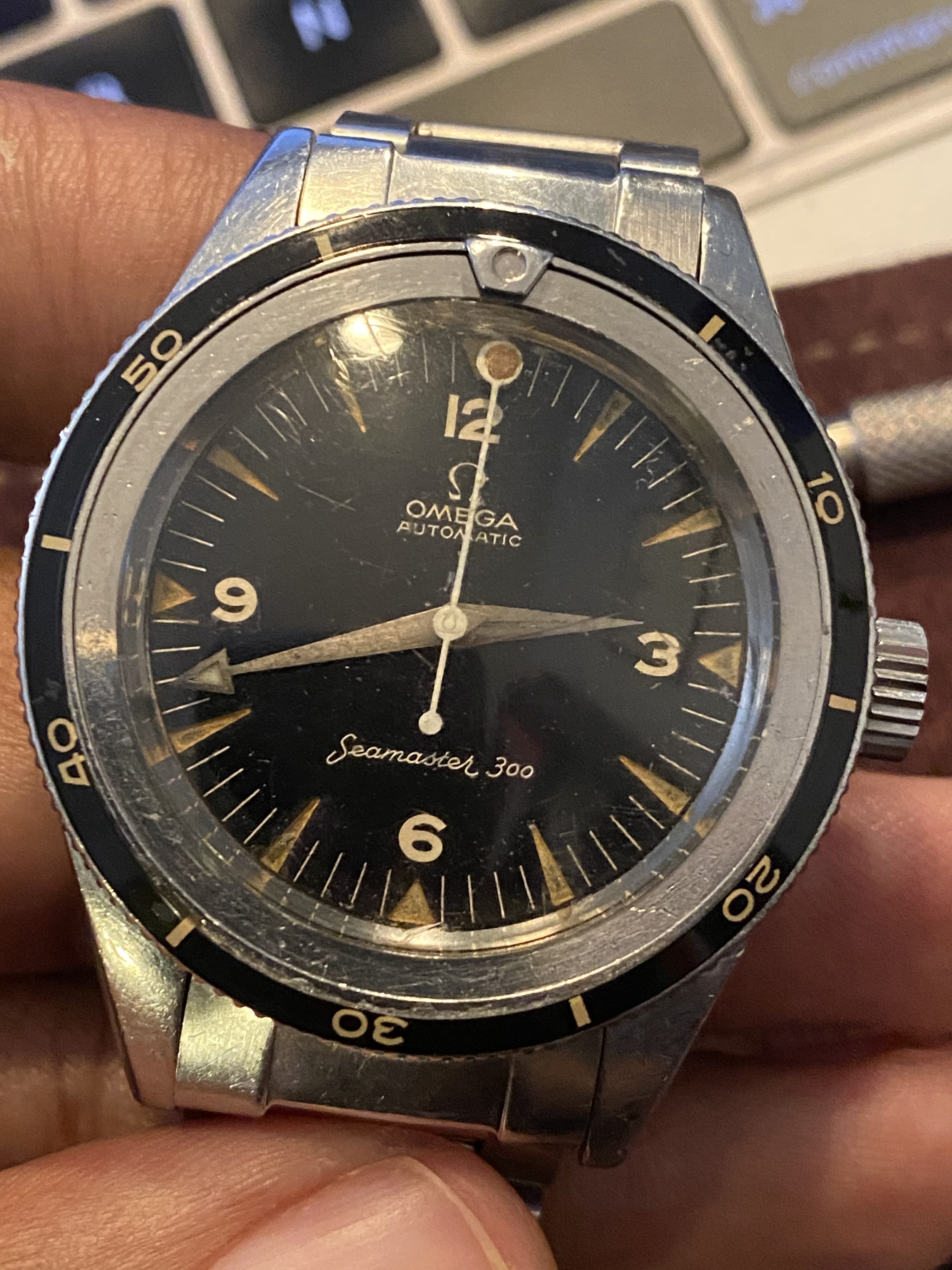

Thanks @speedamatuer @Dan S The crown I think will be a must for me and the hands. But I'm really enjoying it. I think I'd like to replace the crystal as well.

Crown & crystal are still available- if you have any intention of wearing it on a hot steamy day (or occasional rain storm) opt for a correct service crown and don’t get caught up in the lure of a vintage crown (with dead seals). This isn’t a safe queen- no need to stand on ceremony of originality.

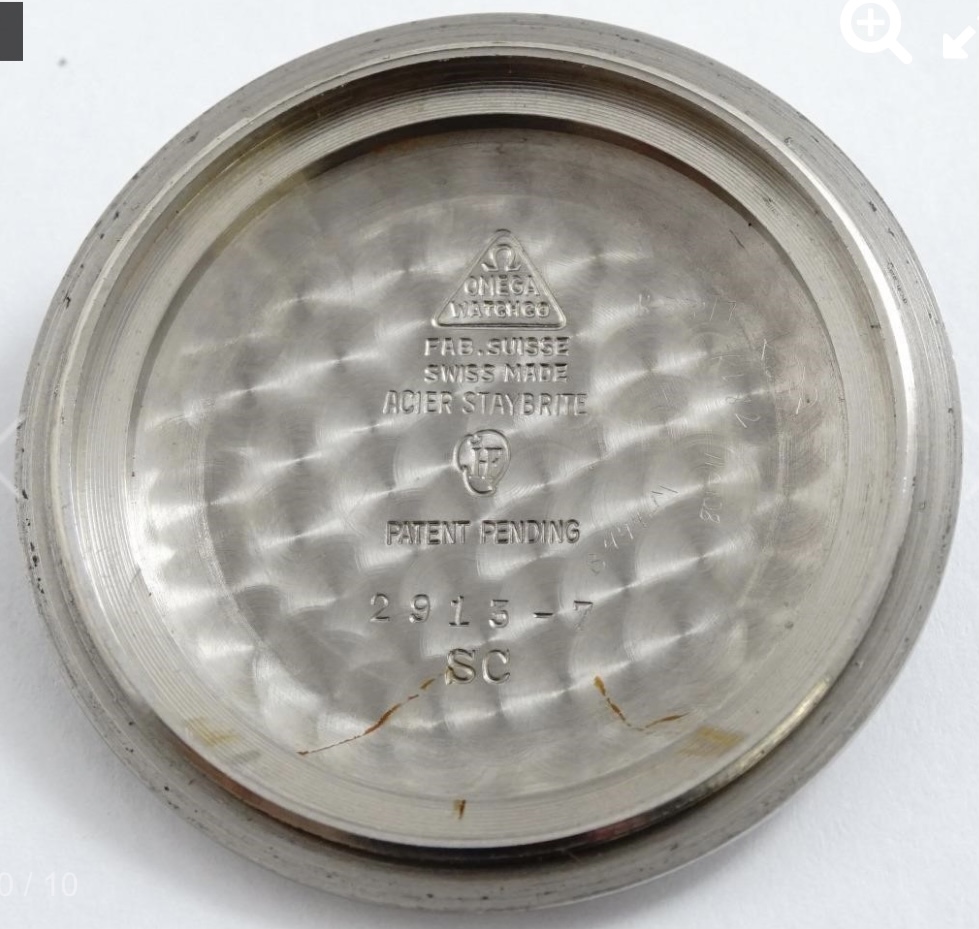

Anyone have a line on an appropriate crystal or know the appropriate serial number? I've seen a couple on eBay but not sure their the exactly right. One example below.

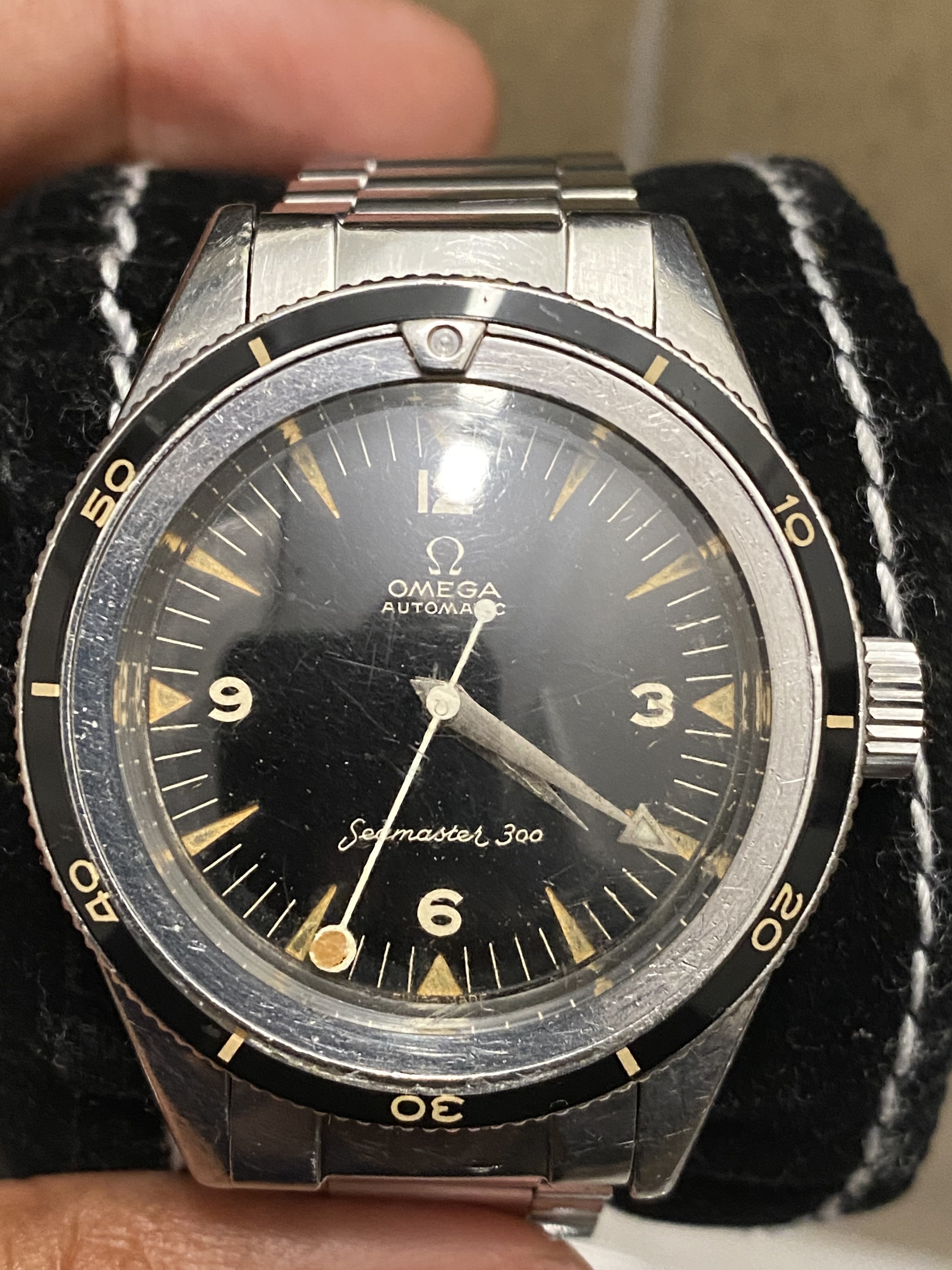

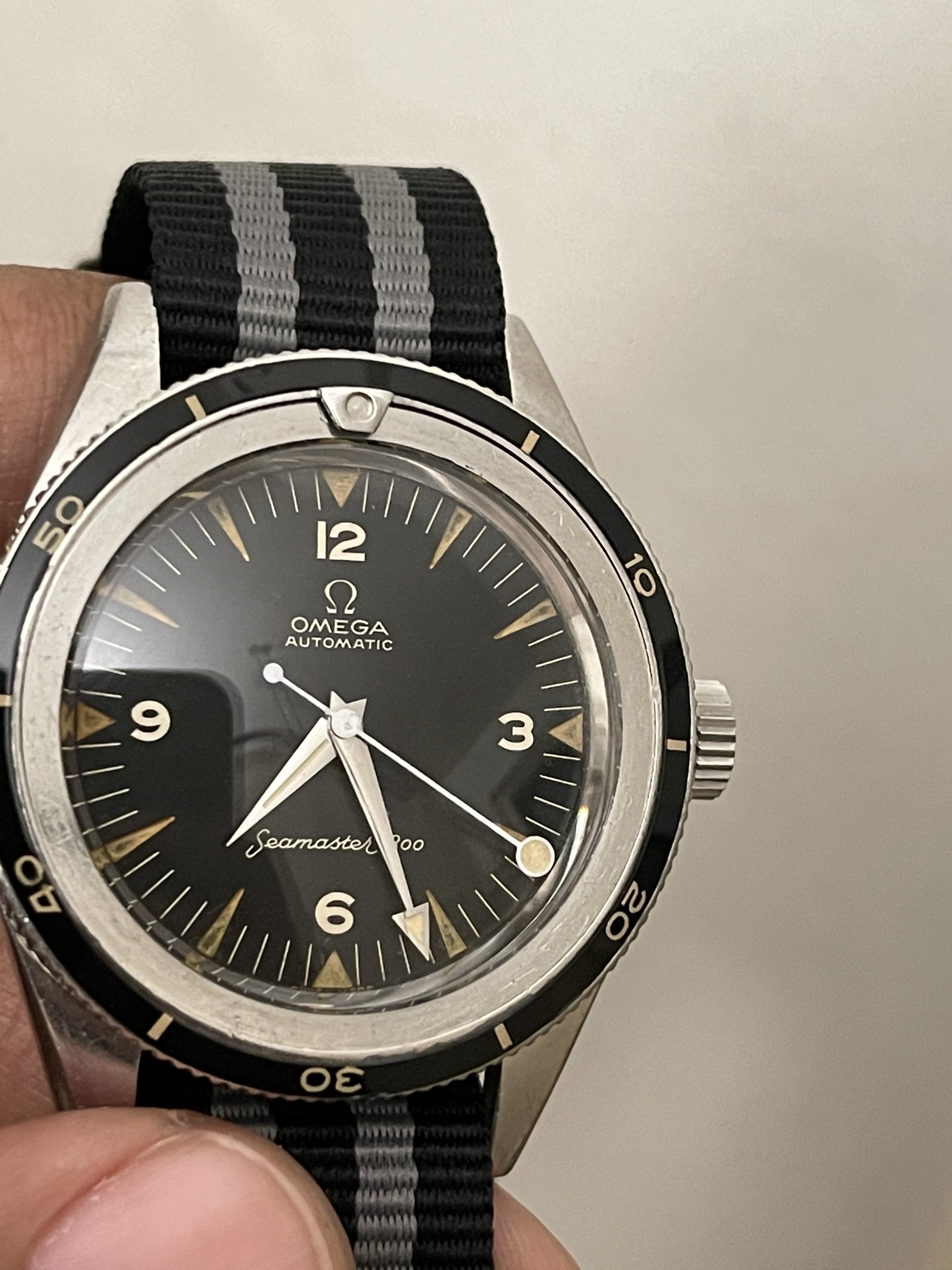

Seamaster 300 project coming along. NOS hands and crystal, and correct crown finally landed. May eventually get the bezel done and grab a Fostner bracelet once I'm over my Spectre phase 😀

What's the deal with the hour hand?
Other than the bad photography, not sure what you mean.
Hands on the 2913 are highly polished so I think it's reflecting the light, looks different
