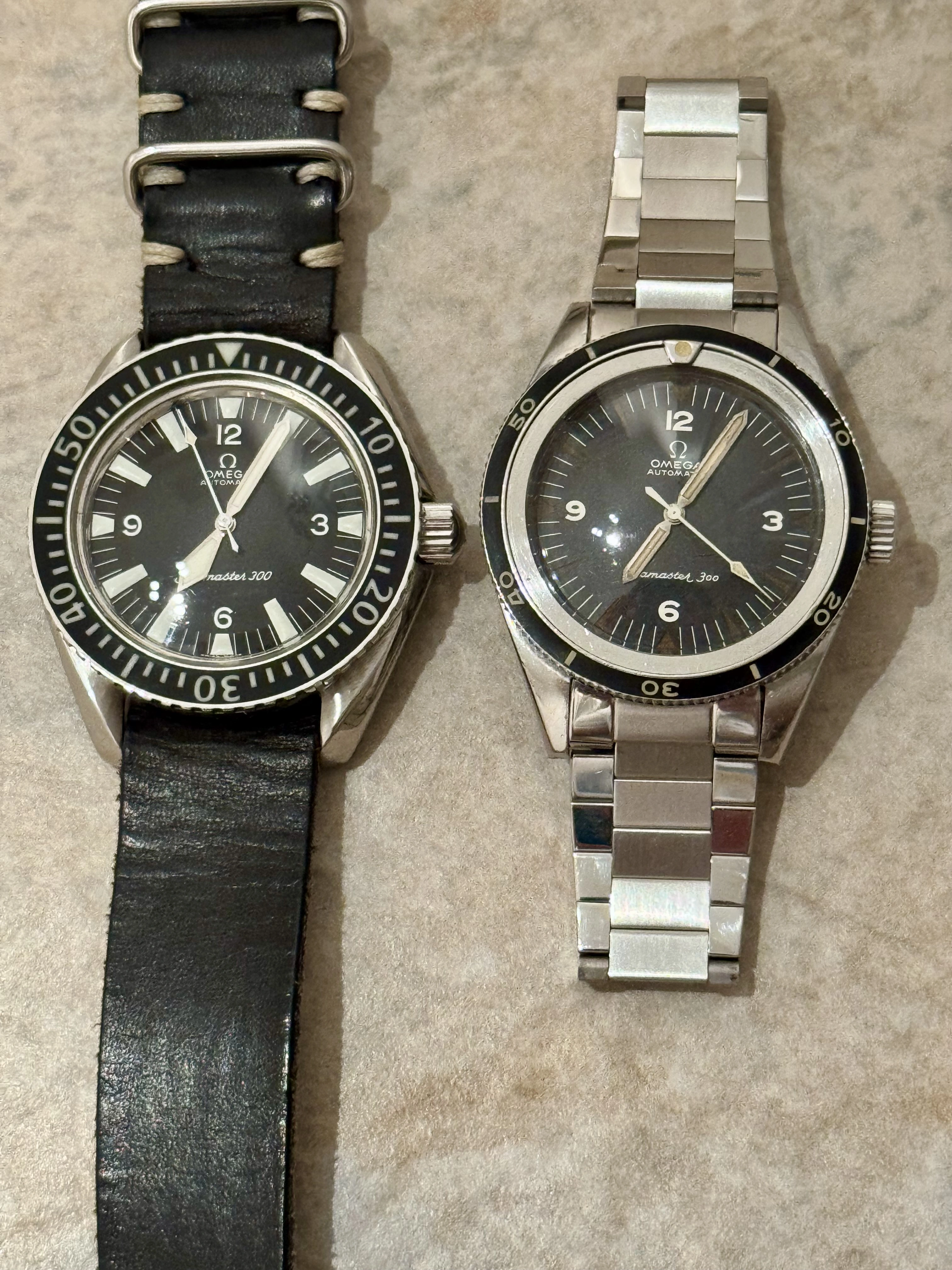

Somethings missing…. Vintage Ploprof next I think 😁thanks again everyone for the help. Dead happy!!

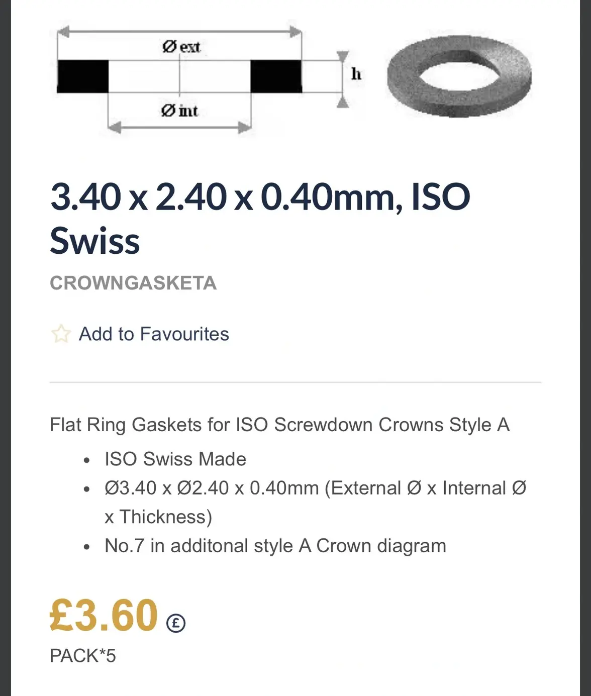

I’ve found these on Cousins. Going to order these and will let you know. @Archer any last suggestions? 😂 I have looked into the crown and could see the gasket has literally turned to cheese. I’ve used a sewing needle to pick the old out. Fingers crossed this works or new crown is the only other option
292
212
I`ve had the gasket exchanged by watchmaker in my original flat feel crown, so it can be dome and I think, there are two in parallel.
I remember only, that he had to remove the crown cover, exchange the seals and close it again somehow...
Looking a the diameters of gasket you have found, it could be it, as the outer diameter of the case tube is 2.5mm as per discussion I had with Archer lately:
48
60

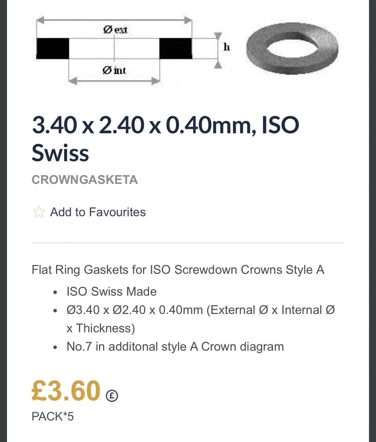

So I have an update for everyone. I was able to successfully push the tube gasket from cousins onto the screw down crown and……. It passed a pressure test. For transparency I would always recommend taking to a watchmaker but this will make me feel a bit more comfortable for now. Part number I used from cousins uk in included below.
