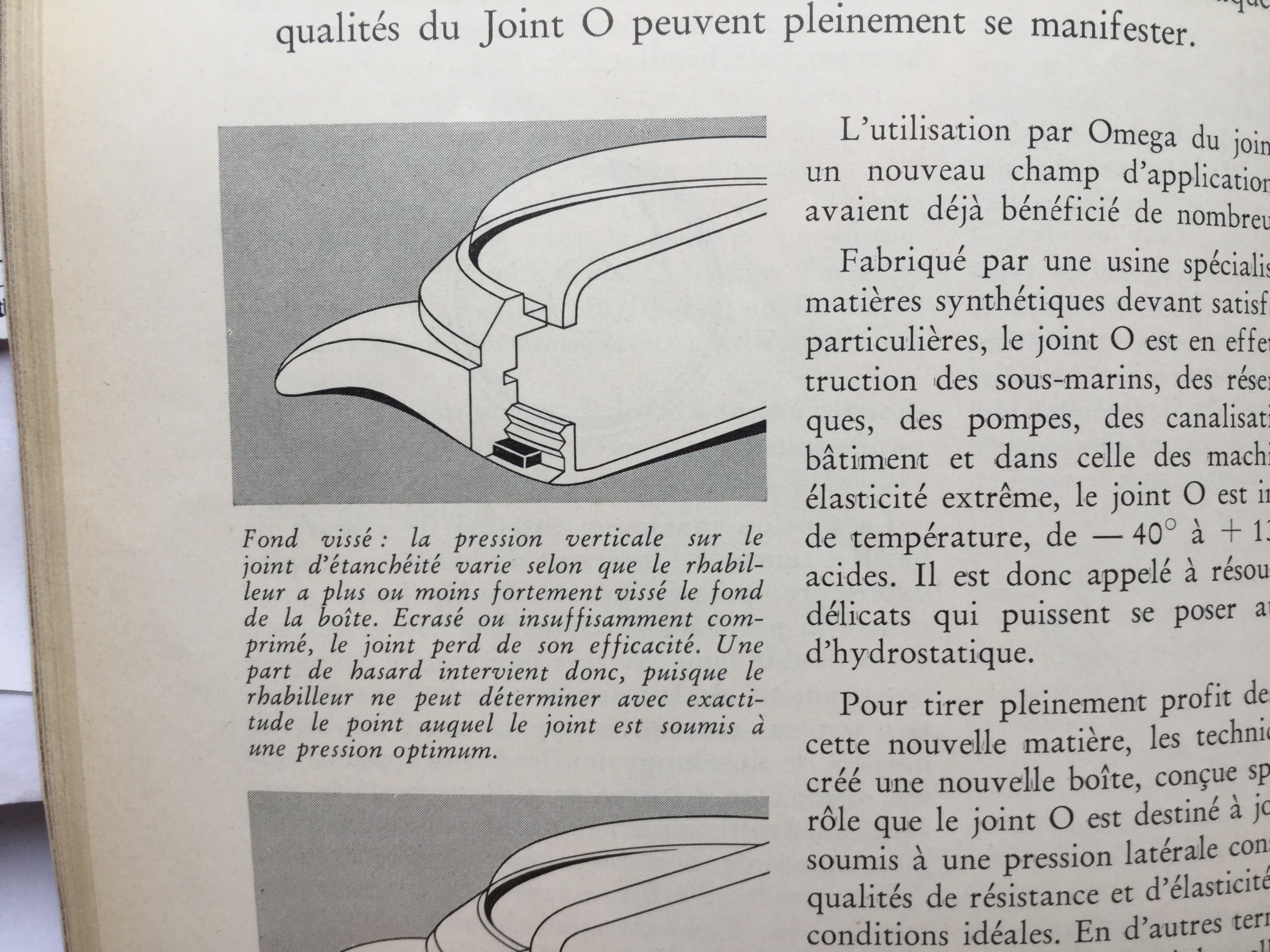

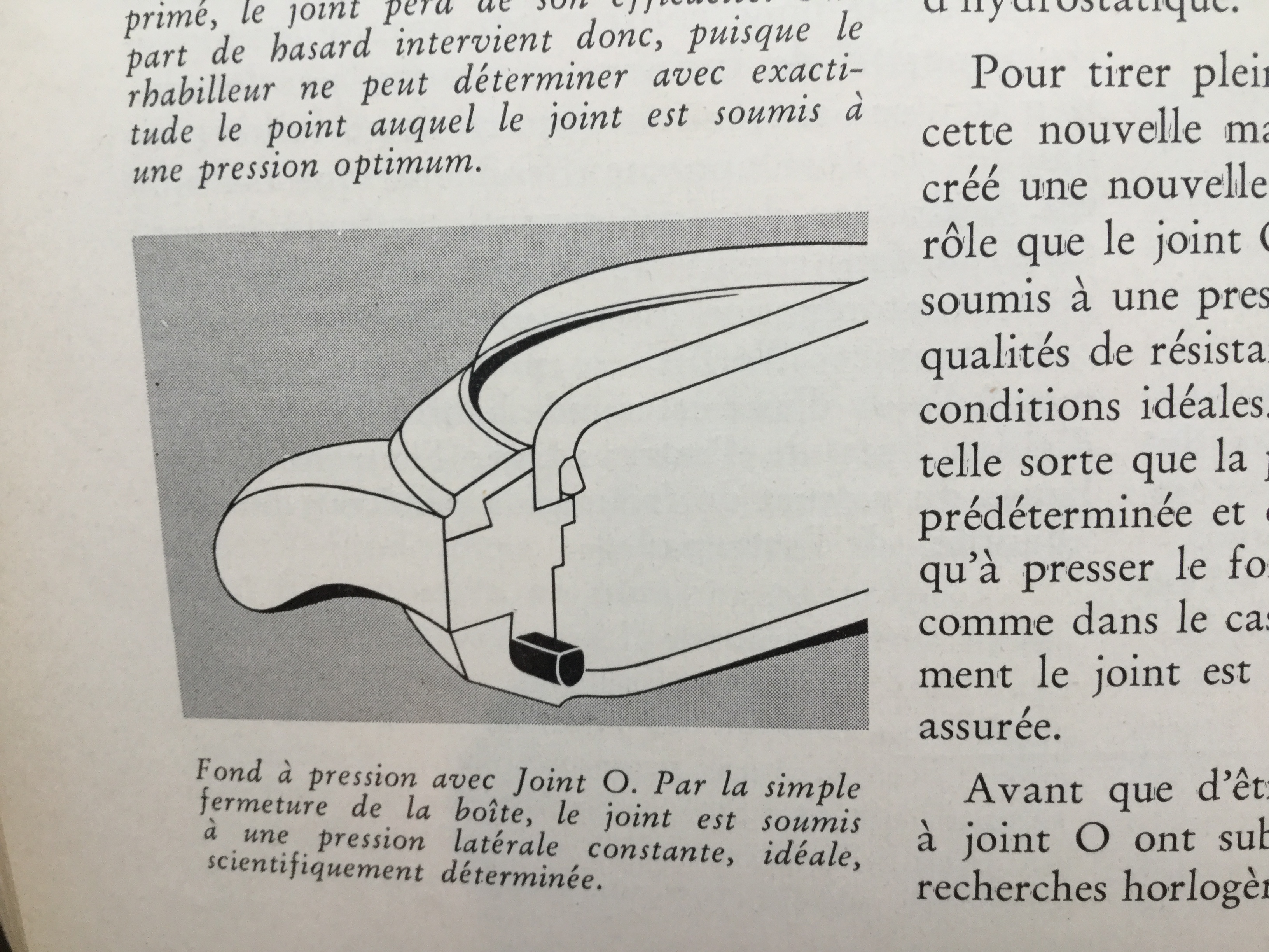

Here is what I found :
It says the "special/spezial" case is OK up to 6bars, like it is explained in your documentation (either pressure fit or screwed).
1,855
5,413
Maybe the « spezial » is the calendar.
The text in my previous post refers to all those type of press in cases bearing a gasket.
Imho, the 2975 was not better for waterproofness. I have never seen this model being advertised as being special, it was just the new model. What made it disappear after one year is the the arrival of the 550 caliber.
But it is a hell of a watch, which is not so common. It rivaled the Constellation.

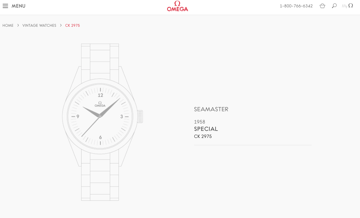

Omega still calls the 2975 a "Special" in their database:
