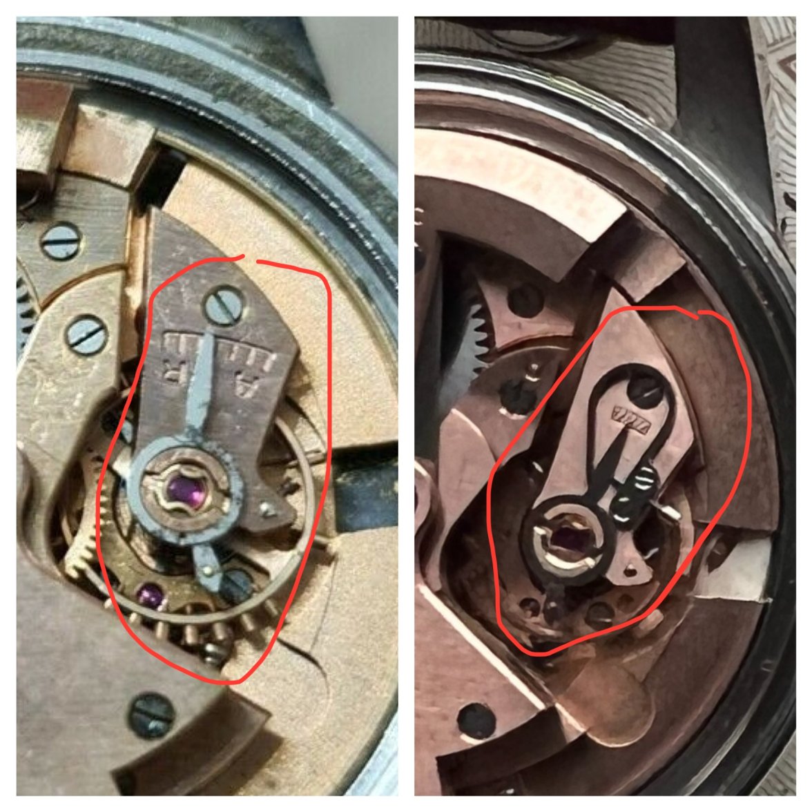

Movement isn鈥檛 just tired, it鈥檚 incomplete (see the regulator).
I'm embarrassed to admit I still don't see what's missing. Or is it that the balance cock is such a different color and was likely replaced?
Compare:

351 did not come with swan's neck fine regulation.
::facepalm1:: Cheers for clearing that up, that's what happens when you reply in between other chores I guess. Mea culpa and sorry for the confusion.

Out of curiosity and to help me understand better, was that a photo of a 344 or 355 that you shared?
In case you meant me, that鈥檚 a cal. 354, the successor of the 351.
