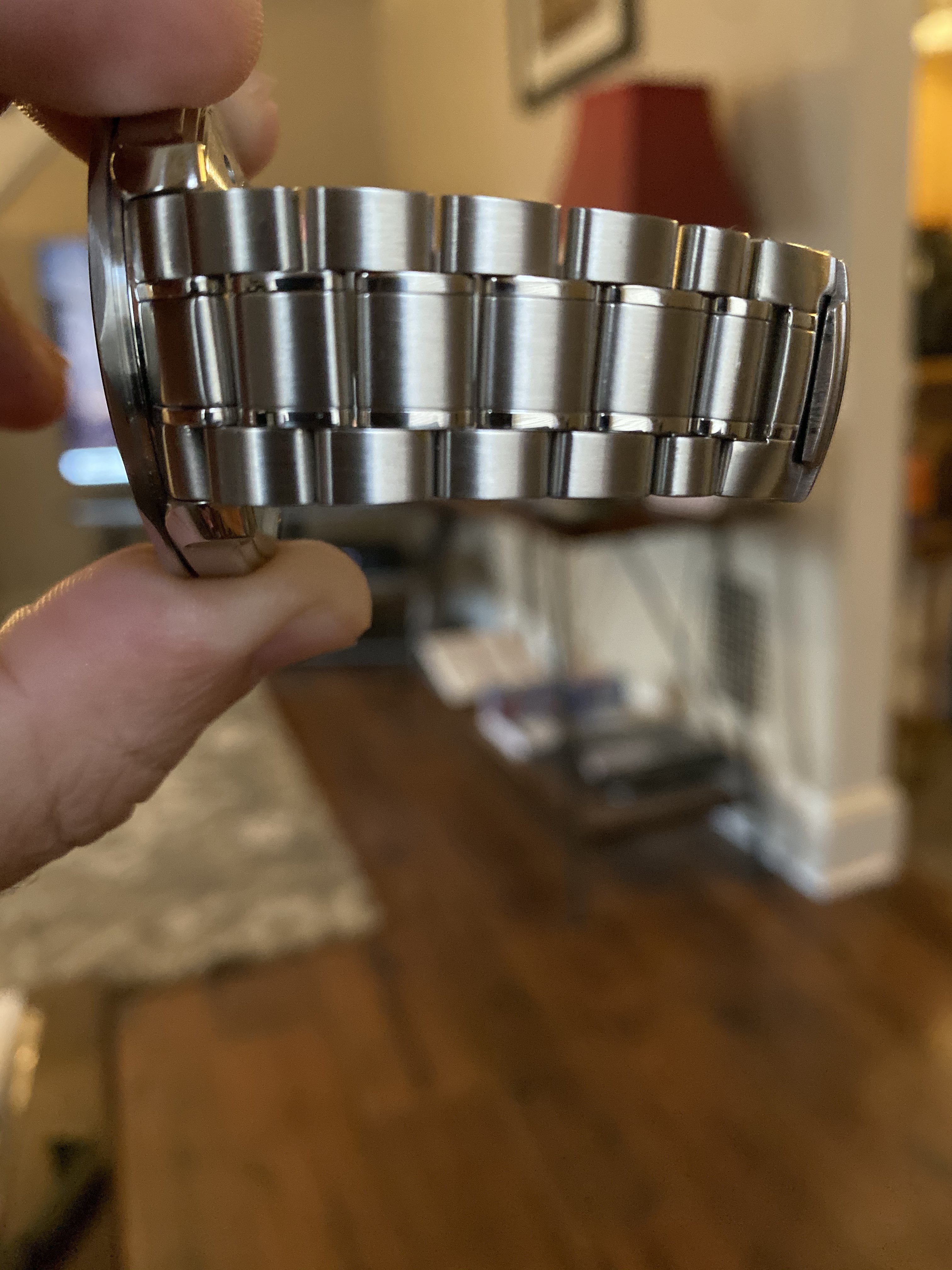

Hi guys,
This summer, I bought a Seamaster 2254.50 from 2006. It's in good condition, but I have a question about the bracelet: There's significant spacing between the links, as you can see from the pictures. I asked my local watchmaker, and although he isn't an Omega AD, he said that it's due to design, not wear. This seems right, and he also checked the pins and tubes, but I was hoping that some other owners could check their bracelets. Do they have the same spacing?
The only reason I'm asking, is because I'm curious. Thanks in advance!

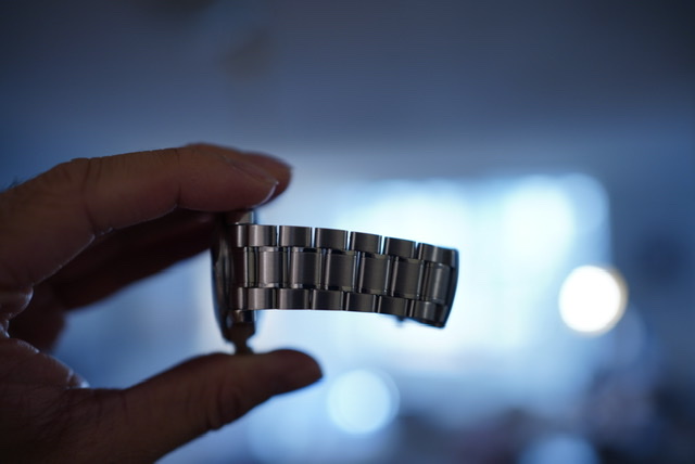

I’m not sure how old my bracelet is as I recently purchased it off WUS, but here’s the flex that it has. I don’t mind it - the pins and sleeves all seem to be solid, and I find the space makes it more comfortable to wear.

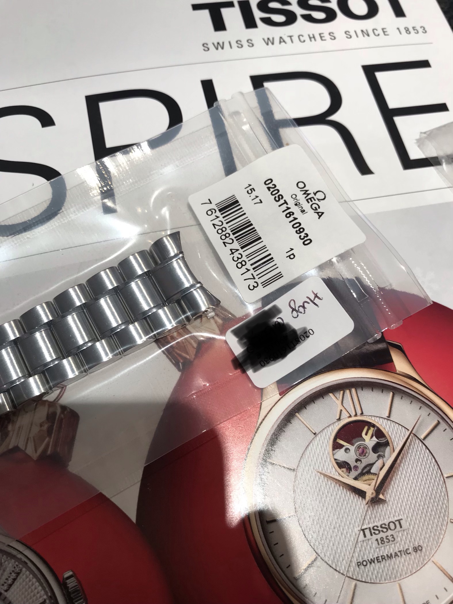

To me, that bracelet shows some stretch, therefore you notice already more gap between the links.

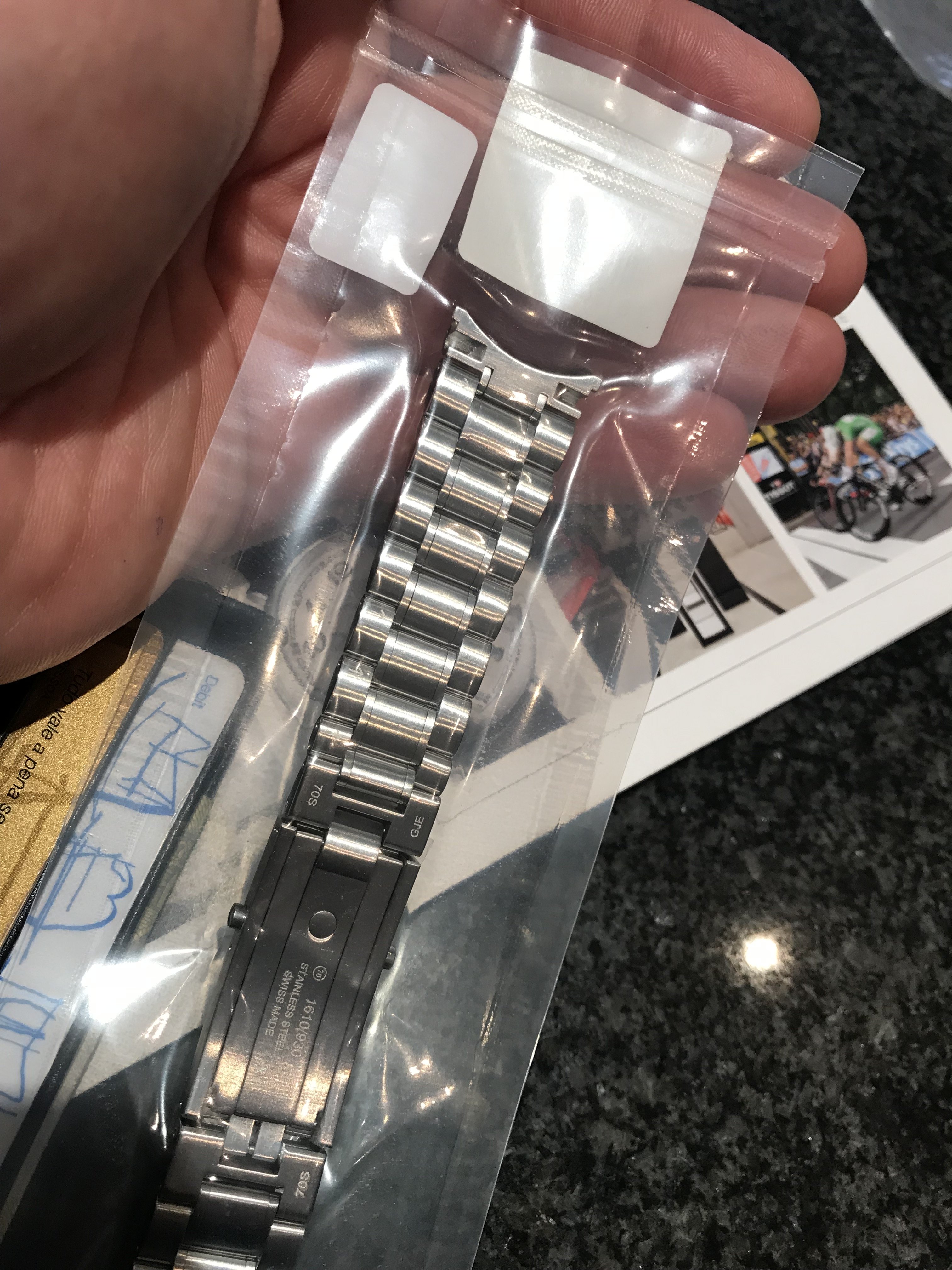

Let me show you how they come from factory.
Last year bought a new one to a friend.

I forget the year but it was recieved back from service earlier this year and there was no note saying the bracelet wear was an issue. You can definitely still get a brand new replacement if you wanna freshen yours up. I'd be interested in knowing how much play is in a brand new one. I would imagine none Haha
FWIW, the last 2254 I had serviced by Omega, they replaced every pin and collar in the bracelet as part of the service. None looked particularly bad, by the way. But they changed them anyway.

And that’s how it’s supposed to be. To insure tightness and for a matter of security and to keep bracelet to factory standards.

There is a specific tool that Omega makes that tests the tightness of the pins, so they will test every one, and if needed replace them if they are loose.
