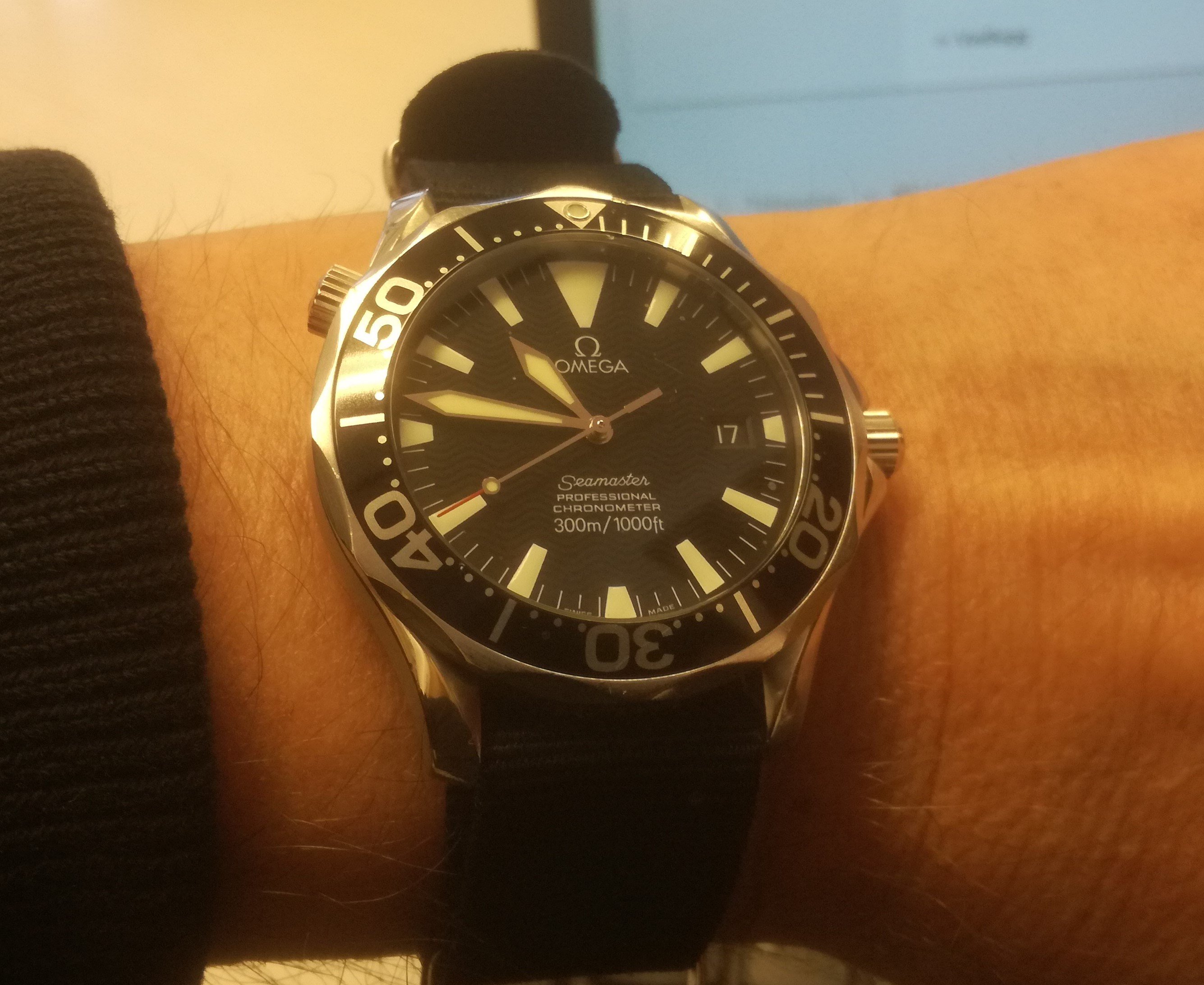

Attached a picture of the watch in question.
