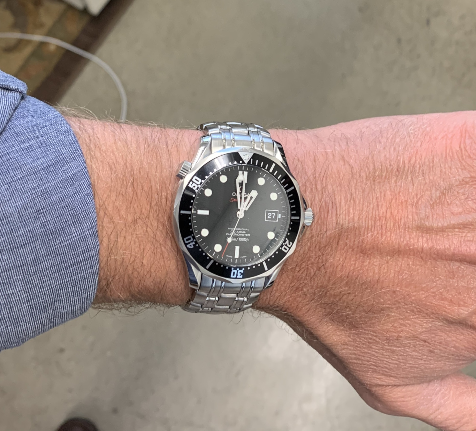

Hello Omega Fam,
I have a recently acquired Seamaster 2220.80. It has the omega co-axial escapement version c. If I manually wind the watch, it runs for around two days and keeps fantastic time (-1 second a day). However, I’ve noticed that it will cease. At first I thought it had to do with the C version of the co-axial escapement since it’s been known to cease, but considering it runs great for almost two days when fully wound by hand, I think there may be something wrong with its automatic winding? I was planning to bring it to service at omega, but I was hoping to kick it down the road a couple of years since it was serviced 2 years ago. Any thoughts on what it could be? I did notice that once it ceases, if I tap it with my fingers it’ll give the movement a jolt for 10 seconds. Any fixes? Or do I need to bite the bullet and give it a full service.

Do keep in mind that the 2500 calibre has a 48hrs power reserve. So if the watch is wound fully but remains at rest, naturally it would stop in 2 days as how you'd mentioned. Over the two days, were you wearing it for at least a few hours a day or was it at rest throughout those two days?

Great question. Yes, I was wearing it all day other than going to bed. In one case, I was even hiking, so I’m certain it should have been charged by the movement of my wrist. It makes me wonder if there is a rotor issue. Thoughts?

No one is going to be able to exactly pinpoint the problem remotely on a forum.
Unclear if the test you did just manually winding it, you we wearing the watch or not. If you were, then it's not a test that is going to tell you anything. So if you haven't done so, wind the watch fully using just the crown, set the time, lay it dial up, and monitor how long it runs. If it runs for the full expected power reserve, then you know the issue is in the automatic winding, and not the base movement.
In the end though, it's not going to fix itself, so you will likely need a full service regardless.
