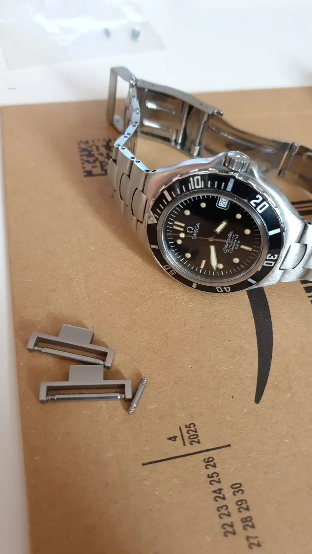

Been browsing the forum for a couple weeks and thought someone might be able to help. I have inherited an 80s Seamaster 200m ('pre bond') and it's in quite good physical condition. An automatic 36mm

Second question is I have made some adapters for an 18mm nato strap (my hands are very big and I have skinny wrists so can't get the bracelet comfortable without not being able to slide it over my mitts lol). I wired them out at work, I saw another post where someone took a 20-18mm adapter and milled the sides off to fit the 8mm gap. I've done the same but with an EDM machine instead.
How do I get the bracelet off? I managed to take a couple of links out without issue but don't want to damage it if there's a special way to remove the pins for the case-bracelet interface.

Those are nice adapters. How did you make them? To answer your questions, first i would advise against sending the watch to Omega. I did it once and i regretted it. They did excellent work (replaced half the components of the movement) but they over-polished the case ( I forgot to tell them not to polish it). They will also change the hands which they should not replace as yours are original to the watch. If i were you I would find a small watch shop next to you to get it serviced and replace the gaskets. It will be cheaper and do tell them exactly what you want done.
To remove the bracelet it is the same process as for a link. There is a pin inside that you need to push out.

Thanks, my pin vice doesn't line up well for pushing that out so I'll have to try tapping it out with a longer pin. Do you have to push it out a certain direction? Some of the bracelet links had an arrow indicating as such.
I bought something similar to this: 20-18mm spring bar adapter
then used a 'wire erosion' machine to cut the 20mm side down to 8mm. The machine works by creating a spark that erodes metal and can do very accurate and detailed work. A bit overkill for the job, really, but it didn't cost me anything to use. I could make one from scratch but the drilling is very tricky on a small part like that.
Either way works. i unusually use a long pin with a hammer while the watch rests on a towel, works well.
Thanks for the tip on the bracket. If i were you i would keep the factory bracelet and use the diver extension to put it on your wrist.

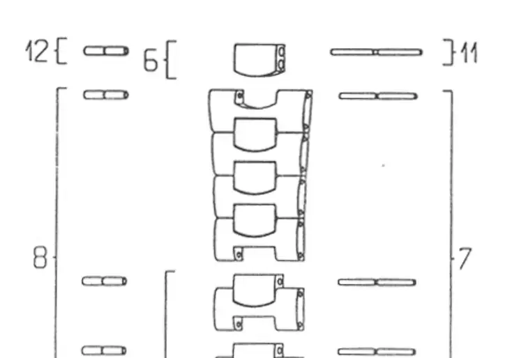

Just use a pin removal punch. Support one side in a plastic bracelet block and drive the pin "11" out with a hammer.
It's a pin/collar setup so should bot be too hard to remove.

Thanks for the advice everyone. That bracelet drawing is very helpful too!
