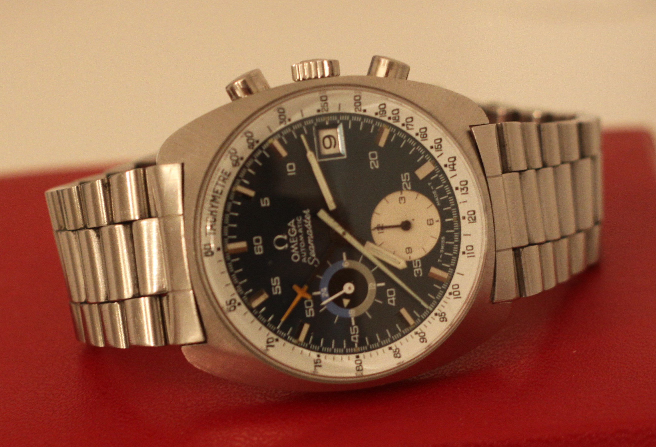

a bit of spare time, and I decided to start my 176.001 restauration project.
I do have a 176.001 movement still residing in a 007 case, and I need to change this.
As I was collecting all the parts to get it to my watchmaker, I still not came across regarding the correct configuration of hands is for the 001.
Any opinion?
Blue Dial (A1)
Hour: black, white tip with lume inlay
Minute: black, white tip with lume inlay, needle pin tip
Small second (Sub dial): white
24h disc: black, with white or orange triangle? (to my mind, the red triangle was for the later prodcution years only)
Small Chrono hour (sub dial): black
Chrono Minute central: black, airplane tip, tip white or orange?
Chrono second central: White, fully lumed ?
For ref and pic junkies, a picture of my 001/007 transitional (also here I am not sure about the 24h disc triangle...)
